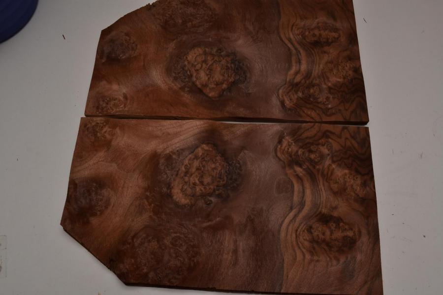

I am looking for finishing suggestions. How have others finished theirs?
Any pics/links to ideas would be much appreciated.

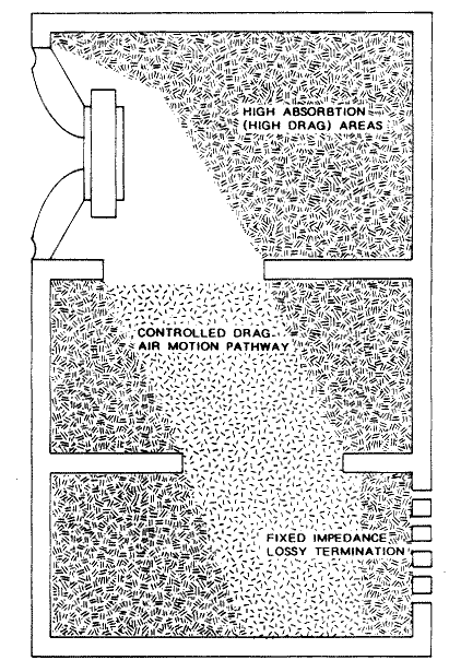

Thor effectively is an over-complicated way of creating an aperiodic box. So let's just come up with an aperiodic enclosure and have done with it. I've been quite interested in aperiodic boxes for a few months, as they seem to offer quite a few advantages, particularly with respect to reducing the impedance at box resonance, which can only be a good thing, but there appears to be a paucity of literature on the subject, bar an excellent Ted Jordan article from 50 years ago (thanks again Dave). However, Scan Speak make some nice-looking aperiodic vents, which, according to the information on the Madisound site, 'makes your sealed driver behave as if it's in an enclosure 20% larger.' Fair enough, and I see no reason to disbelieve that statement. No much to go on, but the Parts Express site is a little more illuminating: apparently you need 1 vent per enclosure for boxes up to 1.75ft^3, 2 vents for a larger box, up to 2.75ft^3 etc. Sounds sensible enough to me. They also suggest that only 60% of the box should be stuffed, and 'a clear pathway from the rear of the driver to the vent is needed'
That last bit might be tricky, given that 60% of the enclosure should be stuffed according to the information, but if we follow the MLTL approach, the point of maximum velocity occurs at the terminus of the line, so if we stuff the upper 60% of the enclosure, leave the bottom part unstuffed, and mount the vent close to the base, by my reckoning, that should work well enough.
Assuming the above assumptions are correct, I've tried to model an aperiodic box in Martin's latest Closed Box sheet. 42" tall, 7.5" wide, 11.75" deep (internal, assuming 3/4" material). These are basically the original enclosure dimensions, albeit without the internal baffle of course. Stuff 0.35lbs ft^3 from the top 25.25" down. Each enclosure will need 2 Scan Speak 29001 'Flow resistance vents' mounted, one above the other, on the rear panel. Centre of the first should be 5 1/2" up from the internal bottom, the second 11" up (basically, as close as possible to each other, and as close to the base of the enclosure as possible). Assuming that the available information is accurate, the anechoic response should look like the attached graph, and I can’t honestly see any reason why it shouldn’t work, and work pretty well at that. Aperiodic Thor anyone?

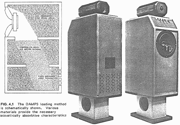

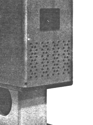

Scottmoose said:They also suggest that only 60% of the box should be stuffed, and 'a clear pathway from the rear of the driver to the vent is needed'
The PEARL PR-2 is probably one of the most advanced aperiodic boxes that ever hit th emarket. You can clearly see this concept in the cutaway drawing.
dave
And Bill's choice of vent. He uses acoustic foam for all his damping. I've tried this and it works, but i find that the slot port ala Dynaco is easier to tune in a 1-off situation.
The ScanSpeak vents seem a compromise to me with no tunability (and they cost $$$).

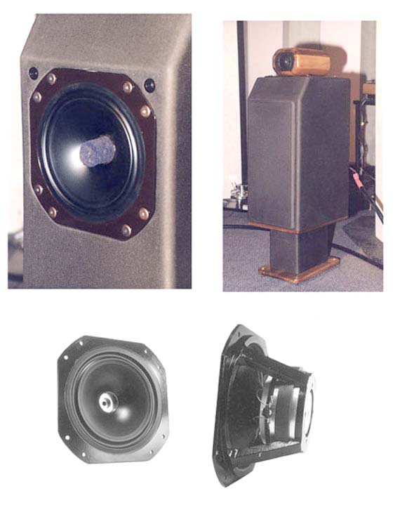

What's with the half a Turantula in the middle of the driver?
Is this a JOKE? The spider is on the WRONG side of the cone. 😀

rcavictim said:What's with the half a Turantula in the middle of the driver?
That is an artifact of a shiny cone, conversion to gray-scale, printed & scanned. Here is a color pic that might clear things up.
The 2nd order XO on these is at 1.2 kHz, the phase plug is a wool-felt cylinder. A bolt goes thru the pole-piece and attaches the woofer to a brace in the cabinet.

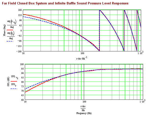

Several have mentioned the differences between the author's near field measurements and those taken in the SEAS anechoic chamber. It must be kept in mind that near field measurements, essentially measure volume velocity and a frequency independent scale factor is used to obtain the equivalent, usually, 1m or 2m response, into half space. A baffle step correction must be applied to obtain an accurate representation of the full space or full anechoic response. I doubt that the author applied baffle step correction to his measurement and therefore his would be a half space measurement as compared to the SEAS full space measurement.
I posted this on another forum:
"The near field measurement method was published by Don Keele in the AES and he graciously gives credit to Raymond J. Newman of Electro-Voice "for first making the observation that nearfield measurements correlated well with anechoic measurements.":
"Low-Frequency Loudspeaker Assessment by Nearfield Sound-Pressure Measurement" D. B. Keele JR.
He covers the theory and gives experimental data. In fact his figure 10 a. anechoic, shows baffle diffraction loss as compared to the nearfield measurement b. in support of my theory for why there is peaking in the nearfield response of baffle step compensated systems. His figure 10 also shows good agreement with half space far field measurements as I also stated."
Keele's papers:
http://www.dbkeele.com/papers.htm
It seems to me that the author decided not to give the design full baffle step compensation, probably to avoid excessive loss in sensitivity. This can be seen by the fact that the SEAS measured (anechoic) response droops by about 3 dB from 1 kHz down to 100 Hz. Then again, now looking I notice that the nearfield measurement of the woofer offered here:
http://www.diyaudio.com/forums/attachment.php?postid=734575&stamp=1128075761&
Shows a full 6 dB of baffle step and therefore something does not seem right. What the total anechoic measurement suggests is that the port is subtracting from the total system output around 100 Hz, and this is a problem with TLs, the port output is out of phase with the woofers over certain frequency bands. I believe that this is the reason for the droop around 100 Hz. I also believe that the author over stuffed the line which reduces deep bass output. I've mentioned this on other forums.
