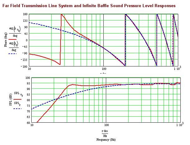

The Fat Thor with a downward firing port should rock the foundations. In MathCad, the response appears to droop a little -that's delibarate because the current version of the software doesn't account for the massive boost from the floor and vertical room-mode. One tweak however -go for a 4" x 4" port rather than the 3" x 4" one I originally suggested -I've been re-working it a little, trying to get the speaker to roll off (ha!) in lock-step with room-gain. Smooths things a little. If anyone finds they want a little more lower end (possible I suppose ;-) try using a higher resistance wire -Van Den Hul carbon if you want 'audiophile' stuff, 18AWG magnet wire or the ilk should do just fine.

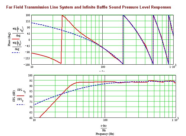

I've re-checked Short Thor too, just to be sure, as my original calculations were a little rough around the edges: this is the response of the cabinet as drawn by Dave (great stuff!). Doesn't go quite as low as Fat Thor, which will embarass some subs I can think of, but low enough, and it's somewhat smoother / more refined. More 'hifi' I suppose. Your choice!

"If anyone finds they want a little more lower end (possible I suppose ;-) try using a higher resistance wire -Van Den Hul carbon if you want 'audiophile' stuff, 18AWG magnet wire or the ilk should do just fine. "
So exactly what will adding a little resistance to the lowpass do? Smooth the response, extend the lowend cut off, steepen the rolloff?

Forget I mentioned the 4" x 4" port for the Fat Thor -mere blithering (I made a typo when entering the parameters and didn't notice -humble apologies. The original 3" wide x 4" long port still stands as probable optimum for this configuration)
Higher resistance wire = ye olde trick pulled by us full-range driver types. Raises the Qes a little, just enough to pull the bottom end into line -if you have a shallow rising response, or a gradual roll-off, it usually flattens it out. For example, I use 24 AWG magnet wire with a pair of Fostex FF165K drivers in one of my completed projects -a very large TQWT. Those cabinets will have a pair of FE166ES-Rs in them next weekend -with those, I'll probably shift even further to using 30AWG. Frankly, the difference will be marginal with the Fat Thor, as they don't start rolling off until below 40Hz anyway, so don't pay too much attention to it. Just a throw-away remark, so to speak. Something to experiment with in future if you feel so inclined, and a -8db point of 20Hz isn't quite good enough any more ;-)
By the way, you can chop the port of Short Thor down a little to 4". Makes the roll-off a little more uneven, but the general response is even flatter over 100Hz (you'll need to add 6db overall for the paralleled drivers to this graph -it doesn't take that into account like the one above)

Final tweaks before I bow out. If you find the response of Fat Thor too droopy (though the floor-mounted port should utterly eliminate that -I deliberately kept the anechoic droop because of this) then increase the area of Sm to 1.75Sd, decrease the length of the vent to 2" and increase its diameter to 5". Props it up a bit more, but retains a bit of a decrease to take the port position into account.
Short Thor is my favourite though. I wanted to tweak it fractionally: all it needed was another vent mod. 4" wide, 4" long. Best response from these drivers. F3 33Hz, one of the flattest responses I've ever seen from anything. It hardly needs any stuffing at all -at a pinch, you could do without completely. 0.5Lbs ft^3 is more than enough

All right: to those who ask, shall recieve. Gentlemen, I present, for your listening pleasure, the Small Thor (everything is relative you understand ;-) Straight, Mass Loaded Transmission Line.
48" line length.
So= 2Sd
Sm=2Sd
Tweeter centre: 36" from the base (so 12" from the top)
Port = 3" diameter x 4" long. 4" from the base. Can be front or rear mounted.
F3=39Hz. See response plot below. I like. In fact, frankly, I think these drivers work best in a straight, un-tapered line, mass-loaded. How I didn't hit on this combination before I don't know, because it works very well indeed, according to the sim, and I long ago learned to trust Martin's sheets.
