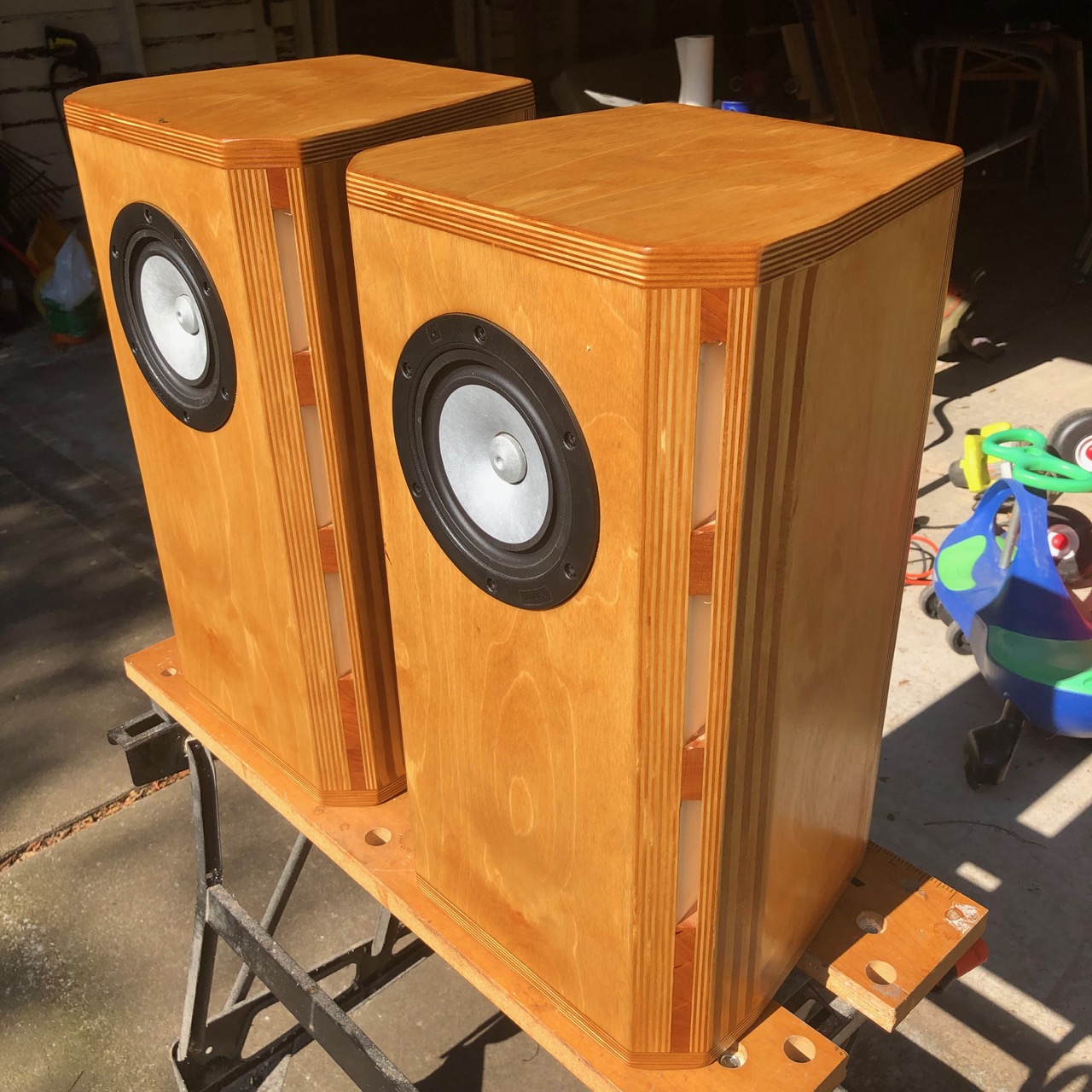

WOW! The modified Thor design (AKA Fat Thor) can really belt out the low notes. Amazing difference. They sound fuller with much deeper bass.
I still need to make some stuffing adjustments, but I think I will be staying with the Fat Thors.
Although my speaker placement is a little odd, the room can easily accomodate these speakers. They are not as imposing as I thought they would be.
Anybody wishing their Thors had a little more umph on the lower end should definetly look into building a Fat Thor pair.
I'm anxious to see what the measurements look like once someone with the necessary equipment builds a set.
Thanks to everyone who contributed to the design.

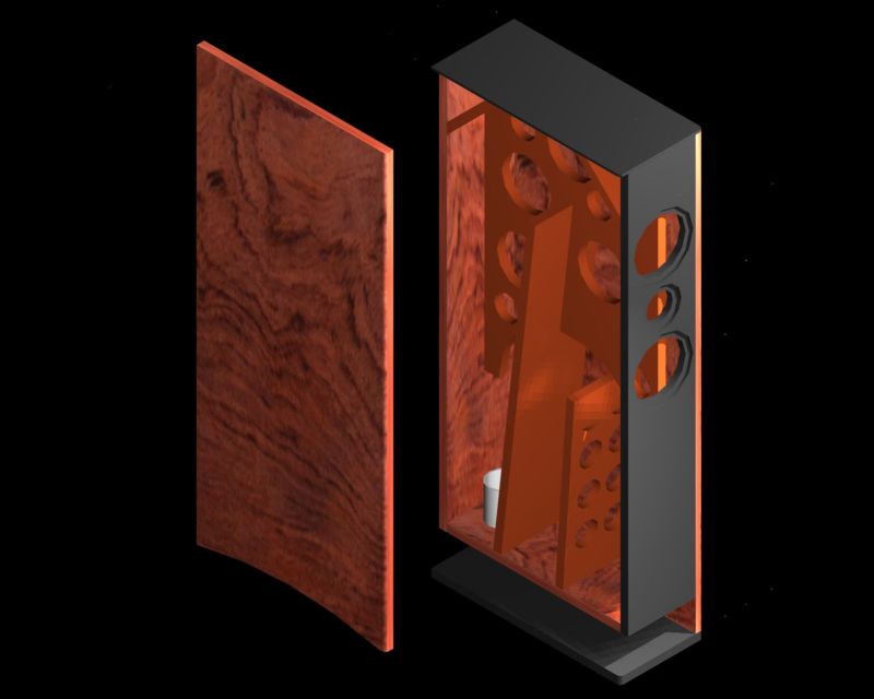

Hey Guys
Would a pedistal arrangement such as the one depicted be ok?
* Both Front & Back are open.
Would it be permissable to have just the back open?
One thing that I realised is that it would probably be easier to keep the front to back brace in one piece and then route a slot in the box divider for the line for the brace to fit into it.
Byrd said:Would a pedistal arrangement such as the one depicted be ok?
As long as the cavity is large enough it shouldn't be a problem. If it isn't you might get some resonances that may be problematic (1/2 wave with both ends open, 1/4 wave with only 1. If you are going to close off the front, it might be an idea to also put a partition just in front of the port to make the cavity length quite small.
