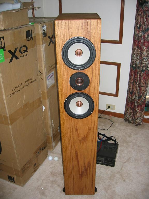

kramster said:Just finished the TALL version.......... 49.75 tall, 12.75 deep 9 inches wide.......... per PLANT10's GREAT plans!!!!
