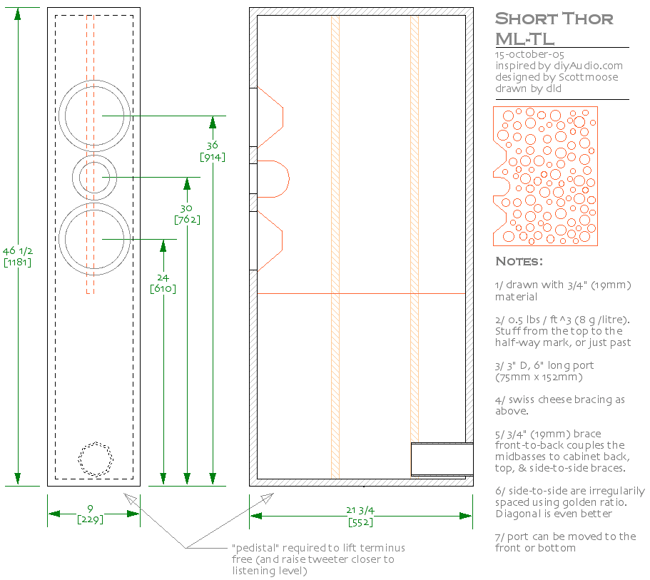

Dowling will help. But these things have got big panels, and should hit some pretty serious LF; ~23Hz would you believe? Nor will SPL be a problem, methinks. The bracing Dave has drawn is heartily encouraged. Bit of a pain to make -not overly difficult, just time consuming. But it'll kill panel resonance stone-dead, and brace the drivers too. Worth it in the long run.
jackinnj said:ever considered dowling instead of swiss cheese?
dowling -- unless you put one every couple inches or so, is actually not all too effective.
dave

ok, Wide Thor -- I had to make the cabinet a bit shorter -- so it's 1 metre (39.37"), and 30cm wide -- but haven't yet taken into account the volume displaced by the swiss cheese. A little bit squigglier than yours. The cabinets are only partly assembled.
I'd call that a good response myself. The room will cause more squiggles than the cabinet will. Best not too near a wall though... 😉

if i were to make the cabinet isoceles-trapezoid-like, (to bevel the front) keeping the same line length (39 or 40 inches), and same top and bottom surface area -- can I assume that the area of the rectangle is just transformed from the area of the trapezus? -- i.e. line length is constant and cabinet volume is constant.

jackinnj said:if i were to make the cabinet isoceles-trapezoid-like, (to bevel the front) keeping the same line length (39 or 40 inches), and same top and bottom surface area -- can I assume that the area of the rectangle is just transformed from the area of the trapezus? -- i.e. line length is constant and cabinet volume is constant.
Yes. The volume on any prism is the area of a cross-section x the height .
