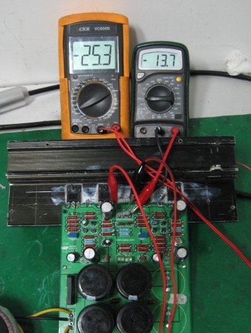

I did citation 12 mos fet last week too,the sound quite good .each channel is handed with 2 IRFP240, but till now there are two
problems troubling me.
Firstly, when the voltage is large (eg: V=+-45V I=100mA), the IRFP240 is very easy destroyed.
Secondly, when the current is large (eg: V=+-35V I=1A), the IRFP240 is very easy destroyed too.
But it can work very good when the voltage is +-35V and the current is 100mA.
I had noticed the turn-on thump of C12, but is this the reason who destroyed the IRFP240?
Who can give me a favor about the explanation of this case.
Thank a lot!

The voltage isn't too high for the devices, but perhaps your
bias is running high, and possibly you are seeing oscillation.
Can you monitor the bias currents?

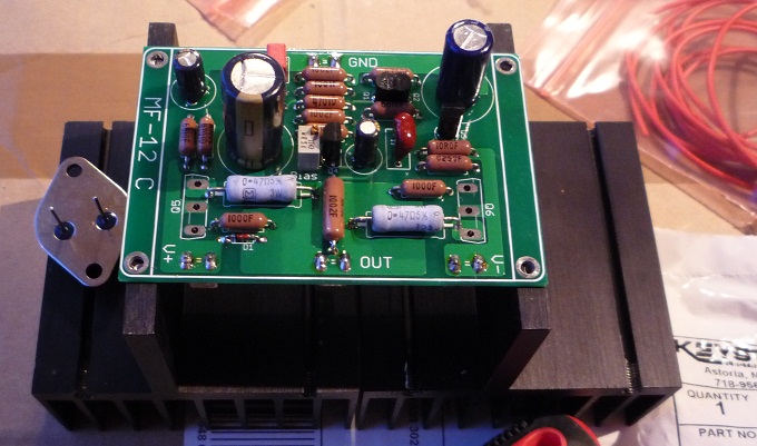

Would you mind posting a photo of the completed amp? I always worry buying a board of eBay, there may be mistakes in the board..

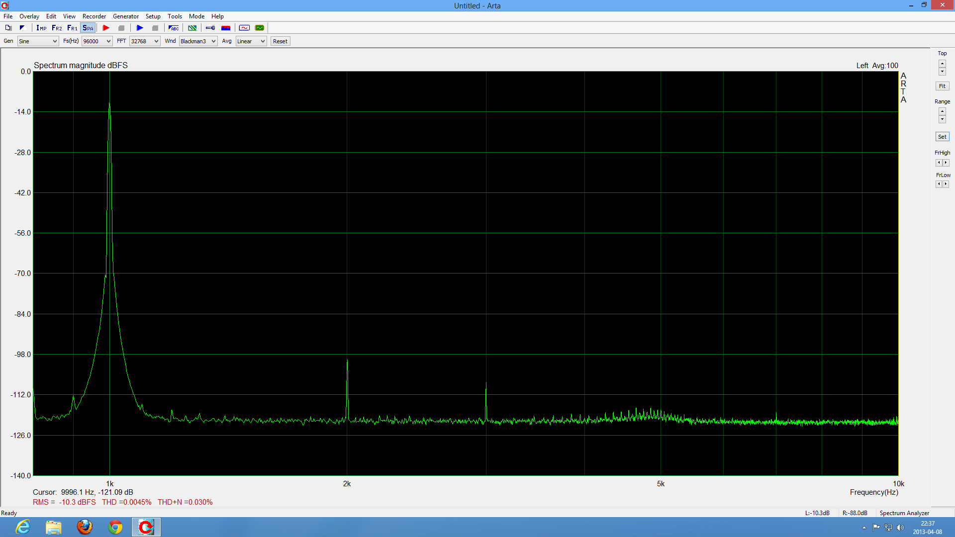

Those numbers are better than awesome! Great job. Thanks for sharing those pictures. A masterpiece and revival of a classic design.
