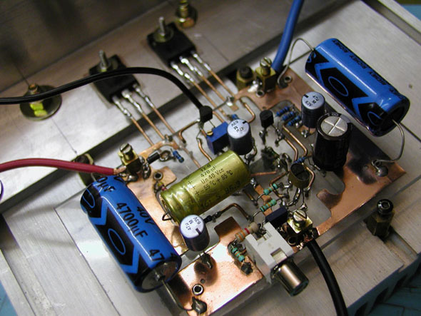

100 mA or so. Best procedure is to bias using distortion analyzer. Lacking
that, run the heat sinks at the 10 second rule.
