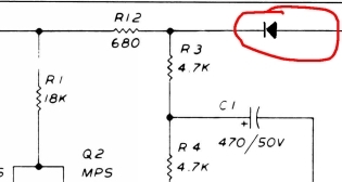

Where did you get your stylish heatsinks? homeade? because I think they look really neat.
I am thinking about using a torodial, dual winding transformer on this, does this sound like what most people do?
Okay, this question I am trying to answer myself with my tube knowledge, but I think I may have it wrong. in [triode] tubes, the bias current is equal to the current being drawn by the plate(the anode). so in a solid state amp, the bias current is equal to the current being drawn by the collector? so this Bias pot should be just a trim pot right? no high wattage nessicary?
also, looking over the schematic, i noticed that the circle Q4 (an MPS-L01) is half-hashed, half solid. Q4 is right next to the bias pot
On the caps, should I try to go black gate on them? or will it cost too much for little return?
Finally, what are the values of C7, and R20? they are directly connected from the output to the ground

to be precise I'll describe quickly the schematic from my memory:
input is made of a differential(of PNP devices BC416C in my case)
then there's a driver BC 414C(in my case) and you also got the Vbe multiplier,a bias temperature compensation part that is a BC414C(still in my case)
to finish you have a pair of IRFP 9240/240 as final drivers(only in the complementary version)
now for clear chart and refering to Nelson's complementary version, here is the combo that can be done:
MPS L51: BC 416C (PNP)
MPS L01: BC 414C(NPN)
and if you can't get them I'll suggest BC 560C/550C(sorry at 1oclock past midnight ) ican'tremember which is the npn and pnp

Hello
About that fet Citation 12 , how about using a diode on positive rail betwen R3 and the output mosfet, to isolate Q3 and the input pair transistors from heavy current demand wen the amp work in high power output ?
Thank
Gaetan
Thank
Gaetan
