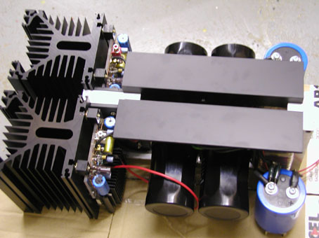

actually concerning the boards it's quite easy, i took plastic plates drilled them, then incerted electrician wire(copper) and cut some copper sheets to get the ground plan...
all the components are soldered directly on that...
looks like an easy way to replace components and quite nice as you can use a diode to lignt the plastic plate...will try to finish this amp and see about that😎

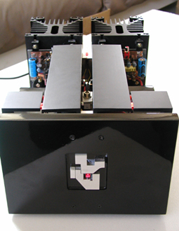

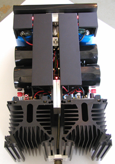

Hi all,
I am happy I managed to findsome time to finish correctly the whole box for the amp, here it is at least completely finished (with soft start circuit +dc velleman kit)
I included some picts ...
just for info it's now +/-24V rails and 1.2A bias
and I get 10Veff max that is about 10Watts if I measured correctly...
Cheers
Vince😕

Vince/Mr Gymtonic,
smashing design, sort of Mark Levinson/Duc. Monster combo.
I envy your industrial design skills, can you give some mechanical details ,please.
You are not expecting a dust problem ?
ps: i'm going to steal some of your design/constructional ideas.
