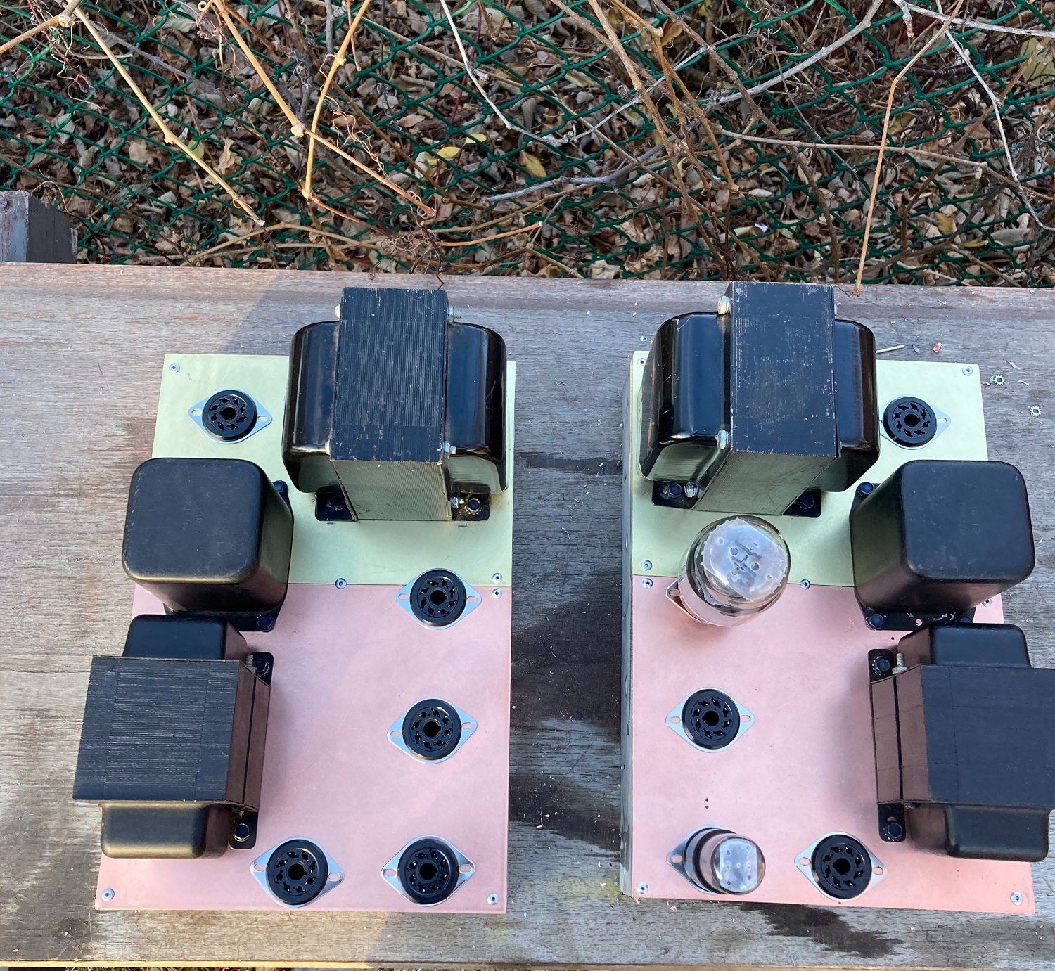

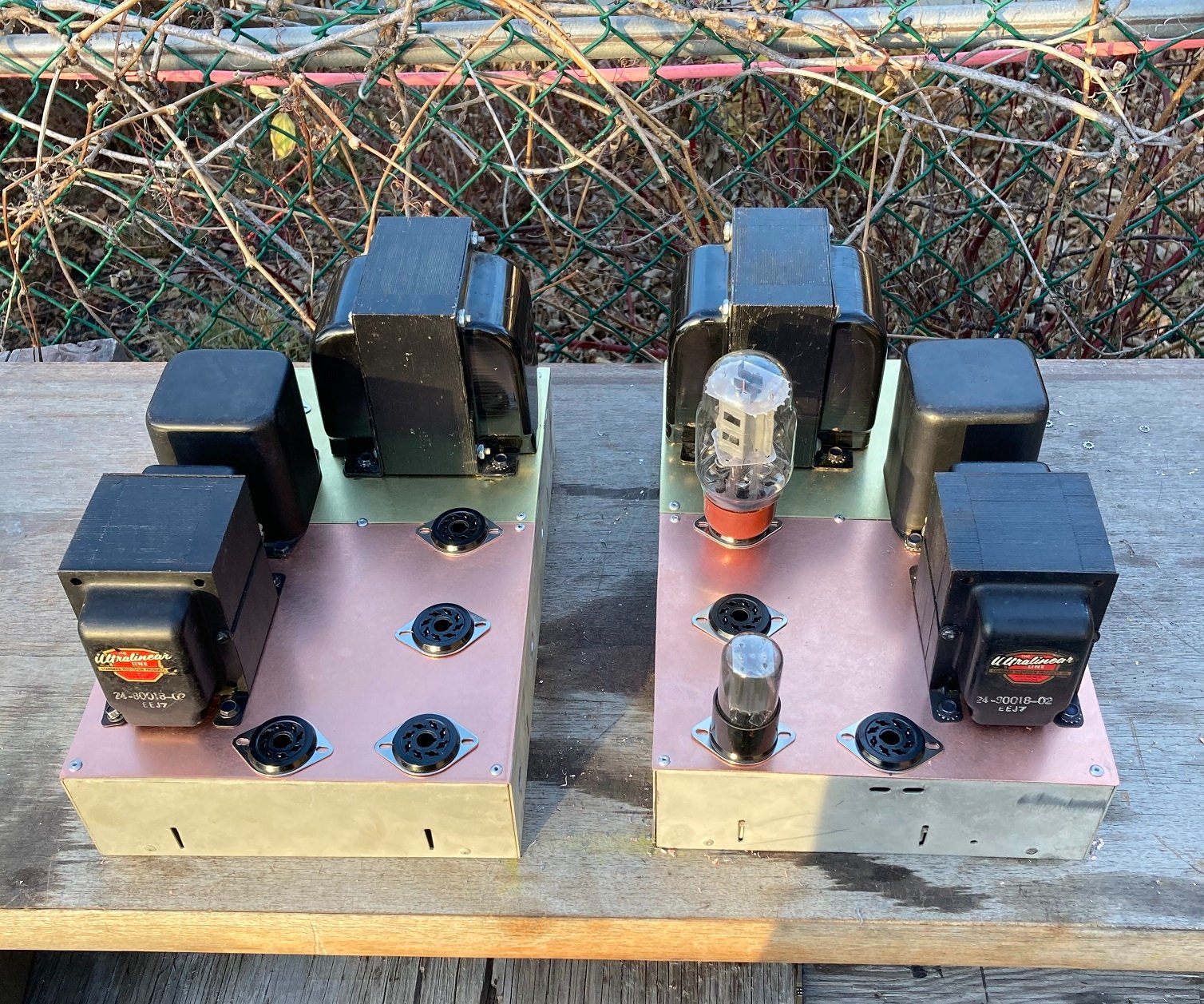

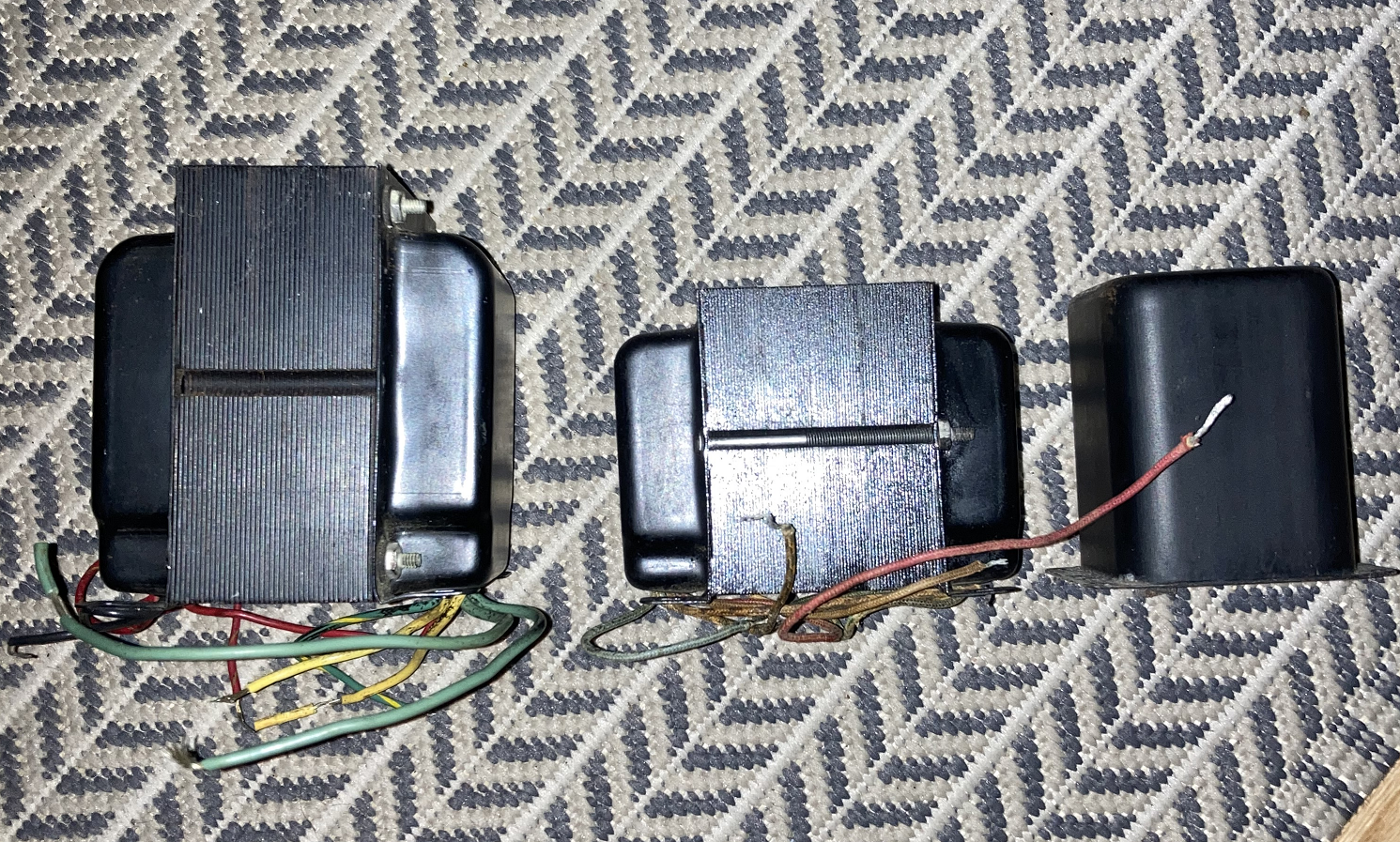

LOL so I just getting to this build now!!! I now have 2 800vct power transformers. The electrohome schematic calls for a 5v4g so I guess I'll go with that
Even though the tube sheet says normal is 10uf and 4uf is better. I'm putting these amps in pretty small chassis but I think they will work ok. I harvested two old electrohome 72 6v6 PP radios that i took the iron out of and built 2 supro amps using 5cz5 power tubes. Anyway With some thought these chassis should work fine. I', taking grover's advice and omitting the second choke.

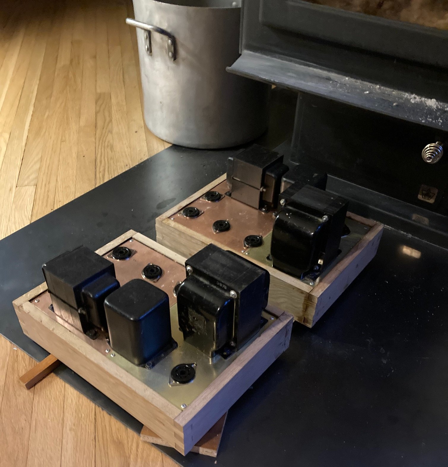

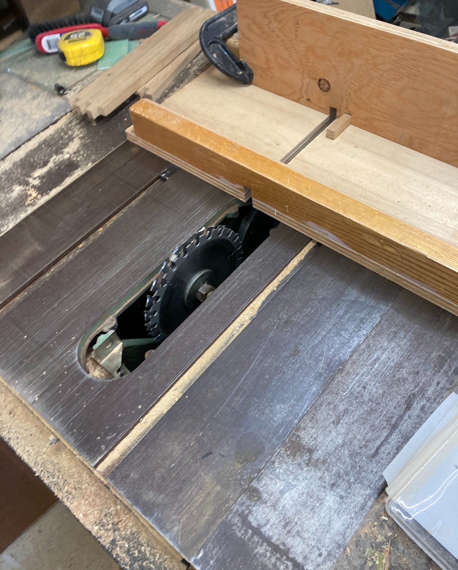

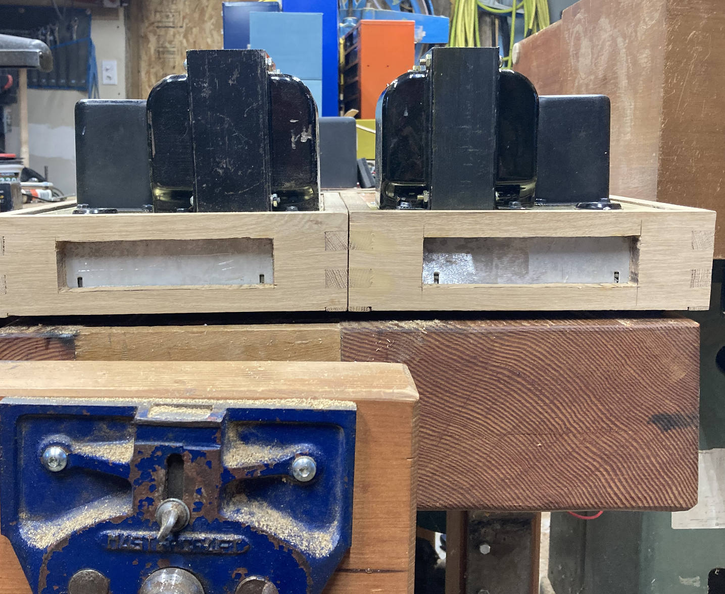

Started the day watching youtube, on how to make a box finger joint jig.
Too many were too involved. I ended up just making a quick and dirty little sled, attached to my miter gauge from some scrap pieces.Note the missing saw insert LOL! Worked ok, but I'll need to take the belt sander to the sides to smooth the joinery. Trim is white oak cut back in 2001 on my fathers property.
I used clear construction adhesive but will put some screws through the chassis into the wood later. Put them in front of the wood stove to help dry the glue.

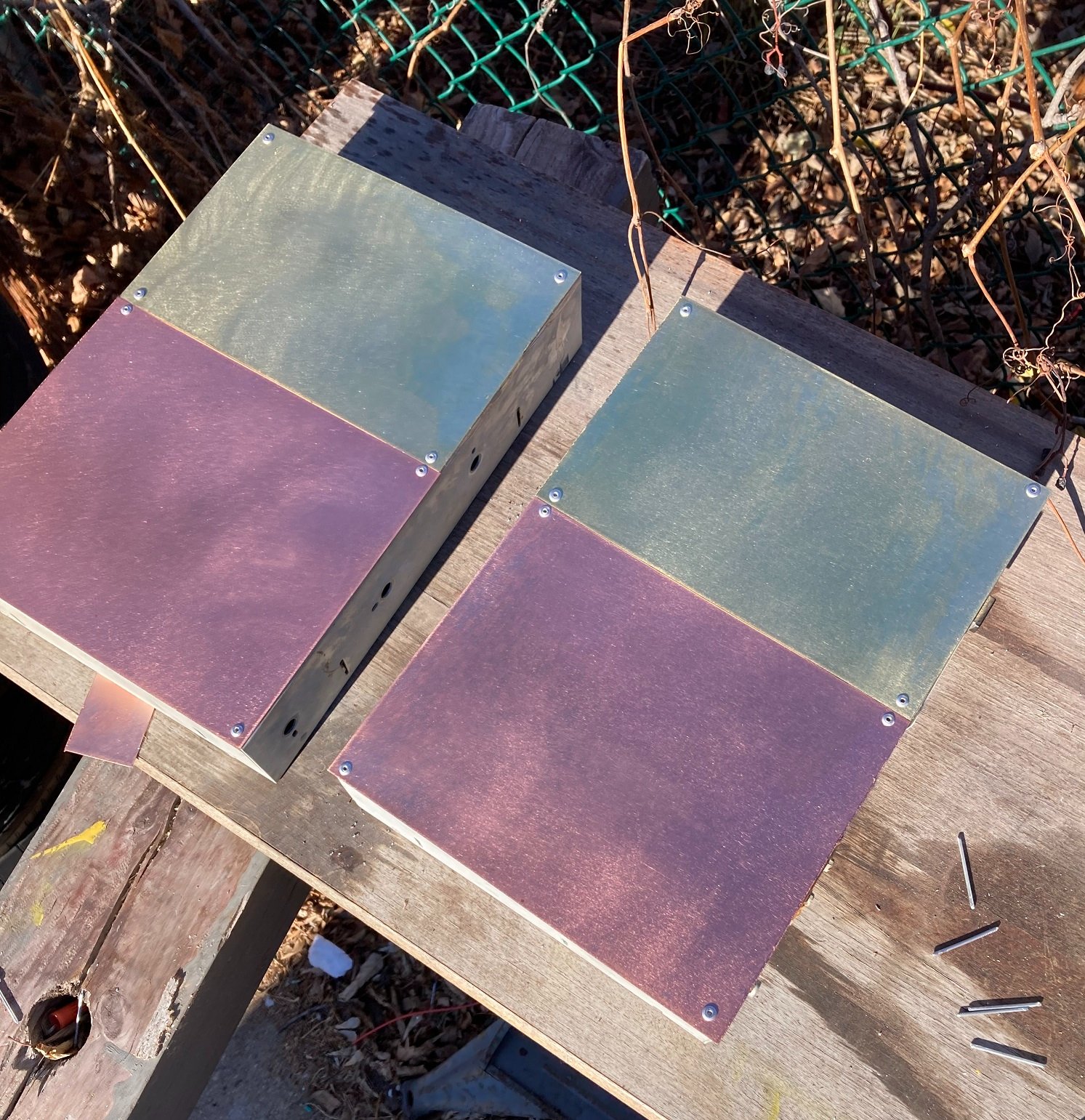

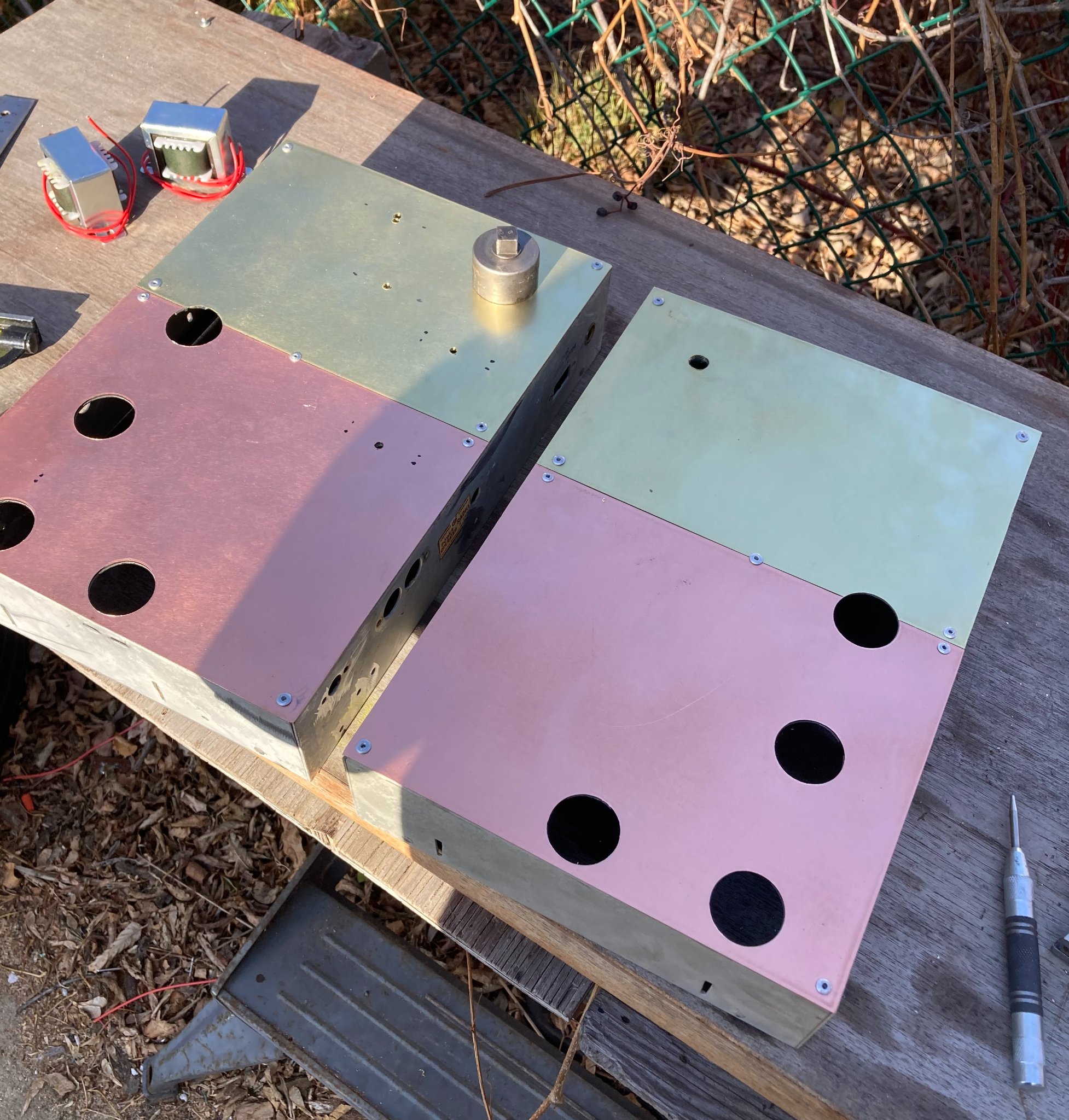

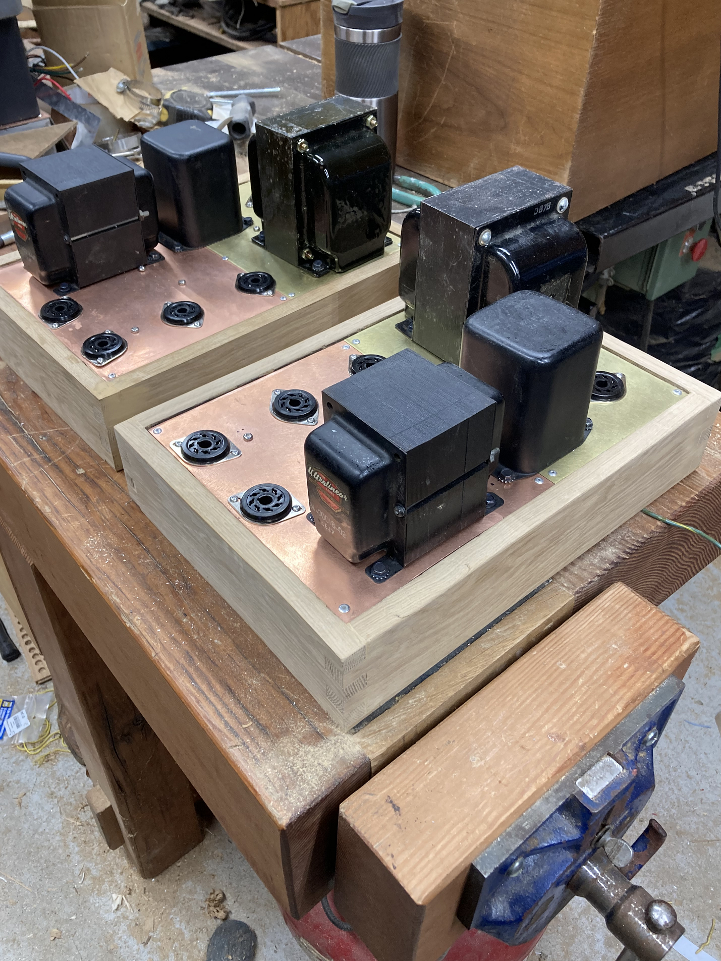

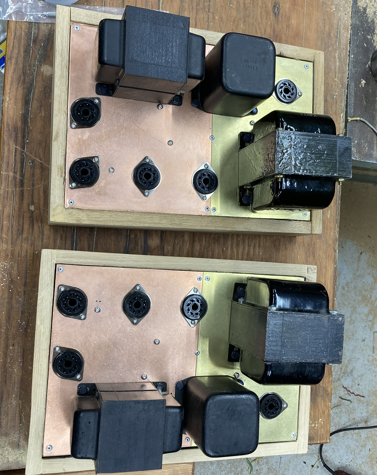

Nice mild day on the Canadian prairies today. Fired up the wood stove this morning in the workshop and got a bit done today.
Still have some mechanical stuff to do and may router out the back, down shy of the steel and do the access that way, or a series of holes
with the hole saw for the ac, speakers, fuse input etc.. I have a 5" x 12" x 1inch thick piece of Jatoba wood that I thought I use to
make medium size volume knob on the front of each. Hopefully I can get back to these soon!

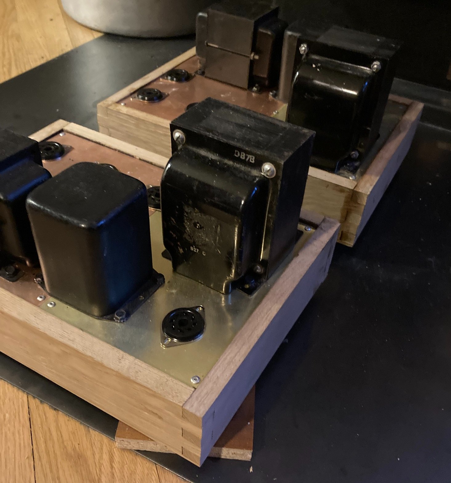

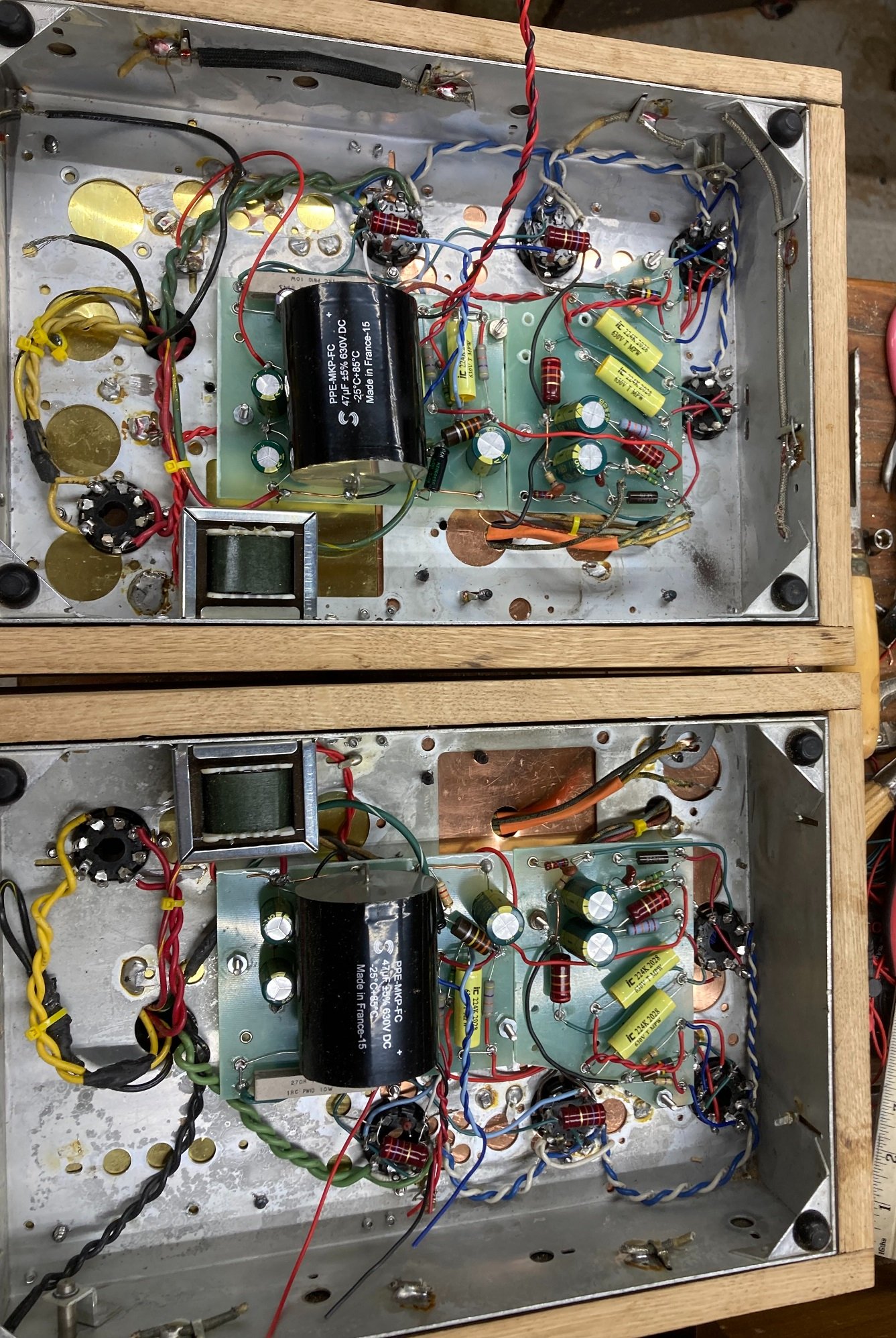

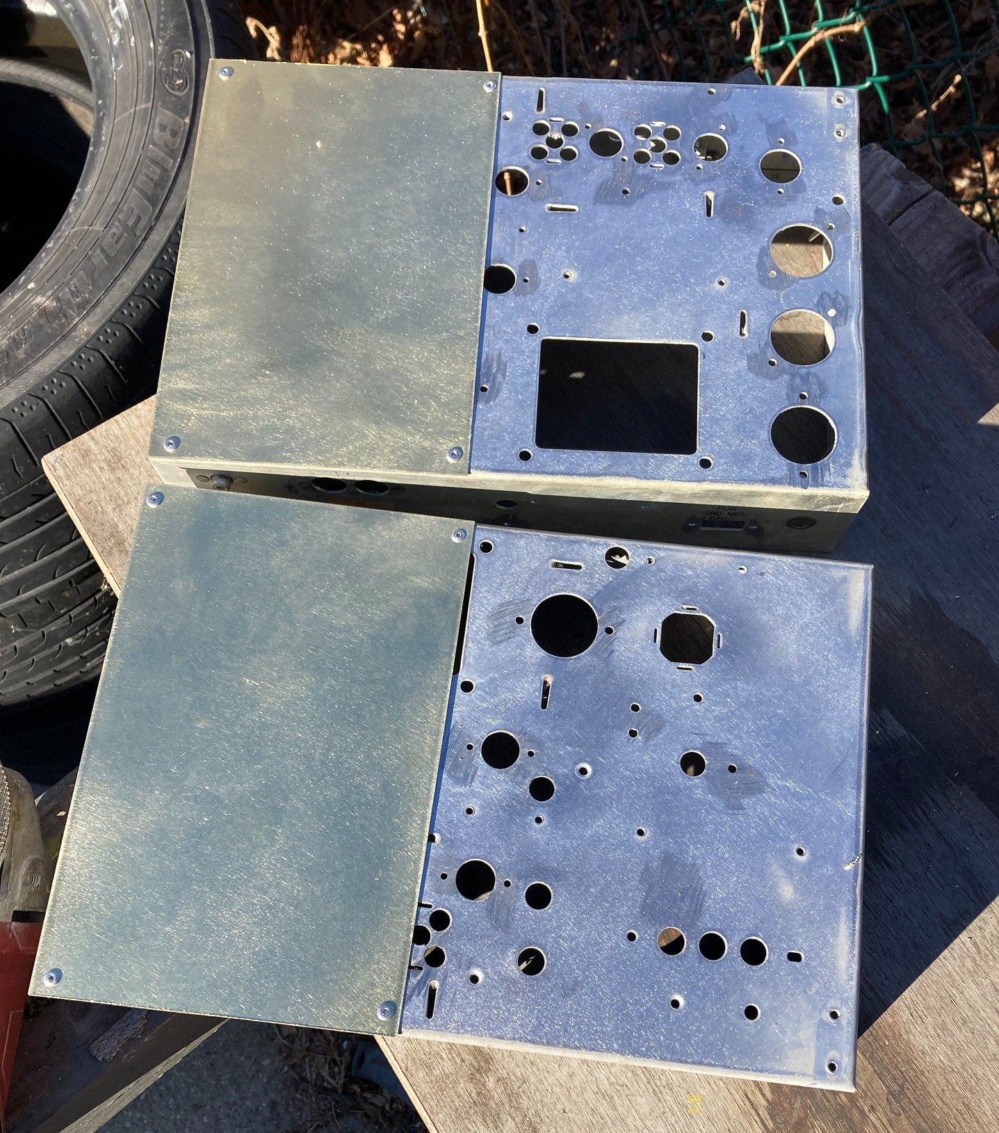

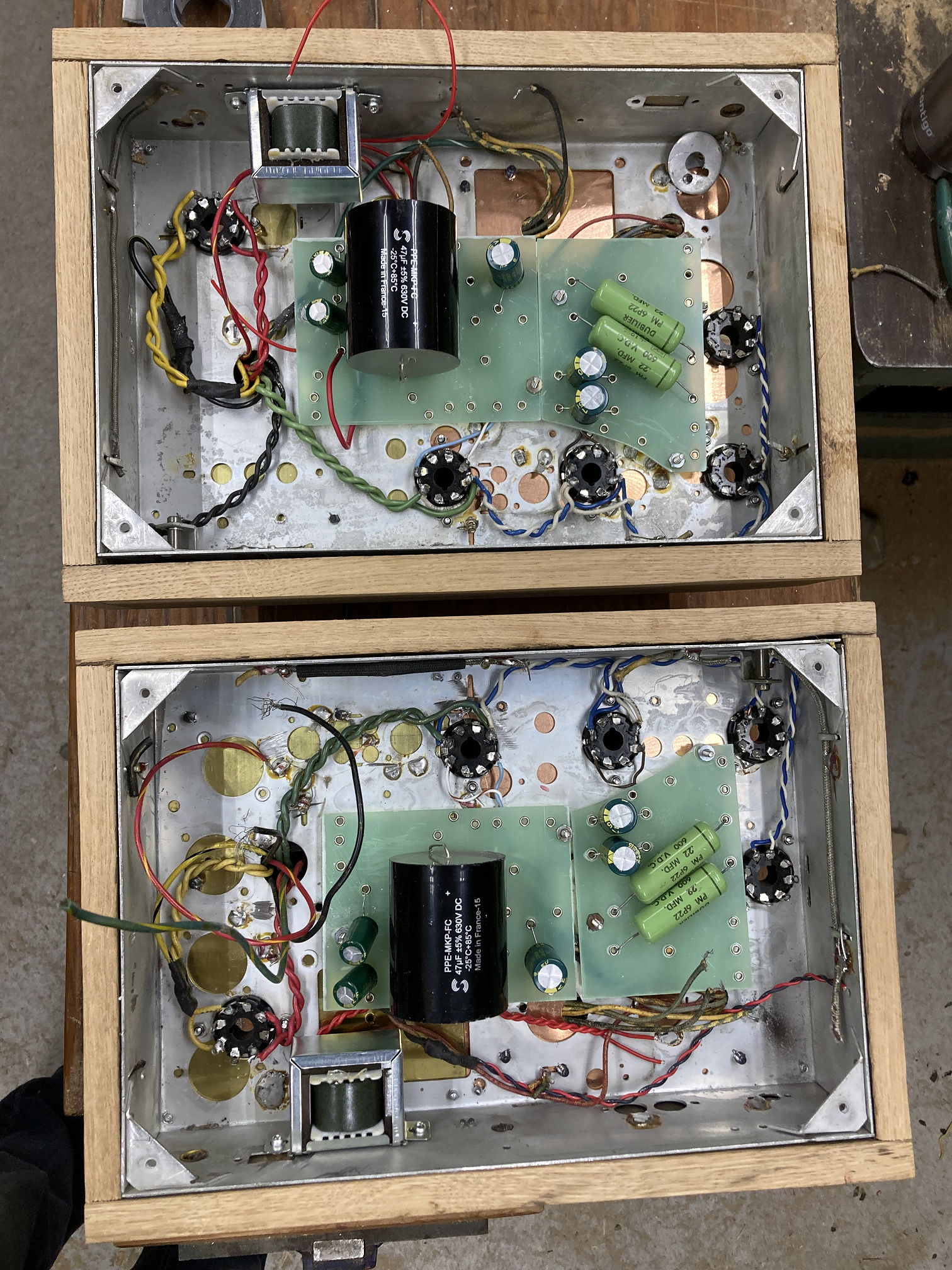

A little more progress. Cut the back access fpr speaker, rca. power and fuse. I know that the logical way would have been to cut that BEFORE
I attached it the the chassis LOL
