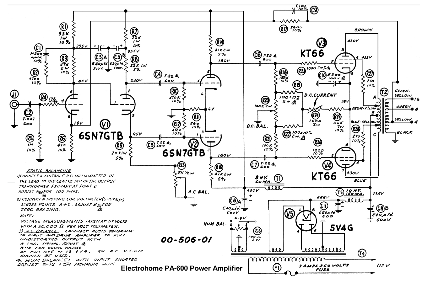

I will. Give me a bit...@THD+N , Maybe you could post the simulation of a 272jx running two channels of the Electrohome Williamson circuit ? 🙂
After simulation, with the Hammond 272JX, your B+ voltage after the first choke will be 352VDC. A bit low for the amp you want to use it for.
I always use a 1.6X multiplier for my power amp power tranformers for B+ current. For example, if the amp design calls for 250mA at rated power, I will use at least 400mA transformer design.
An Edcor power transformer such as the XPWR117 would be perfect. You can use the 12VAC for the tubes... wire the output tubes in series and use 12SN7GT's instead of 6SN7GT's or wire the 6SN7GT in series to separate from the output tubes.
I just used the XPWR117 for an Eico HF-87 clone build and it worked out perfectly with SS rectification. With the XPWR117, you have to use a bridge rectifier topology.

If you do decide to build a Williamson type amp, and it is a close replica of the original circuit, be sure to apply Talbot Wrights modifications to the amp. They are worth while improvements.

The biggest issue with building these types of amps is stability (feedback). Each brand and type of output transformer will require a different capacitor in the feedback network. The Williamson has two main feedback networks, a lag network across the anode resistor in the first stage and a lead network from the 16 ohm tap back to the cathode of the first stage. You can't really guess what the cap values might be.
At the minimum, you will need a scope and signal generator (with square wave option) in able to get the square resonse as good as you can with whatever output transformers you have slected.
If you don't have or can't get this equipment, it is best to follow a circuit somebody else has already tweaked with the same output transformers.

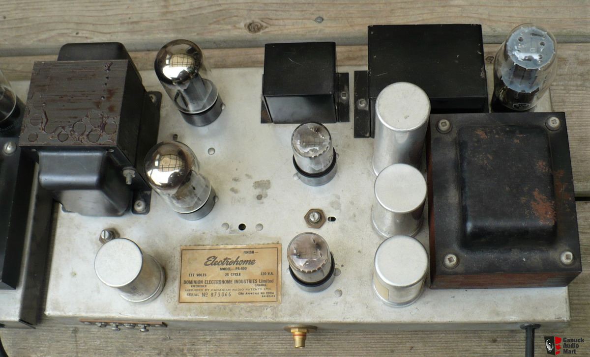

Thanks THD, I was going to follow the Electrohome pa-600 schematic. I have the outputs only from the pictured amp. I do have a scope but I have not really learned how to use it yet. I get on it sooner or later!

I tried the Talbot Wright mods some time ago and I wasn't very pleased with what they did to the sound of my Williamsons. It's quite a different amp, really. Personally I would stick with the Electrohome circuit, but you can always try them. In either case, you should build the original circuit before you try any mods, so you have a basis for comparison.
I think that is good advice grover.. I will likely build it on eyelet boards so changing values is easy.
I admit, my hearing may not be as acute as yours. I still have good high frequency extension in my hearing, but it seems phase and other anomalies get lost on my ears. People who swear they can hear a difference in something, I cannot hear.I tried the Talbot Wright mods some time ago and I wasn't very pleased with what they did to the sound of my Williamsons. It's quite a different amp, really. Personally I would stick with the Electrohome circuit, but you can always try them. In either case, you should build the original circuit before you try any mods, so you have a basis for comparison.
I didn't notice anything (too) audible in the TW mods, but the specs did improve.
I concur, try the PA-600 as-is, then begin modifications if you see fit.
When I built my pair of Williamson mono amps, i did way with the DC current and DC balance and just used a 350 ohm power resistor. It biases up fine and has the correct voltage as indicated on the schematic.
