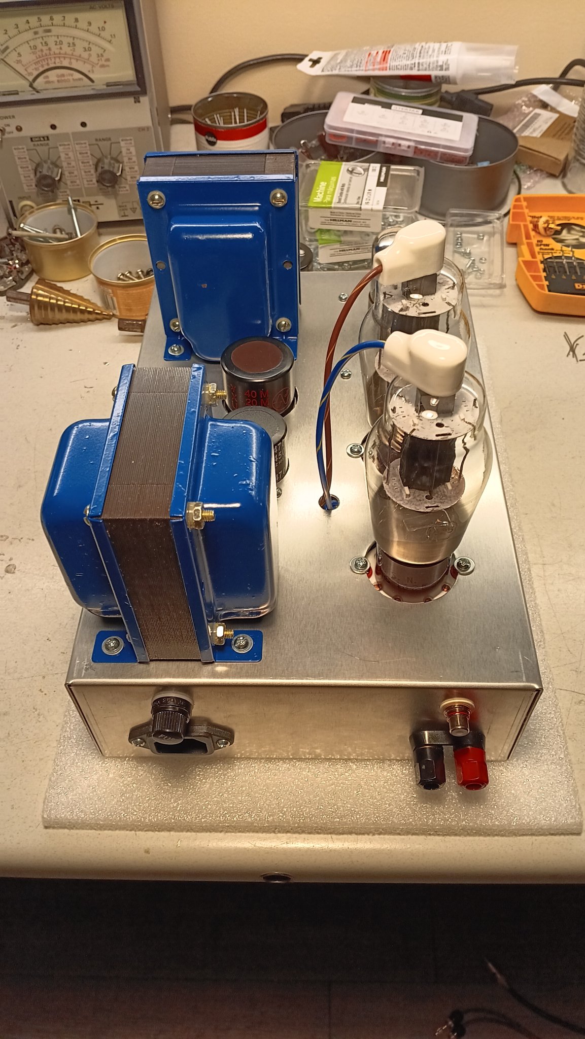

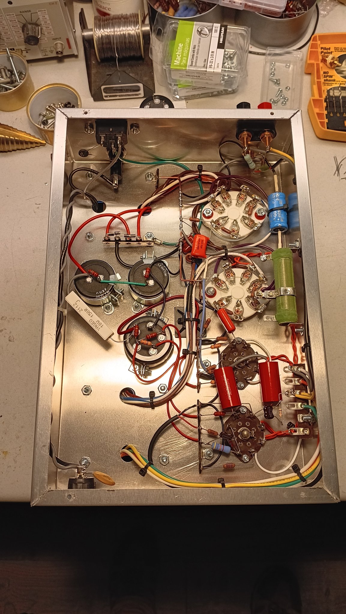

Nice work as always THD+N. I have always enjoyed your postings on Audio karma.Under the hood. Not a work of art like I have done before, but neat and easily serviceable.

Hi THD+N, These are taking me a long time to finish! I'm working on them this weekend. Question about how to implement both elevated heaters and humdinger use in the original schematic. I have a center tap on the heater winding. I usually dont use a humdinger. I'm not 100 percent clear how to best connect these. Would both the tap and the wiper connect to the divider? Thanks in advance.
You shouldn't need a hum pot, really. I've never used one. To elevate the heaters, connect the center tap to the "top" of the output tubes' cathode resistor. That will raise them about 40 volts.
There are various ways to "terminate" the heater circuit with a center tap...
- Simply ground the center tap.
- Place the center tap at the node of the cathode/resistor.
- Use a humdinger pot.
I have even eliminated the cathode pot and I am only using a single 325r/25W wire-wound resistor. Performance and THD numbers are spot on.
I even swapped in & out 10 pairs of output tubes to see if there was much deviation with not having an adjustment in the output tube cathode circuit and test results between pairs was nominal.
