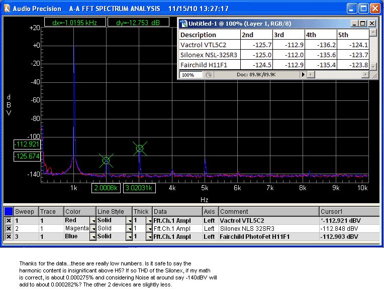

Yes, if distortion is low enough then it can probably be ignored. How low is low enough is something which people will argue about for ever.
Type of distortion matters too. If both amplifiers have similar total harmonic distortion value, they may differ in ratio of upper harmics, and in the end will sound different. Amp with higher distortion may not necassary sound inferior, if the distortion is primarily second harmonic with little odd harmonics. Amp with lower distortion may subjectively sound worse if it contains lots of odd harmonics, 7th, 9th...
What is the lowest distortion you can hear?Yes, if distortion is low enough then it can probably be ignored. How low is low enough is something which people will argue about for ever.
Which are meaning-less, thats if you have heard a H11F1M vs a NSL32SR3
You would basically reject the H11F1M from any comparison, as its dreadful with audio, which infers to me who-ever provided stated measurements did not know what they were doing at all.
