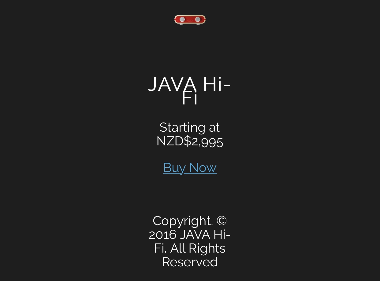

The price is NOT $3000 as you state.
My StereoCoffee cost me $150. Now they have a totally new power/control power supply and have increased to $250 NOT $3000.
You can get one on eBay, that's where I bought mine.
Shop — Java Hi-Fi
Appears stereo coffee has spun into java hifi.
I think you’re referring to the stereo coffee kit.
Presumably same internals, nicer box.
Shop — Java Hi-Fi

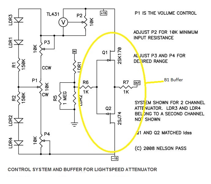

Thanks for that, and here is the version Nelson Pass kindly designed for the Lightspeed to drive lower impedance (10kohm) poweramps of his that some of my customers were using.
It would be interesting for a non biased person to see how close the Coffee version is to Nelson Pass's version if you omit the yellow circled B1 buffer stage and stacked? LDR's, because Nelson copy protects everything he does.
Cheers George
