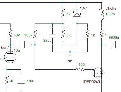

Hi Kashmire. Think of the output stage as being like a linear voltage regulator with two loads in parallel - the choke and the speaker. In your cct they are in parallel AC-wise provided you have a perfect power supply. When there is some ripple on the supply the choke will be fed quiet DC but the other end of the speaker will get fed hum, so it will hum. I like the idea of puting the speaker across the choke. Then, if you still need a coupling capacitor it need only be a very low voltage one, but truly gigantic capacitance if you want. 😉
My preference is to have everything "earthed" at the one rail - input connector, tube cathode cct, bias zener, choke, and speaker.
Edit: The speaker will get fed hum if it is "earthed" to the opposite rail to that which the bias zener is "earthed", whether earth be positive or negative.

Fuling: the bias circuit you posted is much closer to how this circuit would be actually implemented. I’ve changed the simulation to a more realistic circuit below.
Circle: you are correct about the noise problem – except you didn’t take the input stage into consideration. The output stage by itself conducts power supply noise to the load with unity gain (1 volt power supply noise results in 1 volt loudspeaker noise). However, when connected to the input stage, the conducted noise drops down by a factor of 10 or more (actually, more like 50). I’d probably be happy with this performance. Since the tube input stage is inverting, power supply noise could be intentionally injected into the signal, applying anti-noise into the system.
If that doesn’t make you comfortable enough, I’ve added in a 220uF capacitor in the gate bias circuit, which drops noise down even more. This capacitor is technically not in the signal path – it is separated by the 100k resistor – but it does affect noise performance.
Why am I going through this much trouble? Because if the load is connected across the choke, any output at the load will cause an equal ripple on the power supply. To deliver +/-2A at the load, the power supply would see 2A continuous with a +/-2A ripple (4A peak). With such large ripple currents, massive power supply capacitors would be required. In addition, that means the power supply capacitors are part of the signal path (the AC current through the loudspeaker must also flow through the power supply capacitors). By placing the load across the active device (MOSFET), the power supply current is continuous 2A, thereby allowing usage of power supply techniques that are happy with steady-state current loads (such as active capacitor multipliers).

Hrm... It seems people spend a lot of time trying to get extremely clean regulated power supplies. Last semester we spent the whole time learning about frequency responses of LTIC and other LRC circuits, but I'm not sure how to apply those techniques to something which has a variable load and such. Does anyone know of any good books I could check out of the library to learn more about these sorts of circuits? I'm just a poor student, so I can't actually build many different designs, but I'd still like to learn a thing or two. I basically understand the basic underpinnings of the various schematics I've seen around but it would be nice to get a more solid understanding.

The 1 Ohm resistor represents the DCR of the choke. I used 1 Ohm for simulation purposes. The real choke may have a different DCR (hopefully lower).
