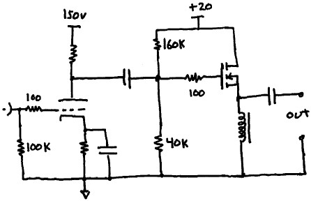

Here’s a choke-loaded follower Zen with a tube driver – no interstage transformer this time.
This circuit lets each part perform their best function: the tube is a voltage device, therefore, the tube performs voltage gain. The MOSFET is a current device, therefore, the MOSFET performs current gain.
I’ve shown some grid-stopper (or gate-stopper) resistors. There may be a few parts missing, such as a gate protection zener diode.
Now here’s the time for me to look like a real noob:
- Since the MOSFET is working in follower configuration, all of the voltage gain must be performed by the tube. How much voltage gain is needed to drive the gate? An IFRP240 has a transconductance of 6.9, so only about 2 or 3V peak-to-peak are needed at the gate? The choice of the triode will be dependant on the amount of voltage gain required.
- What’s the input impedance at the gate? A better question (showing how long it has been since I’ve worked with FETs), how is this calculated?
- The gate will probably have about 1000pF capacitance, so the driver stage should be about 1k output impedance to maintain 100kHz. Better look at those triode specs...
I’ve got everything to build this amp except for the choke. I plan on winding one this week.

That 1000pF is not the problem you might think. Just suppose the gate goes up by +10v and the source follows it by going up +9.8V. The gate-source voltage has only increased by 0.2v and it is *this* tiny voltage that pumps the gate-source capacitance, not the full 10v.Kashmire said:- The gate will probably have about 1000pF capacitance, so the driver stage should be about 1k output impedance to maintain 100kHz.
But wait, theres' more!
A 20v supply will pull +2.5 amps peak into 8 ohms. Therefore, bias the fet at 2.5 amps so the choke will be able to swing the speaker down to -20v as well. That shoud be ok for 25 watts into 8 ohms, in theory. The follower has a gain of 1 of course, so it needs 50v p/p drive on the gate.

The bias circuit needs some work.

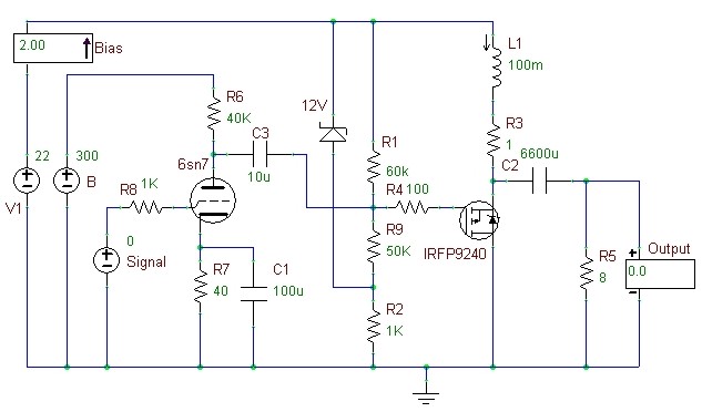

Here’s a choke-loaded source follower n-channel MOSFET amp.
This particular design focuses on using the best attributes of each active component. The MOSFET’s best attribute is controlling current, and the tube’s best attribute is controlling voltage. In addition, local feedback is maximized.
Therefore, the MOSFET is configured in source follower, which does not have any voltage gain. In this mode, the gate drive is severe (the gate voltage must be equal to output voltage), but the effect of gate capacitance is greatly reduced. All of the MOSFET’s transconductance is used in local feedback, which results in the unity gain.
The MOSFET is loaded with a choke, resulting in relatively high operating efficiency and allowing for power supplies down to 20V. The gate is tuned for 2A bias current. A zener diode stabilizes the gate bias, keeping the bias current immune to power supply variations. No filtering capacitors are shown, but the zener should be heavily filtered. Other required components not shown include a gate protection diode to protect against spikes over +20V at the gate. (Note: this circuit may also need a DC servo loop to further stabilize the gate bias)
The tube is employed for voltage gain. This simulation uses the 6sn7 using a 40k plate resistor at 300 volts (my prototype will use the 6c45pi). The triode tube uses the purest form of local feedback, the plate feedback, which is part of the natural operation of the tube.
This stage has a gain of 10, when combined with the unity-gain MOSFET output stage, 1 volt of signal will result in 10 volts of output.

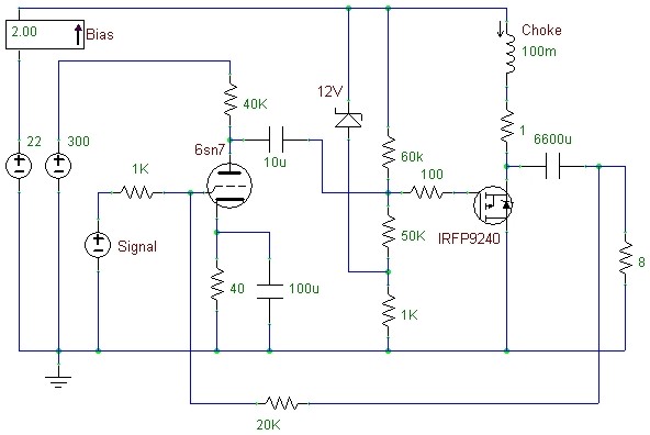

I’m a bit unhappy with the n-channel amplifier shown in the previous post. The load is attached across the active device (the MOSFET), which means the load is referenced to the positive power supply rail. I’d prefer the load to be referenced to ground.
Therefore, a p-channel design. Note the gate stabilizing zener is now referenced to the positive power supply rail instead of ground. Why is referencing to ground so magical? Read on …

This is why ground-referencing the load was so interesting: A global feedback loop has been added. This particular schematic uses a 1k input resistor and a 20k feedback resistor. The amplifier loses some gain (1 volt input results in 8 volts output instead of 10 volts output) but distortion is reduced.
Some things are missing in the simulation that I would use in “real life”: a small capacitor (pF) across the feedback resistor to trim high frequency response, heavy filtering of the gate bias zener diode, and an active current source for the tube instead of the 40k plate resistor. I haven’t shown the power supply, either. Also not shown is a DC servo loop to further stabilize the MOSFET gain bias.
I'll update the simulation with the 6c45pi model later. The 6sn7 should be beefy enough to drive just about any MOSFET in source follower configuration, but the 6c45pi is a more powerful driver with higher gain. With the 6c45pi, this amp will be very easy to drive, and the extra gain (30) can be used to experiment with feedback.
So do you actually know what feedback sound like? Build this amp and find out. The feedback can be adjusted from gross (5k feedback resistor) to negligible (1M feedback resistor). At the end of the day, I can tell you what feedback “sounds like.” I’ll report when I get my chokes …
