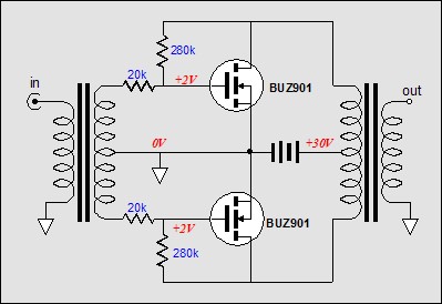

I just read something interesting at John Broskie´s site:
"This amplifier, unlike the previous MOSFET amplifiers, must be run in strict class-A, so the idle current will be quite high, at half of the peak current demand. How do we find the peak current demand? This amplifier is effectively the equivalent to a normal source follower amplifier with +/- voltage rails twice that of this amplifier’s single rail; the magic of inductors. In this case, we can assume that 12 of the power supply’s 15 volts will be deliverable into an 8W load, so 24 volts of peak voltage would require 3A of peak current (as one terminal goes up the other goes down). Thus, an idle current of 3A is needed (24V / 8W), 1.5A per MOSFET."
This seems to indicate the difference between push pull and balanced SE operation: Since I´m going to use separate , airgapped chokes for each "leg" of the amplifier I´ll need twice the bias current, 3A per mosfet instead of 1,5A if a centertapped choke is used.
Do I make any sense here? Maybe I should wind myself a pair of CT chokes... But on the other hand, I love SE amps

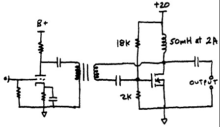

Here’s a schematic … I have some 5965 and 7788 tubes here with an LL1660S/18mA interstage transformer. I’m planning on building a tube amp with these parts in March. I don’t have my output transformer yet, so these things are laying around unused …
Don’t focus on the driver stage. I’ll probably use a pentode (in triode mode) for gain around 40 and low plate impedance. These schematic I attached here shows the driver in parafeed, but I’d probably use the LL1660S interstage as single-ended running at 15mA.
Knowing that the driver will have some voltage gain, the MOSFET can run as source follower. Using a 50 mH choke with 2A bias current, this amp can run as low frequency as most good speakers – especially transmission lines and/or folded horns. I probably wouldn’t use +20V. That may be a bit high.
Don’t pick on the 18k and 2k resistors. I only used those for an example. The actual values would depend on the MOSFET and the desired bias current.
The output capacitor will probably bug some people. Nelson Pass doesn’t seem to mind too much. His Jan 2004 article explicitly says to worry about the transistor before worrying about passive components.

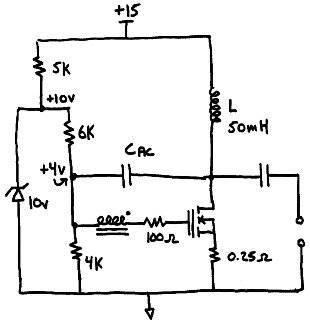

It’s easy enough to get rid of the output capacitor. My next post will include a schematic.

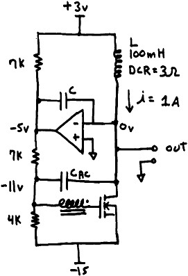

Here’s the transformer-coupled source-follower single-ended tube hybrid MOSFET amp with a DC servo loop to eliminate offset at the output.
I didn’t draw the tube drive stage. Refer to the tube forum or previous posts on this thread to see tube drivers.
Here’s how this circuit works: the op-amp is the servo loop that keeps the inverting (-) input at ground potential (by referencing ground at the non-inverting input). It does this by modulating its output to change the MOSFET’s bias. In this case, if the op-amp maintains about -5V, the bias at the MOSFET gate is -11V, or +4V from gate to source. Actual voltages and resistor values would depend on the MOSFET’s characteristics.
The bias current flows through the DCR of the choke, which causes a voltage drop. If the DCR is 3 Ohms, then a +3V power supply is needed. If the power supply voltages change a little, then the bias current changes to maintain 0V at the output.
In summary: the op-amp controls the MOSFET's bias current so that exactly the right amount of voltage is dropped over the DCR of the choke to maintain 0 volts at the output. This means (worst case) that a DC offset could occur at the output for 1 second.
The slew-rate of the servo loop is managed by C, which should be sized below the lowest frequency of the amplifier. In this case, 1Hz would work.
The signal is applied by an interstage transformer connected directly to the gate (no gate-stopper resistor is shown). The amp is configured as source-follower by the AC coupling capacitor Cac. This capacitor couples the interstage transformer to the drain of the MOSFET, making it operate in source-follower mode.
So how does the amp deliver the positive half of a waveform? As the MOSFET cuts the current off, the choke reacts and releases its stored magnetic energy in the form of positive current, resulting in positive voltage at the output. Here’s where the frequency limitation comes in: if the choke is too small, it doesn’t have enough stored magnetic energy to create a low-frequency waveform. The lower the frequency, the more stored energy in the choke’s magnetic field you need.
This amp may not be practical to build, due to the crazy +3 volt power supply requirement, but certainly feasible in theory. If you wind your own power supply transformers (or you use switching power supplies), this amp is very feasible.

Looks good, but I can´t qute figure out how it´s going to function as a source follower. Looks more like a Zen to me.
Does it have anything to do with the fact that the input is connected between drain and gate instead of gate and ground?

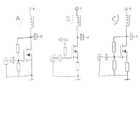

If we go back to where we started
Pretend that we leave balanced SE and PP aside for a while and look at some basic SE designs.
Drawing A shows a "regular" choke loaded Zen design that has ~twice the efficiency of a CCS loaded design. Interesting.
The big drawback is that the PSU has to be well regulated if we want to keep the bias reasonably stable. Temperature drift might be a *female dog* too.
Drawing B should be quite insensitive to PSU variations thanks to the resistor from source to ground. The problem is that this resistor introduces us to current feedback and the high output impedance which is related.
The voltage gain here would be
Rload / Rsource, which tells us that the voltage gain depends on the speaker impedance.
Might work good with some speakers (open baffles?).
Drawing C has what I think can be called mixed feedback, we have both voltage and current feedback. With the right combination of resistor values we should be able to achieve a quite high but well defined output impedance and still keep bias and temp drift under control.
This might be an attractive solution for certain speakers, I´m thinking dipoles again.

Here’s a choke-loaded source-follower Zen with some stabilized bias.
The zener diode (buffered by the 5k resistor) establishes a stable +10V reference across the bias resistor network for a stable Vgs. Since zeners are well-known sources of noise, the zener should be buffered with some caps - maybe even a little choke! (o.k. I'm getting out of hand. Where's Circ when you need 'em?)
Since we’re trying to control bias current, not gate voltage, a better way would be creating a stable reference for current. A DC servo loop could be used to control bias current using a reference. Just as a conversation piece, I’ll cook one up.
The signal is applied to the gate (through a gate-stopper resistor) with the secondary of the interstage transformer. The signal path is completed to the drain by the coupling capacitor Cac. The capacitor also serves as the local MOSFET drain-to-gate feedback path. This is very similar to the feedback of a triode-connected pentode (vacuum tubes). The feedback consumes all of the available gain, so the transistor operates with unity gain.
This forces more demands on the driver stage, which should produce a gain of about 15.
This is similar to my discussion on the push-pull thread: http://www.diyaudio.com/forums/showthread.php?s=&threadid=24744&perpage=15&pagenumber=2
Additional feedback is provided by a source resistor (0.25 Ohms in this example). An added bonus is increased stability.
I’ll be running some SPICE simulations of these circuits over the next few days. If someone beats me to it, post your results! Simulations should solve the 50mH vs. 1H debate, too.

I´m glad to see that this thread is still active!
Unfortunately I don´t have time to look closer at the drawings and interfere with the discussions right now, ´cause tonight I have some prototype breadboarding to do.
The topology will be something like drawing C in the last picture I posted, but the resistive voltage divider for the voltage feedback will be replaced by... something else😀
I´ll report tomorrow or as soon as I have anything to report.
