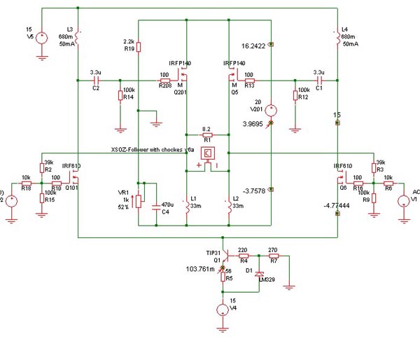

The circuit in post #51 needs energy storage in the chokes. It also needs a level shift device (coupling cap, folded cascode, interstage transformer, whatever) between the diff inputs and the outputs. Then the outputs need bias.
No - the energy stored cant be cahnged by feedback, i guess that is why it needed 200A in the sim.
The circiut in #51 works fine with resistors instead of chockes, and i can´t see why a levelshift device should be nessesary when using chockes, i will take a look into that suggestion.
djk
Come on - i thought we were here to have fun and learn - not to insult each others intelligence.
I've got a simulator but I never use it because I can't figure it out.Henrik said:It looks verry promising in the simulator, and this is only the first shot.
🙄 Anyway, could you try these two suggestions?
1/ Replace R101 & R14 with a single-centre tapped transformer winding with the ends going to the gate resistors and the centre tap going to a somewhat reduced supply rail.
2/ Replace R8 with a proper current sink.
Doing either or both of these should make the input fets at least, very symmetrical wrt each other.
Wishfull thinking.
Of course, since there are no perfect components.
A real world 50mH choke that can handle 3A DC seems to have at least half an ohm of DC resistance, so the voltage drop is an issue.
Is the DC resistance a bad thing? Not necessarily, since we can use it instead of source resistors to stabilize the bias point.

I'll admit I was laughing at your sim, but you must admit it WAS laughable (200A!).

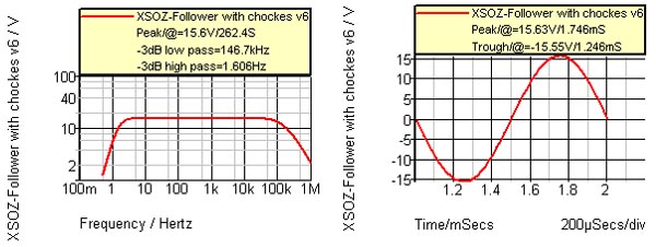

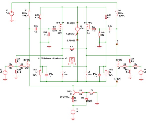

Circlotron
Thanks for the suggestions, I have simulated them - almost, i used two inductors instead of a single-centre tapped transformer.
Do you have a special reason to suggest a centertapped transformer?
Speakerload 8 Ohm.
Bias current for the outputfets is 4.3A, which is better than the previous 200A😀 .
The output inductors is 33mH as suggested elswhere in this thread.
The inductors at the inputstage needs to be as high as 680mH but needs only to take 50mA.
Output bias is adjusted by VR1 and VR2.
This Circiut is not ment to be ready to bulid, but more to evaluate this topology, all though i am shure it will work, but how does it sound?
I am not used to work with inductors, so i have to study that issue a some more before i take this further.

Your new circuit looks better.
The resistor plus bootstrap cap in the Hadley serves the same function as the 680mH choke does in your new circuit.

Yes. It guarantees that as Q101 drain goes up for example, Q6 drain goes down by exactly the same amount. With two separate inductors they not locked to each other but are free to move independently which is not good.Henrik said:i used two inductors instead of a single-centre tapped transformer.
