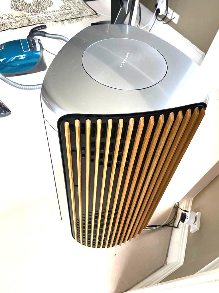

As long as you keep the open area and depth reasonable, I doubt you'll have trouble. Of course from an audiophile standpoint there are those that say no grille is the only proper grille, but practical people often have to make cosmetic and protective concessions.ideas about wooden strips as a grille?
Your rib version looks more closed than the B&O's and the depth looks greater also. Here's a picture of them with the contrast and brightness jacked up so more of the details can be seen. There's another element behind the wooden ones, which you likely won't have.

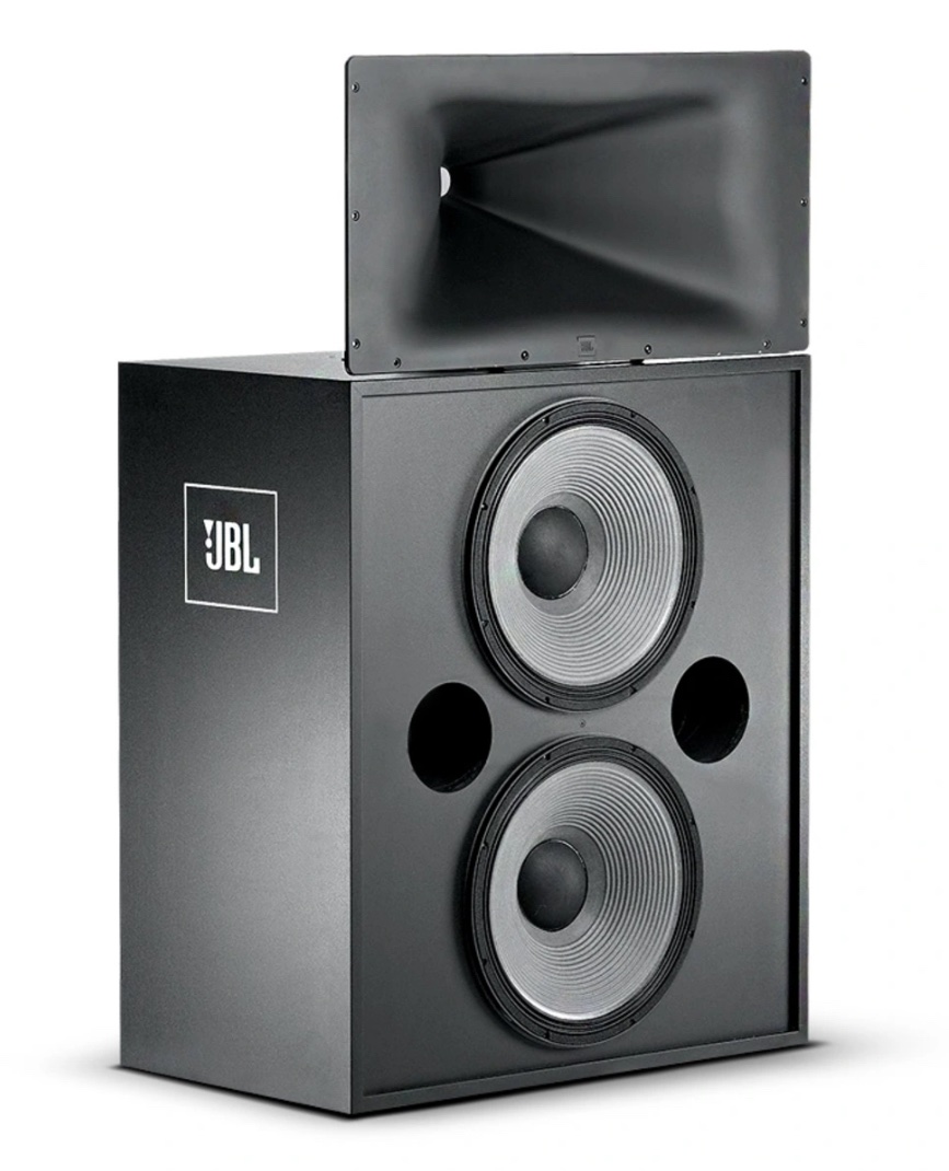

I installed some JBL 4722 speakers in my living room while my wife was gone, this was not appreciated but were in the room for 2 years: Now any speakers I bring in are complemented as "at least they are not as big and ugly as those Jbl's"
If a more conventional or traditional-looking speaker is acceptable to you and your spouse, this one is within your budget. If you are adept at furniture or cabinet building, this speaker would be easily within your capability. It is 107 cm tall, however.

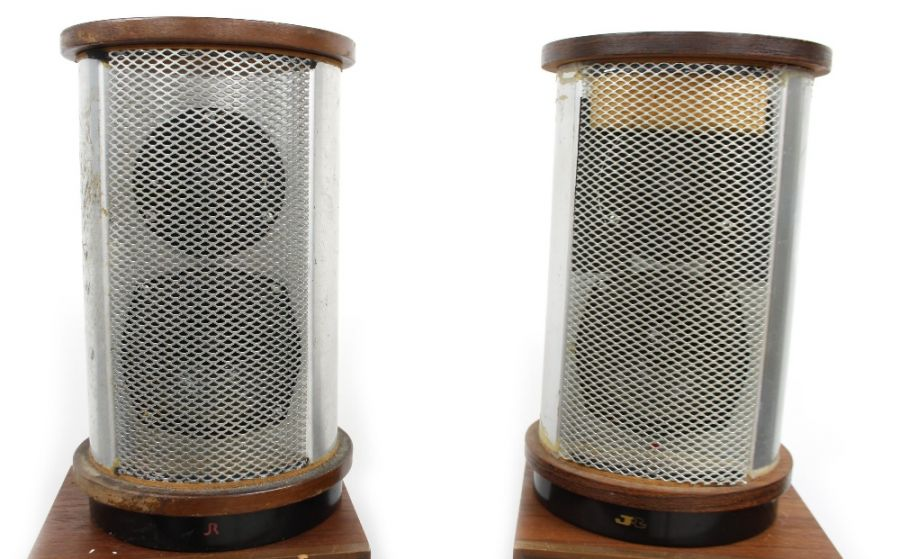

These are Jim Rogers "JR149", small British speakers from the 70s - ad taken from Internet. Perhaps too small, but I would think WAF would be high.
They were, IIRC, largely made from aluminium; look like they used a 4" mid and small tweeter. I heard them at Encel Stereo in Melbourne many years ago, and thought they sounded nice but the sound wasn't as big as several cheaper designs. Maybe the cabinet could be adapted for a modern design with similar sized drivers?
