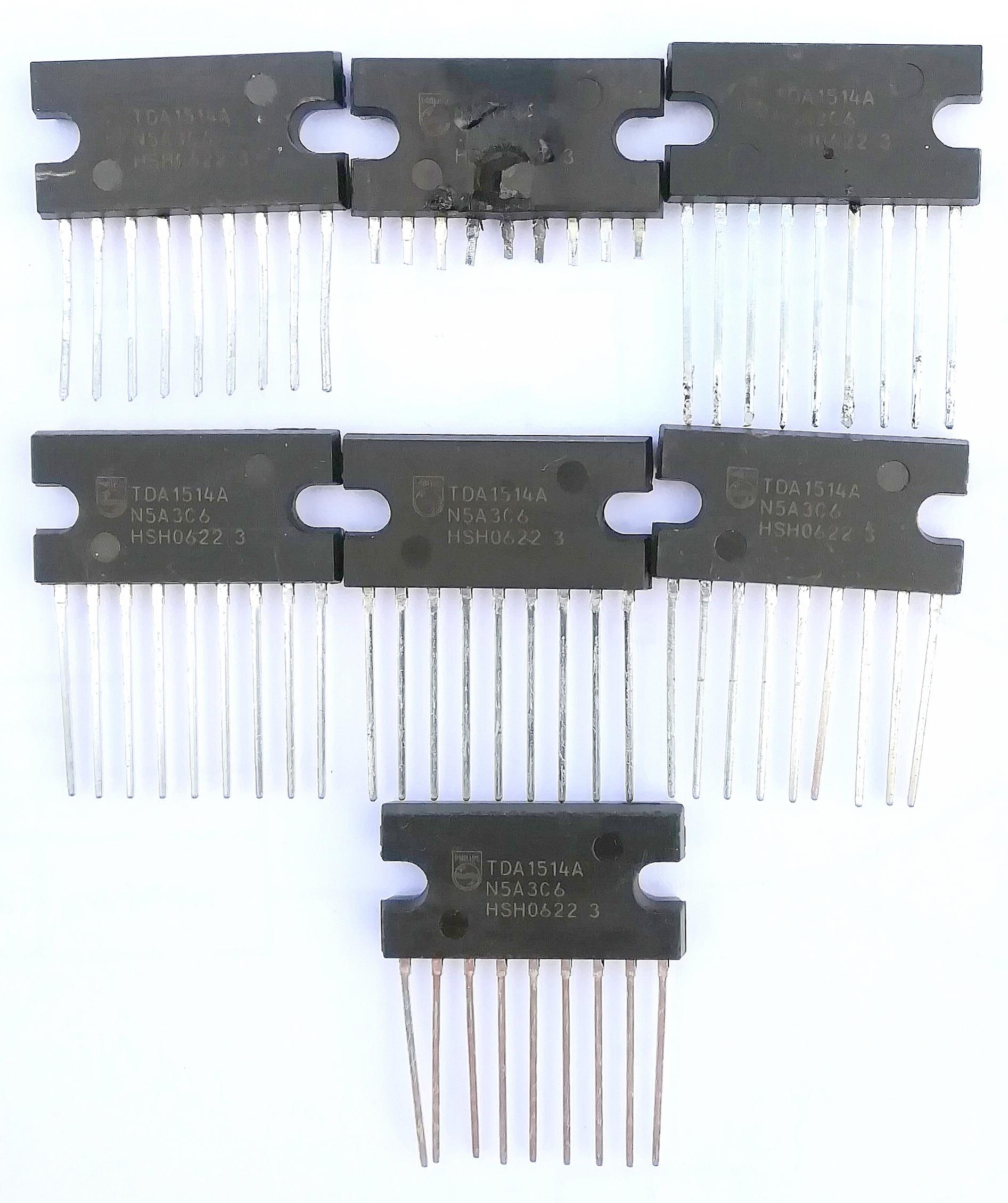

TDA1514A
I had hoped to present test results for this elderly and no longer produced (by Philips/NXP) chip with reputation for good sound.
I made a test-board relying on Fig.4 “Application and test circuit” in the datasheet. All connections were checked with an Ohm-meter before turning the power ON. No load at the output and the input shorted. I used a +/-18V supply and the first TDA1514A chip was destroyed (sound+smoke) immediately after power was turned ON.
I replaced the IC with a similar one after having checked that the output line would not have a low impedance connection to either power rail or ground. Turning the +/-18V supply ON immediately destroyed the second chip with a sound and smoke like the first.
I cut the second chip out leaving a part of the pins in the PCB such that I, without the chip, could check the voltage level on each pin before inserting a third LM1514A. I found no mistake in voltage levels or connections. The third IC was inserted and destroyed immediately on power-ON, like the two before.
I checked my storage of TDA1514A and their origin. I had seven TDA1514A of which three already were destroyed. They were bought in three times from FSXSEMI but all seem to be from the same production lot of which none seem functional. I am 99% certain that the application circuit in Fig.4 is complied with. The supply voltage of +/-18V is much below the limit of +/-25V. The output wasn’t loaded and could accordingly not cause an external current to flow. Thus, the current that caused destruction of the chips had to flow between the two power supply pins (6 and 3). The far most likely reason for destruction is a chip-fault causing high current between pins 6 and 3.
Tomorrow I will try to keep an TDA1514A IC muted and see if the chip is still destroyed. Most likely, those TDA1514A I have are fully non-functional and useless. Sorry maxhifi. At least no-one is tempted to use them for anything. Once more Turbowatch2 was right.
Image 1: The three upper ICs have been destroyed.

The TDA1514A is famous for fakes, and the fakes are famous for behaving like yours did. I read about it on several different forums. Apparently there is a 1990s Marshall guitar amplifier which uses the TDA1514A, and installing a fake has the same result as you had above. Considering that they're from a Chinese supplier, I think it is most likely that your ICs are not genuine at all, because this IC predates the time period of "everything" being Made in China. At least the TDA2030 fakes actually work! It is good you tried!

TDA1514A
I continued a bit the testing of my TDA1514A samples without bootstrapping connected.
One specimen blew when the +/-18V supply voltage was applied.
Two other specimens did not appear to “burn” such as the four other but did not show any important reaction to supply voltage or an input signal.
One did put its output voltage close to zero but a sine-wave at the input caused no signal at the output.
Another specimen put the output voltage at around -12V. It did not react to a sine-wave at the input.
Having tested 6 out of my 7 TDA1514A ICs, and knowing from maxhifi that there are many fakes around and no supply of genuine items possible from reputed suppliers, I find it time to conclude that TDA1514A ICs bought from Asia are very likely useless. They will hardly perform even to a reduced level. Worst case they self-destruct when supply voltage is applied, best case they do not react much at all.
I terminate my testing of TDA1514A.
@FF
I´m really sorry you verified my worst expectations. I was surprised when I saw your chips still offered a dozen times at Aliexpress, all with your serial and production numbers. Which is impossible. The faker not even changed numbers after a few thousand pieces and years.
Maybe you got fakes that failed quality control 🙁
At least, in the sense of Chinese mentality they worked: You paid in valuable Euros for worthless Wuhan´s and you are unable to complain!
I expected most of them to be fake, but basically working. Maybe your design misses some tweak to let them live. If you wanted to know for sure, I would order one of the cheap kit´s with such a fake TDA1514A, as some seem to work if you look at the comments.
In my thinking, the ones you got are the best outcome, imagine they would work, you use them for a project and the resulting sound is bad, after you spent all this time and money to build an amp. You would be disappointed and think you constructed something wrong. In reality it was just because your chip was something cheap and different inside.
