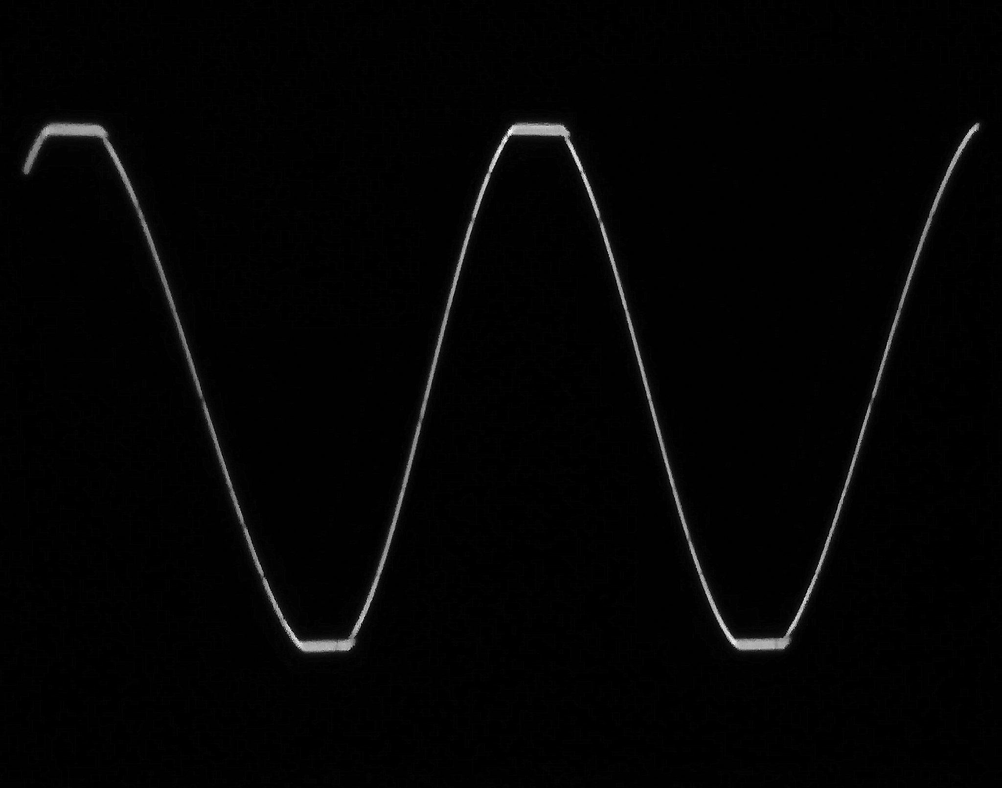

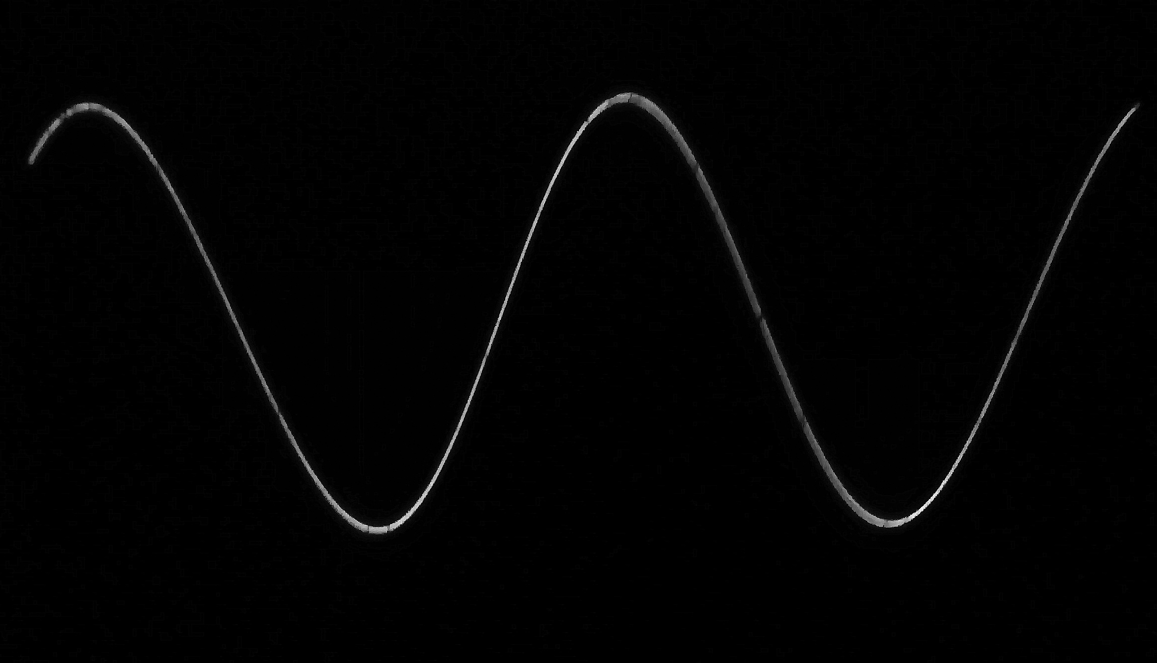

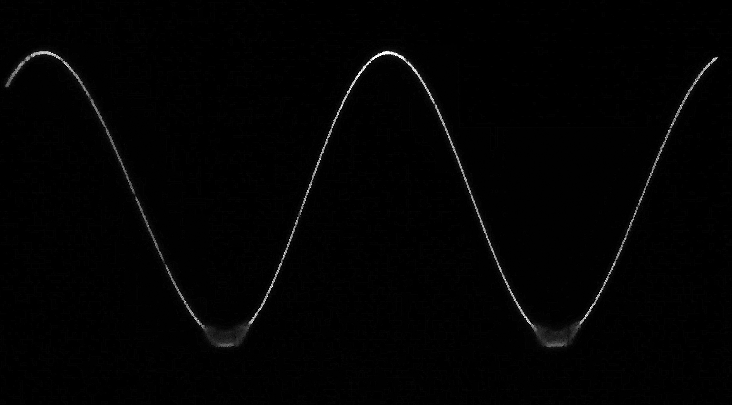

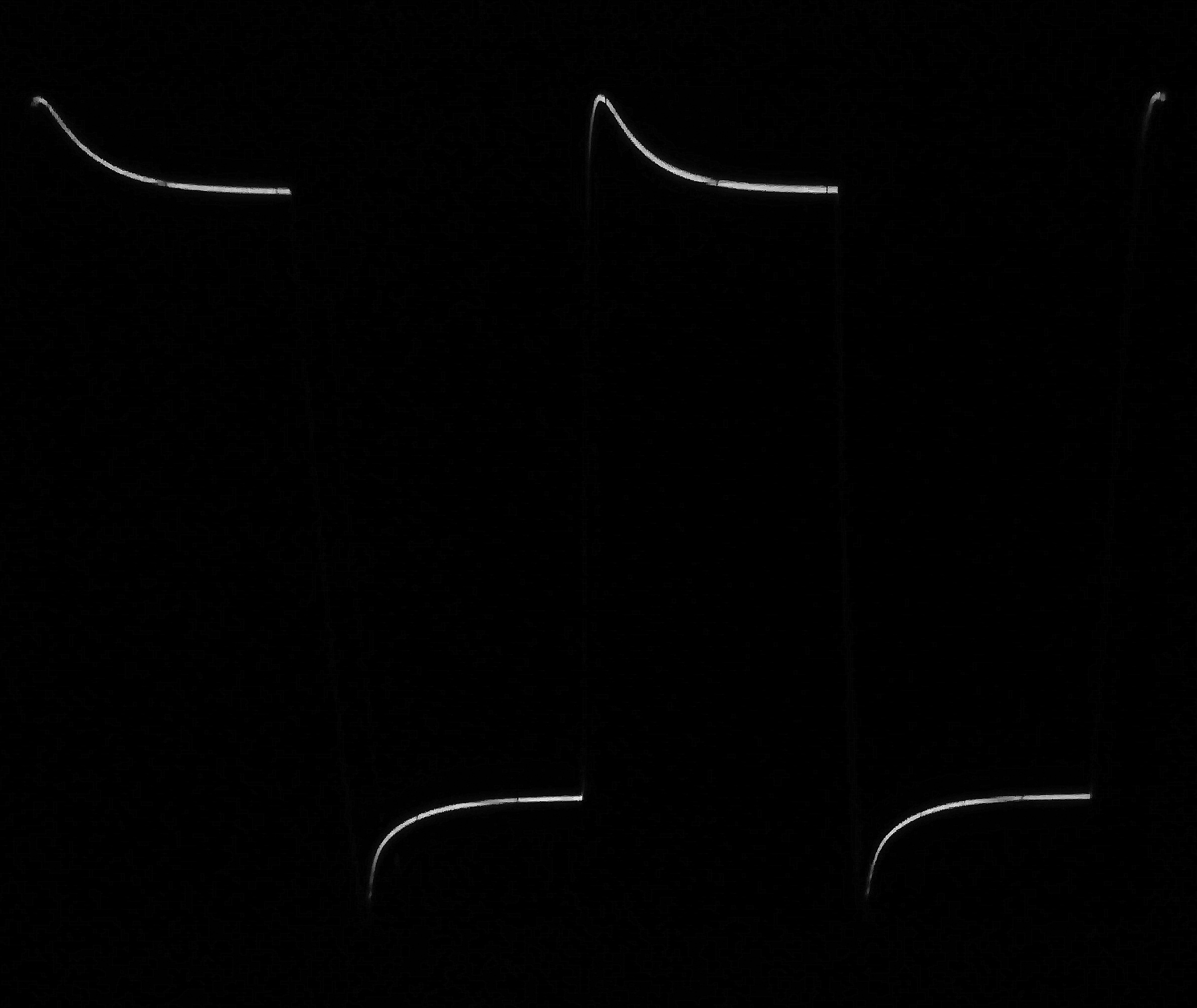

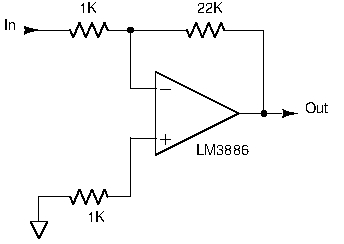

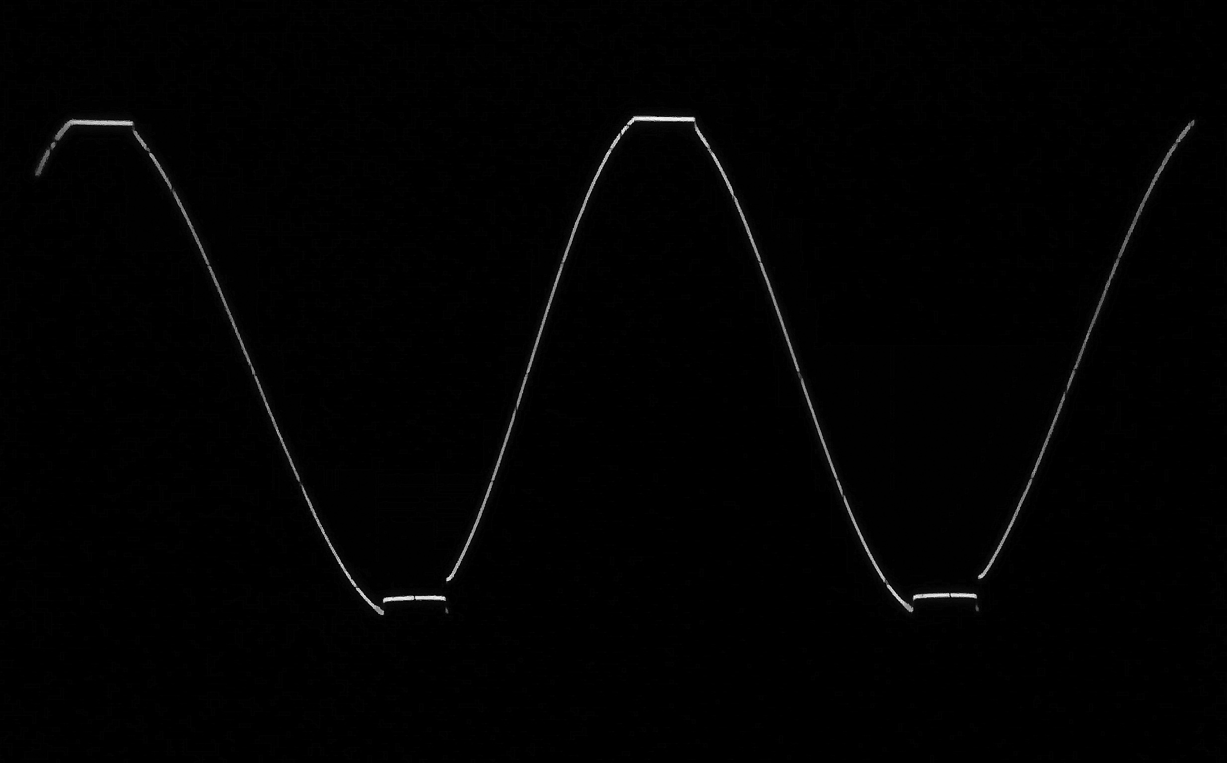

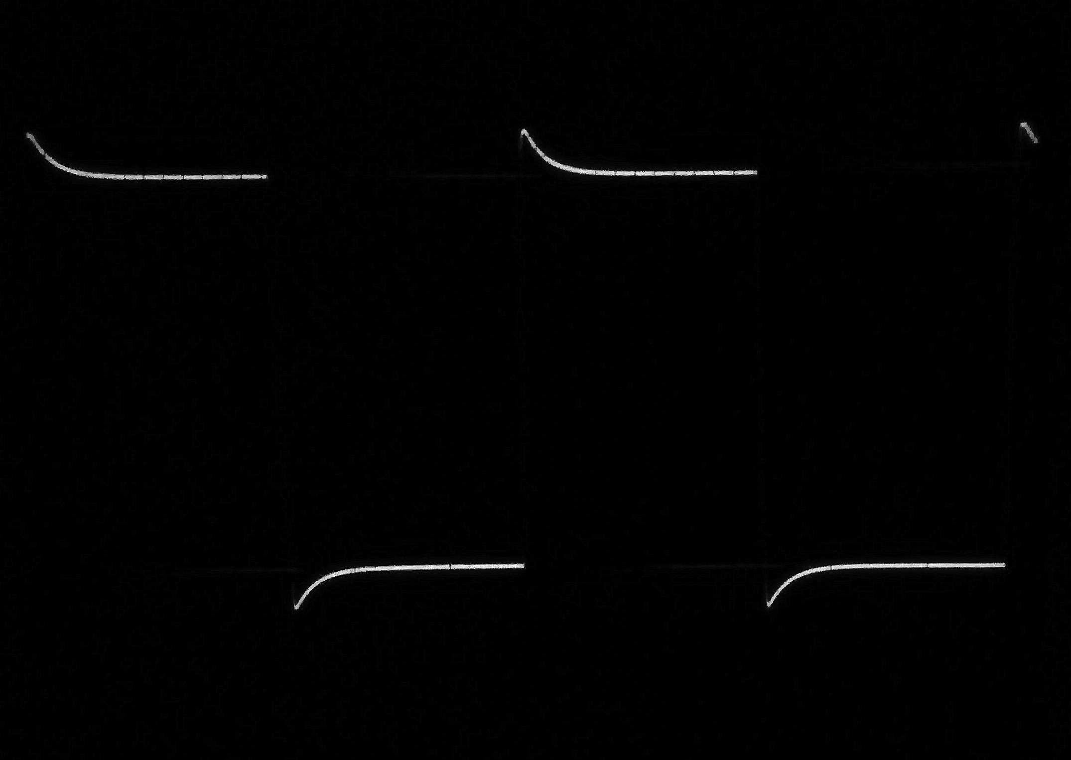

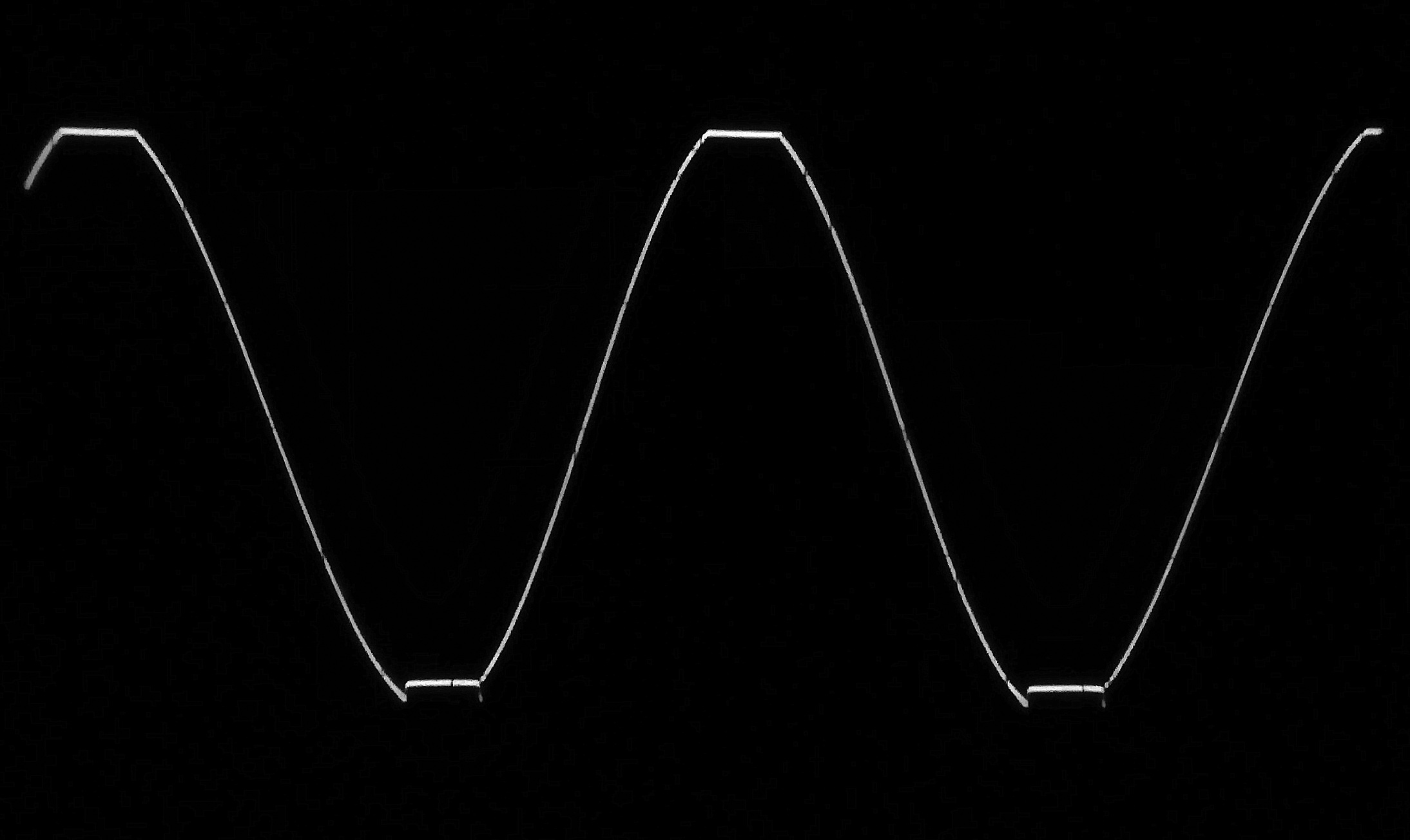

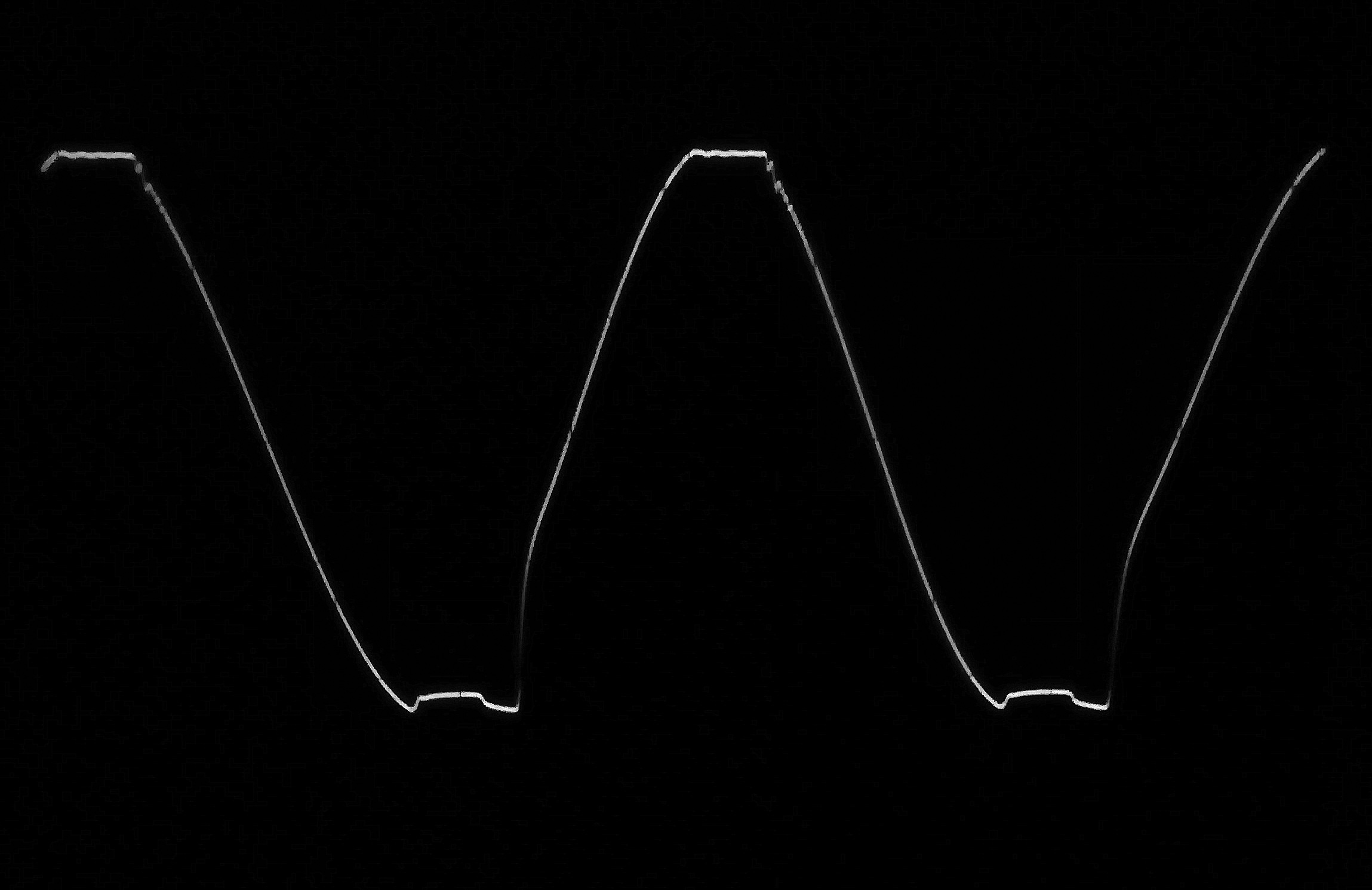

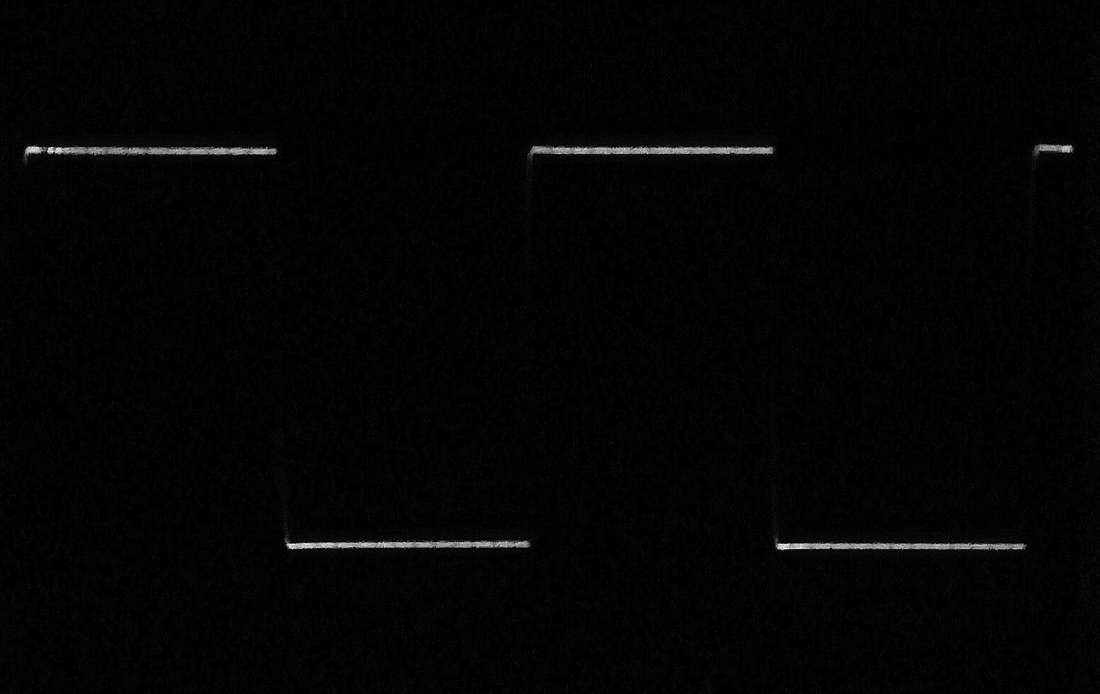

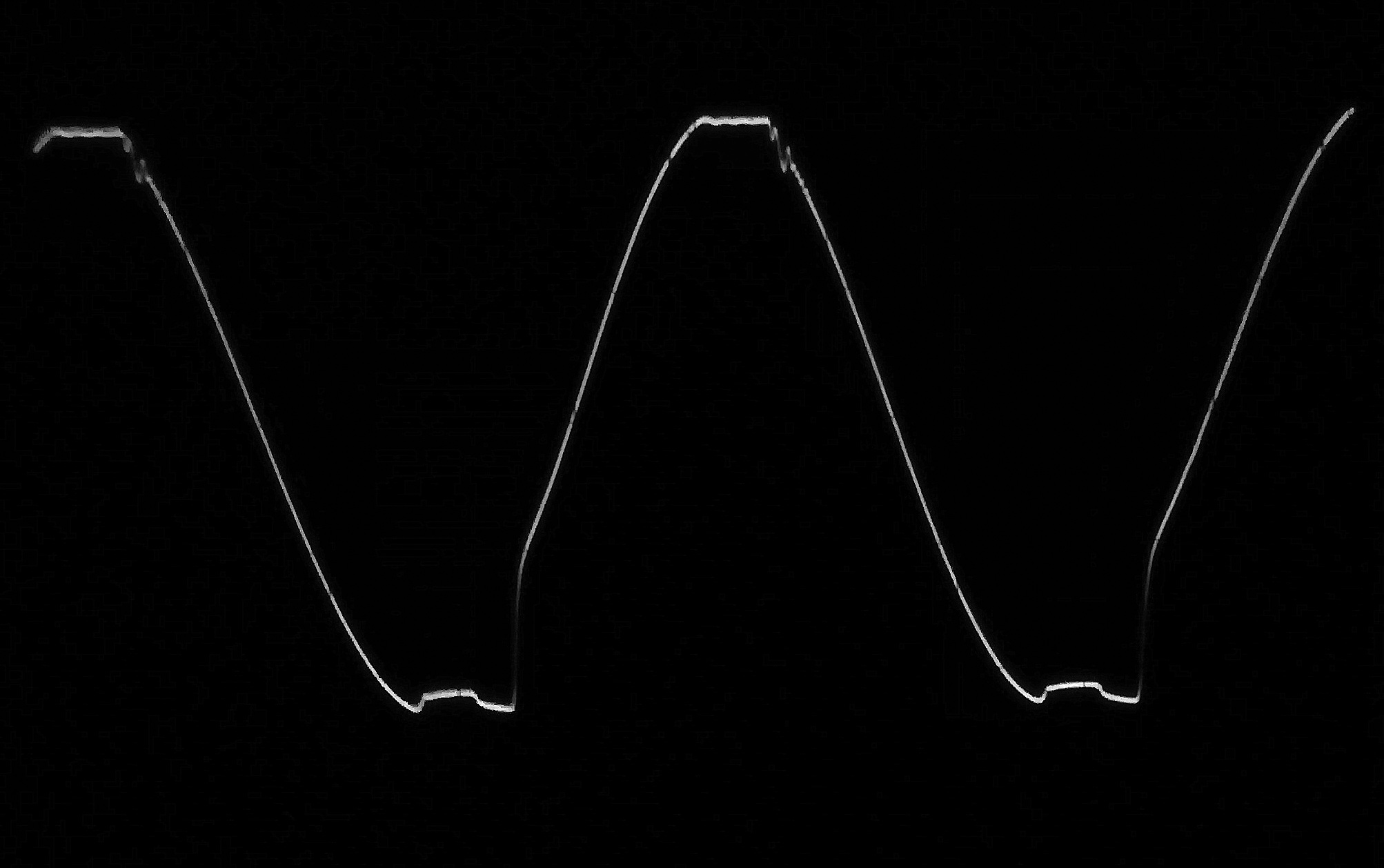

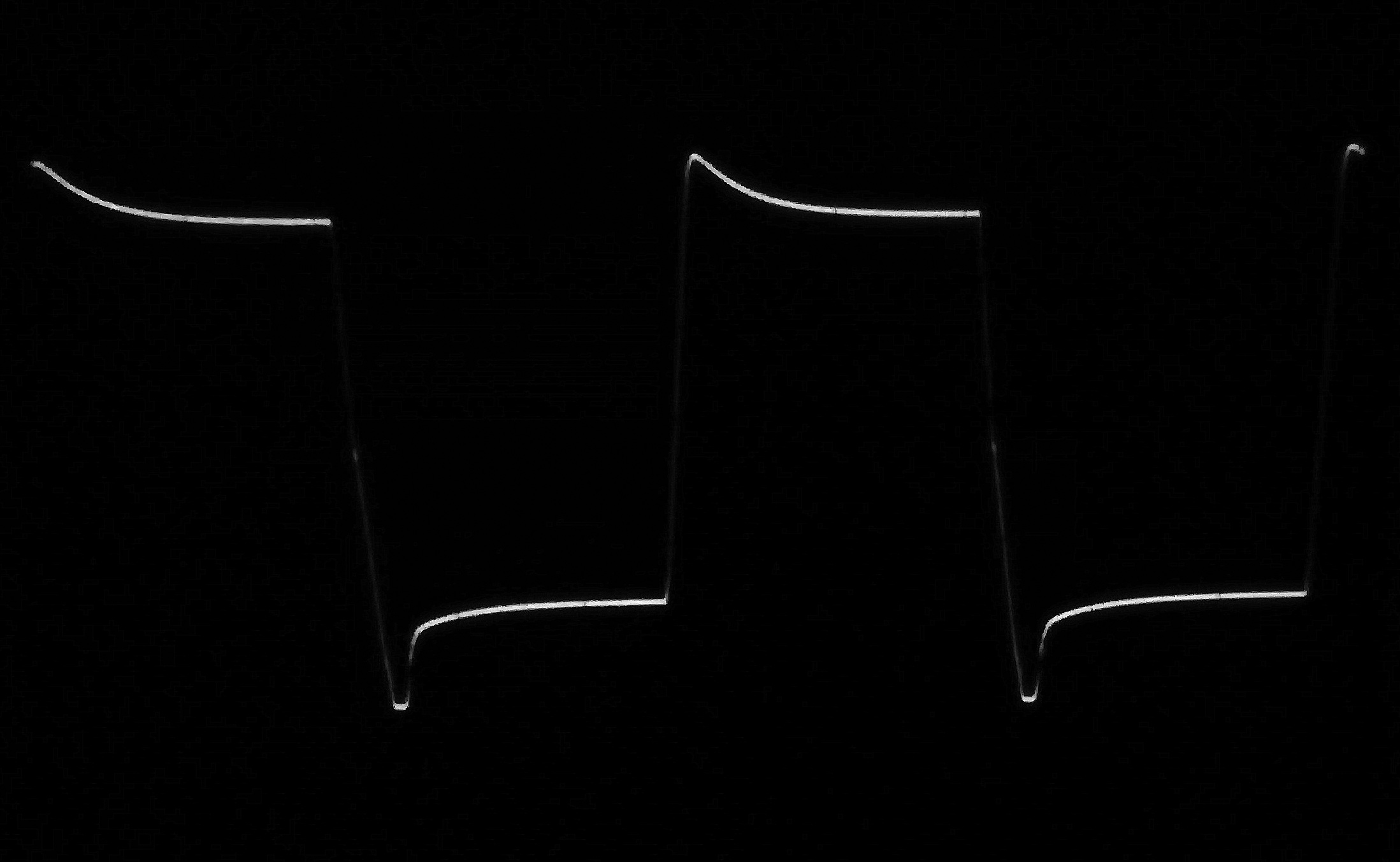

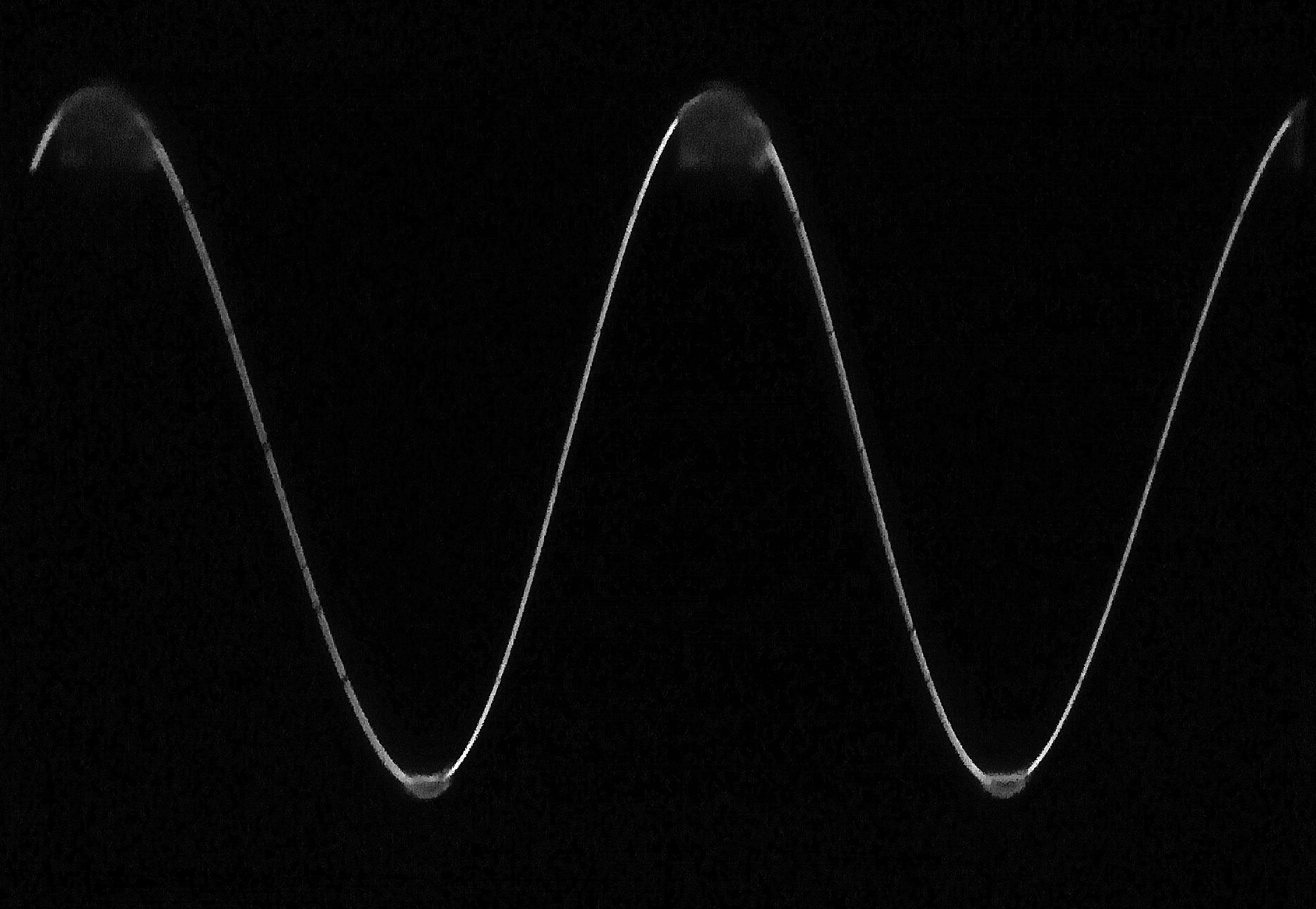

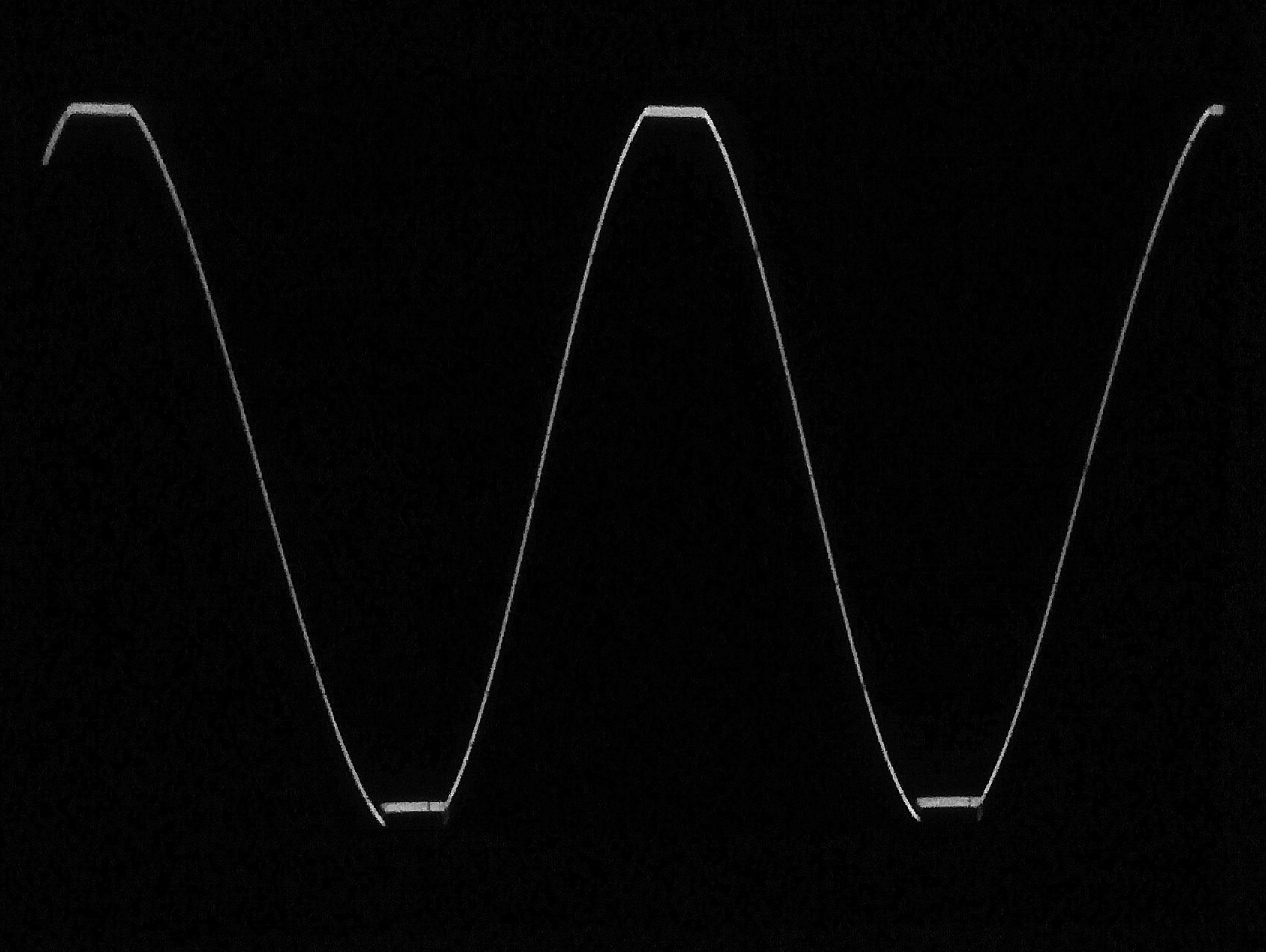

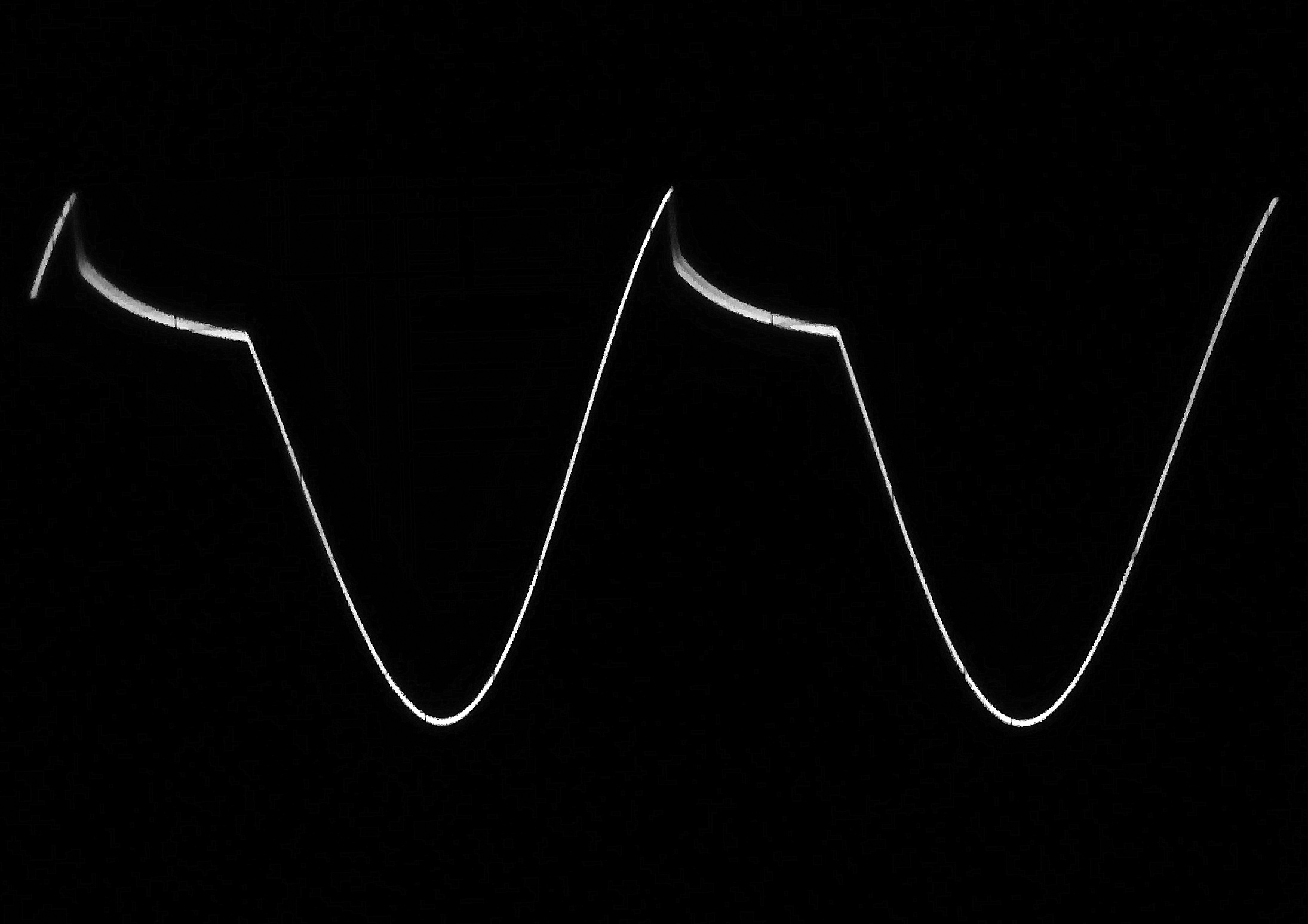

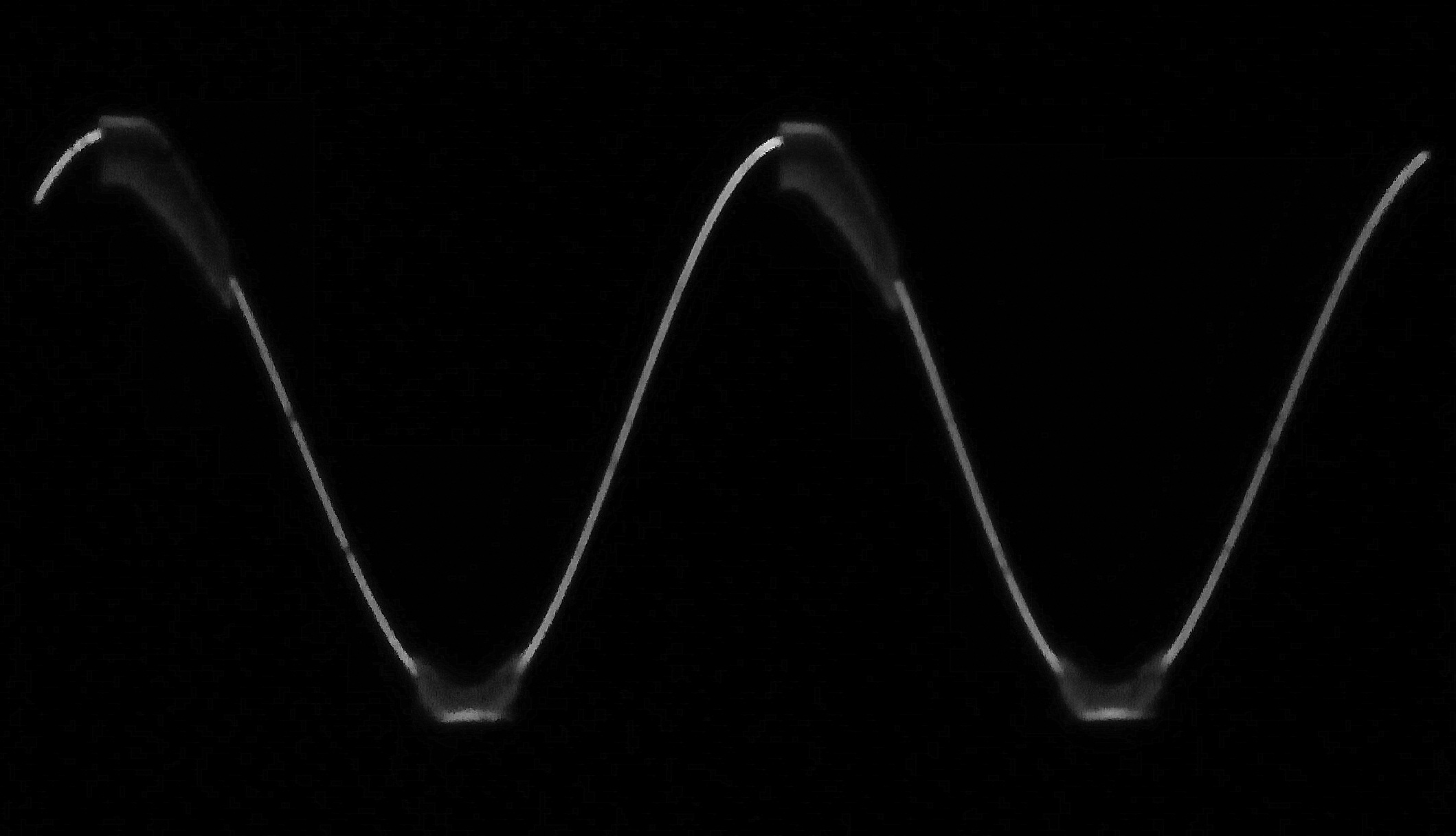

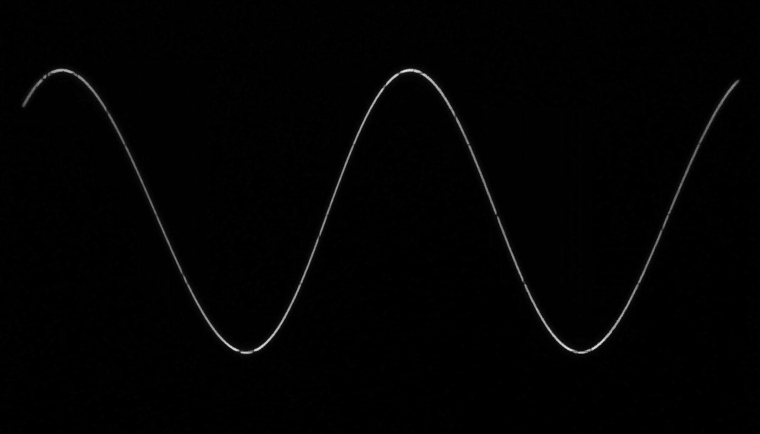

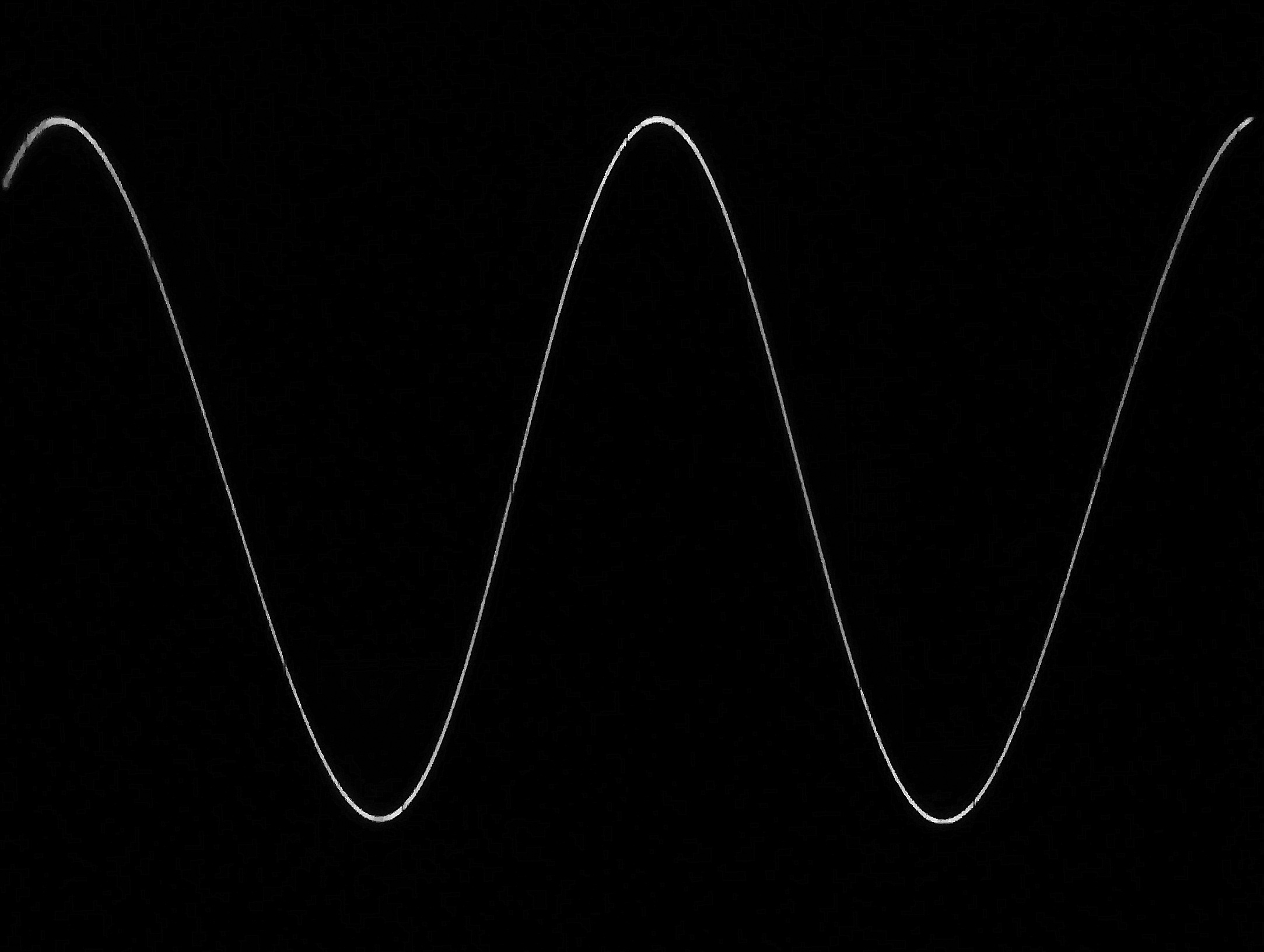

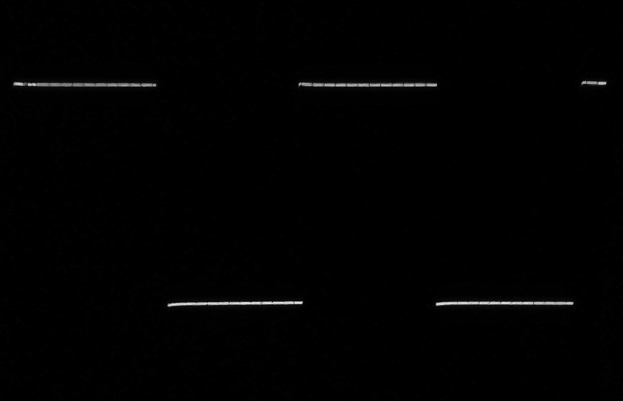

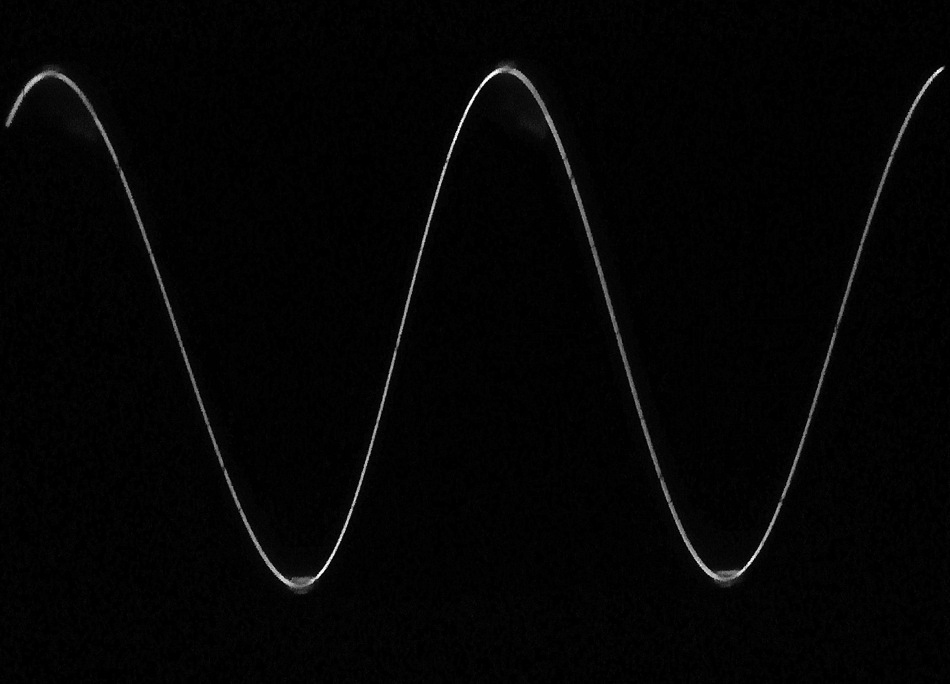

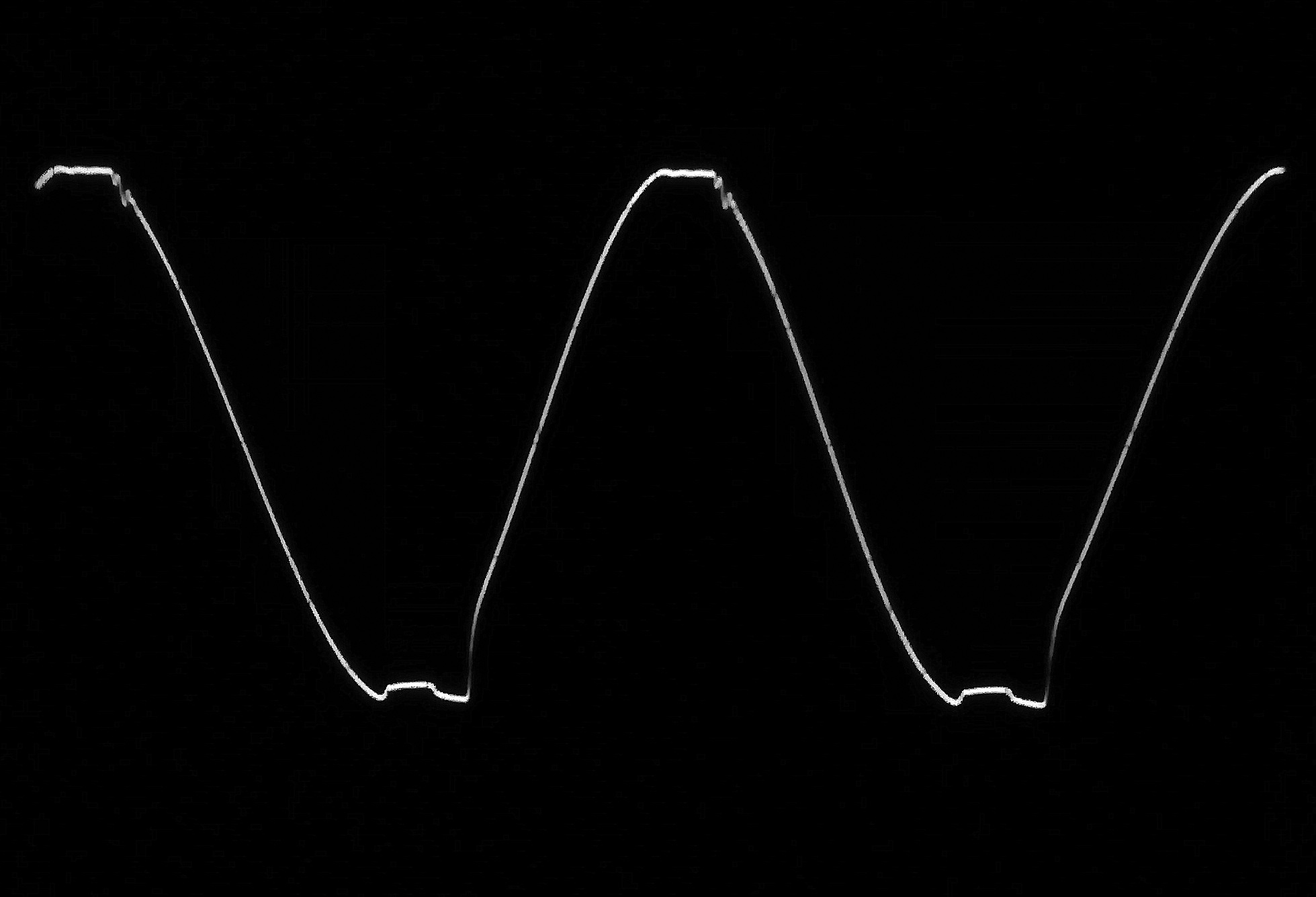

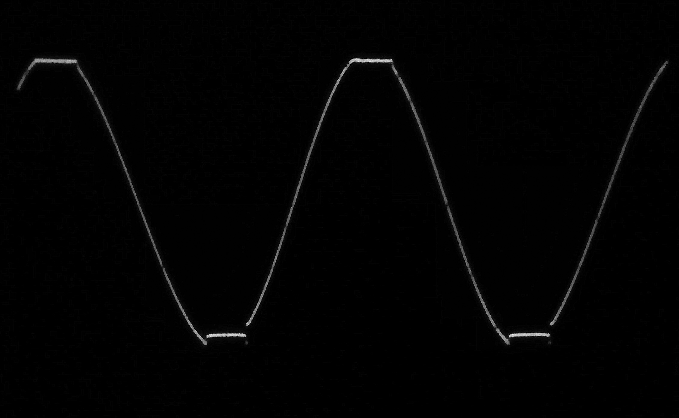

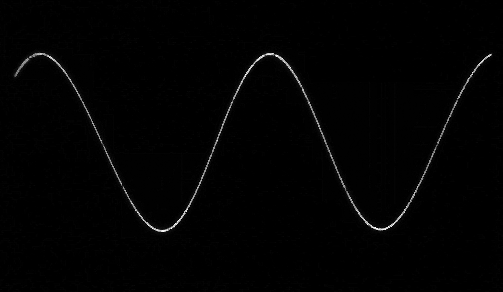

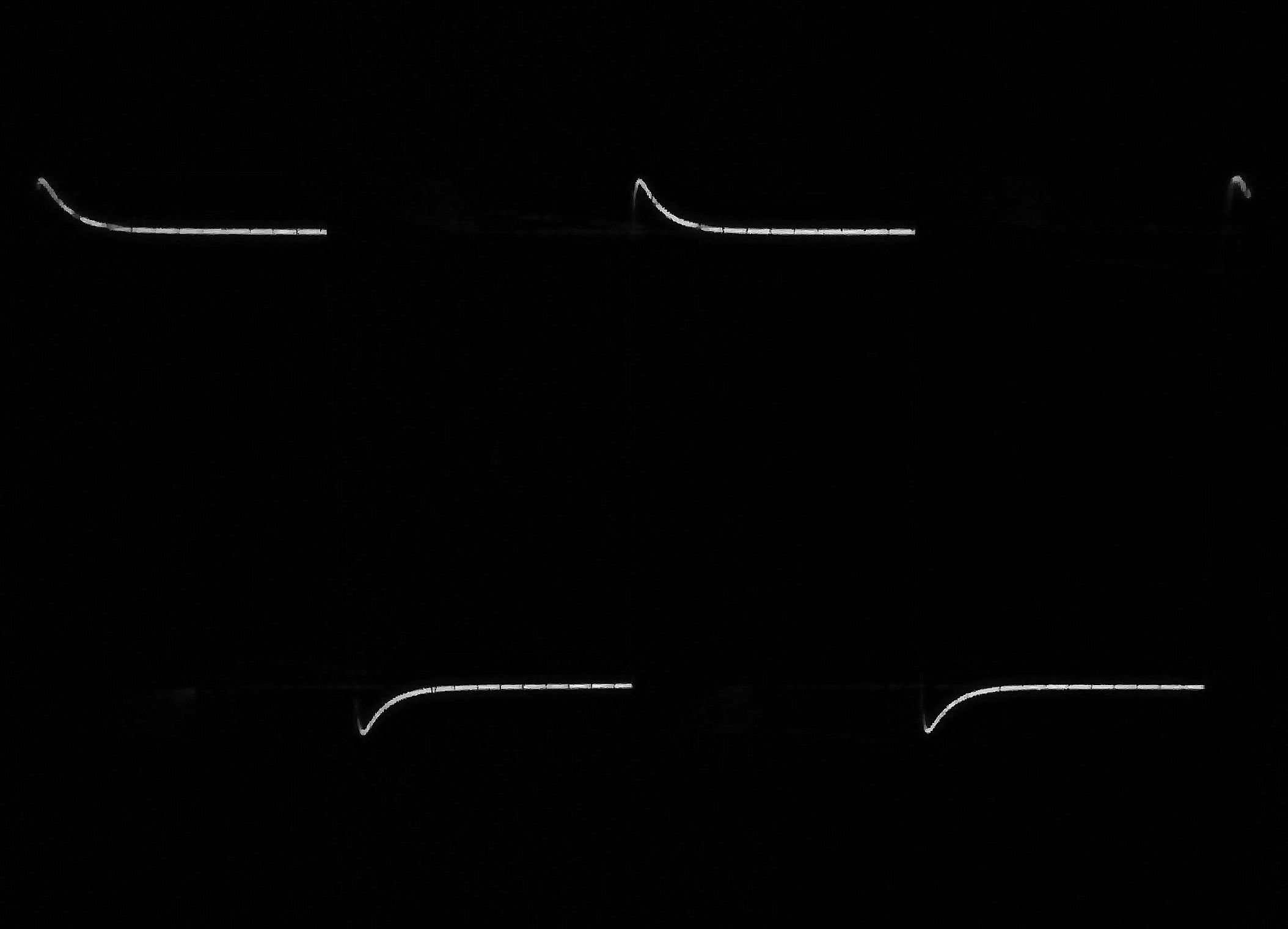

The LM3886 is next in line for an assessment. The minimum gain is stated in the datasheet to be 10 times (20dB).
First test was carried out within the recommended gain range using a gain of 22 and an inverting configuration. The supply voltage was +/-26V from a regulated power supply and the load 4 Ohm. For a start, no Zobel-network or Thiele-network was included.
Picture 1: Diagram of the main components.
Picture 2: 1KHz sine-wave, 20Vpp.
Picture 3: 1KHz square-wave, 20Vpp.
Picture 4: 1KHz sine-wave, clipping at 44Vpp.
Picture 5: 20KHz square-wave, 20Vpp.
Picture 6: 20KHz sine-wave, clipping at 44Vpp.
The results obtained show a stable amplifier, as expected, only with slightly deform clipping which is best seen from the curve at 20KHz. LM3886 has a “SPiKe” protection system that may be the cause of deformation at clipping. At clipping of the output, the voltage margins to the supply rail voltages were some 3-4V which is reasonable with 4 Ohm loading.

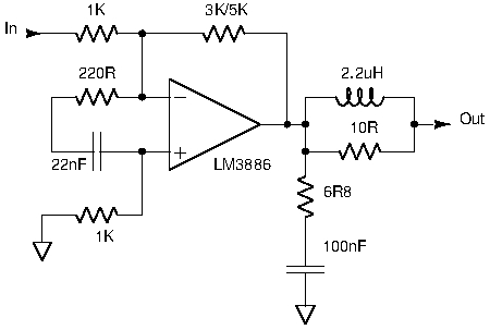

LM3886
These conclusions are evidently drawn on the LM3886 specimen I had in the test board. If that specimen behaves the same way as other LM3886 specimens, I cannot say.
When the gain was reduced, first to -5 times and subsequently to -3 times (inverting), oscillation on the output signal appeared at higher signal levels, near clipping. The less gain - the more oscillation, just as for TDA7293. For the LM3886, the initial oscillation was less than for the TDA7293 with the same gain.
Initial test with reduced gains, +/-26V supply voltage and 4 Ohm load.
Image 1: Gain -5, 1KHz, amplitude just below clipping level.
Image 2: Gain -3, 1KHz, amplitude just below clipping level.
In order to eliminate the oscillation, I first tried to include a Zobel-network but that only made the oscillation worse. Then, I tried the same CR-string that was used for the TDA7293. Using the same values, 10nF in series with 470 Ohm, immediately removed the oscillation for operation in the linear working area.
A difference between LM3886 and TDA7293, according to my results, is that LM3886 probably is easier to handle in the normal linear working area than the TDA7293 but behaves less predictable when the clipping level is approached.
Most of my efforts trying to optimize the CR-string values and the Zobel-network turned around having a less abrupt behavior when clipping was reached. The values I arrived at may very well vary according to each LM3886 specimen such that the values I chose are somewhat arbitrary.
When I had implemented values for the CR-string and Zobel-network, the LM3886 would oscillate permanently with only10nF connected directly at the output. LM3886 certainly requires a Thiele network at the output such as shown in the datasheet. For the Thiele-network I used 2.2uH in parallel with 10 Ohm because that was what I had. The 0,7uH shown in the datasheet should work as well. With the Thiele-network connected directly at the output of the LM3886 IC, the LM3886 would remain stable even when loaded with 1uF.
In the end I implemented LM3886 components as shown in Image 3.
Image 3: Values for the LM3886 peripheral components
In a following posting the output curves at gains of -3 and -5 will be shown.

LM3886
Using the components shown in Picture 3 of posting #22, I obtained the below output curves:

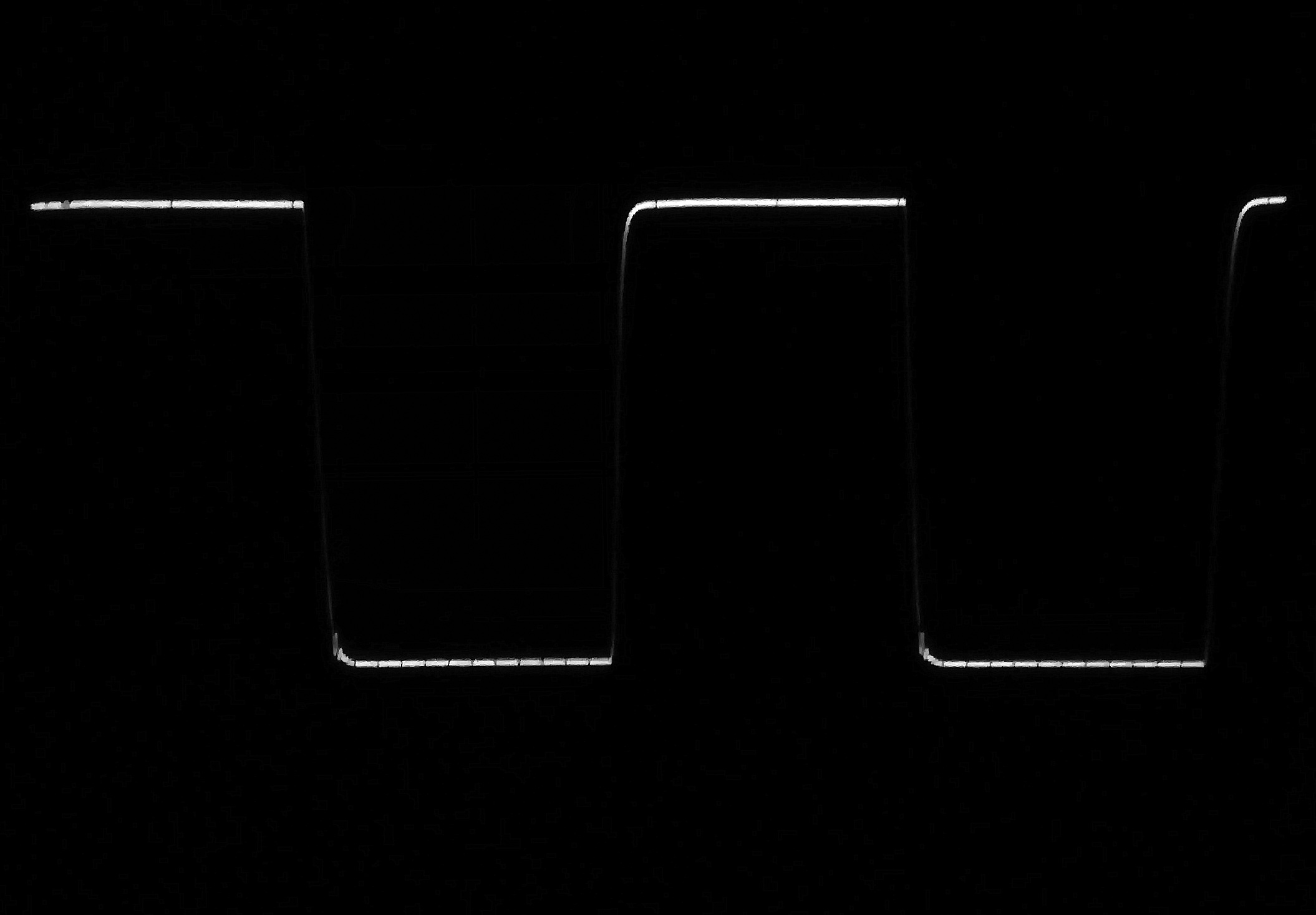

[FONT=FreeSerif, serif]LM3886[/FONT]
[FONT=FreeSerif, serif]I tried the LM3886 test-board with my 500W strong +/-35Vdc LLC power supply. With a 4 Ohm load and the same components as used for the test in posting #23, I turned up the power. At around 28V peak the output would start oscillating, which sometimes led to collapse of the positive half-wave such that the chip drew high currents and the IC had a very high power loss. Two things could improve the situation – either reducing the load to 8 Ohm or increase the gain to 22 (above the minimum gain). I tried lowering the impedance of the CR-string but could not get the chip stable with reasonable values. The board layout and power rail decoupling were such that it would work much better with recommended gain and I accordingly assume that doing a further effort here would bring very little.[/FONT]
[FONT=FreeSerif, serif]Apart from a very well reputed sound in ordinary use, the LM3886 is attractive if the particularly high current limit of 11.5A (typ.) can be used. My immediate impression is that it will be difficult. Either the gain has to be maintained higher than convenient for use in a composite amplifier or, the LM3886 should not be used to near its attractive 11.5A current limit in which case other chip-amps, like the TDA729X series, are serious alternatives.[/FONT]
[FONT=FreeSerif, serif]It has been hinted before that the LM3886 changes dynamic properties with higher supply voltages. It is consistent with that the datasheet only mentions 68W in 4 Ohm as a continuous output power limit. That corresponds to a use of the LM3886 far below the 11.5A current limit. The datasheet also mentions an “Instantaneous Peak Output Power” of 135W. But, relying on such dynamic values in a design is difficult. The specification in the datasheet of 11.5A could actually look like an output short-circuit limit rather than an operational current limit.[/FONT]
[FONT=FreeSerif, serif]For the above reasons, I will terminate testing of the LM3886 and conclude that while it is no doubt a very well sounding chip-amp for ordinary use, it seems not to be what I hoped for when I probably misunderstood the datasheet values.[/FONT]

As requested by aparatusonitus, I tried the LM3886 with the compensation recommended by Tom from Neurochrome. And, it absolutely looked good with a gain of 22 (within the recommended gain range) and an 8 Ohm load. 180pF (film) between the two inputs, 49pF+20K in parallel with the 22K feedback resistor. -22 times gain. The supply voltage was regulated +/-35V from an LLC SMPS.
Tests with 8 Ohm load.
Image 1: 1KHz, 60Vpp (just before clipping).
Image 2: 1KHz, 40Vpp.
Image 3: 1KHz, clipping at 64Vpp.
As recommended by Tom, the signals were without instability and the square-wave reproduction almost perfect. Clipping was reached in a regular manner and the clipped levels remained acceptably flat.
Then, the more questionable test results with 4 Ohm load.
Image 4: 1KHz, 60Vpp and just after turn-on.
Image 5: 1KHz, 60Vpp and a moment later.
Image 6: 1KHz, signal level reduced to 48Vpp (24Vp) and waiting some 15 seconds.
From posting #21 it is seen that until an output level of 22Vp and with a 4 Ohm load, the output remained stable. But when the output level is increased further, instability appears. First I tried the level of 30Vp (60Vpp) but instability appeared just after turn-on (as shown in Image 4) and soon developed to be worse (as shown in Image 5). I then reduced the signal level to 24Vp (48Vpp) and studied the output for some 15 seconds before the positive signal half would suddenly become unstable and collapse, as shown in Image 6 (could be repeated). When that happens as a more severe result of oscillation, the amplifier chip heats up very fast and may suffer damage.
Thus, at higher signal levels and with a 4 Ohm load, instability appears. This could be the result of changed dynamic behavior of the LM3886 chip with higher load current but it may also be due to another reason. I probably misunderstood the LM3886 11.5A (typ.) current limit that appears not to be meant as an operational current limit but rather as a short-circuit current limit. What is then the operational current limit? One way to find out is calculating back from the datasheet specification of 68W in 4 Ohm. 68W in 4 Ohm corresponds to a peak output current of 5.8A. For the test described in Image 6, the peak current level was some 6A and the signal almost stable.
It could be that the instability observed at higher signal levels and with a 4 Ohm load is cause by beginning influence from the current limiter. Similar has been seen with the LM1875. An operational current limit of around 6A is not bad. What is less good is if the chip shows instability near the operational current limit.
It cannot be disputed that the LM3886 has an exceptionally good sound when used on its own and ample supporters for that reason. Wizards like Tom may be able to tame the LM3886 with their exceptional knowledge. For less experienced DIYers, it seems not an obvious choice in a composite amplifier because the challenge of controlling the LM3886 will take most of the effort and as a mere power buffer its performance is not unprecedented.
