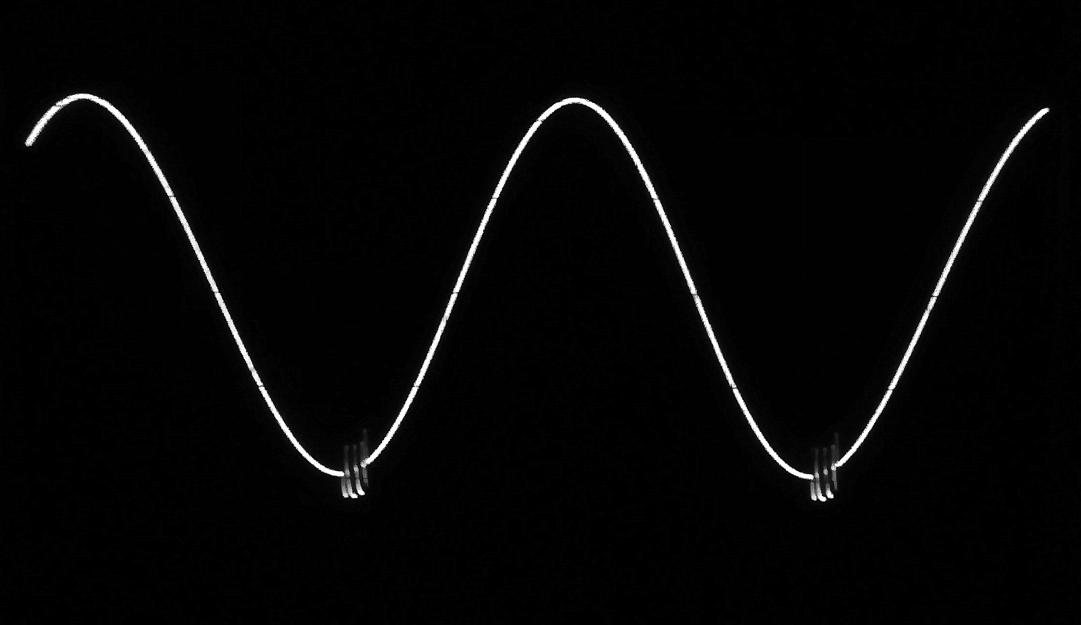

Image 6: 1KHz, signal level reduced to 48Vpp (24Vp) and waiting some 15 seconds.
This picture doesn't look like it should...more in the attached documents.
Excellent, thank you again...SPiKe protection seems to be a bit aggressive and will do everything to protect the IC...so every effort should be made to prevent it from activating at all.

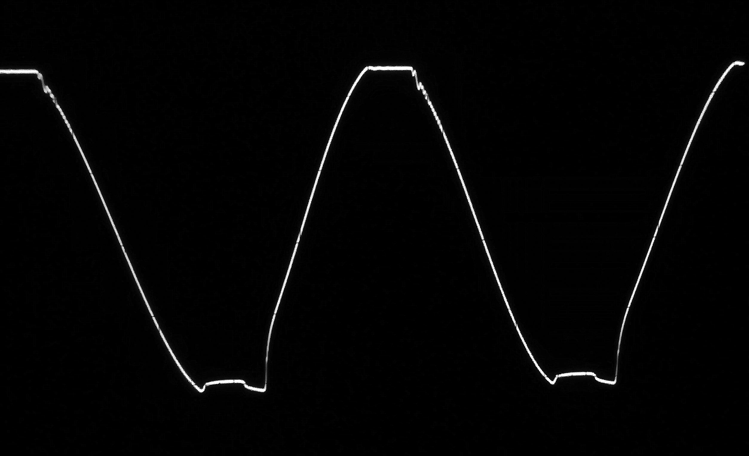

TDA7293
Having gained experience from the TDA2050 that the best compensation of instability at low closed-loop gain may be a simple resistor between the two input pins, I tried that option replacing the CR-string. Indeed, the square wave reproduction at 20KHz seemed somewhat better. As a drawback, the sensitivity to capacitive loading at the output seemed worse. Before, 100nF was about the limit for permanent oscillation at the output. After, around 10nF was found to be the limit. With a Thiele filter in-between the capacitive load and the TDA7293 output, even 1uF could be connected without causing permanent oscillation.
Three resistor values were tried between the two input pins – 470 Om, 560 Ohm and 680 Ohm.
The results are shown below for a gain of -5 times. I prefer the use of 560 Ohm as replacement for the CR-string.
Tests with +/-25V supply voltage and 4 Ohm load
Image 1: 20KHz, 20Vpp and 470 Ohm resistor.
Image 2: 20KHz, clipping at 43Vpp and 470 Ohm resistor.
Bandwidth measured to around 560KHz.
Image 3: 20KHz, 20Vpp and 560 Ohm resistor.
Image 4: 20KHz, clipping at 43Vpp and 560 Ohm resistor.
Bandwidth measured to around 600KHz.
Image 5: 20KHz, 20Vpp and 680 Ohm resistor.
Image 6: 20KHz, clipping at 43Vpp and 680 Ohm resistor.
Bandwidth measured to around 800KHz.
The current limiter showed once more a fully flat top without instability.

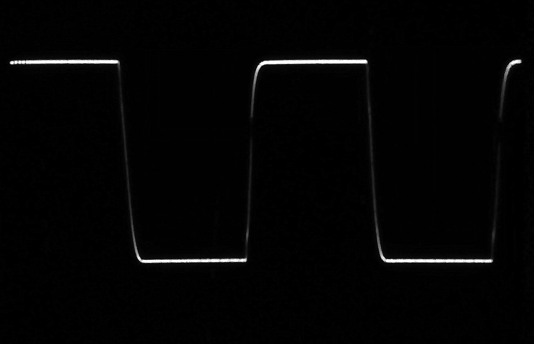

LM3886
Somewhat better results!

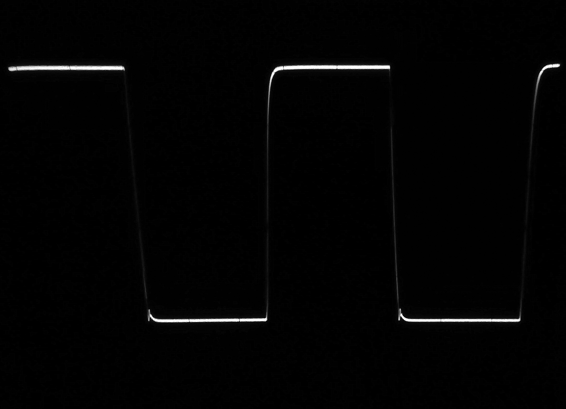

Following my stability experiments with the TDA2050 and subsequently the TDA7293, the time had come to try improving stability of the LM3886 with a single resistor replacing the CR-string.
With a gain of -5, I found the value of 470 Ohm to be about the best when looking at the square-wave response at 20KHz.
Tests with a regulated +/-25V power supply, a gain of -5 (1K/5K), and a 470 Ohm resistor between the two input pins.

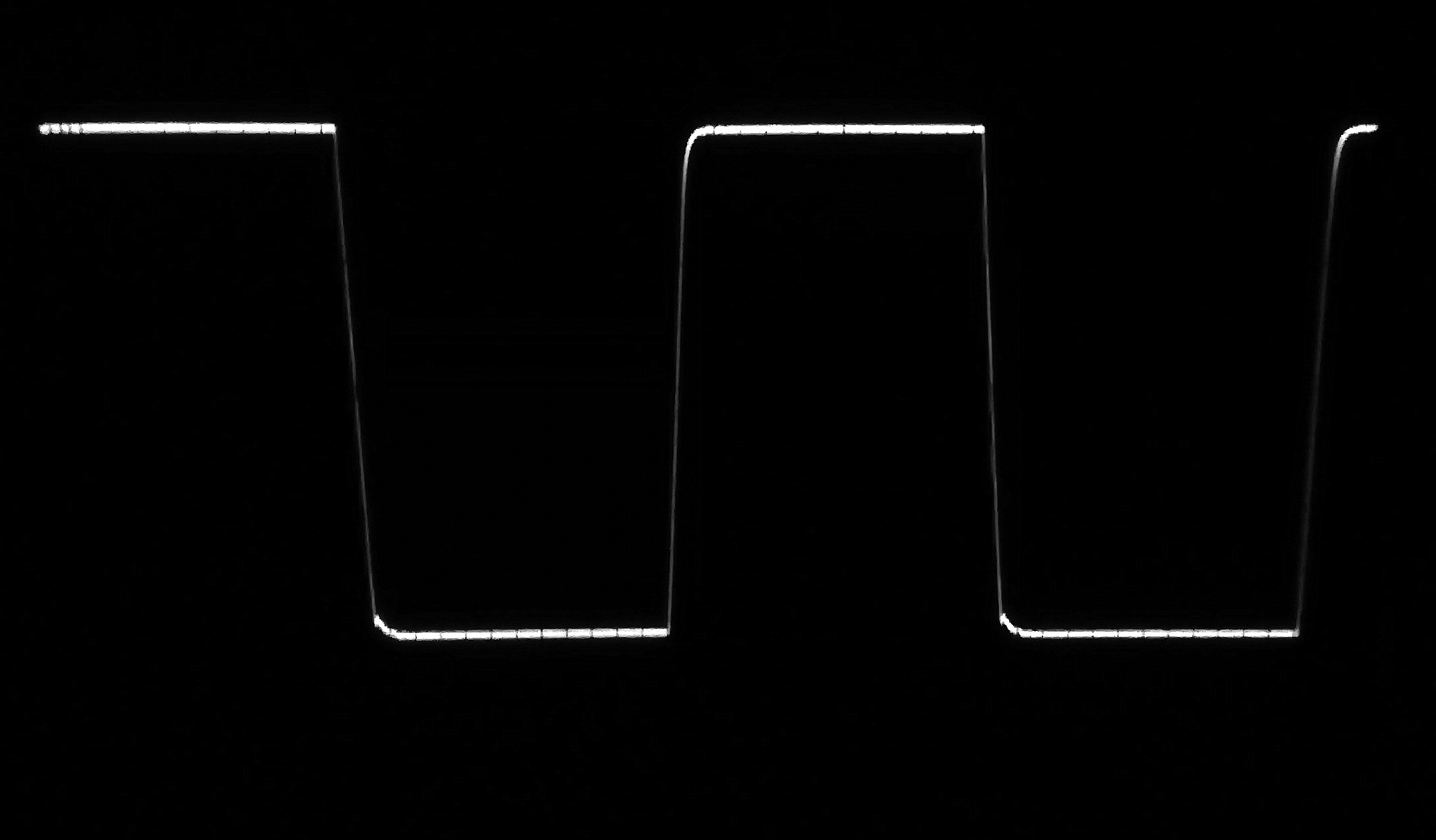

Image 1: 20KHz square-wave at 20Vpp in a 4 Ohm load.

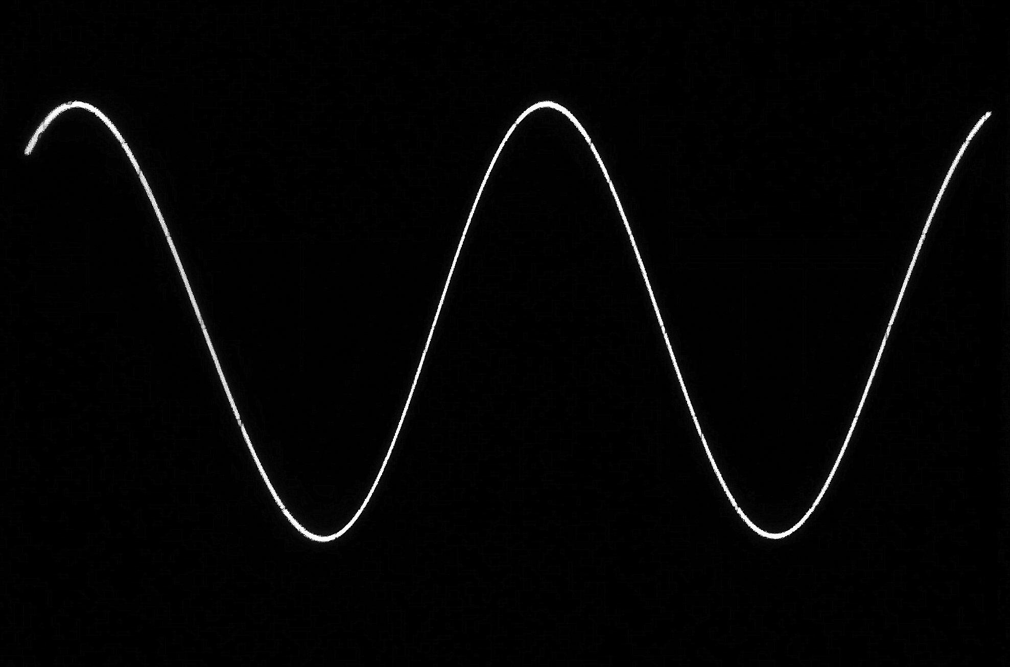

Image 2: 20KHz sine-wave and clipping at 43Vpp in a 4 Ohm load.
No signs of instability near clipping.

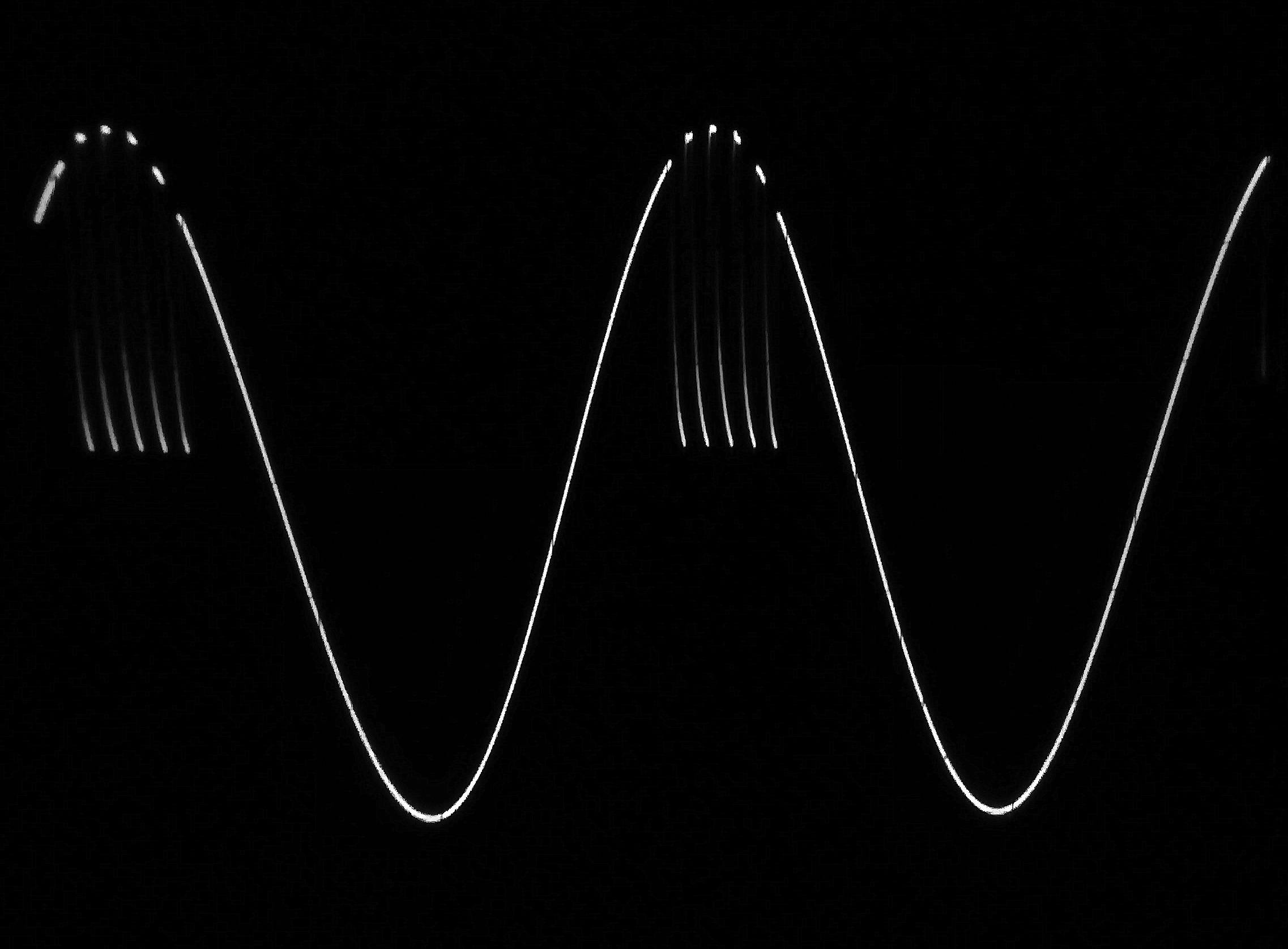

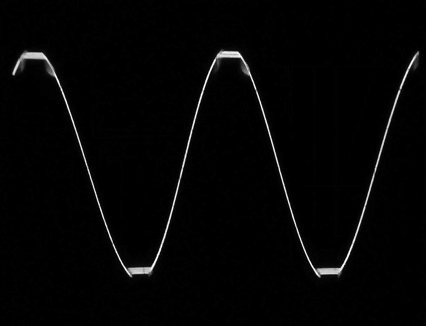

Then, repetition of the current limitation results that did not come out so pretty in posting #25.
The load impedance had to be reduced to 2 Ohm to be sure that current clipping would be reached.
I tried at both 20KHz and 1KHz. In both cases I had very little sudden oscillation from instability with that supply voltage. I had sine-wave peaks of 18V in 2 Ohm. Thus, peaks of 9A!, and quite regular clipping.
The datasheet speaks about a 135W “Peak Output Power capability”. It must be assumed to be in 4 Ohm. 135W in 4 Ohm means current peaks of 8.2A so it seems consistent.

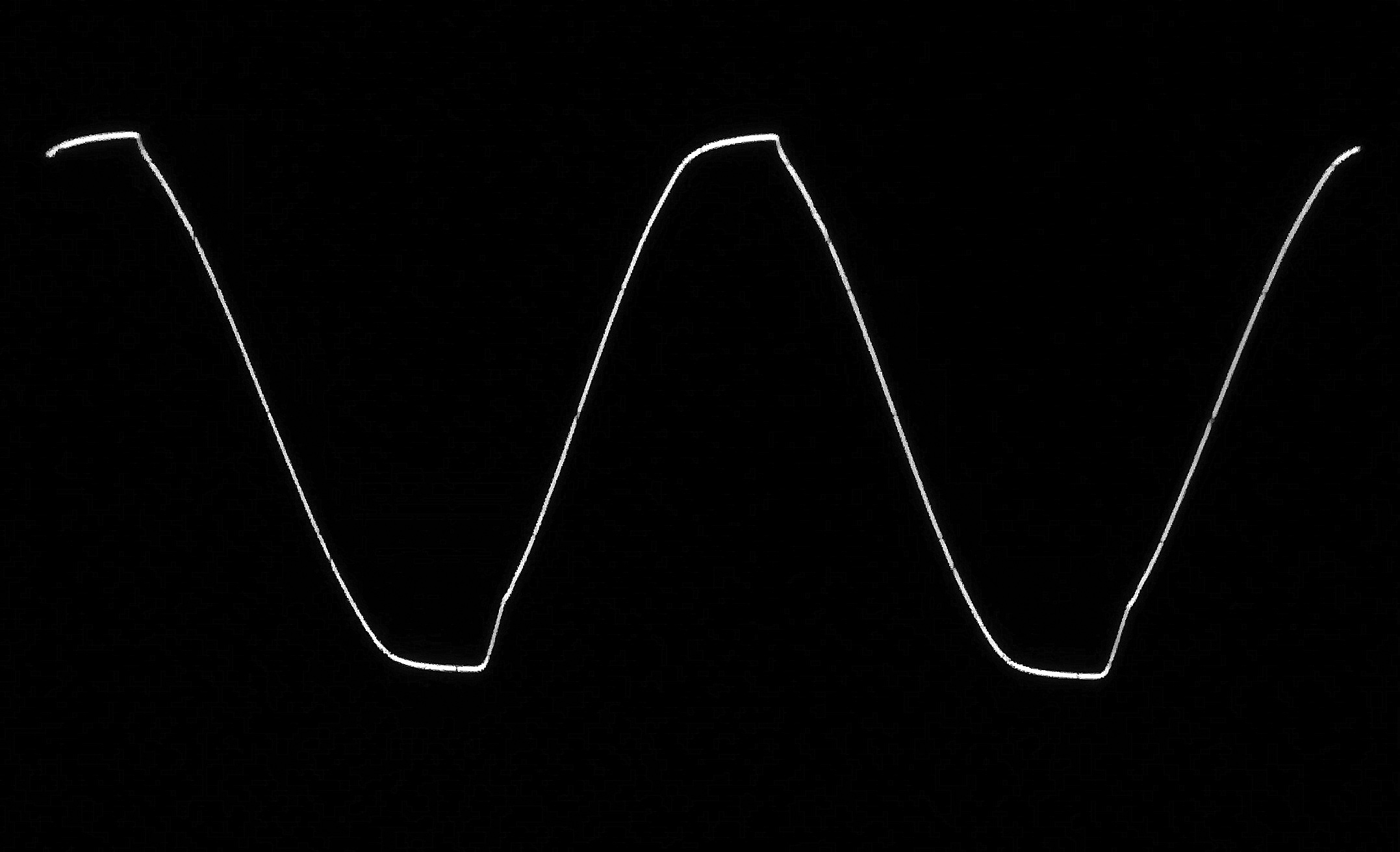

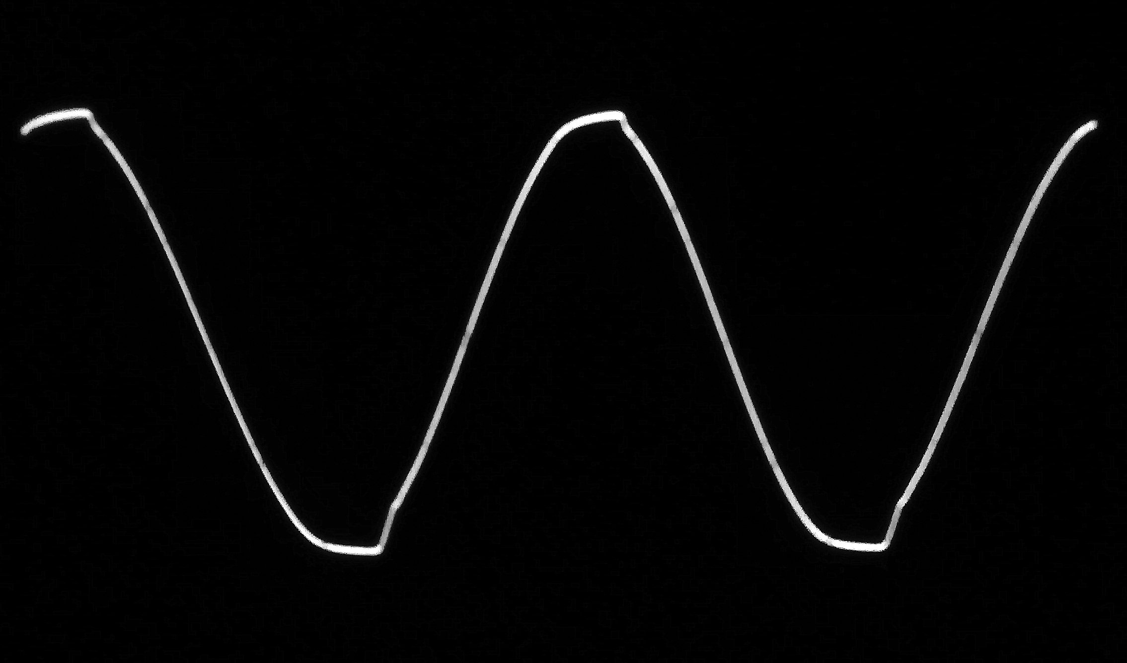

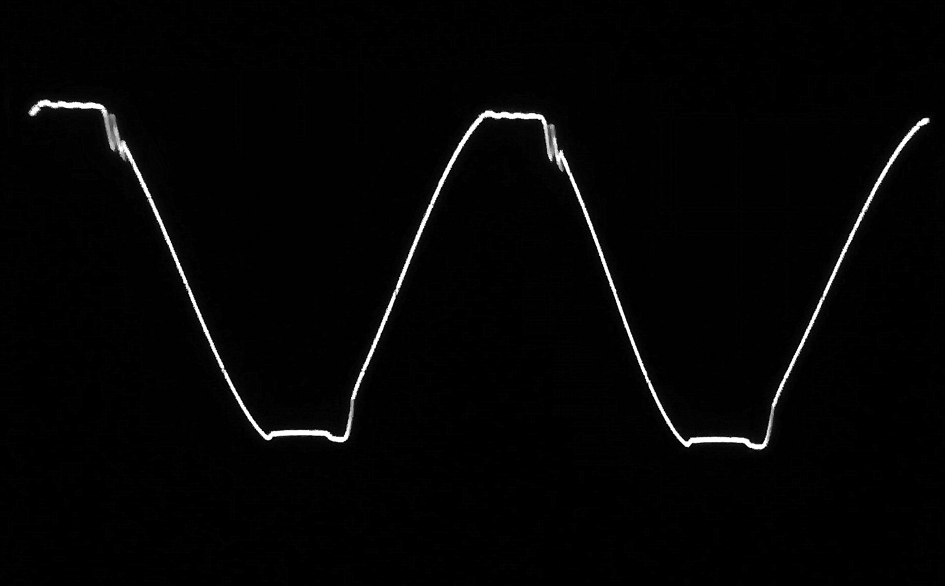

Image 3: 20KHz sine-wave current clipping at 36Vpp in a 2 Ohm load.
Image 4: 1KHz sine-wave current clipping at 36Vpp in a 2 Ohm load.
The sensitivity to capacitive loading of the output was also somewhat improved. With 10nF or 100nF at the output, there was no permanent oscillation but instability showed up at higher amplitude levels. A Thiele compensation network will still be needed.
With a 4Vpp sine-wave at the output, I measured the -3dB bandwidth to 400KHz. The output offset voltage was 16mV. Much better than for my TDA7293 (80-90mV).

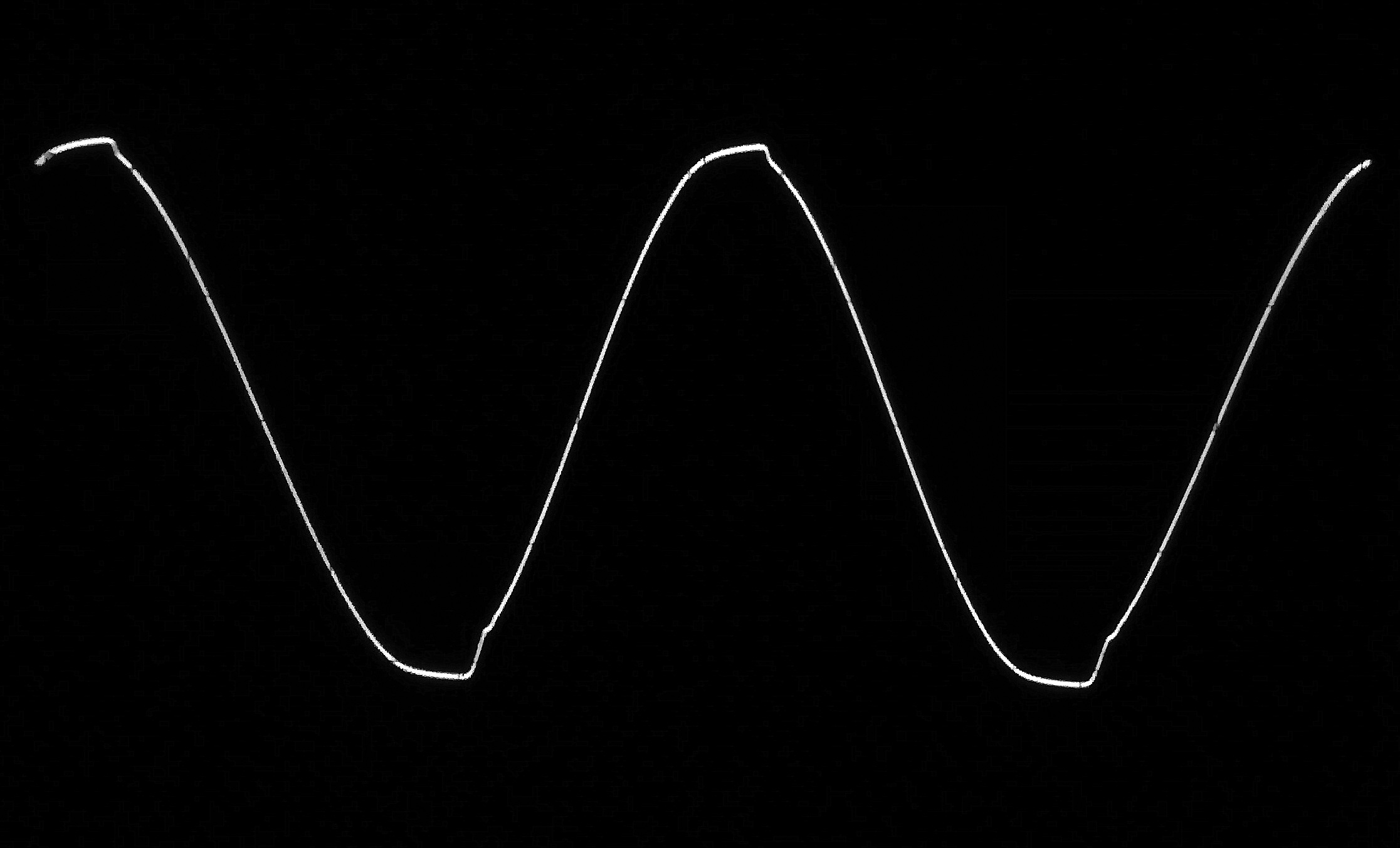

Finally I used my +/-35 V LLC SMPS as supply. The results were better than in posting #25 though some of the same instability as before reappeared. The load was 2.7 Ohm. The current limits reached were higher than before.

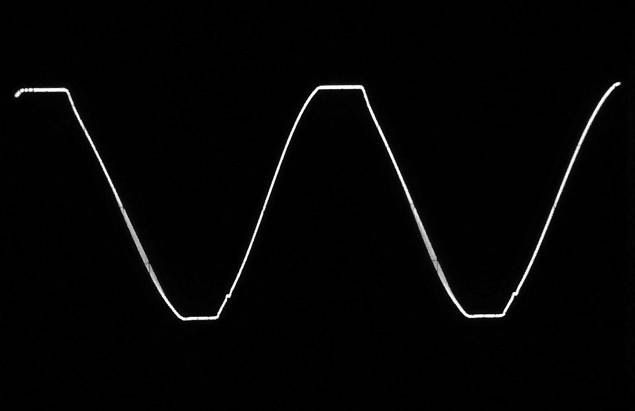

Instability started from 24-25V, corresponding to 9A, and the level stagnated at 28V equivalent to good 10A! The dynamic current capability of the LM3886 could be used. Instability at such high levels is less of a problem but indicates that the LM3886 should perhaps not be used at the top of the supply voltage range.
Image 5: 1KHz sine-wave, current clipping at 56Vpp in 2.7 Ohm.
I can only recommend to use a resistor of 470 Ohm across the input pins (and no CR-string) when using the LM3886 at a gain around -5.

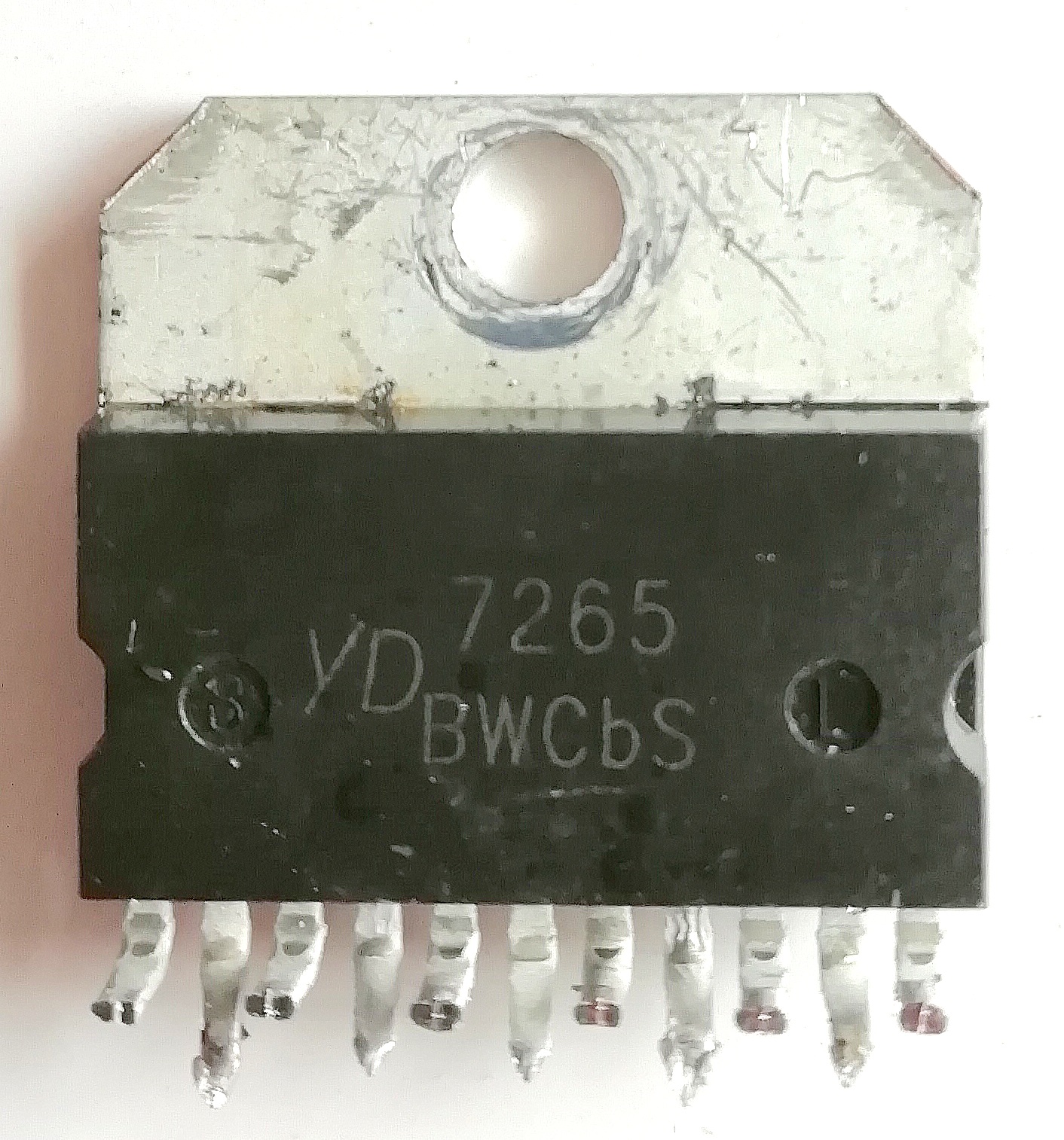

TDA7265 / YD7265
TDA7265 is a good workhorse and available at an attractive price. It includes two channels that may be combined into a single channel with almost double the current capability of a single channel. TDA7265 is supplied in a housing with 11 pins such that it is reasonable to handle for DIY.
YD7265 is a clone of the TDA7265, made by Wuxi Yuoda Electronics in China. Often clones are manufactured as second source to a known brand name, such as Unisonic’s well performing UTC-TDA2050. Once when ordering a pair of TDA7265, I received two YD7265 instead. Somewhat disappointed I concluded that this could be an opportunity to test how such a second source product would perform. Somewhere I had read that YD7265 could be a disappointment with initial defects or poor performance. So, for a start I tested my two specimens with an Ohm-meter and realized that for one of my two YD7265, one channel output was internally shorted to the positive supply pin. Thus, this defect item could be discarded right away. The other IC initially seemed to work and test results are shown in a following posting.
I would first test the TDA7265 from ST and then compare with results for the YD7265.

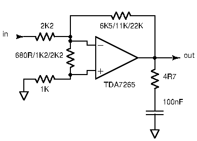

Without first looking in the datasheet, I implemented my test-board with gains of -10 (inverting). Then, I realized that the minimum closed-loop gain was stated in the dataheet to 25 dB (18 times) for stability reasons. But, as both channels actually performed without instability with a gain of -10, I let -10 be the highest gain. I subsequently assessed performance at gains of -5 and -3.

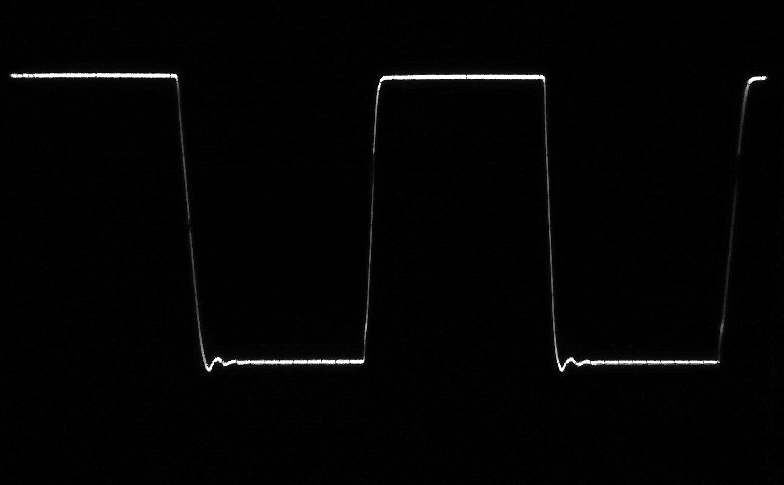

Image 1: Schematic with the essential components in the test board.
Tests with +/-22V regulated supply, -10 times gain, 8 Ohm load and no resistor between the input pins.

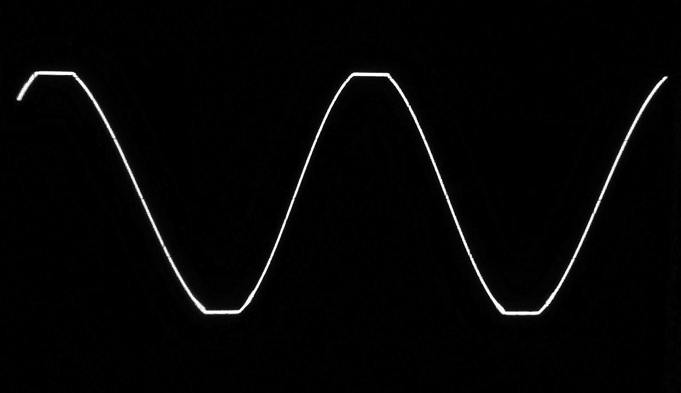

Image 5: 1KHz sine-wave with current limitation effects at 35Vpp.

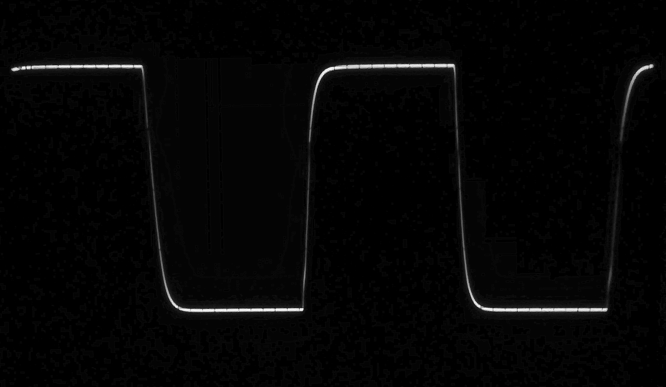

Image 6: 20KHz square-wave at 20Vpp.
Both channels showed similar results.
As seen in Image 5, current limiting effects would start at the positive half-wave around 15V with a 4 Ohm load. For the negative half-wave around 17V. 15V across 4 Ohm means 3.75A. 17V across 4 Ohm means 4.25A. The current limiting effects look like short-lasting attempts to switch off the output current and then short after allow the output current for a brief moment. That type of signal can be expected to cause an unpleasant distorted sound. The 4.5A specified in the datasheet as typical current limit seems not to be realistic and I would not rely on an output current above 3.5A from a single channel. Luckily, the two channels can be combined.
A resistor between the two input pins would reduce ringing with a square-wave at 20KHz.

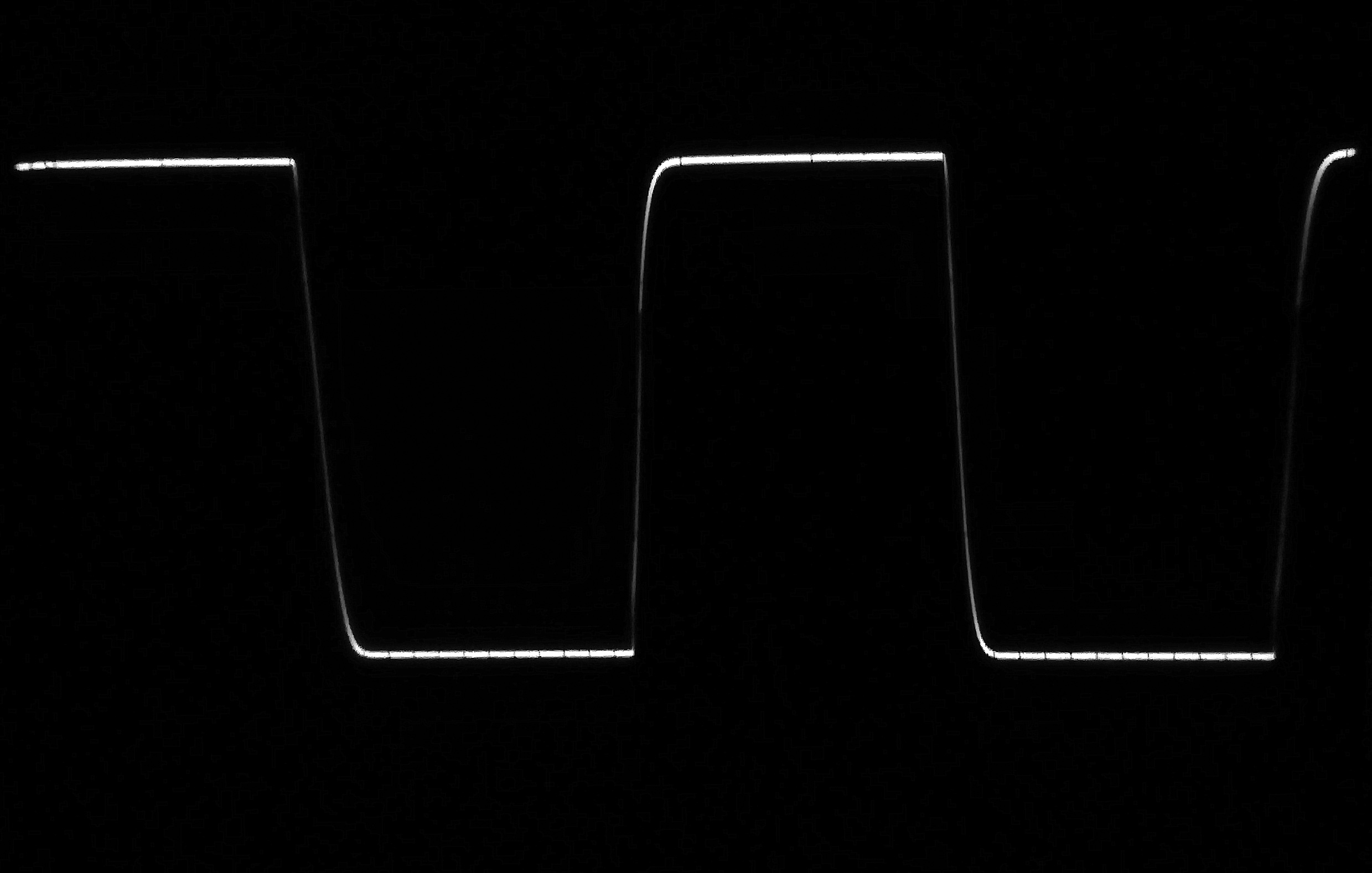

Image 7: Gain -10. 20KHz square-wave at 20Vpp with 2.2 KOhm between the input pins.
Image 8: Gain -5. 20KHz square-wave at 20Vpp with 1.2 KOhm between the input pins.
Image 9: Gain -3. 20KHz square-wave at 20Vpp with 680 Ohm between the input pins.
Similar to what was found for other chip-amps, a well chosen resistor between the two input pins will leave a well damped square-wave response.

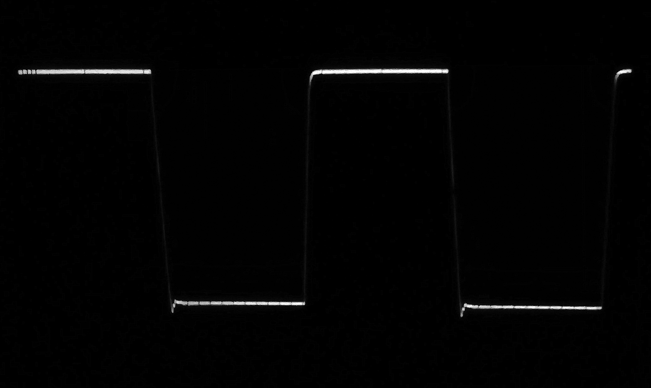

YD7265
This is a short comparative test of the YD7265 as mentioned in posting #49. The test of my remaining YD7265 specimen was quick.
For a start I checked that the IC worked without load. Both channels did function but showed noise on the signal with an amplitude just below clipping. This noise resembled the spikes at current limitation of the TDA7265.
Image 1: 1KHz sine-wave at 36Vpp and without load. +/-22V regulated supply.
I tried to load the output with 4 Ohm but the output signal would collapse almost completely. Then I tried to load one of the channels with 8 Ohm to see if that was possible. The output signal would collapse less than with 4 Ohm but would be useless as an audio signal. While I was trying to adjust the amplitude of the collapsed signal such that I could make a photo, the chip made a worrying sound and started to smoke. The power supply went off.
The YD7265 had shorted power-pins and output pins to one another and the power supply fuse was blow to protect the power supply.
Removing the YD7265 from the board, I noticed that pins 3 (+ supply), 6 (- supply) 2 and 4 (outputs) had become one low-impedance connection. Unfortunately it had at the same time destroyed my previously functional TDA7265 on the same board.
Sometimes it is nice to draw an unambiguous conclusion: The YD7265, as assessed from two specimens, is absolutely useless. One was initially defect, the other was unable to supply a reasonable audio signal in just 8 Ohm.
Image 2: The former YD7265.
