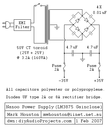

Hi people,
really interesting forum.. was lurking a lot till I finally decided to buy some kits from brianGT and get to the real work: my first chipamps.
I'm starting with the LM 1875 kit now and am stuck in cabling the toroid to the PSU:
I have TWO toroidal transformers having ONE single primary (220V) and just ONE single secondary output windings (at 13.5V).
Will I be able to use those trafos? My real question is how do I connect those trafos to the AC1, AC1_, AC2 and AC2_ posts on the PSU PCB?
I suppose I need two PSU PCBs since the ones I have have only one rectifying bridge (4 MURs) per PCB, right? no way to connect two trrafos on the same bridge (since i have 4 ACx holes 😉 ?
Ok sorry for the really silly questions but was not able to spot on the forum anyone using single secondary toroids on this forum (afaik), maybe a bad idea in general?
Thanks in advance for any hint!

Assuming both transformers are identical (you would not want to use two dissimilar ones even if they seem rated the same as ratings can vary with other parameters) you would take one secondary and connect it to the opposite end of the other secondary, thus creating the equivalent of a single center tapped transformer, the two connected together being the center tap.
When you do that, do the opposite for the high-side input windings meaning the mains AC power hot goes to the same end of the winding on each transformer, mains AC neutral goes to the other end.
Then you just wire it to the single bridge as anyone else using a single bridge, the output of which becomes V+ and V- rails while the center tap is ground.
I mean like in the folllowing picture, but I don't recall the pad designations for the circuit on the PCB you have.

Ok, so coming back to my original question, I'm using "chipamp.com's" based PCB you can also see here: http://www.chipamp.com/images/lm1875-5.jpg
And you would say to connect my two trafos this way?

well I already tried this the first time before asking here and putting the primaries in parallel, and connecting the secondaries to the PSU single bridge, but then something went wrong and it seems not ok (the fuse on the main did blow "slowly" and thus luckily saving the rest.. so probably something is wrong on how I connect the secondaries... I did as said also here: two wires of the secondaries of the first trafo went on AC1 and AC1_, the other two wires of the second trafo went to AC2 and AC2_ but it seemd not ok.. what's wront?
tent:wq
PS: I also of course measured the secondaries of both toroids before connecting them on the PSU and on both Imeasured 13.5V difference with my tester set on ACV200...

I did this but the result was a blown 2A 220V fuse.. if you look at the schematics on the chipam.com for this LM1785 you'll notice that AC1_ and AC2 are connected togheter and that it is a single rectifying brideg.. I don't know if this is maybe the trouble/difference with other PSUs like the one of CarlosFM.. Maybe I should rather build one like Carlo's one with two bridges?

Are you sure you have the right orientation of each transformers' primarys, and of their secondaries? You might have wired them opposite each other so they are out of phase?
Leave the transformers disconnected from the PCB for the time being. Connect one end of the secondary from one transformer to the opposite end of the other transformer.
Connect the same ends of each transformer's primarys together so the transformer primaries are in parallel, then wire them to mains AC.
When power is turned on, measure the voltage between the non-joined ends of the secondary windings and compare to the voltage between either non-joined end and the joined portion in the middle. Voltage between the non-joined ends should be double the voltage between either end and the joined center tap.
If you join the wrong end of the secondary together the voltage of one will cancel out the other. The same will happen if you join the wrong end of the primary to the other transformer's primary.
Once you are sure the transformers are wired correctly, and to save fuses, I would temporarily place a several watt rated, a few dozen ohms power resistor in series with either transformer's secondary connection to the PCB. That way, you have current limiting so you aren't stressing any parts but you will be able to get an output voltage reading from the power supply PCB to see if it is correct. Do this without the amp connected to the power supply PCB, test each thing as simply as possible to make sure each works before wiring it to the amp.
Unless I overlooked it, you did not mention the current rating of the transformers or their type. It is possible too large an inrush current happens when the PSU is turned on because the fuse is undersized for the transformers and capacitance of the PSU. Even if you don't expect the amp to consume as much as 2A at full power, momentary inrush current may be higher than this.
Instead of just using a larger fuse which subjects the parts to more possible damage if something else is wrong still, you could temporarily place a low, under 10ohm power resistor in series on one of the primary windings to limit inrush current, then remove it once you are sure everything is working ok. If you have no power resistors you could temporarily remove the capacitors from the PSU PCB and measure the output voltage to be sure it is roughly what is expected to confirm the rest of the PCB is wired correctly without as large an inrush current.
If and when everything else seems to be working properly based on voltage measurements, if you are then still blowing fuses you may need to use a larger fuse or more safe would be to permanently place a NTC thermistor in series with the hot AC input, but it would need be one of low ohmic value because at the low continuous current levels the amp would use, the higher the value the more significantly it will drop the transformer output voltage.
Warning: when I wrote "connect" one end to the other, I didn't mean electrically connect, I meant connect your multimeter for a voltage reading.
Do not do what my prior post implied, and I apologize for the ambiguous wording I used. I always mean, take measurements with a multimeter to confirm each subcircuit is doing what you expect it to.

ok this makes sense! I probably connected those two trafos out of phase! so simple and so stupid.. 😉 I'll try it out again just now (but still a bit scared about the warning of your second post.. should I consider the post edited an read it as I did?).

ok I did the test again settupping it like ! suggested and it is working now (no fuse blew) at least with no bridge connected, only with the two trafos. And I read 13.4V difference between the connected point of the secondaries and the non connected ones; while I read 27V c.a. between the two non connected ones.
But hey I have a problem now! this means I do not have any more the 13.5V I needed for the LM1875 at 4ohm speaker load I was planning: now I have 27V (all before rectifying so they are going to rise by 1.4 c.a.) so this is probably something to go on an LM3886 at 8ohm speaker load! Do you confirm?
