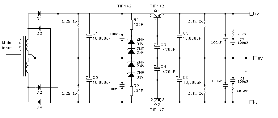

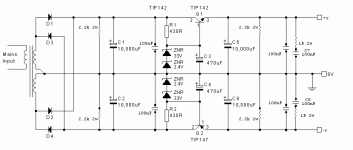

bmwpowere36m3 said:I'm interested in building a "regulated PSU" for my LM3886 gainclone project. I plan on building it for maximum output @ 4 ohms, just in case so I have a flexible system that'll work with a variety of speakers. So with a planned 25-30 Vcc, the continuous output would be ~68W (2x, stereo). After much reading I'd like to build Pedja's Discrete PSU (Module R), however on his site the listed schematic follows:
and on Nuuk's is:
Differences (Pro's & Con's)? R1-R4 are different, in the top schematic he mentions they are charging resistors for the second set of capacitors. Also neither include bleed resistors on the capacitors.
Looking at commonly available zeners' (25, 27, 28, & 30 V), in the module R manual he lists Vishay BZX79 which seem no longer to be manuf. What should I looked for, 500mW power dissipation, DO-35 package, etc...
Also trafo secondary voltage, the manual mention selecting a voltage at least 4V higher than the zener's with 3-4 V on top of that fine for headroom. Is this voltage pre or post rectification? i.e. if I chose to use a 27V zener, then would a secondary voltage of 22 V work (post rectification 31 V)? Finally VA rating conservatively 250VA should be enough, or more or less?

I have previously built a zener/pass-transistor regulated PSU which wasn't exactly like either of those, but was somewhat similar. The amp sounded good with it, but ultimately I feel it would be just as well to use an IC, a linear regulator plus pass transistor instead of a zener for regulation, an example of the basic circuit I mean can be found in National Semiconductor's LM317 datasheet.
R1-R4 form an RC filter but most people don't seem to feel it is worthwhile since they omit resistors in these positions (regardless of whether the rest of the PSU is the same, anyone could use a circuit topology with the equivalent of R1-R4 and 4 instead of 2 capacitors.
You could include bleed resistors on the capacitors, it is not a bad idea at all. It's just that with any basic circuit topology lots of things can be added for different reasons, some very good reasons and some just tweaks with less and less improvement the more parts are added on, generally speaking (though there are of course exceptions).
To determine zener power rating you will have to calculate how much power is dissipated, which depends on the resistor values between the power rail and the zener, how much current is passed * voltage difference between the zeners and the pre-pass-transistor voltage. If the right resistor values are used, yes you should be able to use a 500mW zener, with the pair of BD139s (Or BD140 on the other rail) you have enough gain that the current shouldn't need be very high at the zener. The package type you use depends on convenience in mounting to the circuit board you want to use, or since it's a DIY design you can pick a zener with easy availability and design the circuit board around using that type.
The input voltage requirement would be the voltage after the rectification. 31V post rectification is cutting it too close with a 27V zener, unless you are measuring the 31V with the transformer at full load, full output power. The point of the additional 3-4V margin is that under load the initial voltage before the pass transistors (BD911/912) will have dropped some so that 3-4V is a margin to allow for voltage drop.
So based on what you have mentioned of the recommendations, if you want to use a 27V zener you would want at least 34V after the rectification stage, or
(34 + 1.0 [approx voltage drop of two schottky diodes SB560]) / 1.41 = 25V AC rating on transformer.
Edit: What I wrote above is not quite right, since a transformer is rated for it's voltage at the rated output current. If it's rated output current is similar to what you expect the amp to use, the 3-4V margin can be reduced to almost zero, if it's rated output current is higher than you'd use, the margin might even become a negative number. If it's rated output current is lower than amp peak current consumption the number might (but is unlikely to unless the transformer has very poor regulation or is much too small for proper use) be higher than 3-4V.
Either way, that is only the additional margin, no matter what the additional margin is you still need 4V more between rectification and pass transistor than the voltage of the zener(s).
Personally what I like to do is pick the transformer I want, then based on it's voltage rating and post-rectification stage voltage, then pick the zener value so that you don't have so much loss (don't need as big a heatsink) on the pass transistor, though this also requires a transformer with a voltage rating not too high, so you can do this without exceeding the max voltage you amp can tolerate.
If you wanted some other voltage and can't find the right zener value for it, you can just put two zeners in series. For example 33V zener then 2.4V zener = 35.4V zener. Attached is a more simplified pass transistor type PSU showning two in series, though it uses smaller resistor values because that causes higher base current to drive a single darlington transistor instead of getting gain in drive current from two BD139 before the BD911.

Something else about building a zener / pass-transistor type PSU, you may want to buy several zeners and pick the ones that measure to be the closest match in voltage, so your V+ to Gnd, and Gnd to V- voltages are as close to the same value as possible.
It seems that the higher the zener voltage rating is, the more variation there is in actual voltage of each zener... something about rating them for % accuracy, means the higher the voltage rating the more that % * voltage can result in deviation from spec'd voltage.

Great, well I'm planning around the amp's continuous power rating of 68W at 4 ohms with a 28Vcc. Based on the spec sheet that equates to an Iopeak of 5.8A and looking at trafos of 250VA size their rating is (25-30 V secondary) is 4-5 A. So for the "most" part, when not taxing the system, the current demands of the amp will be less or equal to the trafo. So the 3-4V headroom is sufficient, correct?
Yes, to result in 28Vcc a 4-5A transformer rated for 25VAC would be good.

two channels of 68W+68W require a transformer between 136VA and 272VA.bmwpowere36m3 said:the amp's continuous power rating of 68W at 4 ohms with a 28Vcc. Based on the spec sheet that equates to an Iopeak of 5.8A and looking at trafos of 250VA
Your 250VA is perfect.
The 5.8Apk only applies to sinewave into a resistive (non reactive) load.
The transient peak current into a 4ohm reactive speaker load could be around three times this, i.e. ~17Apk.
That is way in excess of the chipamp specification. The transformer can easily meet this transient requirement.

I'll try it out anyway, would this probably silent the trafo also? 😉
The mains input voltage is at unloaded status: 236V AC
Thanks,
tent:wq
(PS: my english is probably a bit limited.. sorry..)
a bi-fillar winding has two separate (insulated) wires wound on the core.
If you separate the wires into two windings, each produces the same voltage but has half the current capacity.
A 10A, 13.5Vac bi-fillar secondary becomes 5A, 13.5Vac + 5A, 13.5Vac when separated.
This will not solve the noise problem. It will allow you to run the good transformer with the voltage you need.
When you have altered the bad transformer, you may discover that it has been wound/wired incorrectly and now operates quietly, but this is unlikely.
When you feed 236Vac into the transformer, what is the secondary Vac when there is no load on the secondary?
AndrewT said:Hi,
Wow, I see, So I'll try to disassemble the trafo and see what happens now..
The secondary output load is 13.4Vac.
Now I tried also with the light bulb tester and curiousely enough the 60W bulb stays on at amp powered on!! not really bright but also not dim.. 🙁 I'm going to recheck everything again now.. grr..
