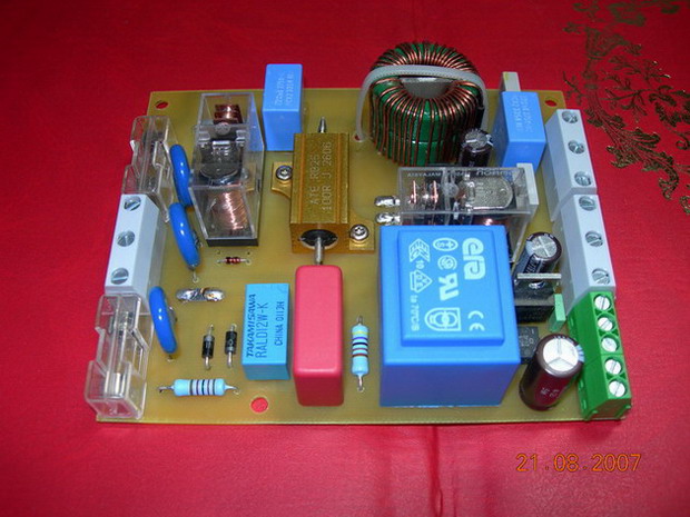

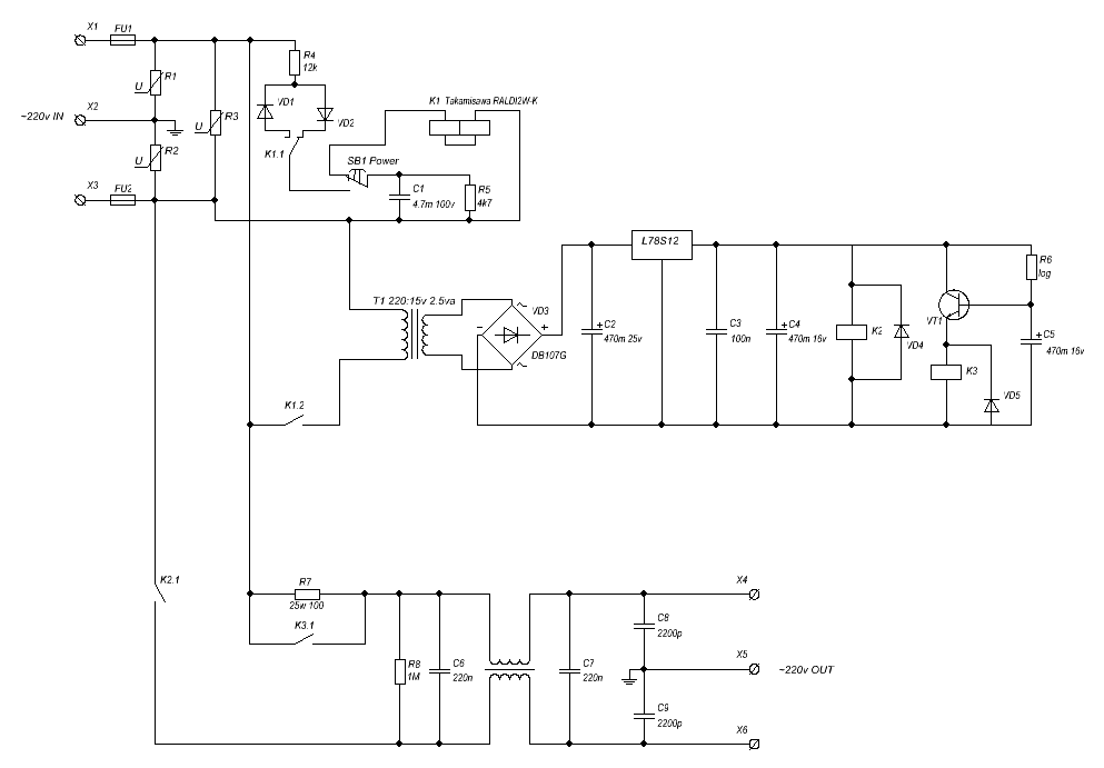

No, this part powered if you push the power button SB1 and consumes an electricity at the moment of switching. Only varistors directly connect to mains but you may not use they, and you may not use the interference suppressor.a complicated soft start circuit.
And part of it is direct mains powered!
Skip C1, R4, R5, VD1, VD2 and replace K1 with a latching relay for mains voltage. That is easier to build and much safer.
Then the power button with fixing is necessary.Skip C1, R4, R5, VD1, VD2 and replace K1 with a latching relay for mains voltage. That is easier to build and much safer.
If you mean with fixing that you need a switch instead of a button, then no. A latching relay toggles between its two states by means of a ratchet mechanism each time the coil is exited. You often find them in building installations, where lights must be switched on and off from many places, e. g. in an aisle, and where this type is used. Other styles are available from many manufacturers.
There are two types of latching relays. For use with a single pushbutton, the single coil type is the right choice. The type with separate coils for setting and resetting requires two pushbuttons.
Latching relay nice thing but I already used my scheme =)If you mean with fixing that you need a switch instead of a button, then no. A latching relay toggles between its two states by means of a ratchet mechanism each time the coil is exited. You often find them in building installations, where lights must be switched on and off from many places, e. g. in an aisle, and where this type is used. Other styles are available from many manufacturers.
