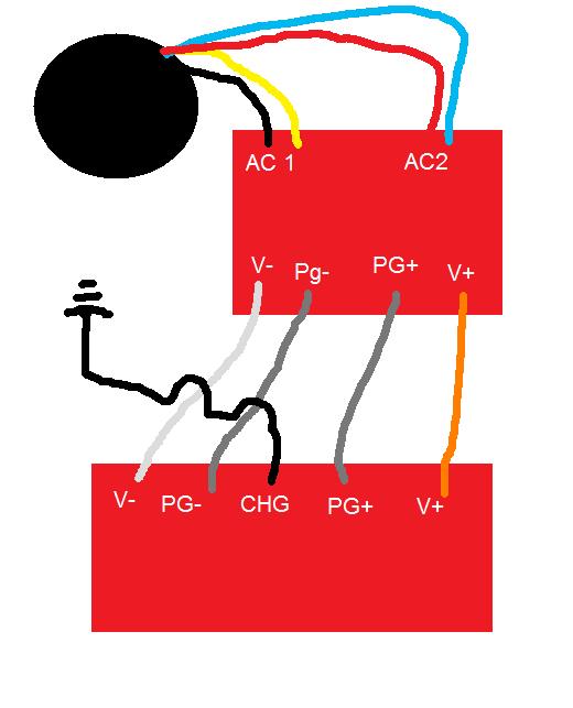

I just plugged my OTHER psu into an amp board, the light buld glows full intensity but there is no immediate heat or humming.... stand by for a diagram.

This should be perfect??1?
It is perfect! I took them apart and put them back together and now they work magically.
Output level is too quiet though!!

The voltage drop across the bulb is very high. This results in a very low voltage drop across the transformer.
Simple maths says that if you apply 11Vac to a 110Vac transformer and you will get ~ one tenth of the output voltage, before the voltage drop of the rectifier. Similarly a 300VA transformer will be downrated to ~30VA when fed with 10% of mains voltage.
you might have <=5% of mains voltage across the transformer.
It is impossible in this bulb protected test to smoke the components.
