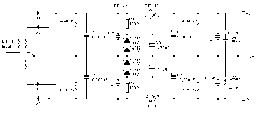

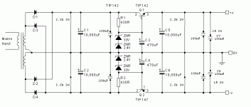

Since a capacitance multiplier is a simple concept and CarlosFM has posted various schematics of his LM338 implementation, I'll attach an example of a zener pass-transistor PSU, one that uses two zeners in series to get closer to a target voltage if a supply of zeners for the target aren't readily available (but if they were available then certainly one zener instead of two in series could be used instead).
It is an example only, to go to the trouble and then not make the next step to a true regulator IC doesn't seem logical unless someone were limited in budget and needed to use parts they already had to build something meaning the circuit topology might be similar even if the parts values were changed.

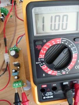

I have just built a couple of adjustable regulated power supplies for a pair of Pedja's discrete buffers. I have read somewhere that I can put a low value resistor after a single reservoir capacitor to help filter the supply.
Can someone suggest a suitable value?
Richard
that creates a CRC filter.
Find your excess voltage when worst conditions apply.
That is the maximum voltage you can drop across the added R of the CRC. use a resistor combined with your output current that drops <=your excess voltage.
If your excess voltage at worst case conditions is very low or negative (i.e. dropout @ low mains voltage and maximum current draw) then R<=0r0.
