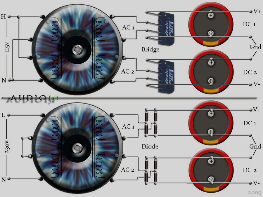

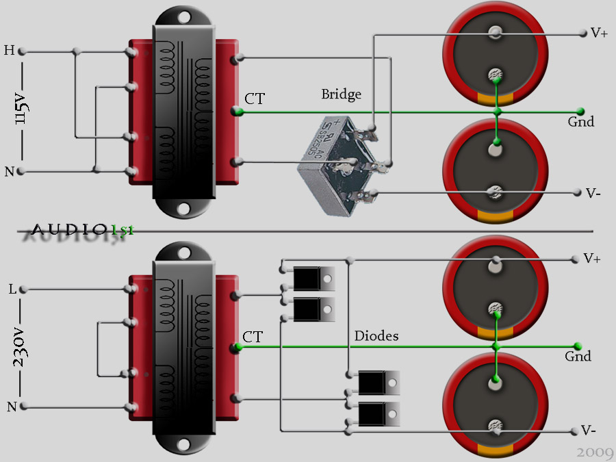

Here are some diagrams that I hope show anyone new to dual voltage supplies, how to get the V+, V- and Gnd from their transformers.
First the centre tapped transformer.
Neon switch help required...
I went to buy an IEC socket, fuse and switch combi unit for building my first gainclone, and they only had the version with a DPST switch with neon. The brand is Bulgin and I got it from RS in the UK.
The datasheet confuses the hell out of me. I'd be fine without the neon bit. Please help me out!!
There's 4 pins on the switch 1,2 on one side and 4 & 5 on the other.
They're all isolated at off. At on, 1 joins to 2, 4 joins to 5. 2 bridges to 5 within the rocker, passing through a resistor and a neon bulb.
How should I wire it up to the socket and the traffo? I'm wondering if the live passes through the resistor and neon by using pins 1 in and 4 out. It doesn't make sense to me that it would.
Here's a URL to the item: http://uk.rs-online.com/web/search/searchBrowseAction.html?method=getProduct&R=2111001
Many thanks
Lucas
LucasAdamson,
AC input cord is wired to pin 1 and 4. Output to transformer is pin 2 and 5. When you flip the switch on, that will make 2 and 5 live, so the neon bulb is lit. Since it is AC power, and since neon bulbs don't care about polarity, you could put hot and common AC leads on either way, hot to pin 1 or to pin 4, but if there is other circuitry involved like the fuse, whichever pin that connects to should be wired with the hot AC lead.
Thanks for that. So basically, I wire it just as I would were there no neon bulb there at all. I had it up and running last night by dismantling the switch to check what the pins were and what did what.
I have a power supply up and running now so thanks for that. I put the hots to the resistor side of the light (1&4), so that it would run through the resistor before reaching the bulb. I had to dismantle the switch to work it all out though, as there was no diagram.
Impossible for a man of my education without this forum. Many thanks!
Lucas
