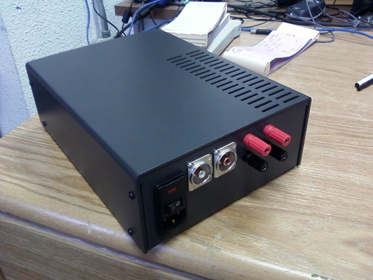

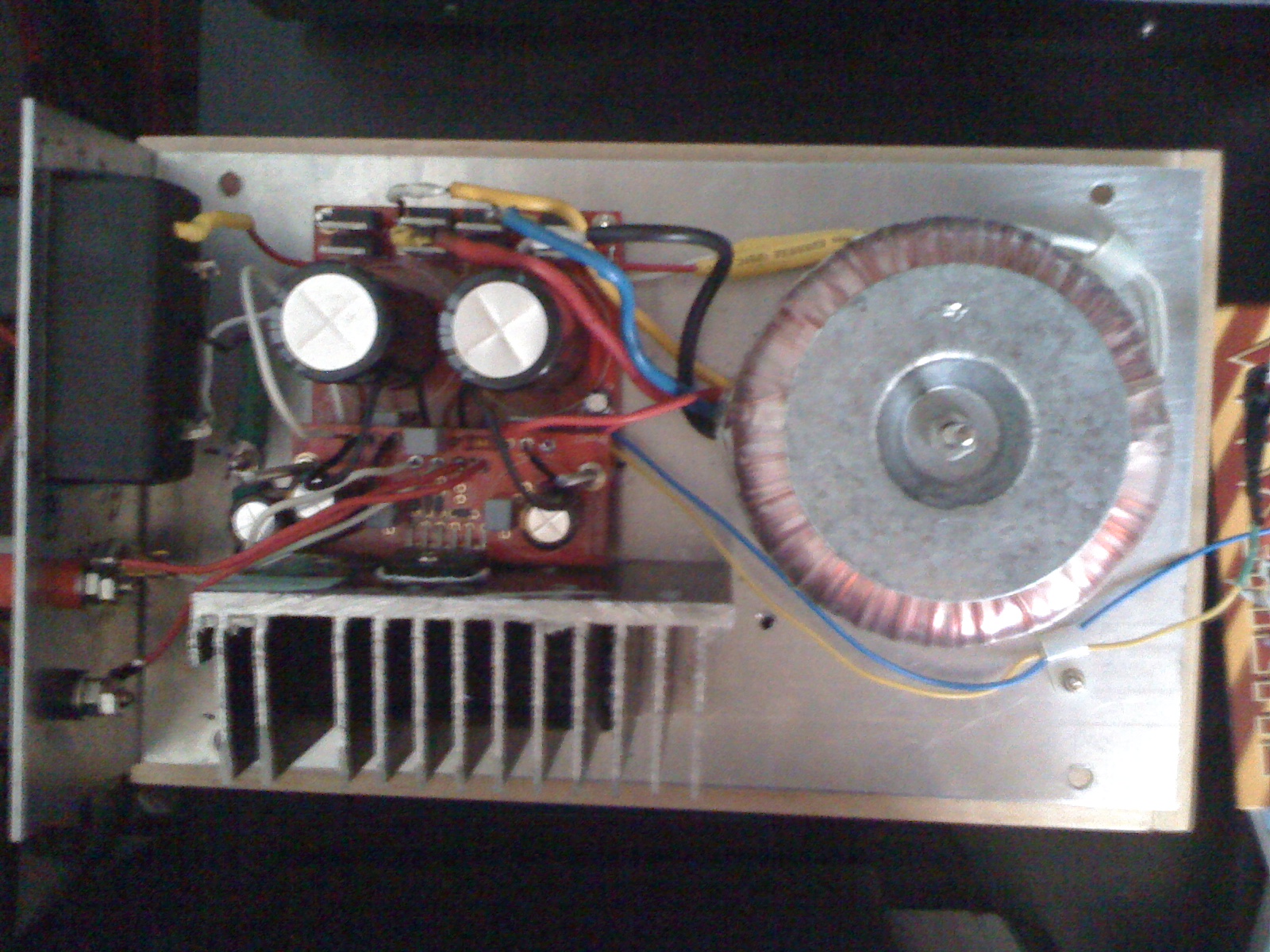

Mono Blocks with TDA 2050

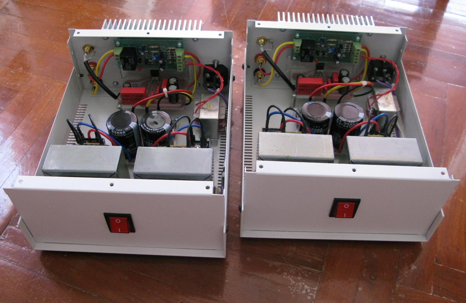

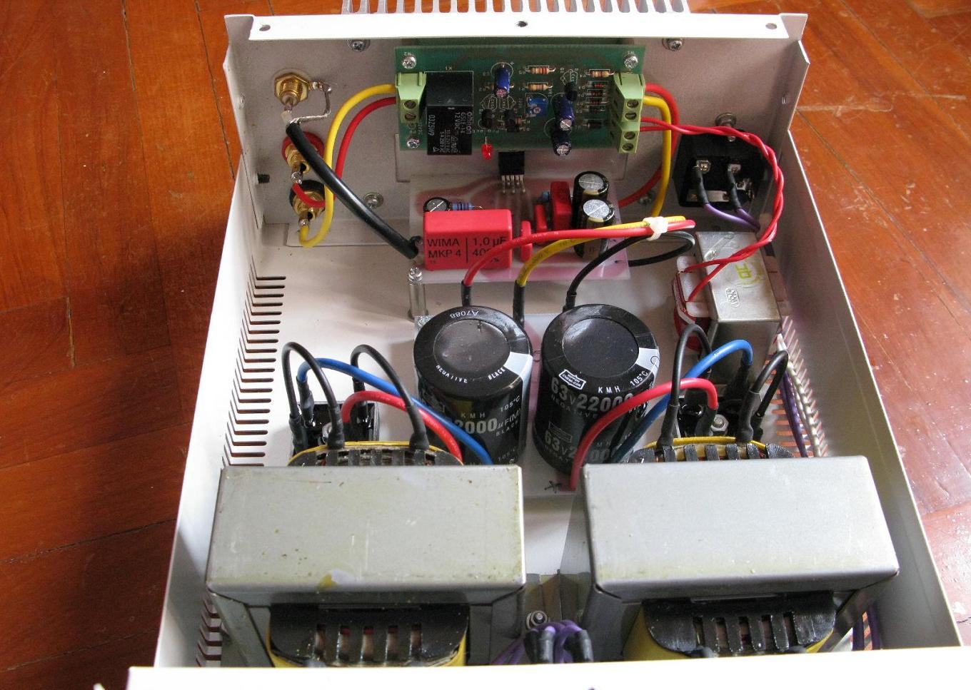

Here are my TDA 2050 mono blocks.
I was inspired by Thomas Bethe, he allready build this amp.
The transformers are nothing special, but will do the job.
Each mono block uses 2 pcs 22.000 uF for the power supply.
The TDA is running at + / - 25 V.
The TDA Chip sits right at heatsink.
All Caps are WIMA and Cerafine.
I have add a DC protection, because the TDA have no protection.
I keep the signal path short as possible.
The sound quality is very good, even for this low price.

Internal layout and work looks very professional!

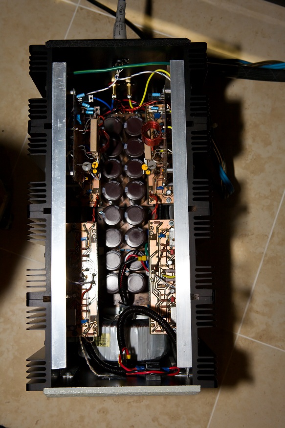

My first chip amp

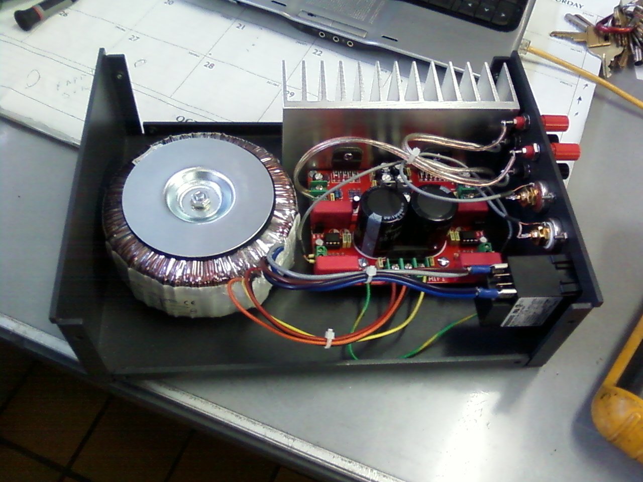

8 LM3886 200W per channel. 600VA 27V and 240,000 uF. I think I overdid it with the caps, but oh well, the more the merrier. Overall, very nice sound, no hum and very very small hiss at the tweeter at about .5 inch.

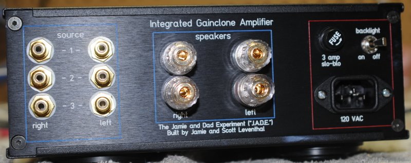

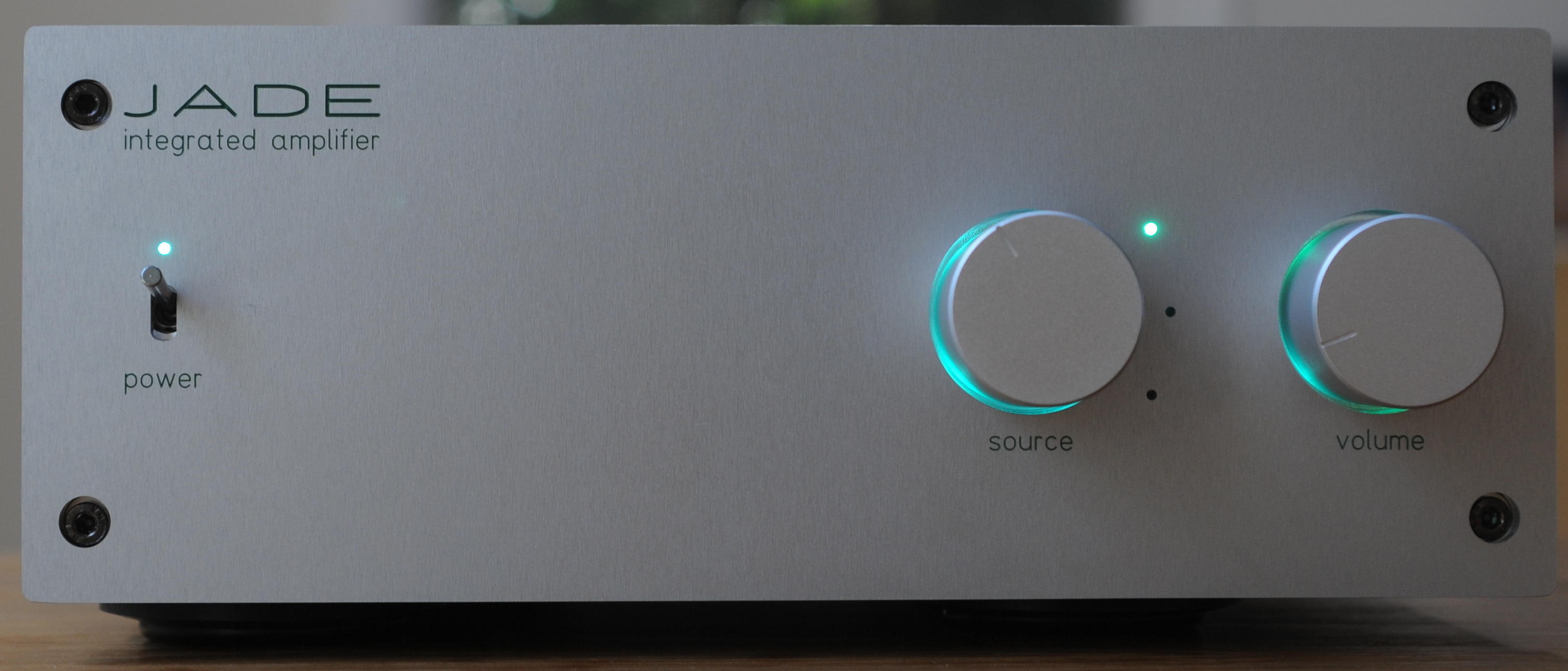

When I made the offer, my 13 year old daughter jumped at the chance to help me build a small integrated amplifier for her bedroom. She did about half the work (including assembling the BrianGT boards and most of the other soldering). We used an extra HiFi2000 chassis and Front Panel Express cut, engraved and colored the front and rear panels. The amp sounds great, she's happy and we had a little bonding time (very important, for reasons all parents of young teenagers will appreciate). All in all, a great father-daughter project.
Scott

I have to say, it is very nice amp and even better when you know you got help from your daughter. my congratulations for you and your daughter!;)
