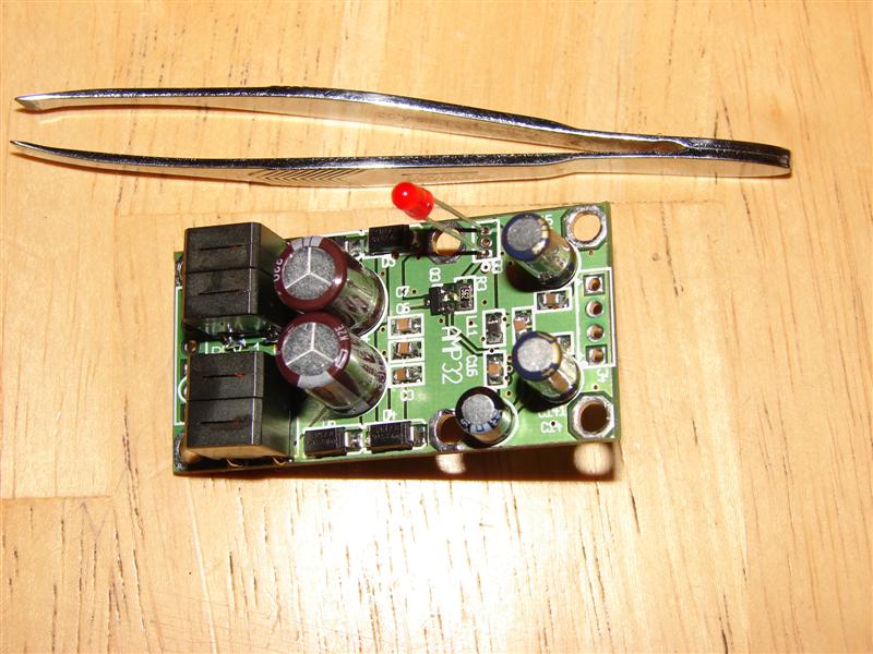

5 channel LM3875 driving into 5 4ohm speakers, plus a 200 watt discrete block that drives the sub.
No input caps at all, film caps directly across the rails.
25-+ volt rails for the LM chips, and -+55 volts for the sub amp.
yea, very on the heavy side.
Also finished the controller for it, which is a timer based circuit that controls soft turn on, dethump, etc etc.
I have more pics of it if anyone is interested.
it may be inappropriate but u can see all the pics by copying the image source location (right clicking the above image) and pasting in browser address bar.
