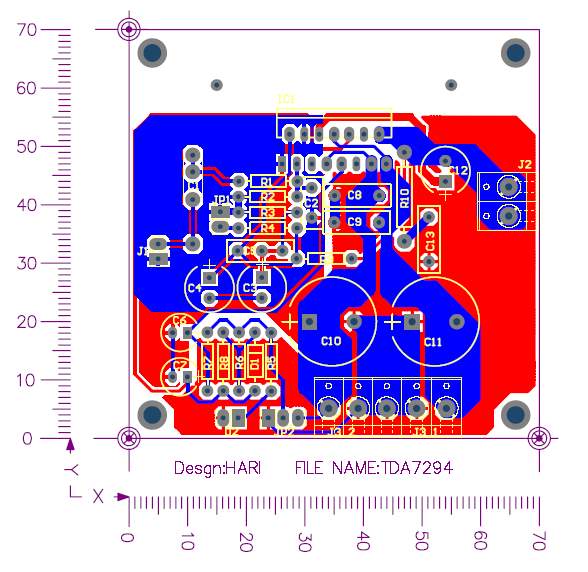

you are welcome to put the circuit that controls the fan speed here.
Abbe, this thread is for showcasing finished chip amps.
Please create a new thread for the TDA7294 pcbs or use one of
older TDA7294 threads, if that is appropriate.

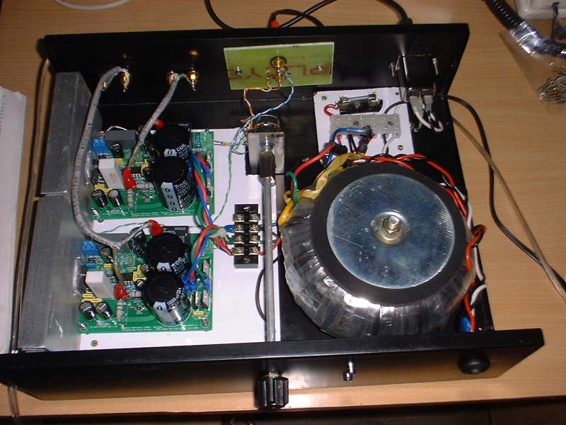

Folks,
I completed the MyRef RevC from the recent group buy.
The chassis has a spartan, industrial look, and everything is made easy
to remove. I mounted the PCBs on a "mezzanine" card of bakelite.
The shaft coupler is the brass insert from a 60A electrical connector.
The front bushing for the shaft was scavenged from a cheap rotary switch.
The power switch contacts have 1KV rated caps across them.
No turn-on or turn-off thump at all, and the amp is dead quiet. DC offset is like 5mV.
Some things like the cheesy LED holder and the knob will be replaced once I
have better ones.
The build pics are here -
http://picasaweb.google.com/prasadb/MauroMyRefRevC#
Thanks for looking
Prasad

Hi
Look great well done. What value are the 1Kv caps accross mains switch terminal ?
That something I need to do so the info would be great.
Many thanks
dh
Many thanks
dh
Thanks, dh!
The value of the caps is not too critical.
Use 0.001 uF to 0.01uf 1KV (or higher) ceramic caps across the switch contacts.
Apparently, the high voltage rating is required to tolerate inductive kick back
from the transformer.

A few pics of my 'assembly project' for the biamp I'm using to drive my new Fonken167s with woofers/subs in the base.
Chassis was recycled from dead CD player. Cherry faceplate and knobs, paua dot markers.
Controls: (L to R) Power, Full-range volume, 'Master volume', Balance, Input select.
Amps:A pair of myref 3886 amps drive the Fostex167s.
An eBay TDA7294 amp does woofer duty with signal via a low-pass (~300Hz) filter.
Cheers
John
