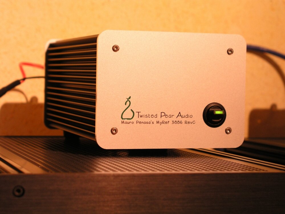

Re: heatsink enclosure for 3886 RefC
Who makes that case? It looks nice! Good job!

the cases consists of heatsink profiles from http://www.fischerelektronik.de and milled front plates from www.schaeffer-apparatebau.de / www.frontpanelexpress.com.

Indeed a sharp looking amp.
Did you ordered those alu profiles directly from Fischer Elektronik or through a retailer?

Hi GeWa,
I have ordered the alu profiles in meter pieces directly from Fischer. They were expensive, probably you can get them cheaper from a retailer like Schuro.

Arne (1543), can you tell more about prices - especially this front panel. Your enclosure look great!
Hi veteran,
the frontplates were 28,70€ each and the heatsink profiles costs around 50€ for each amp.

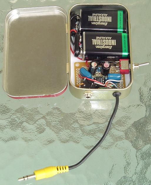

CMoy Headphone Amplifier
Attached is my latest project. A CMoy headphone amplifier. It uses the OPA2132PA opamp.
On the success of this project, I want to try a desktop unit with volume control, bigger input caps, regulated power supply and bypass caps on the chip.
There are a couple more pictures and details at my website.
Overall, the CMoy performs well and it increases listening pleasure with a good set of headphones.
Gio.

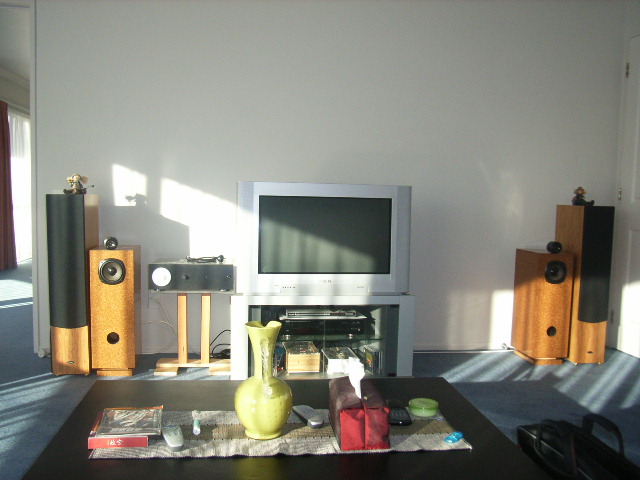

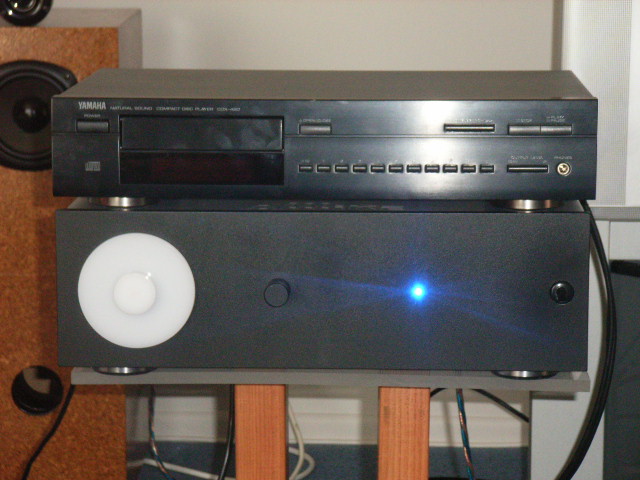

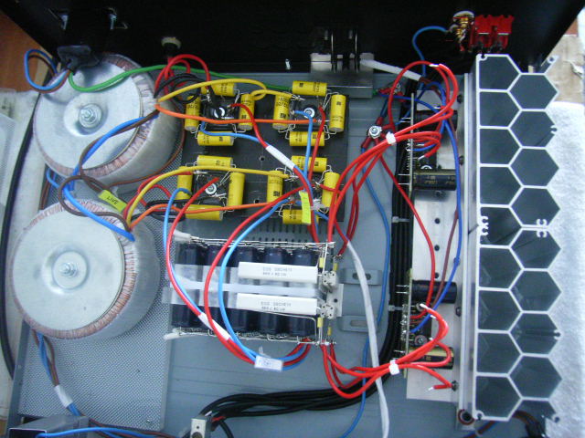

Rebuilt LM4780

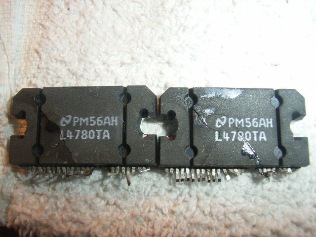

Well after cooking the first set of chips my first Lm4780 is up and running.
This has been a long process(1 year) since I first ordered the chips from National.
This one sounds way more dynamic if i could use that term without getting too airy fairy. I think this has to do with the power supply, as this one was built with a dual mono and it is a parallel design. I used two 300va trannies and four bridge rectifiers.
I think this made all the difference, more power😉
Anyway its not perfect, as there are a few things I'm still sorting(tweaking) as you do..............
