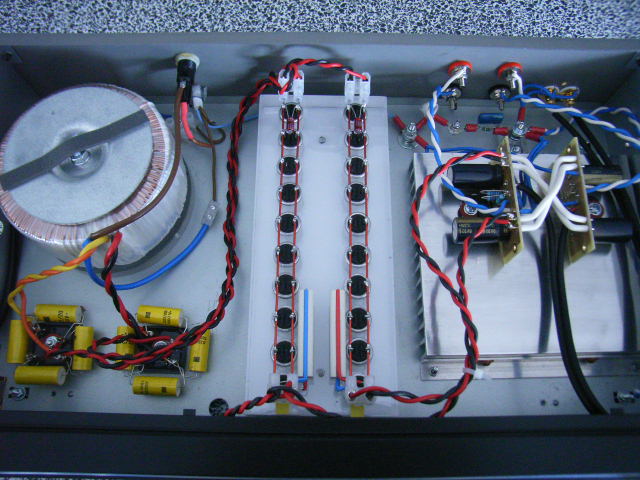

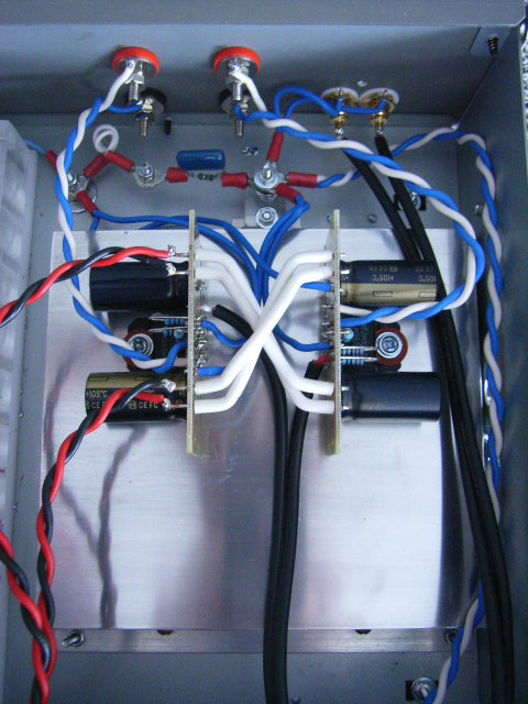

LM3875
The unit is an old Yamaha CD Player.
Trans = 300VA 25/25
Two 400v 30amp Rectifiers
Caps are 1000uf x 10/per rail
Snubber caps 1000Vdc 22nf
I think I posted a pic of this before, but I had to pull this apart to do a quick repair on the led board so I took some of the inside.
I built this about a year ago and it's been running fine.....

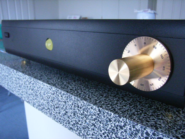

Front
I replaced the volume knob with this one, which I'm trialing for my next amp. I got this from an exellent site called, thlaudio.com
They are in Taiwan, and are very good, well packaged.
I went for the big yellow led instead of the blue, bit tired of those...........😉
