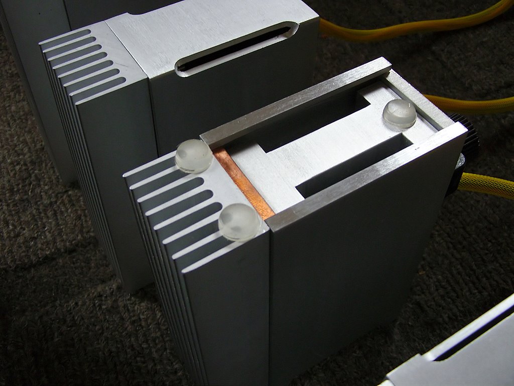

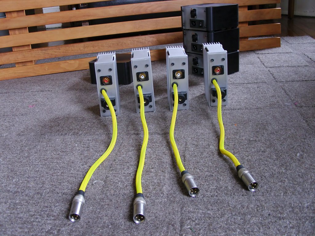

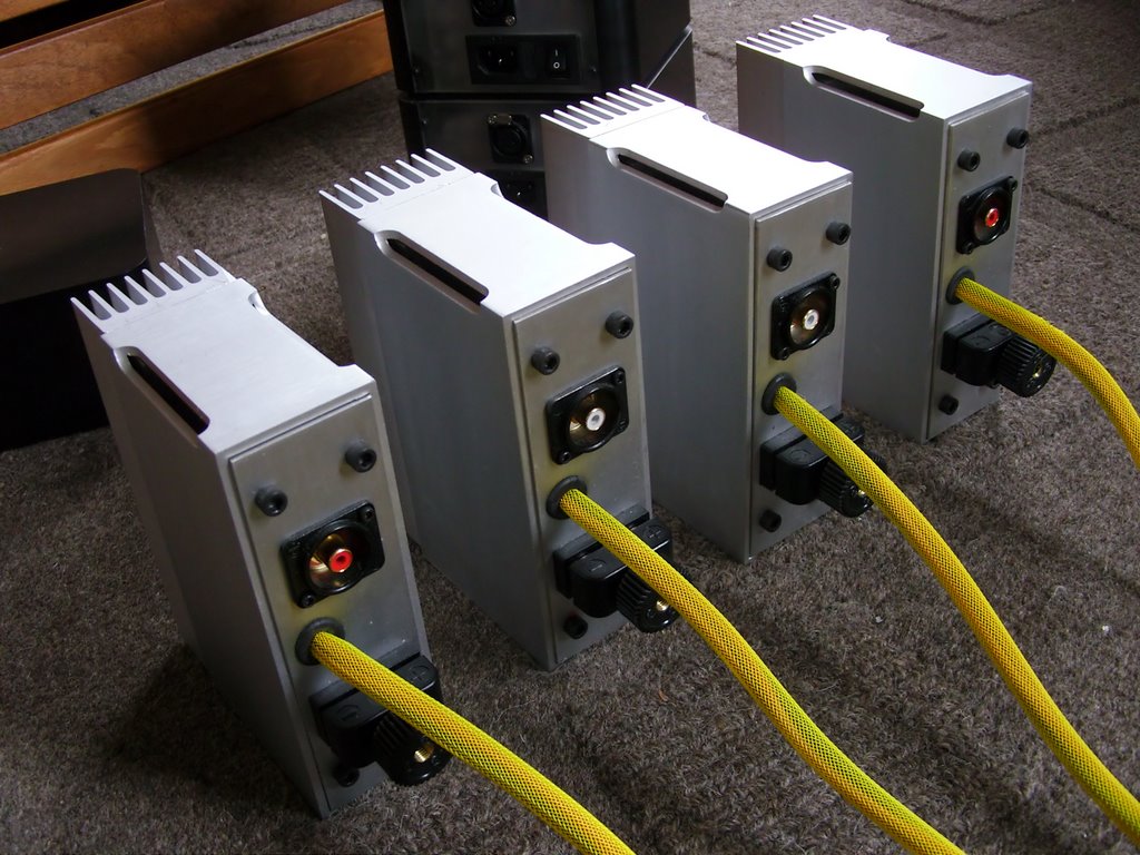

Update on LM4780 Amp
I recently finished the cases for my LM4780 amps.
Here are some pics:
The case was made from extruded 2X6 inch 6061 aluminum rectangle. I used a half inch ball end mill to make the top heat vents. I cut the bottom opening on the band saw after squaring off the ends on the mill. They slide over the amp chassis and are friction fit.
Unfortunately, as of right now i am unhappy with the sound of these amps and today i pulled them out of my main system and replaced them with my original LM3875, single power supply amp. I lost some of the left/right channel separation that comes with monoblocks but gained a much richer sound. I think i may just rebuild the amp section with LM3875 chips as i don't see how i can improve the LM4780's.
If anyone has any suggestions as to how i can tweak my lm4780's i would greatly appreciate it.
My preamp is still in a temporary chassis as i am continuing to experiment with different buffers and attenuators.
Here are some pics:

They look great okapi!!
why don't you like the sound? what is missing? low end? top end?
how much rectification caps are in those power supplys versus your other amp you like more?
Aengus and tangmonster, thanks for the kind feedback. i had been thinking about the design of the cases on and off for the better part of a year. it was only recently that i came up with the idea for the top vents.
tangmonster. i think you are right about the source of the problem being capacitance. my lm3875 has a little over 1500 micro farads per rail while the lm4780 has only 1000 micro farads. In both cases i have 4.7 micro farads just after the bridge on each rail. the large caps are located near the chip (a typical peter daniel set up).
i actually designed my lm3875 amp so i could easily change rail capacitance so i could experiment. it seems i needed to do it with the lm4780 and not the lm3875.
given that the lm4780 has two chips in it i would expect that it needs at least twice as much capacitance as the lm3875 and certainly not less as i currently have it set up? what do you recommend?
Many recommends the low capacitance , but in my opinion it is just not enough.
Indeed I would recommend adding more capacitance at the power supply.
I would ad at least ad 10000uF per voltage rail at each of the power supplies.
This should help your rectification and voltage delivery at higher currents a lot. And mostly help with lower frequency's (that needs all the constant current)

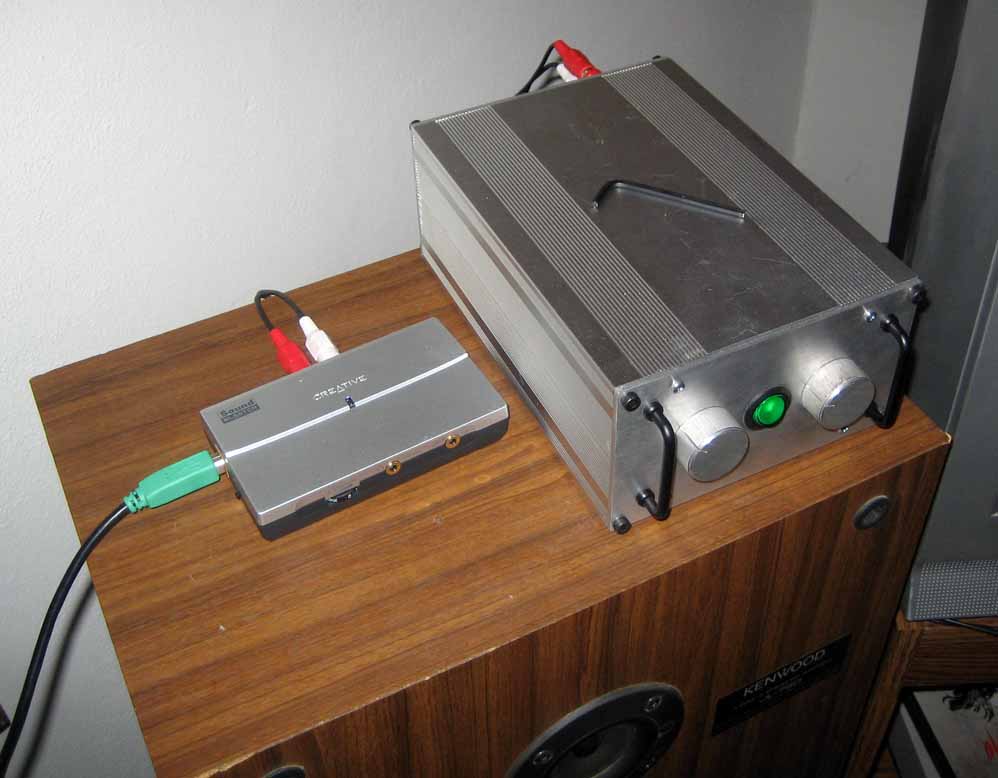

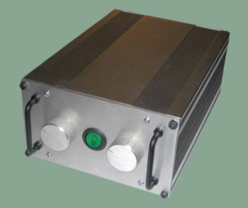

3875 Chipamp
Here is my 3875 chipamp. It rocks. (Meaning that it plays music and doesn't catch fire.) Thanks to all that gave help during its design!
It contains:
AnTek 32V 300VA transformer, P. Daniel PCBs, waterjet front/back plates, cheap housing extrusions from eBay, nearly a billion spade connectors, and Mouser stuffs
More info:
Original thread
Now the pics:
Front
It contains:
More info:
Original thread
Now the pics:
Front

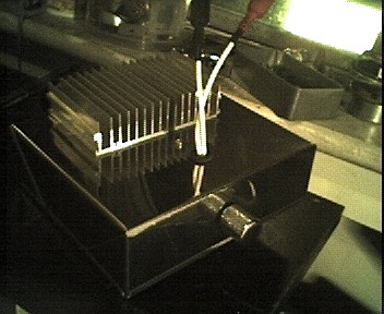

I needed to whip up an amp quickly to power my reference monitors since my Samson Servo blew out, so I put this free-wired LM3886 together. There is 5,600uF on each pin after a bulk filtering of 15,000uF on each rail. I ran the input RCA jacks out the top through a rubber grommet so that I could set it under my workstation and get to them easily.

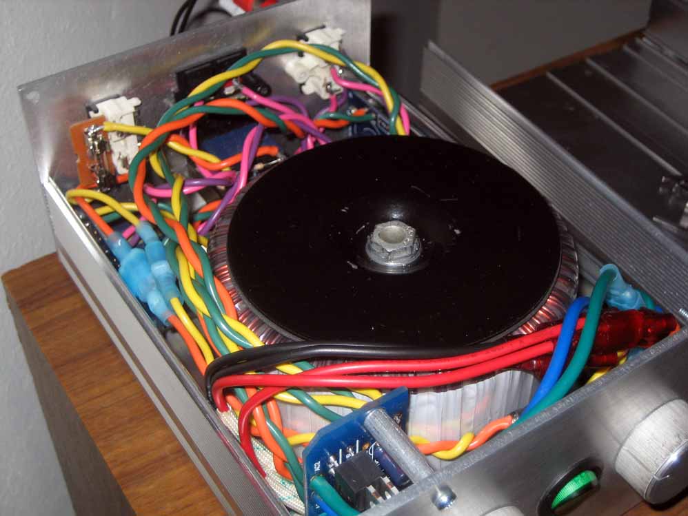

Managed to add 2 more GCs in the amp. It is now driving pair of bi-amp speakers using activer crossover.
I can't get it as quiet as before though, must be the transformer inducing bit of hum to the cramped cabling.
