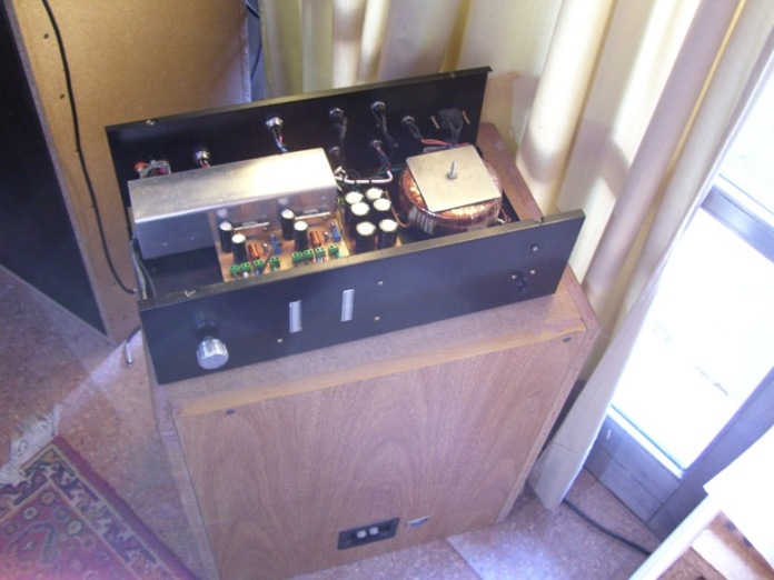

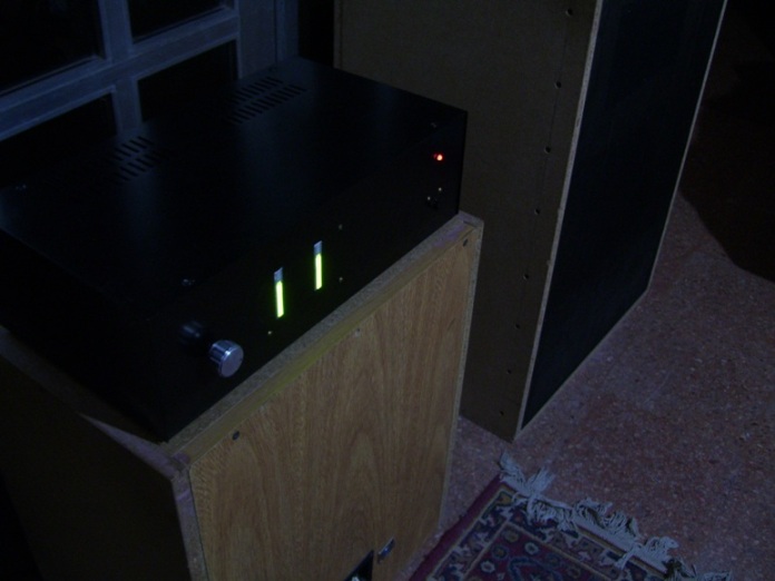

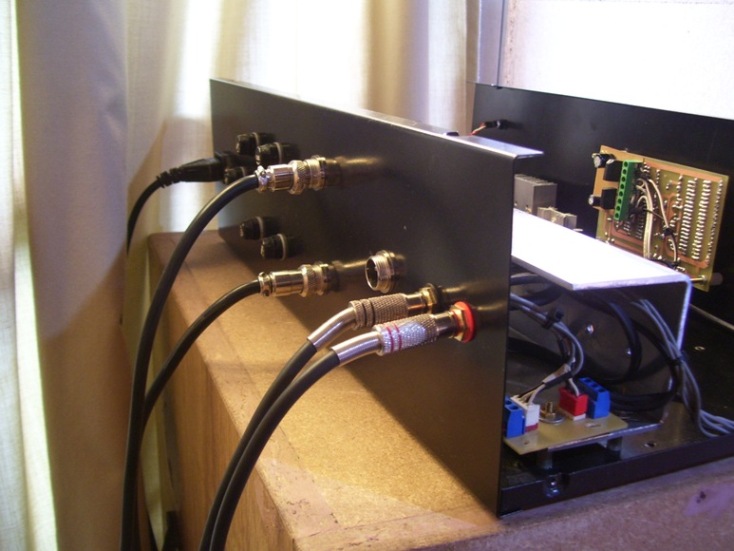

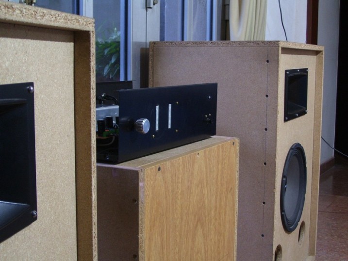

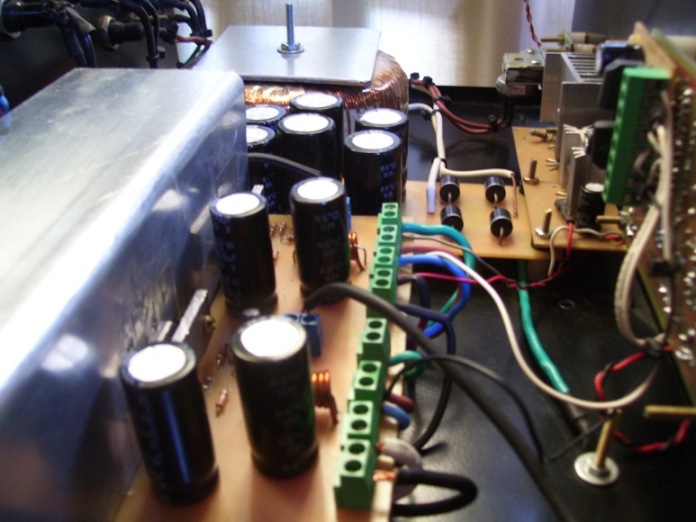

This is my stereo amp...
it's based on the LM3886T...
i have a 27+27 V 300 VA toroidal transformer, and a total of 37000uF in the supply...
the VU meter is based on the IC's LM3915 and LM3916...
i desing all the boards...
the result of the test show...
60W per channel and a Singal noise ratio of 87dB
the amp is not finishied...

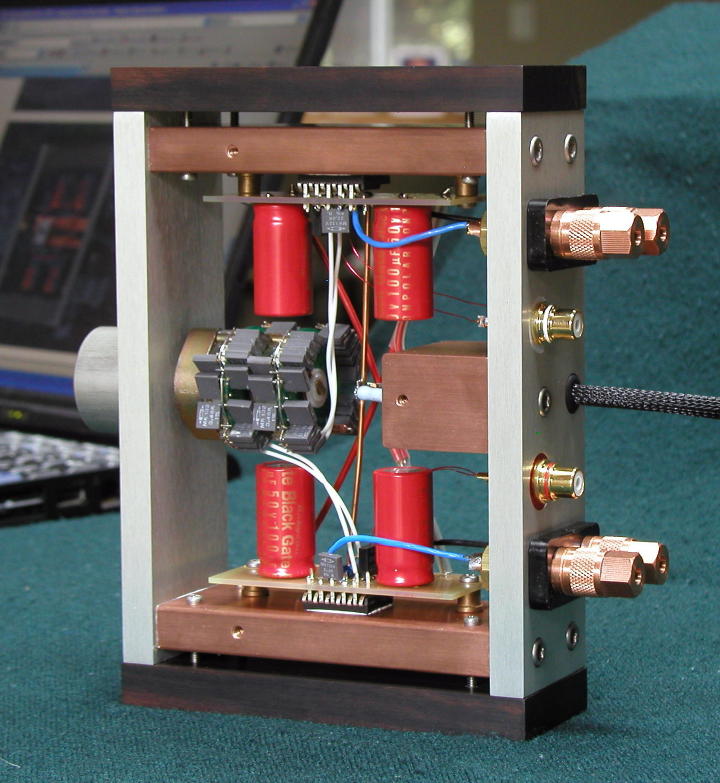

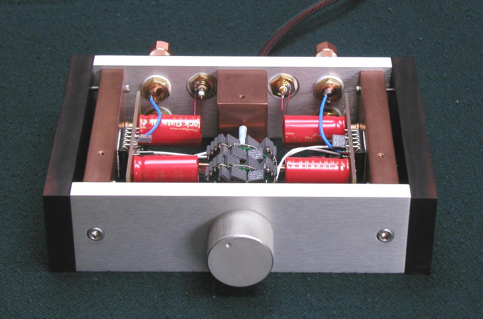

Mick_F said:
My new copper amp....
More information here .
Mick
Apologies for the delayed response.
Mick, that's great work. I've been looking at GCs that seem to be layering more and more parts into them. I built my GC as simply as I could and have been loving the sound. Your design fits my philosophy of simplicity and then some. My next GC will be a clone of your clone.
Outstanding job you've done and thanks for taking the time to post about it.
