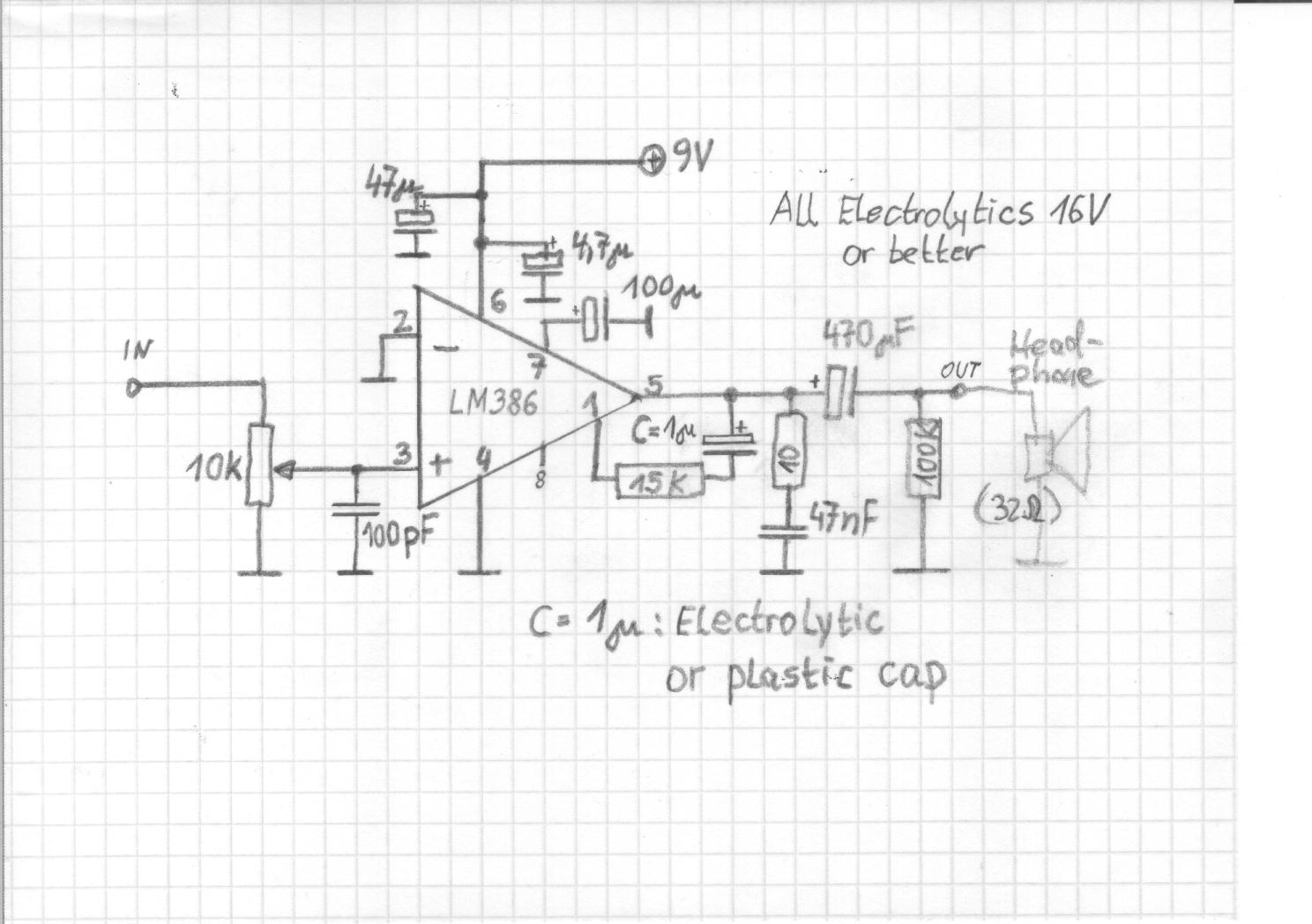

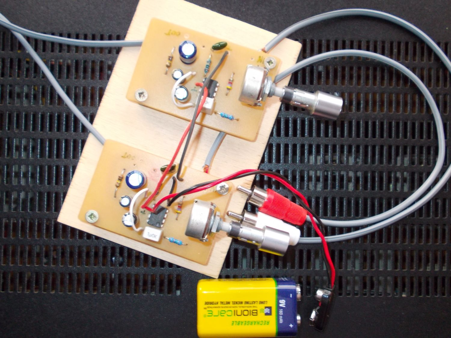

LM 386 headphone amp
the foto shows a lm386 amp on a piece of wood (prototype, without case).
capacitors 100pF and 4,7uF soldered at the copperclad side.
voltage gain around 10 times.

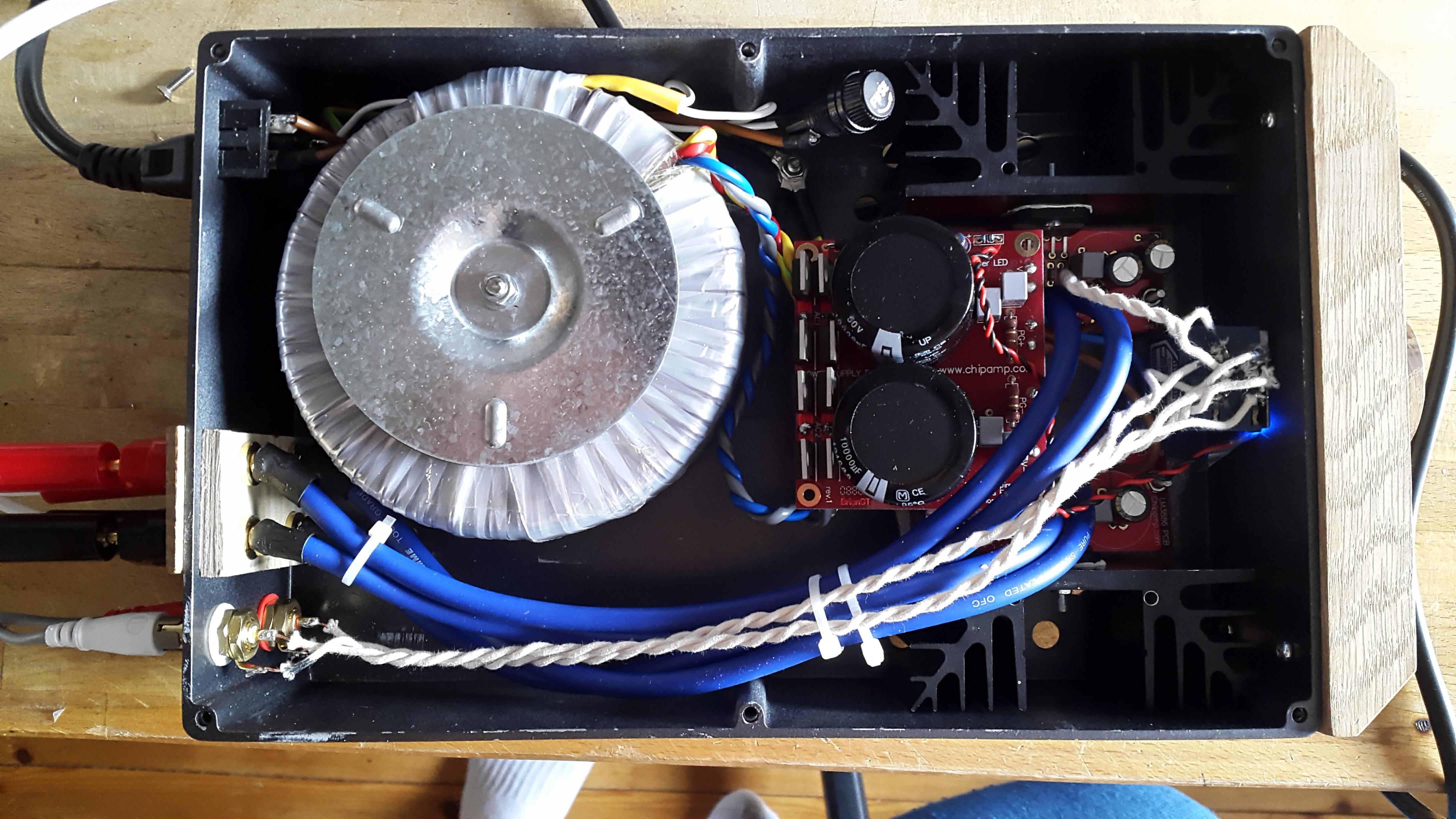

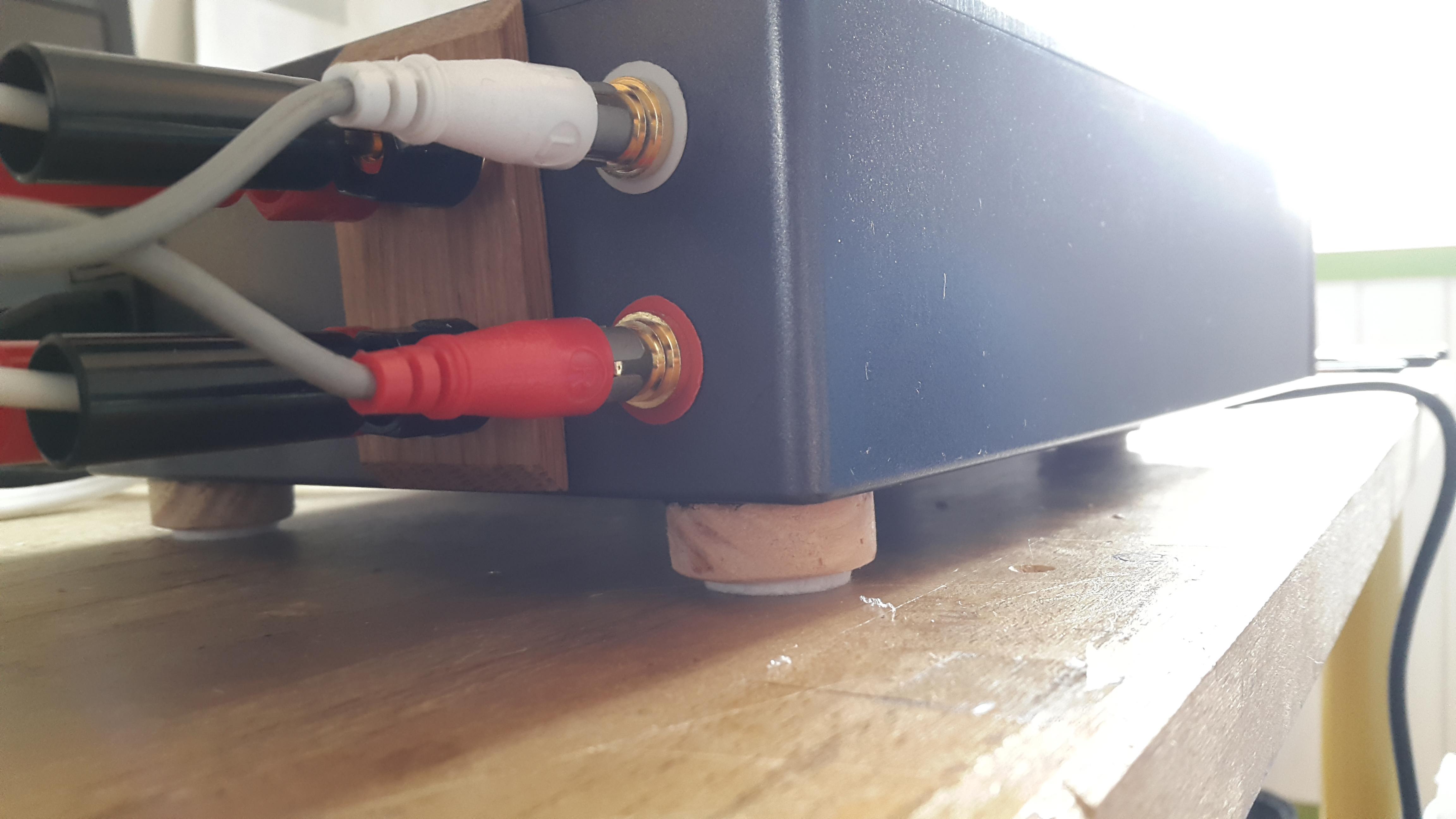

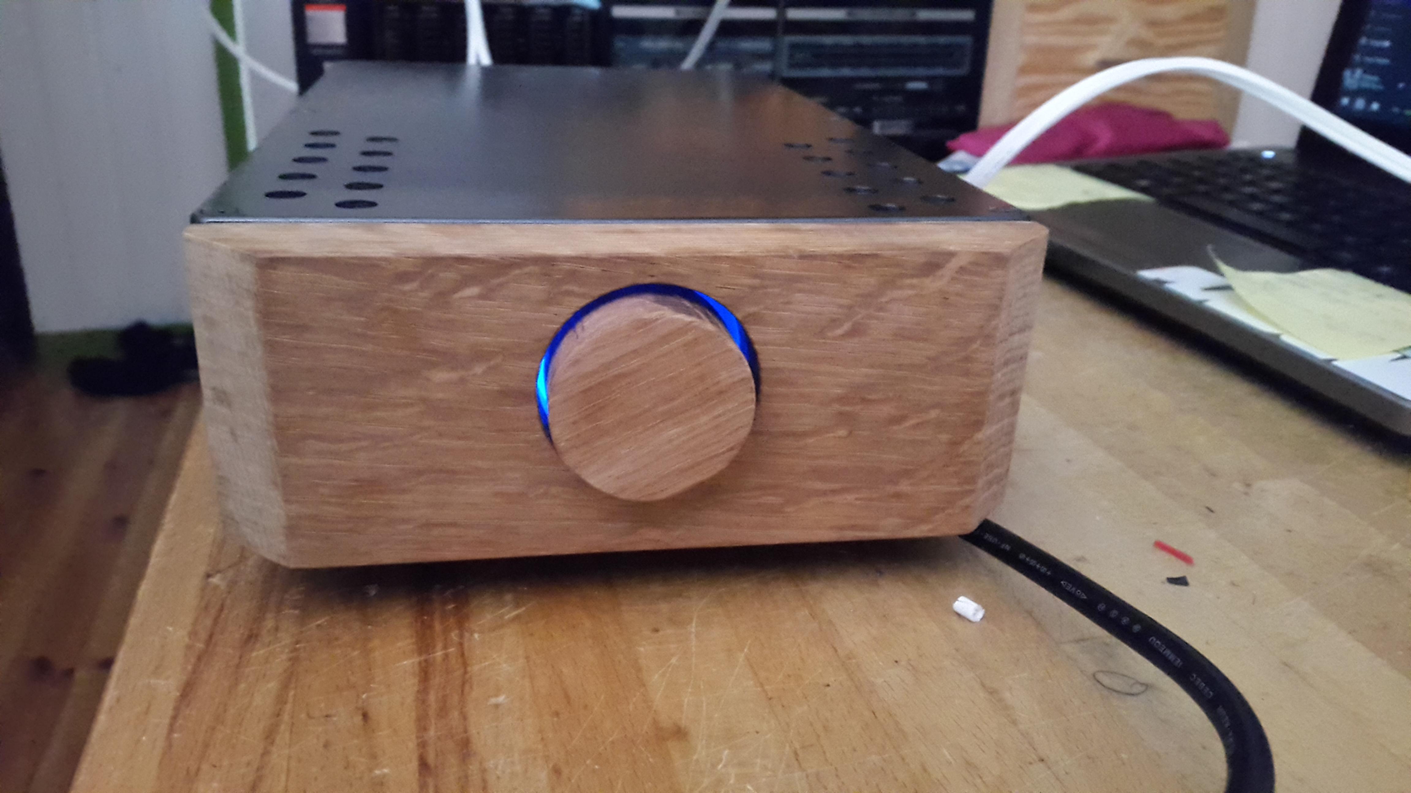

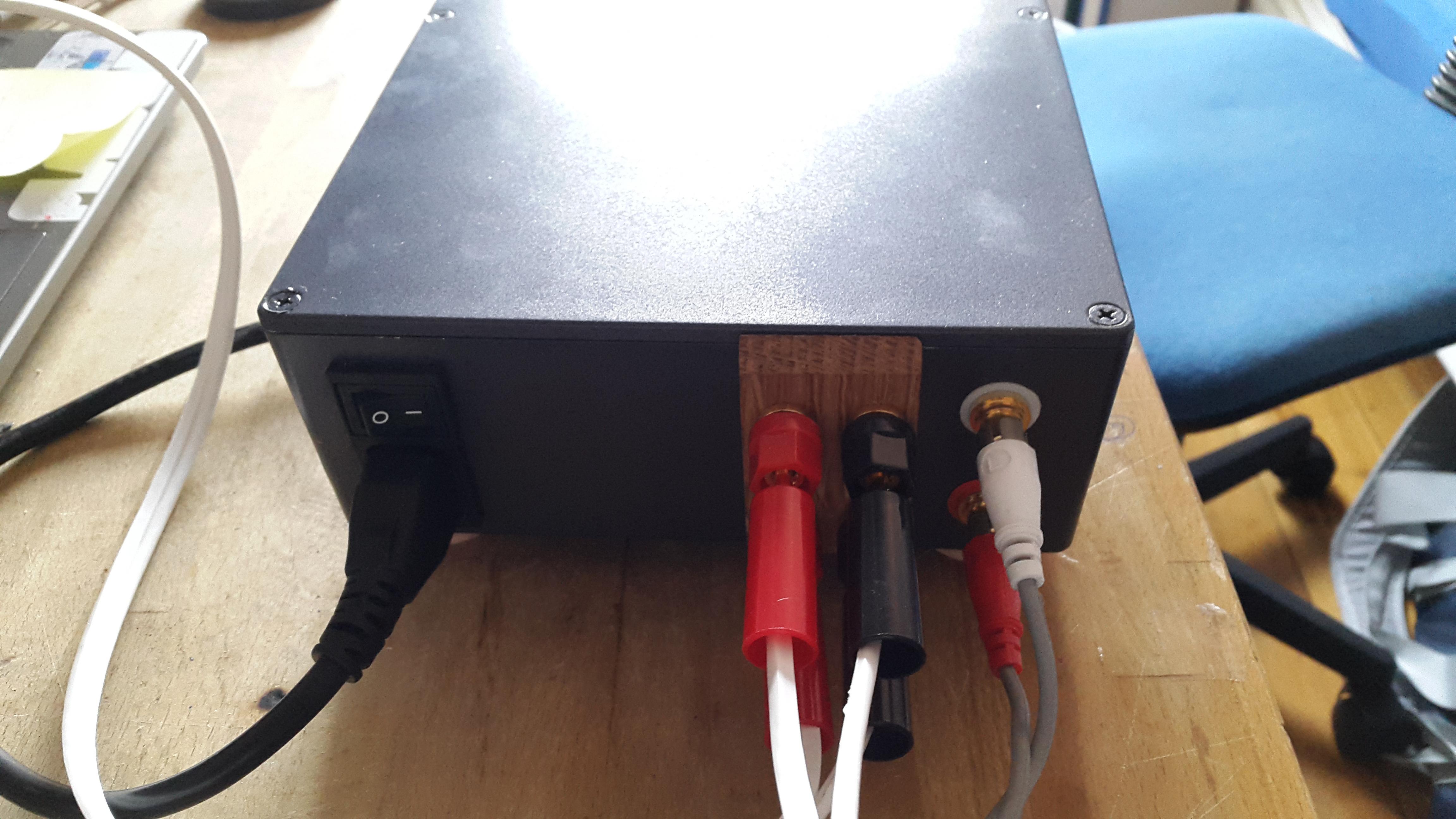

Hi all
Started thinking about building an amplifier a while ago and decided to purchase a kit from chipamp.com. This is my first amplifier build so I can proudly say that the result is better than expected. The casing is a bit small, and I had to think alot of how to solve the layout in the best way to not get interrference with transformator and signal wires for example. Funny doing the led in front, got the idea from another build at this thread. 🙂
I really like it! The wood panel and knob were enough, but when you added the led behind it...! Super job!
