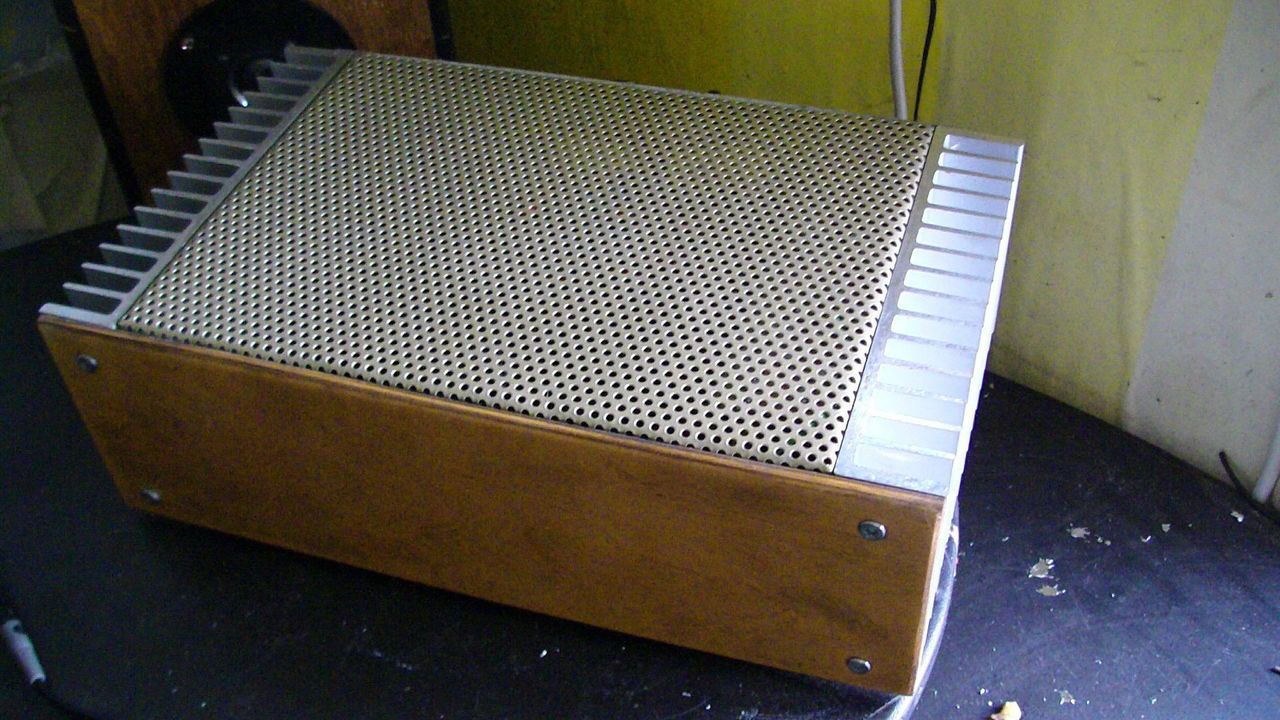

Here is the same Chipamp LM3886 kit in a different box. I built it for our lad but with one transformer/power supply. It has a matching 4 input 2 output passive preamp sitting on top of it. Just finished earlier today and sounding very good indeed :drink:
Thanks, yes that case makes things quite easy and no problems with heat dissipation.
Only problem is not enough space to fit input selector and volume pot so they need to be in a separate case. How did you connect your volume pots Phil, are they both for volume or is one for balance?
Thanks Phil, I actually read through that thread you linked to fairly recently, I should have recognized it was you who posted there last.
I also have had the same issue as you with too much gain causing the volume to go very loud with a small amount of pot movement. Even worse because of the tracks becoming unbalanced near their ends it causes one channel to fade out before the other at very low volume which is annoying at night.
That's an interesting solution you have used, if I had to drive a separate bass unit it would be ideal.
I got around it by loading the pot with a resistor as described by Zigis in post 31 of your linked thread. I ended up with a 10K resistor added to each channel of a 20K Tocos stereo pot which has worked well.

My lm3875 stereo amp:
Not finished, just testing under heavy load in my workshop It was a class A amp before..
