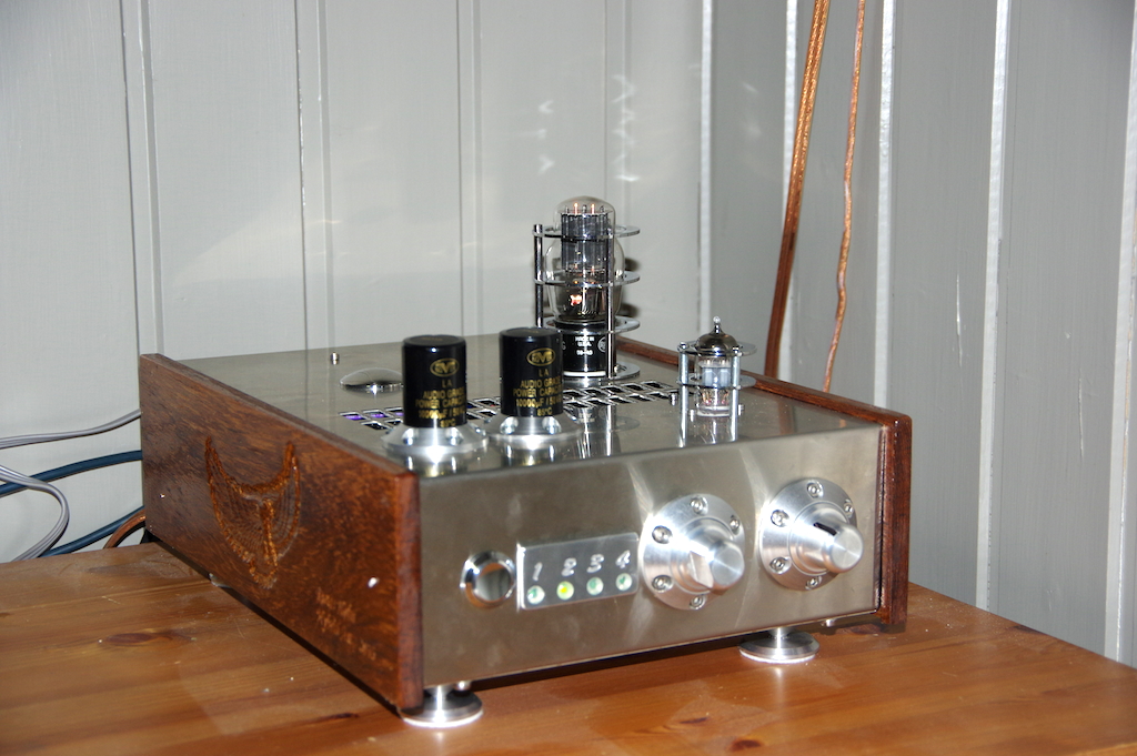

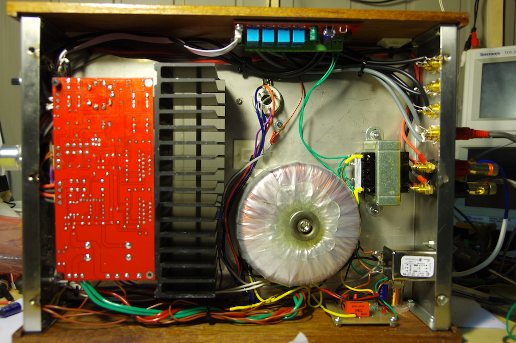

Hybrid
Last project done.
50W@8ohm and 72W@4Ohm (RMS @1Khz)
LM3886 + ECC83 + 5V4G
Chassis and all is made by me.
I was quit impressed with the performance on this amp, it is nothing I tried before and it plays really clear and open

What are you wondering about?
It is quit simple, LM3886 as classic Voltage amplifier working on +-37V and PSU capable of 8amps. 5V4G as tube rectifier for ECC83, working on 180V.
One PCB board for changing in signal, one PCB board for on/off with a PSU on 12V, on/off switch is based on push button and CD4013 for switching relay.
Hope this clarify some of it 🙂
Yes it does, thanks. I've done several LM3886 projects and didn't understand the integration of the tubes. What is the advantage of the "5V4G as tube rectifier for ECC83"? It's just something new to me. Always wanting and willing to learn.😉

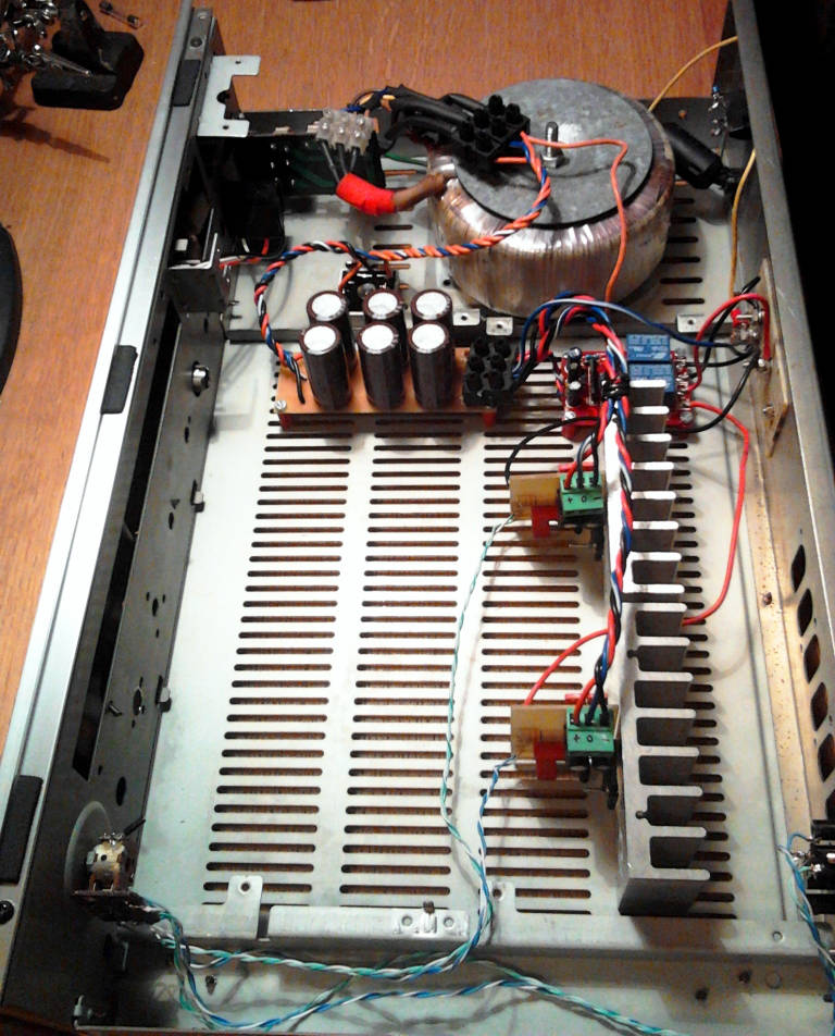

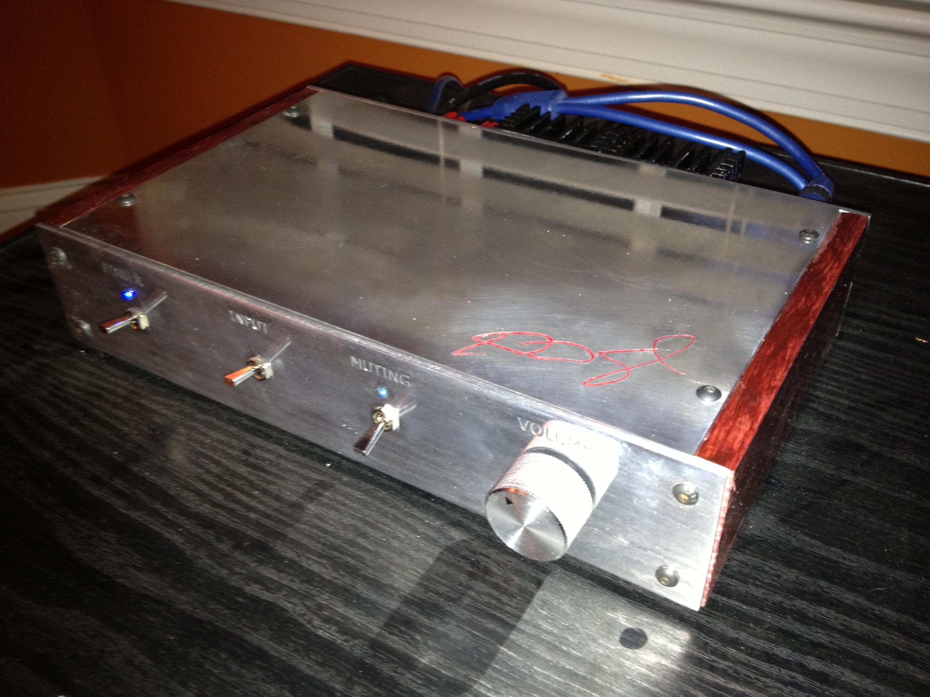

Quite an ugly duck after those pretty amps. But it sounds fine. No hum, hiss or oscillation to be found.
It's just a pair of lm3886. PSU is 2x21vac/225va into 3x3300uf per rail. Plenty of space left inside to add something. No idea what yet. 😛

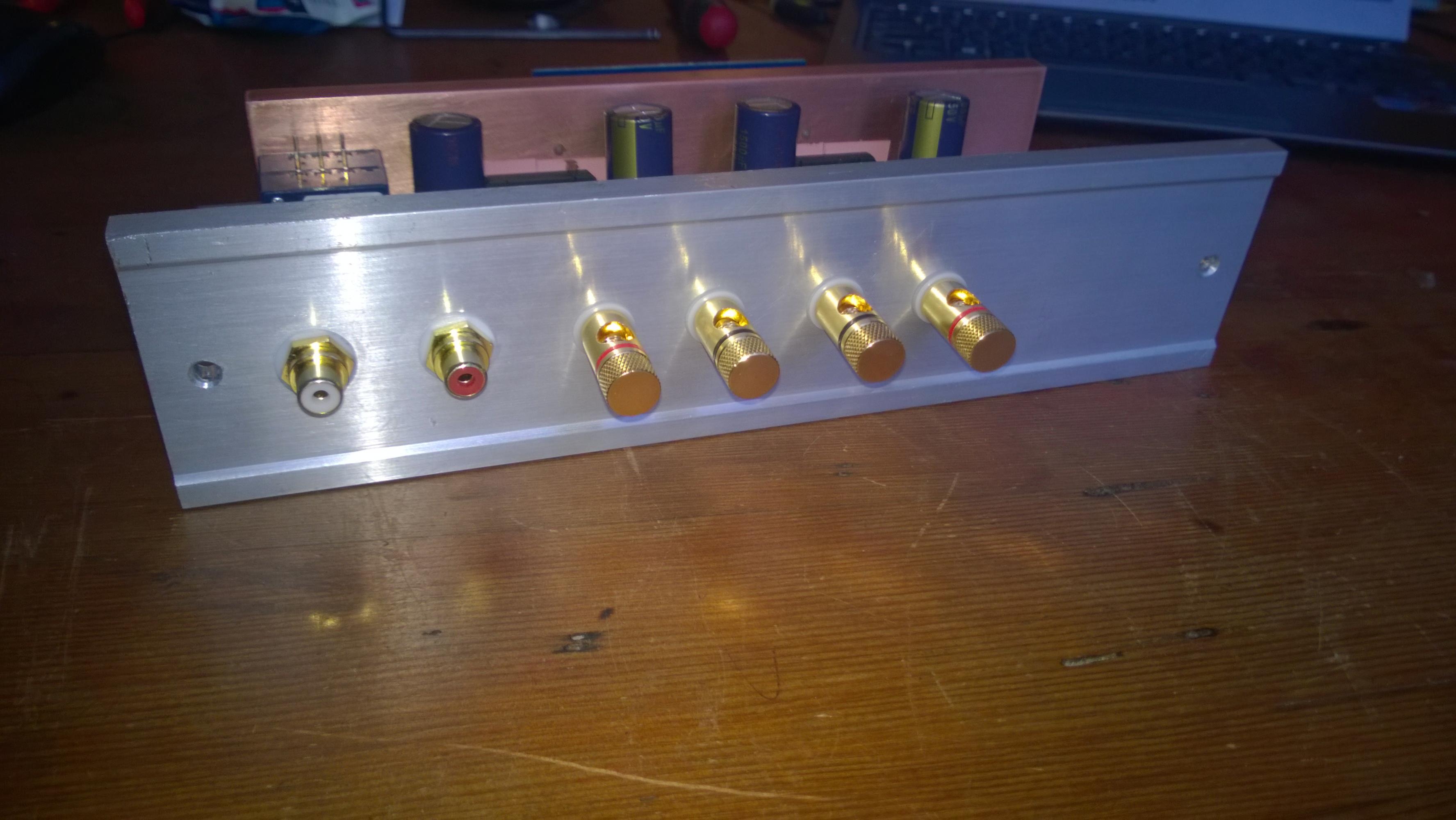

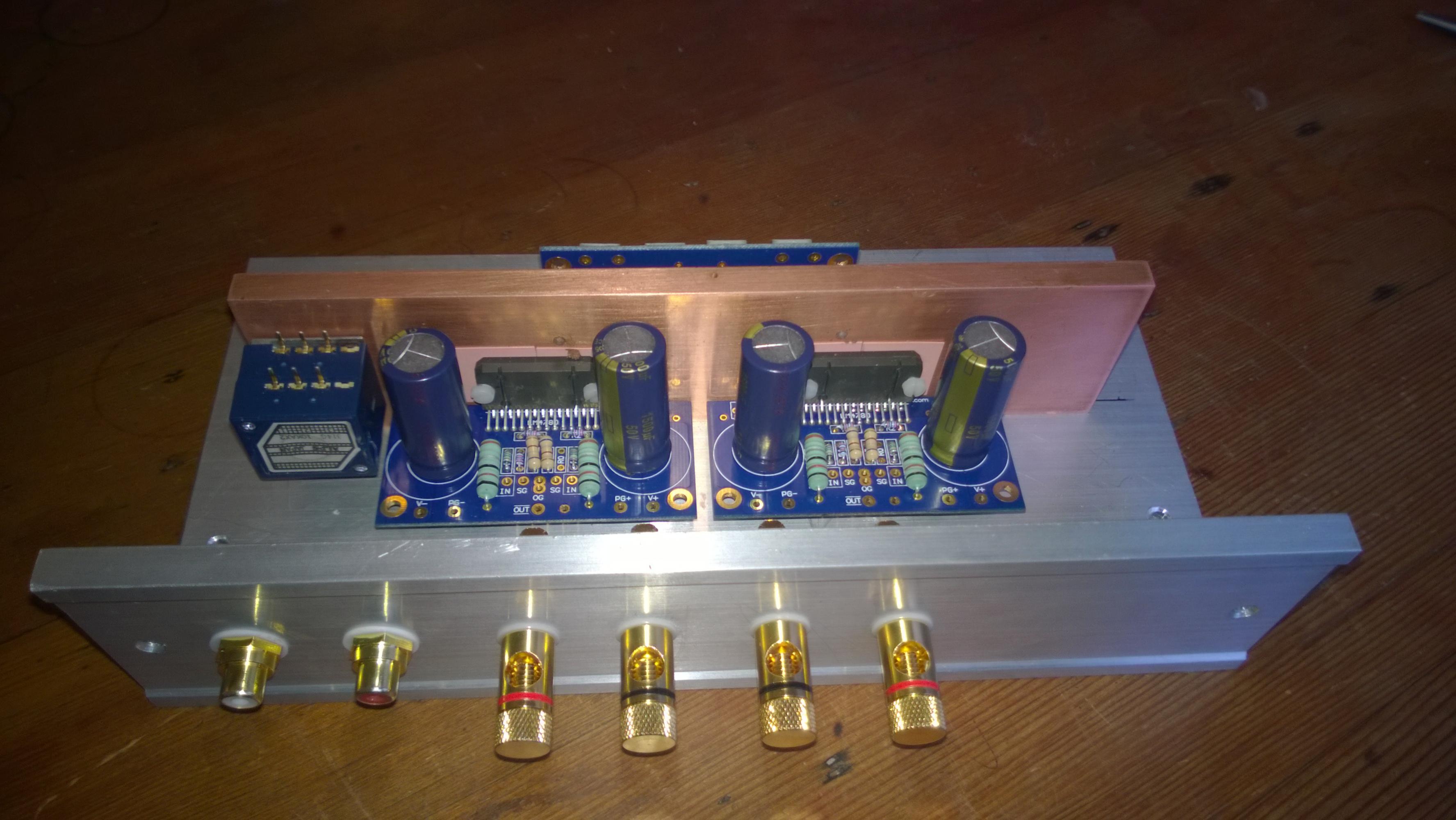

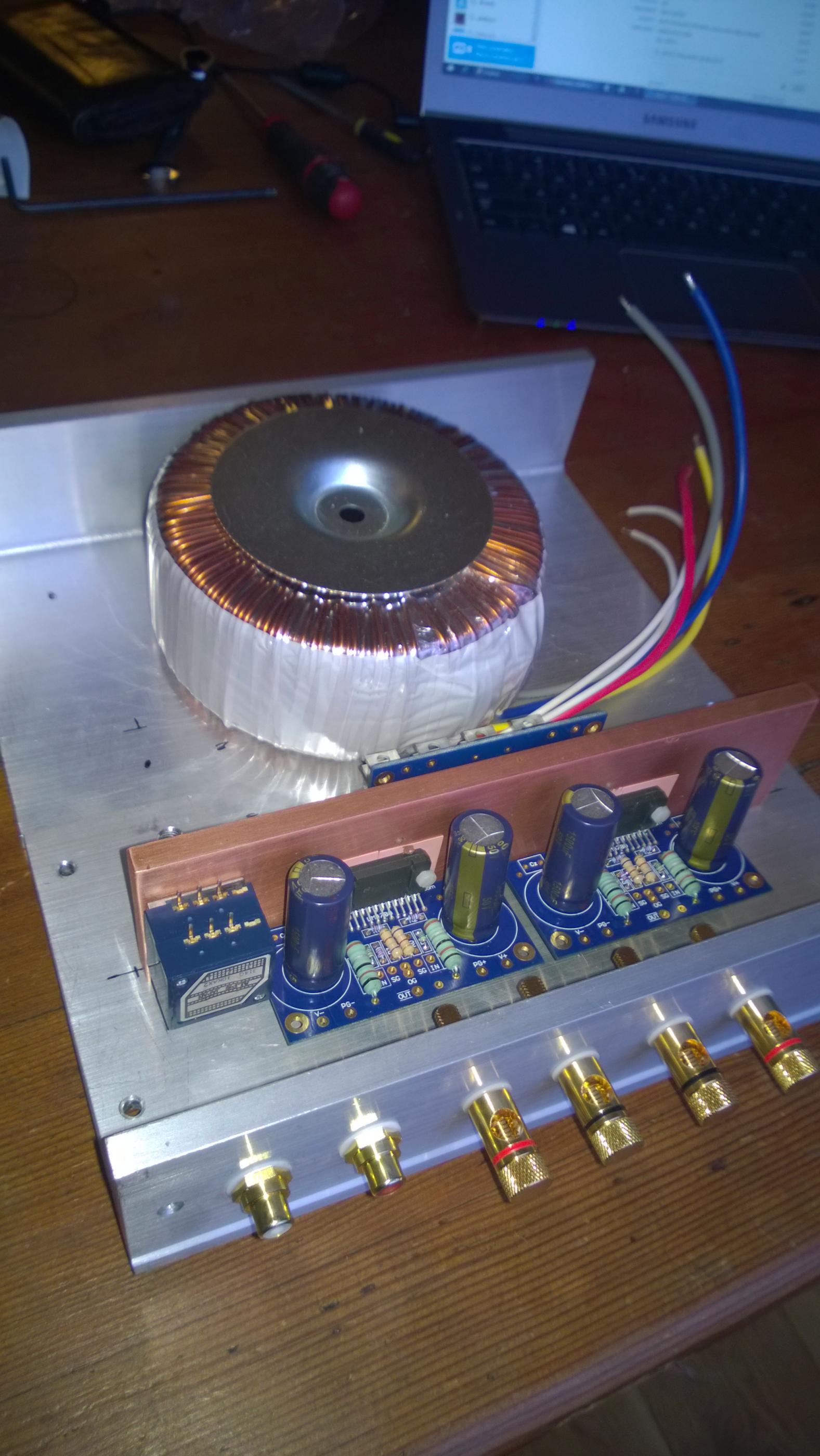

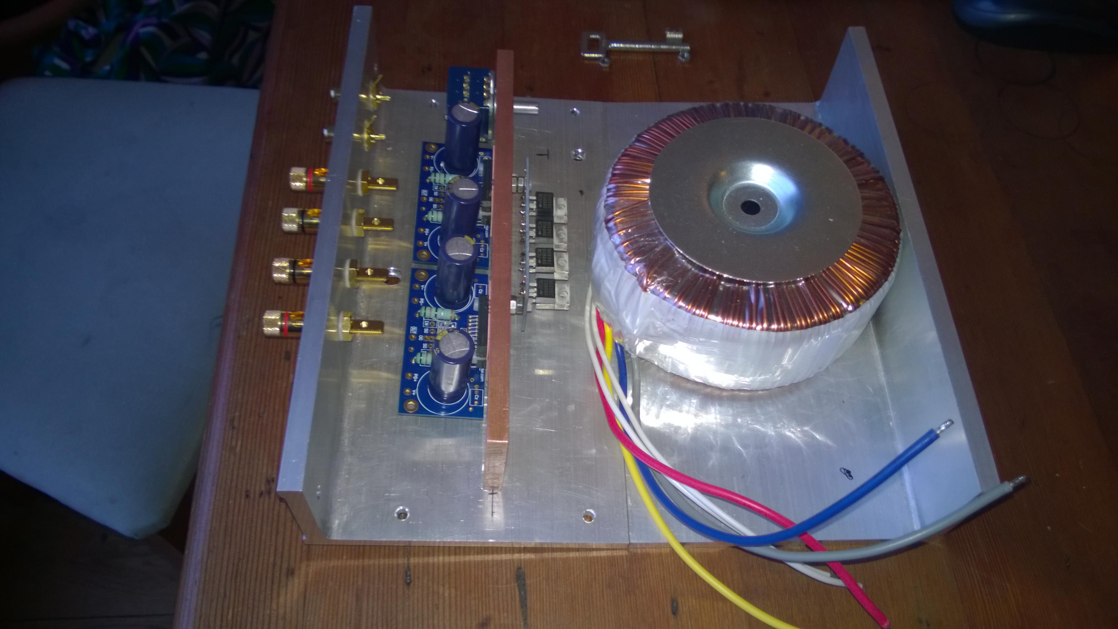

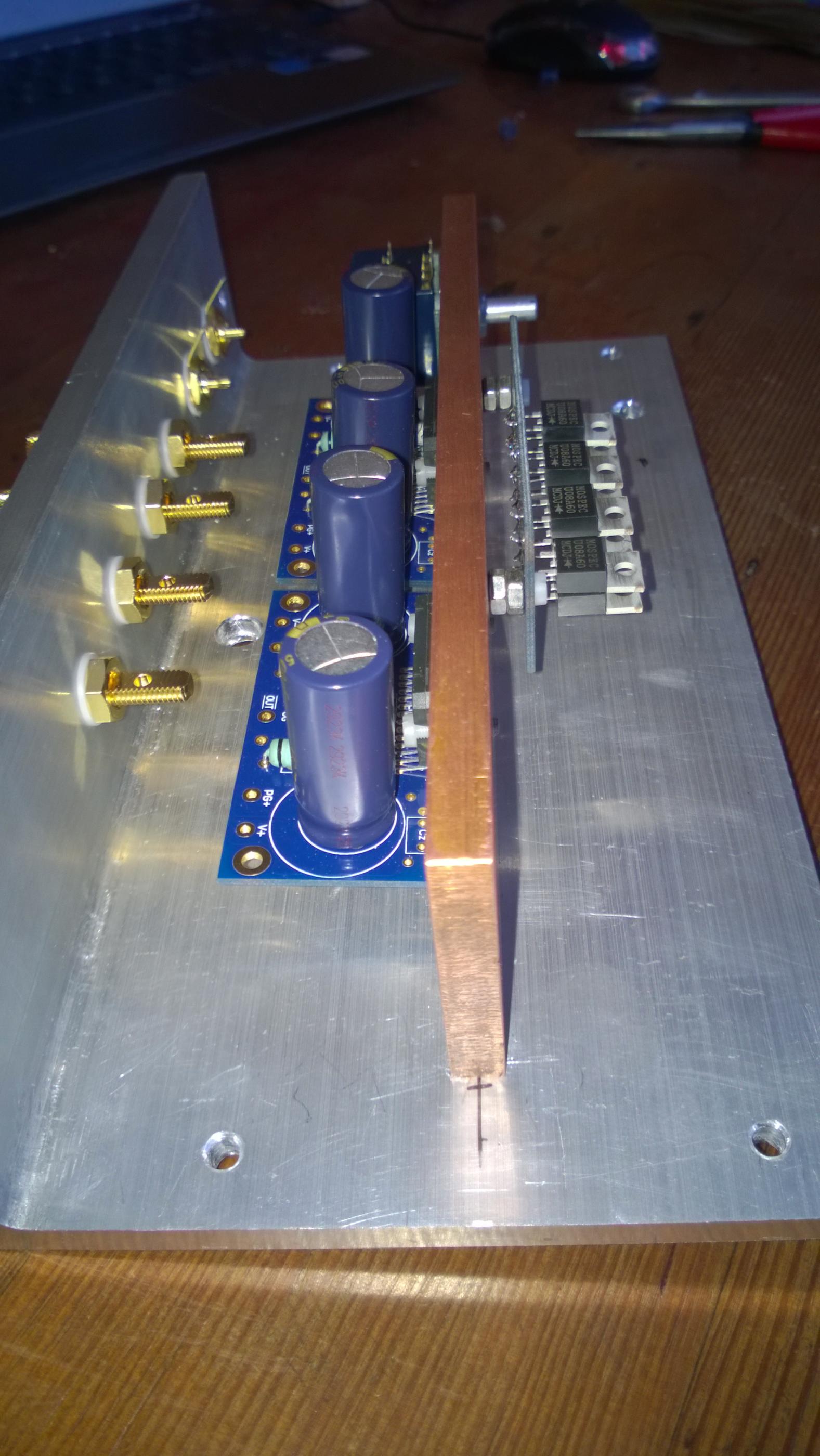

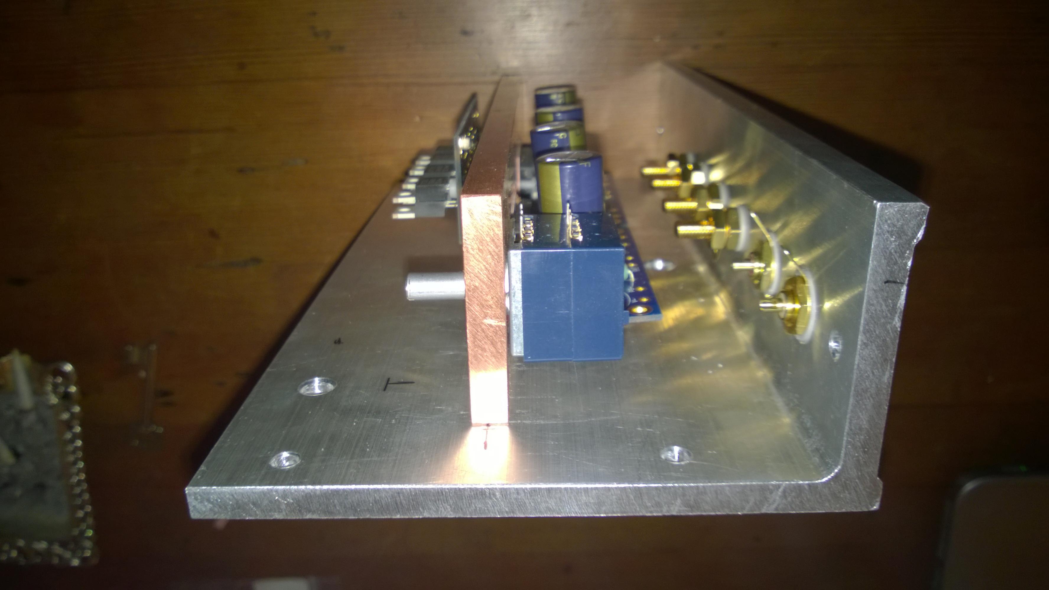

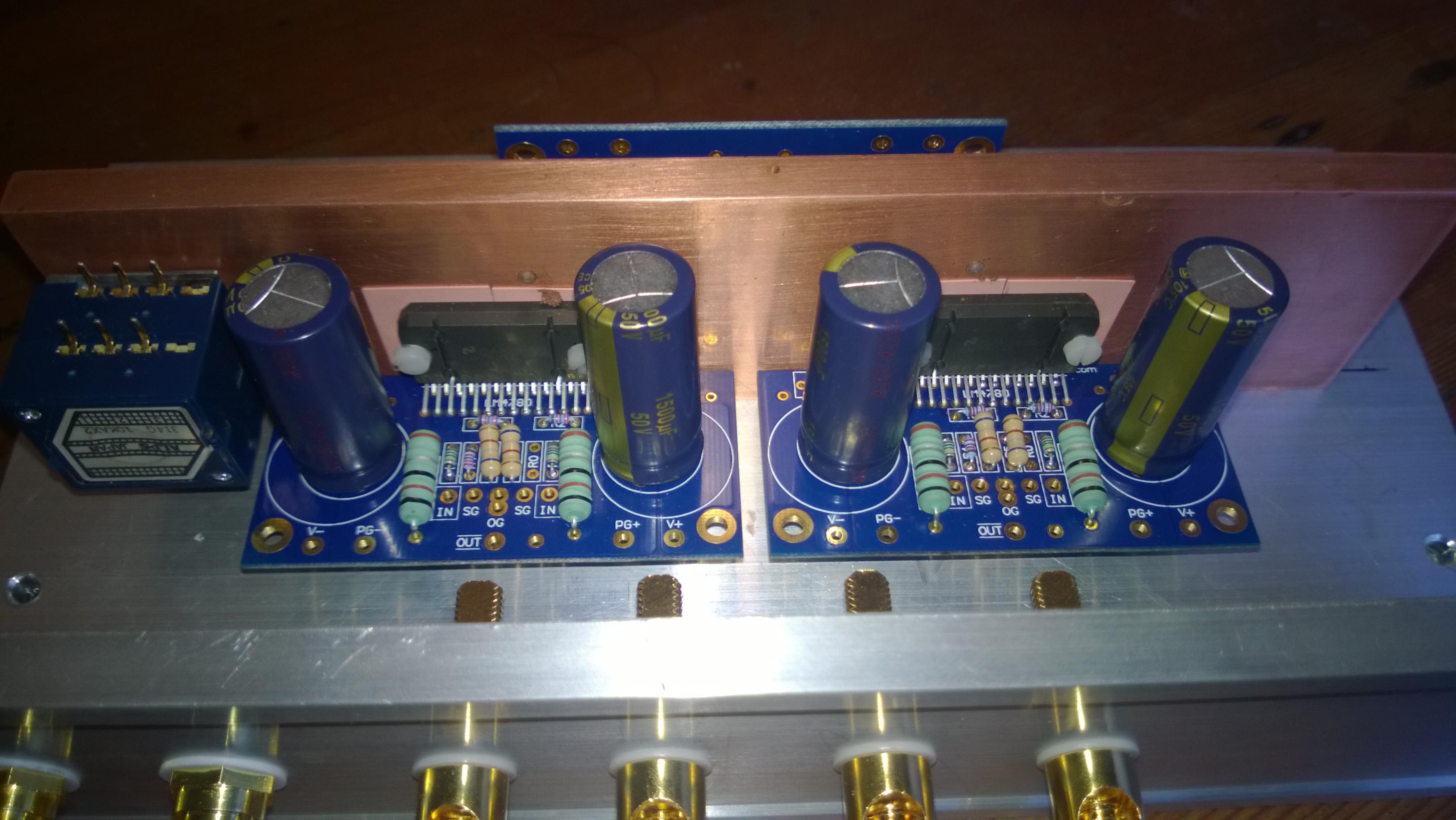

Progress build LM4780 amp
Here the progress of the build of my LM4780 parallel amp from P. Daniel
The pictures shown are of the amp upside down, the sides I want to cover with oak wood and the bottom will stay open.
The transformer is 2 x 25V 10A 500VA
The heat-sink inside is a copper bar 8 x 50 x 200mm
The cover is aluminum 7mm thick
The star ground I've planned in the middle of the copper bar
The insulation between the LM4780 and the heat-sink is made with silica pads without paste.
I've used an Alps pot for volume control.
Any comments and/or suggestions are very welcome
Greetz,
Joery
