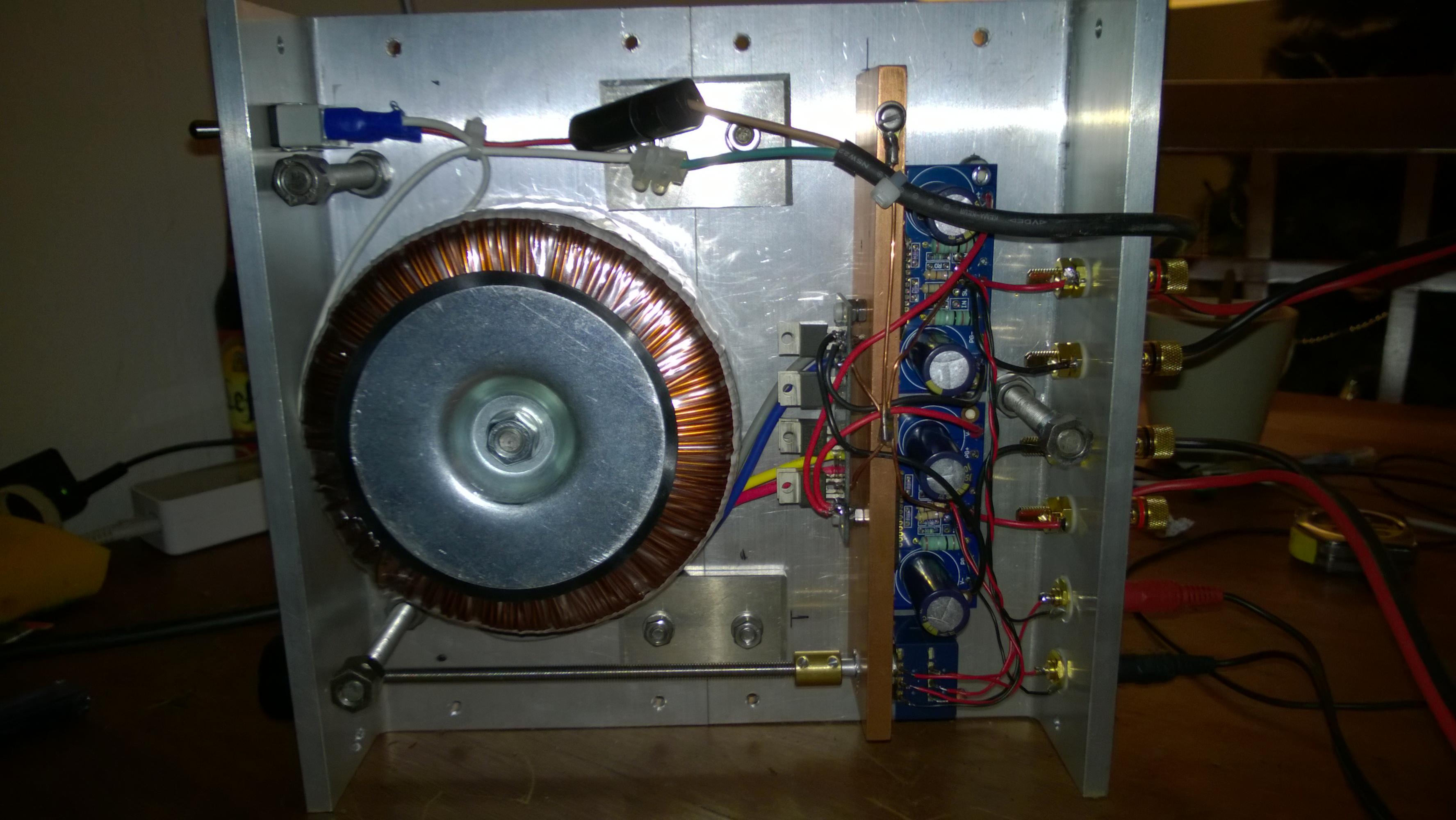

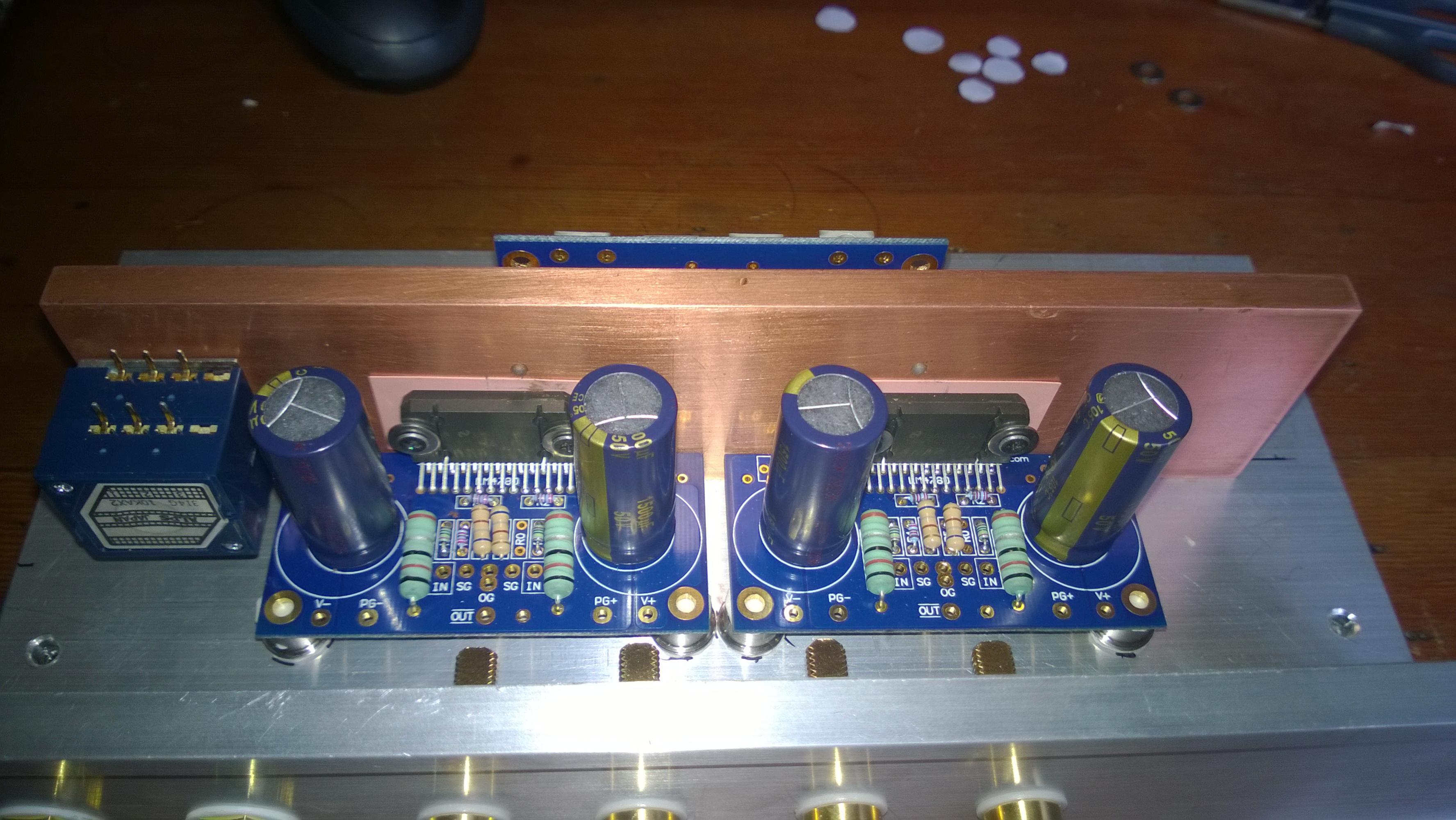

Joerytech, looks good! Are you sure you get a good enough thermal transfer with the LM4870 mounted using only nylon bolts? Perhaps consider using a bar/clamp mount or if the mounting holes are plastic right through then there's no harm to use metal bolts. Good luck with the rest of the build 🙂
Thanks for the advice.
Someone else already made the same comment and I have changed it.
Greetz,
Joery

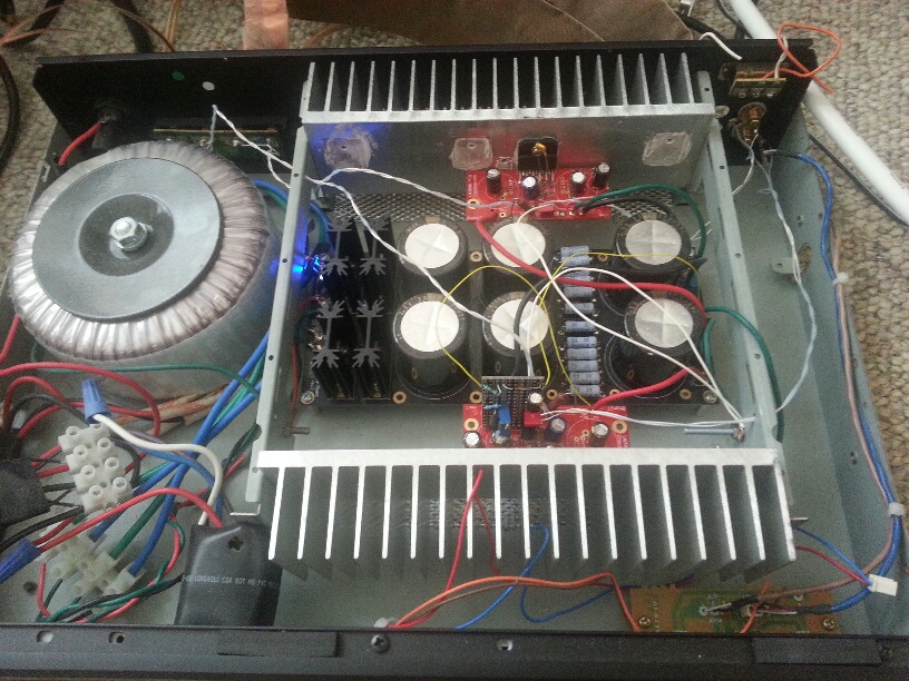

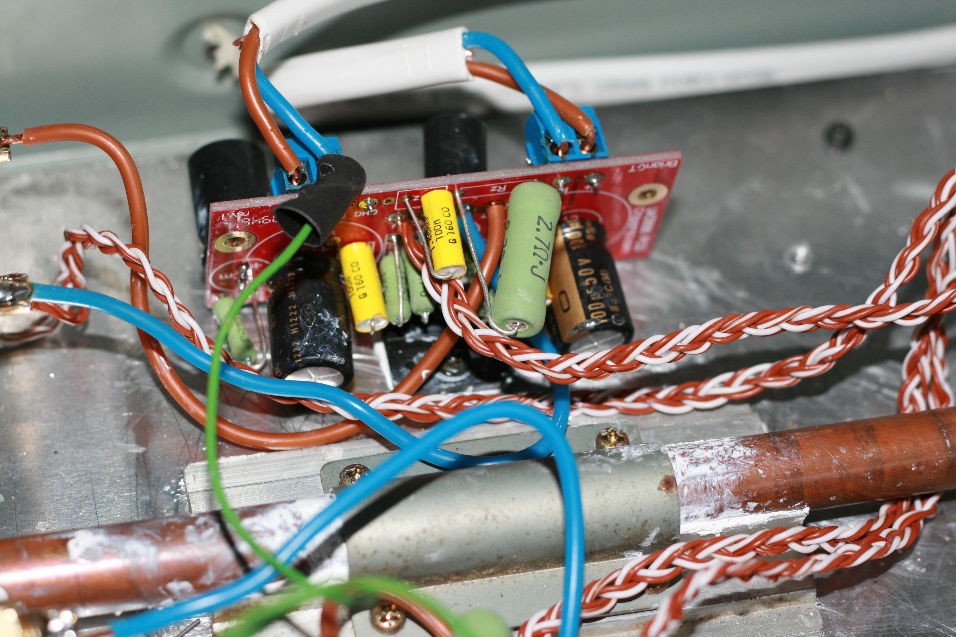

this is my first amp, the pcbs are from chipamp. the case needs finishing and wiring tidying up. its nothing compared to whats on this forum but im happy with sound.

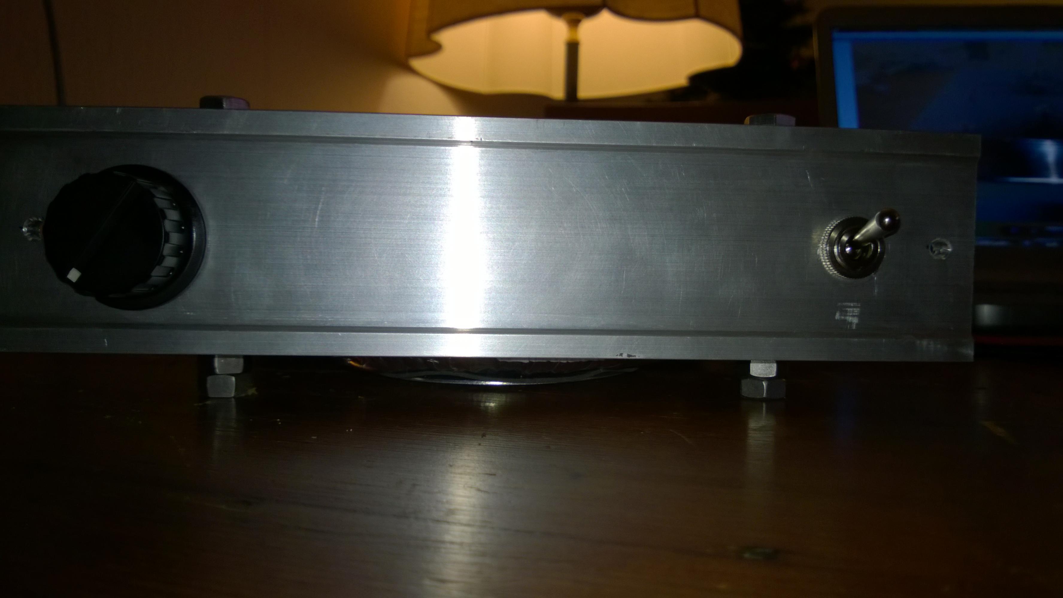

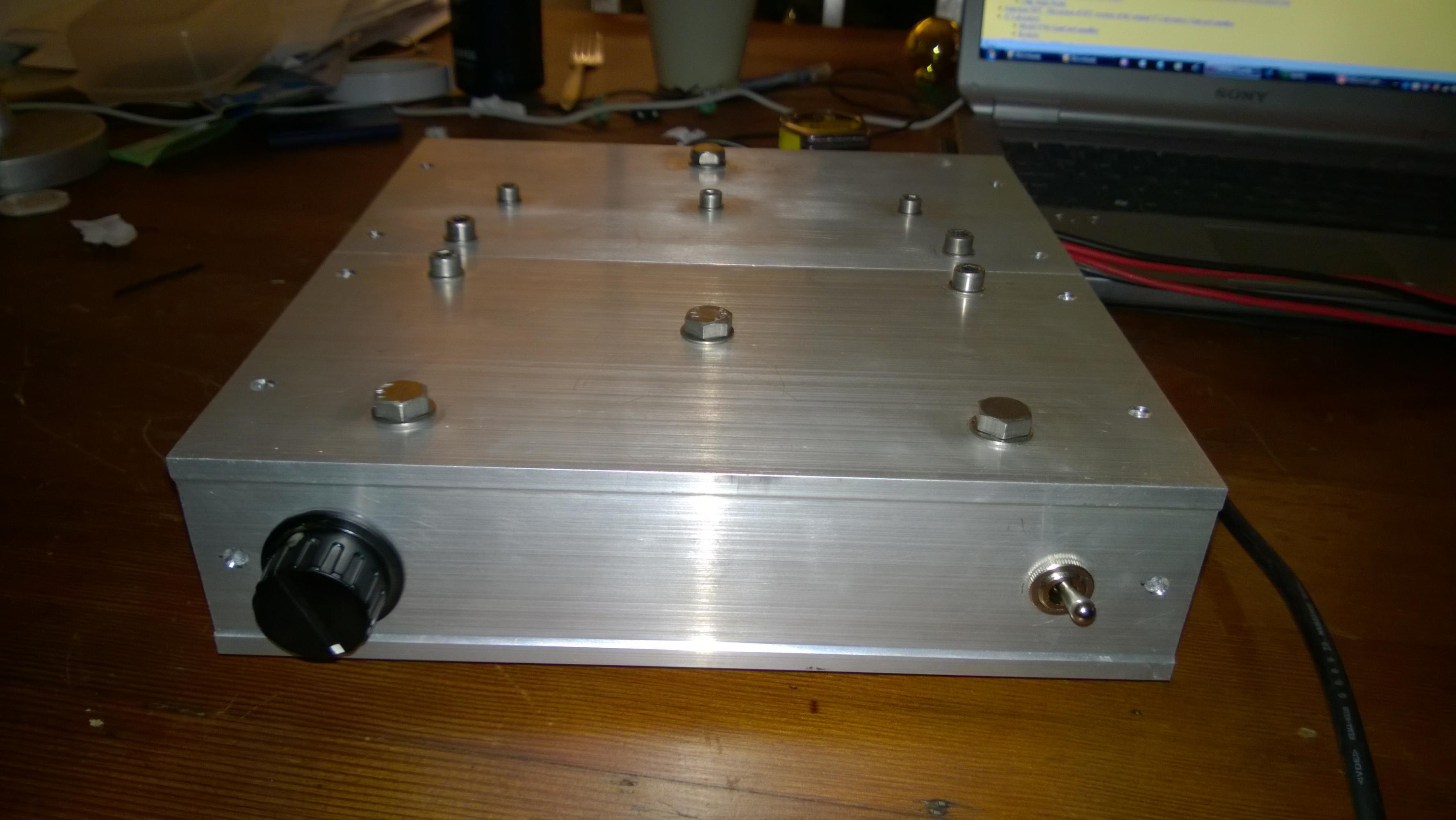

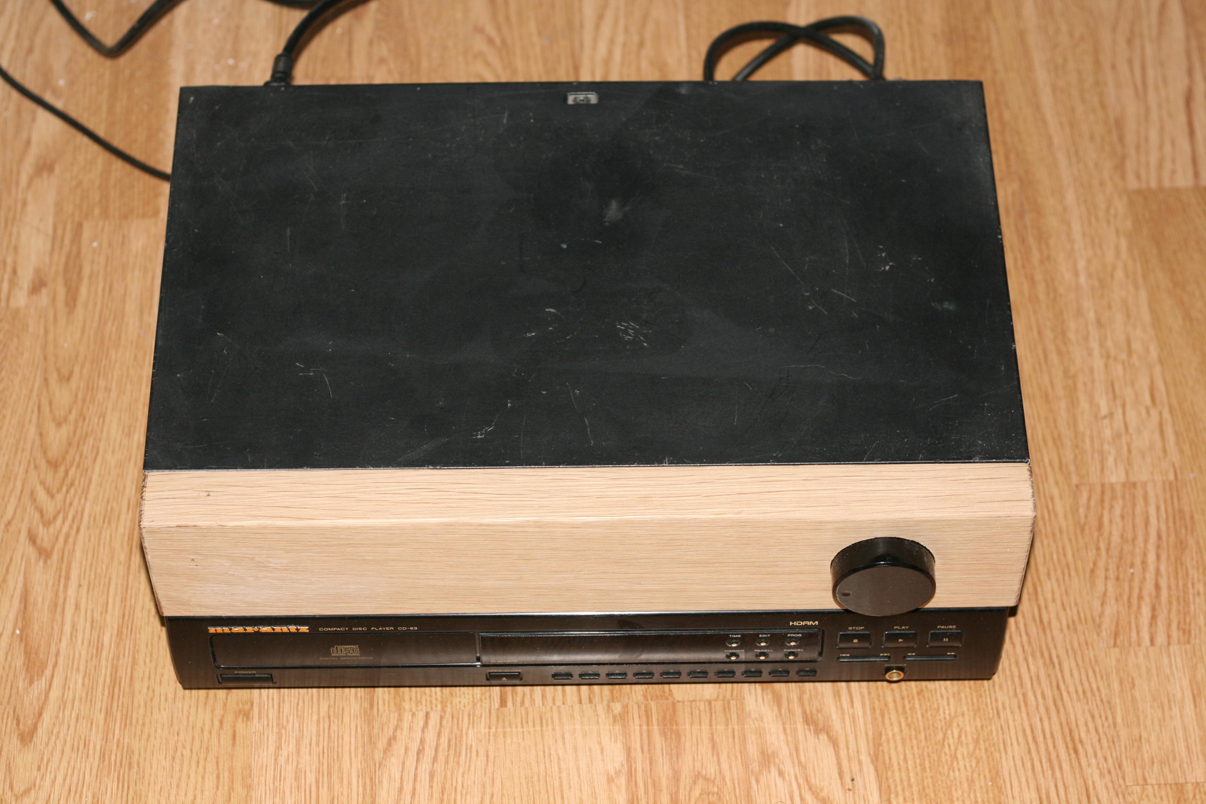

Getting along,
Still have to make the side panels, they will be from oak wood.
The plastic knob will be replaced with an aluminum one.
The power cable entry still has to be made.
Have to do some polishing of the aluminum
Greetz
Joery
Pretty cool case. I think you might add some capacitance after listening for a while. Apex Jr sells some very inexpensive 33000uf 50V caps. About $4 each that would probably fit in your chassis. Good luck with the rest of your build.
I second this! believe it or not...it will improve his sound big time😉 I did build some LM3875/LM3886 long time ago and "experimented" with different values from 10uf to 20000uf per rail.
very nice - very thick chassis - as battle ship! (it can be used as a heatsink).
this is a good aluminum knob- I often use them.
39mm aluminium knob | eBay
Yeah, I found the aluminum profile at a local scrapyard.
When running the amp at full power for some time it gets quiet warm but not to hot so I think its okay like this.
Thanks for the link for the knob but I would have to import it to Holland and actually already found some nice ones around here. Will order soon

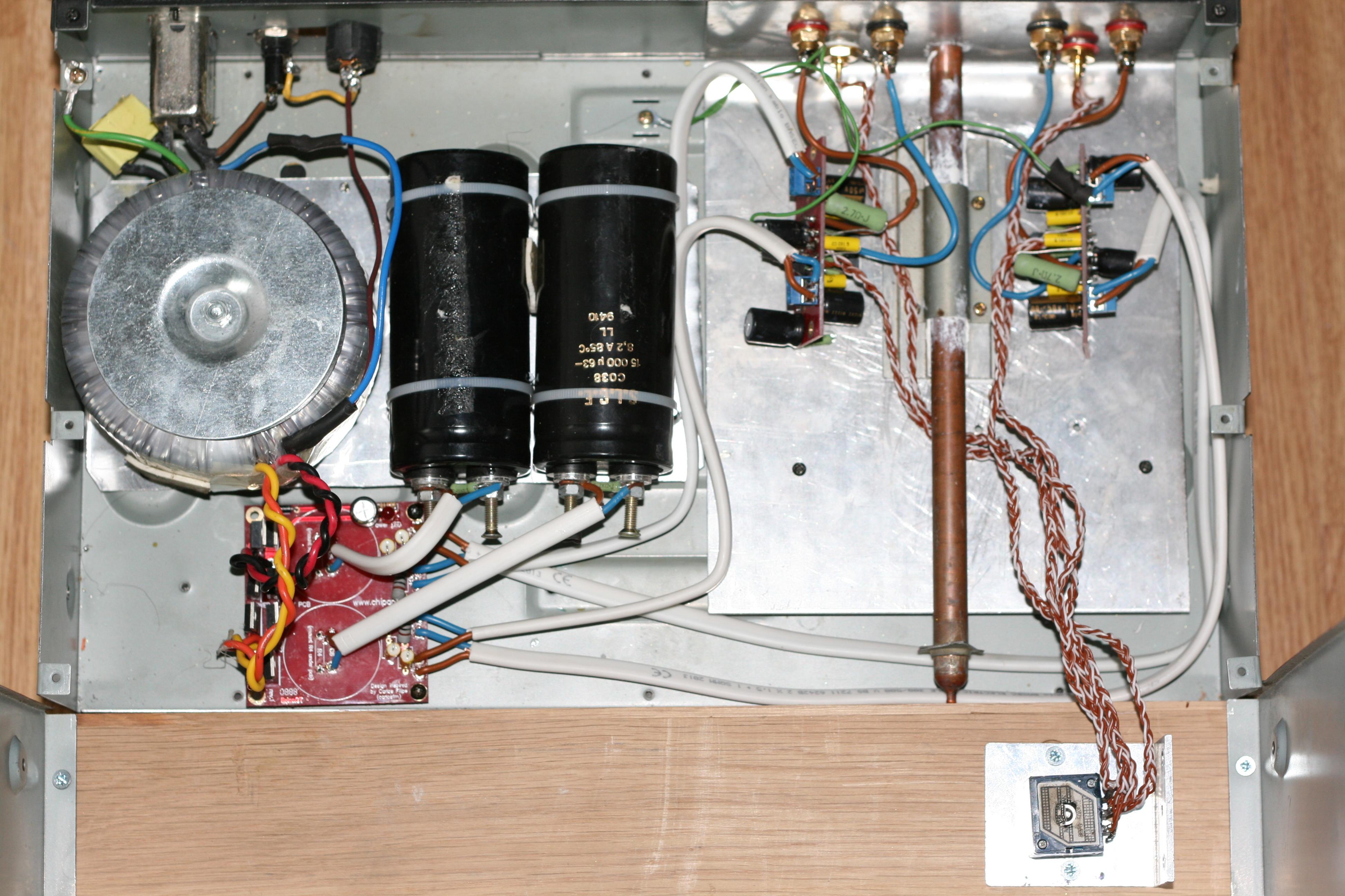

If I want to increase the capacitance, can I simply put extra caps parallel or do I have to exchange the existing ones?
I have used the chipamp.com miniA psu boards for my LM3886 builds. Then I stick about 60000uf on there with some great diodes and its really a fantastic sound.
Joery you can just add them in parallel. Easy with screw top caps. Just a bit of wire and add it to the power input wires going into the amp if you want to test the idea.

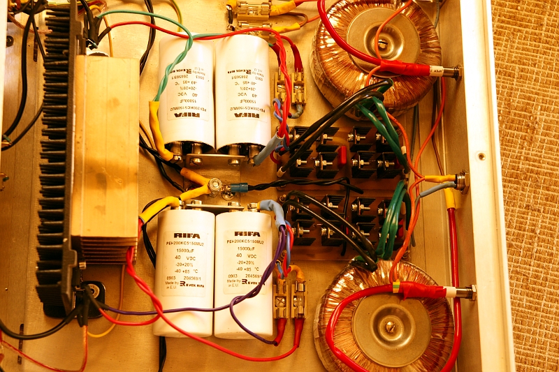

and don't forget that standard capacitors have +- 20% tolerance. good ones have -20% and + 70%. And capacitors aging...
i don't believe i capacitor sound but this one with 4x 15 000 rifa sounds very good.
