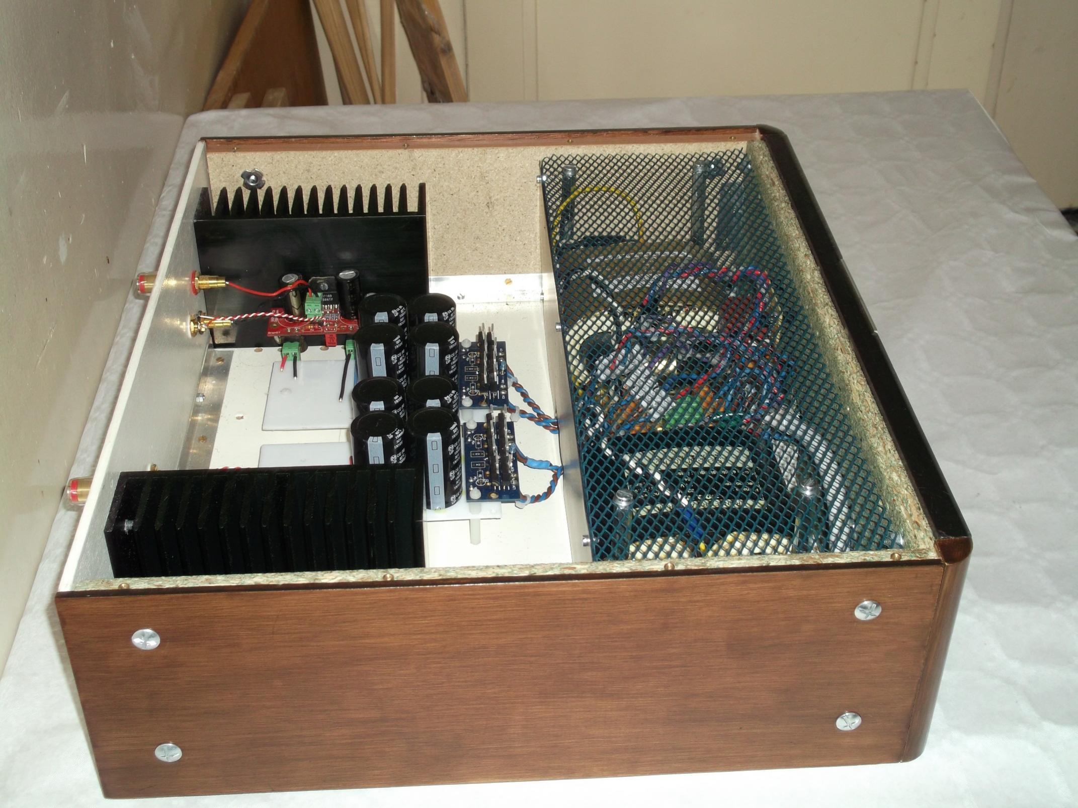

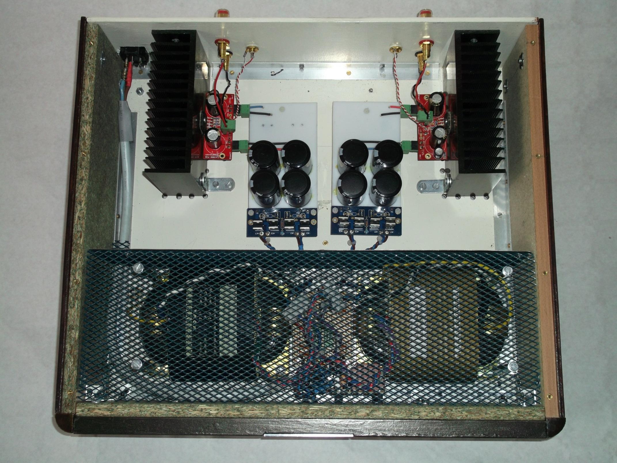

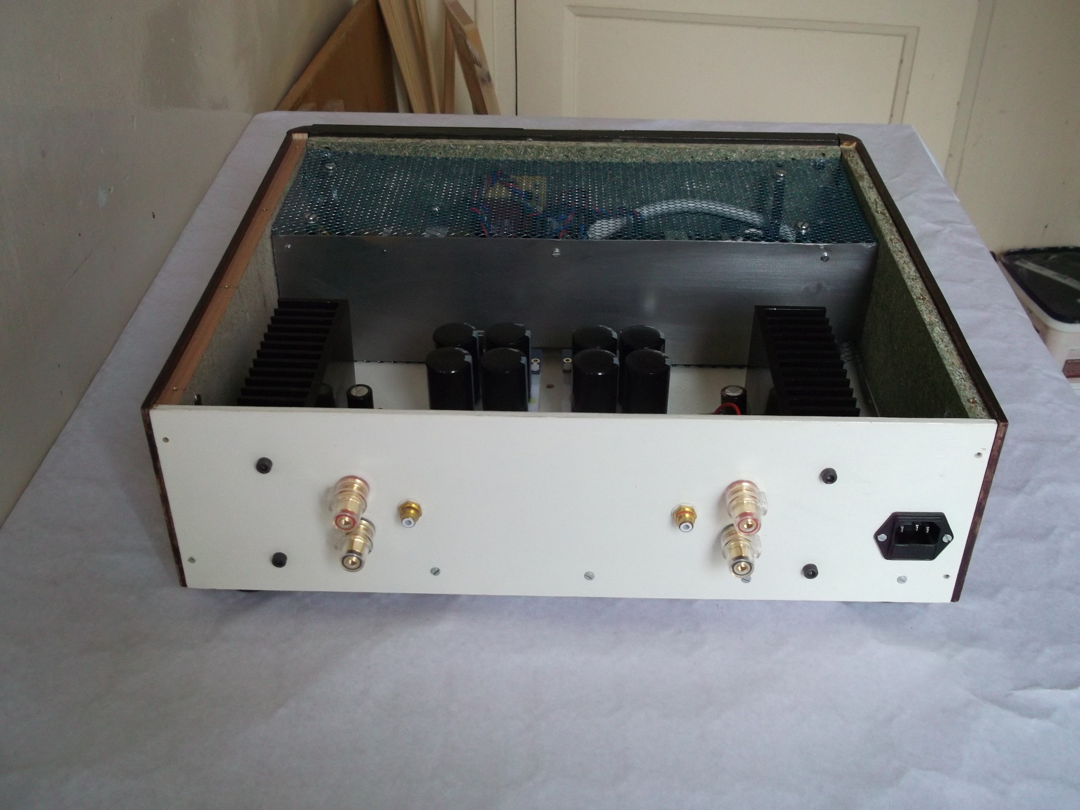

My vintage look Chip Amp

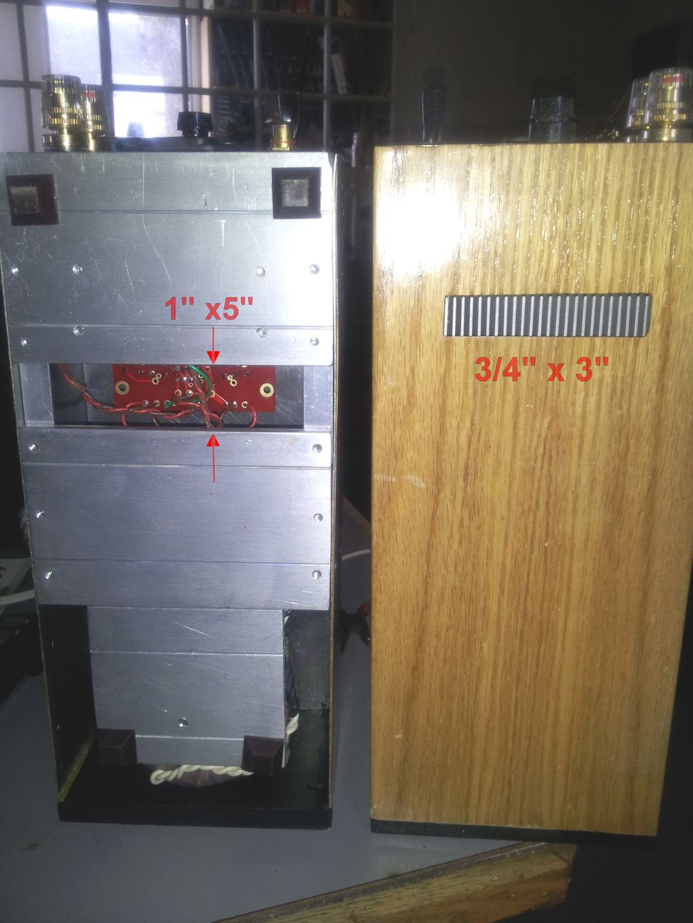

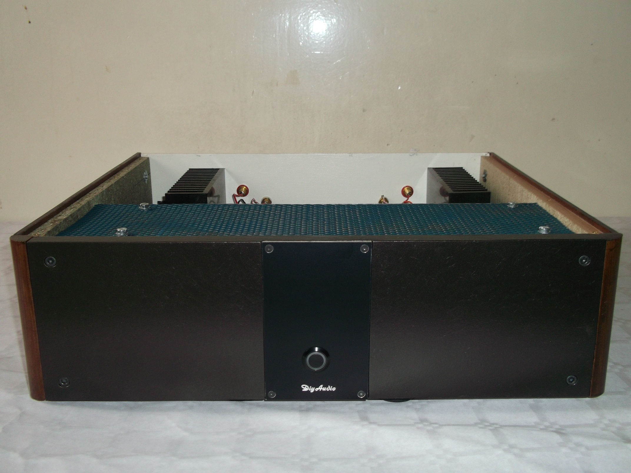

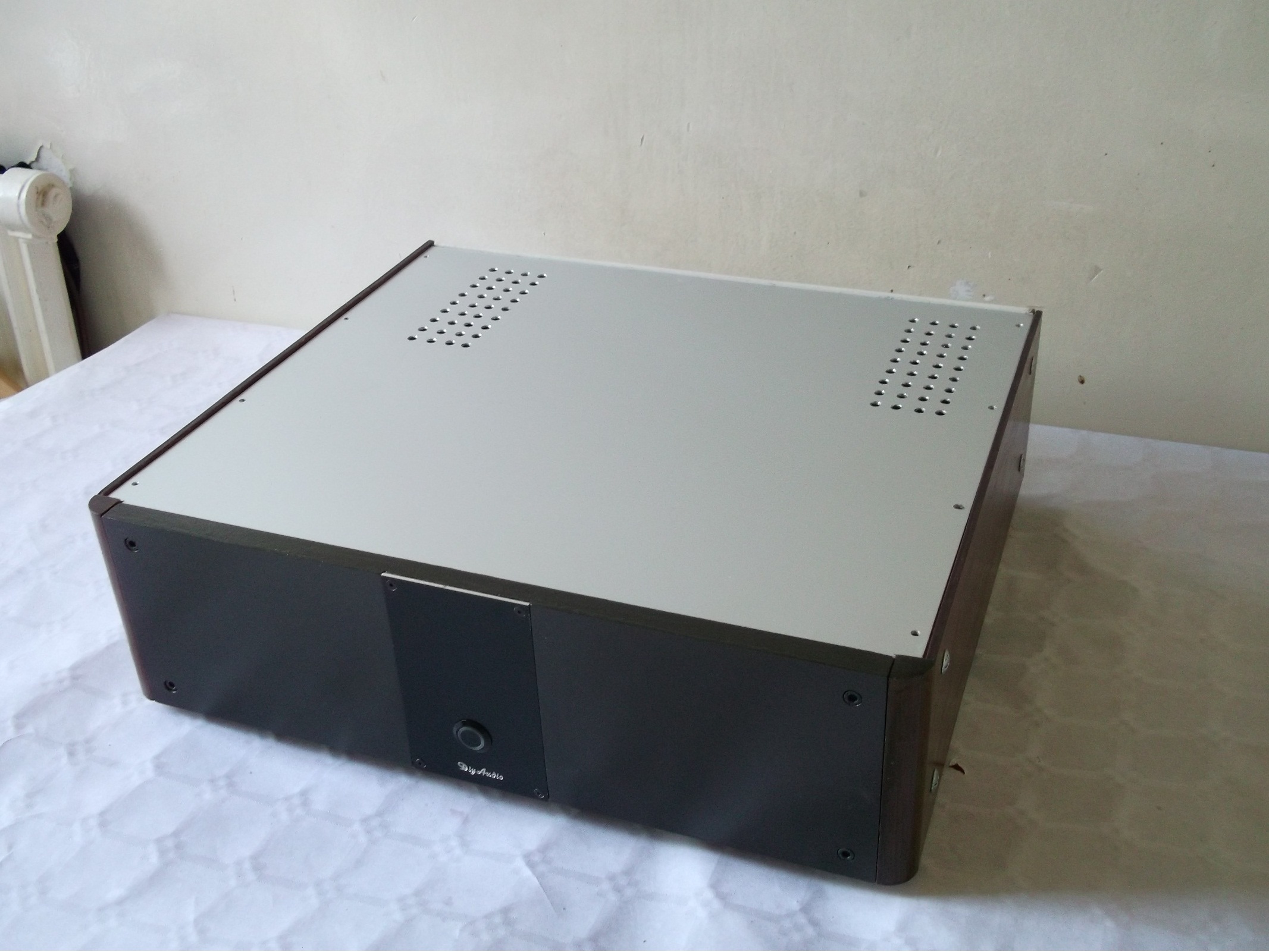

This is my new amp.
It's based on a Brian GT LM3886 Kit with some modifications.
The sound is very good to my ears, this the best power amp that I ever had.
The enclosure is mainly made of wood.
Despite the holes I have made under and over the heatsinks, the temperature grows rather rapidly in the enclosure. I will have to change the back plate layout so that I can have the heatsinks outside.
Some Technical details are available here :
http://www.diyaudio.com/forums/chip-amps/187908-lack-bass-lm3886-4.html

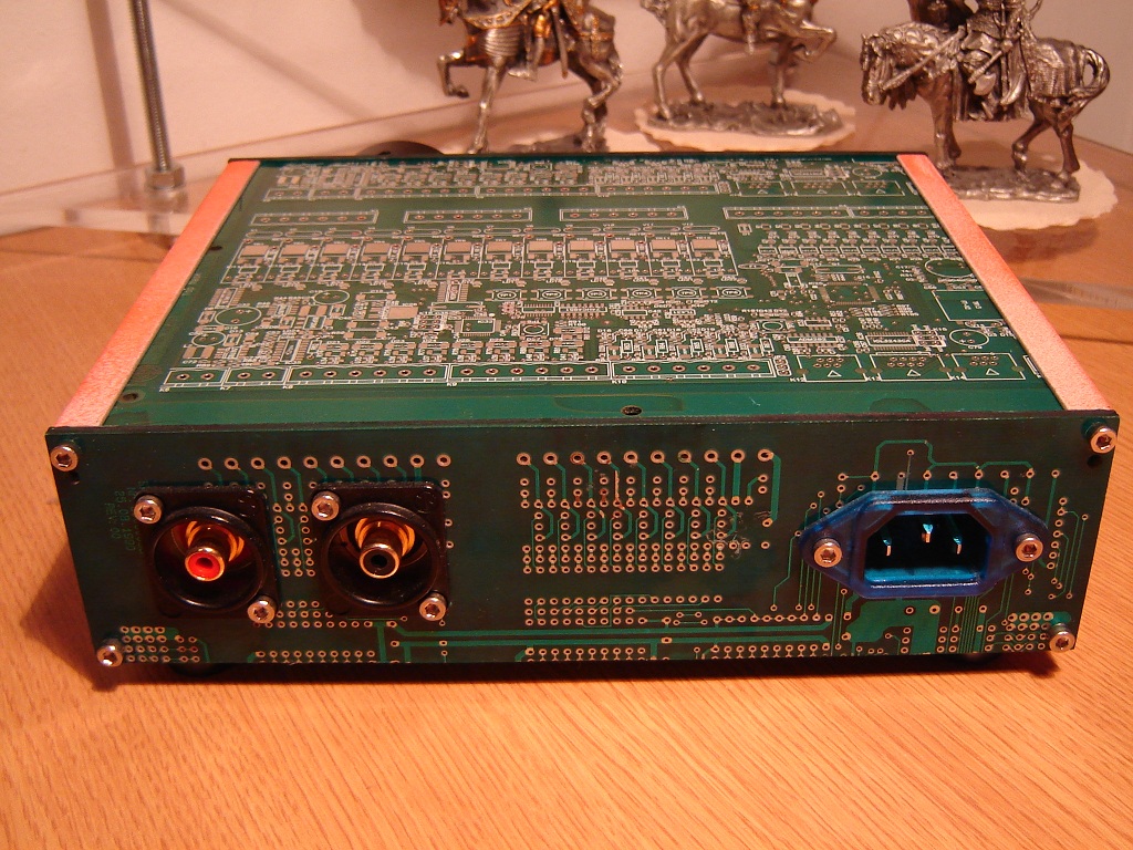

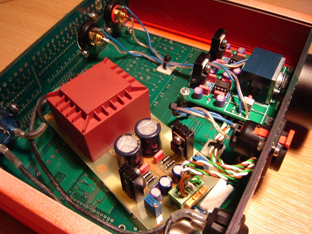

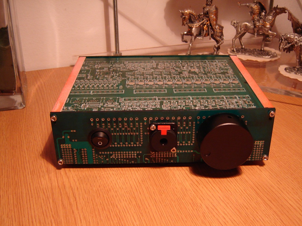

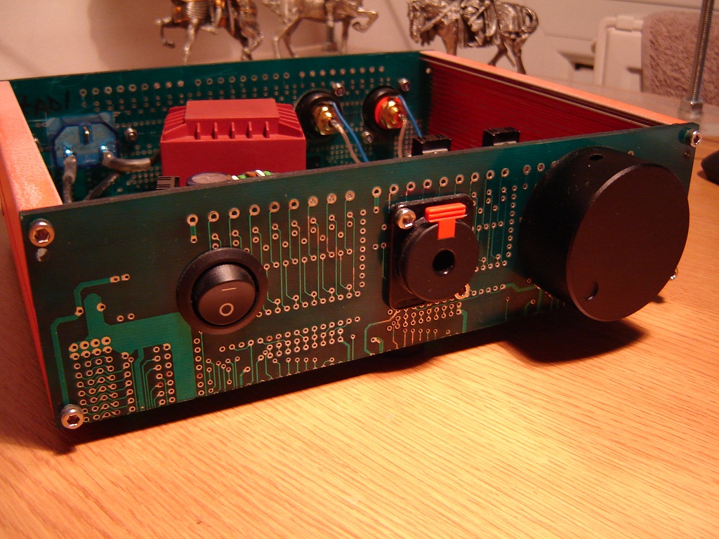

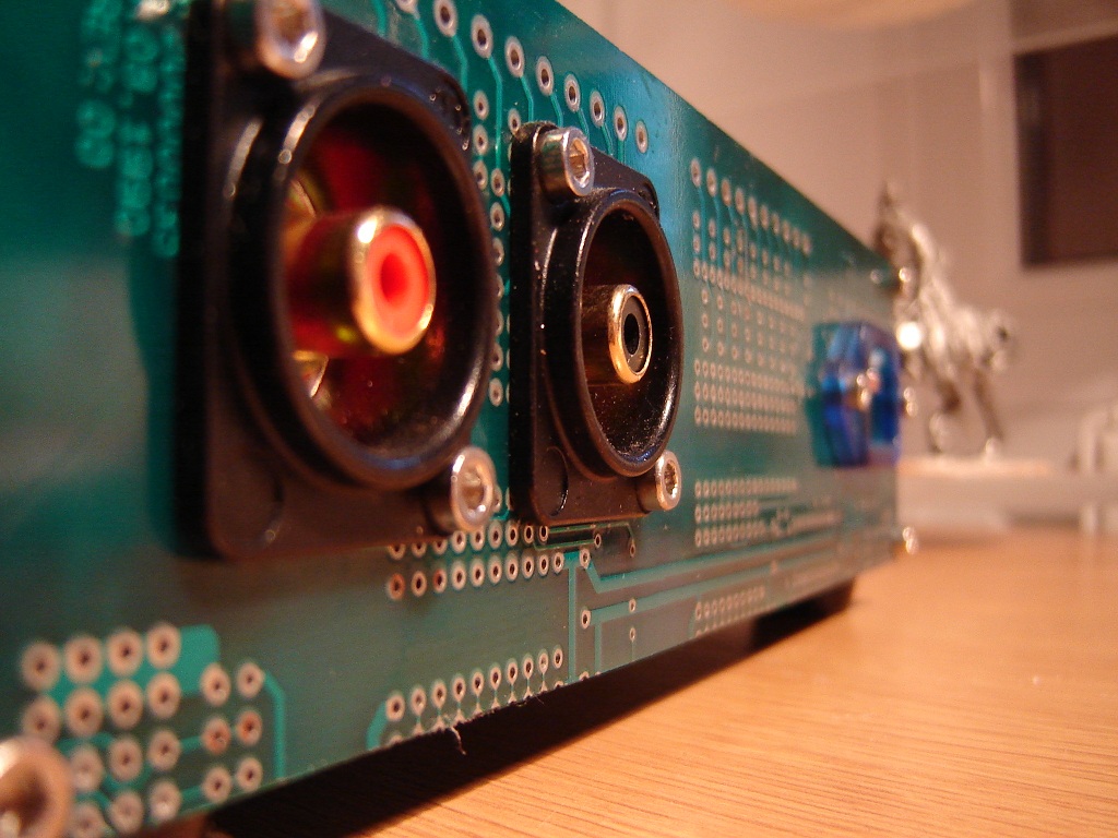

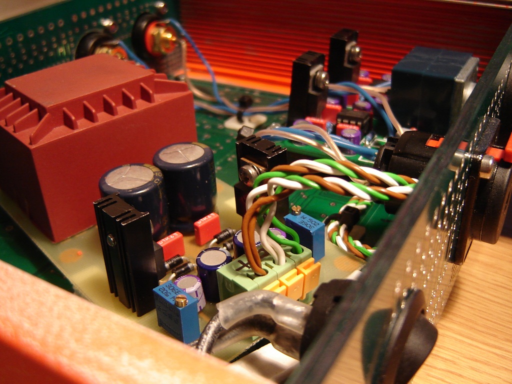

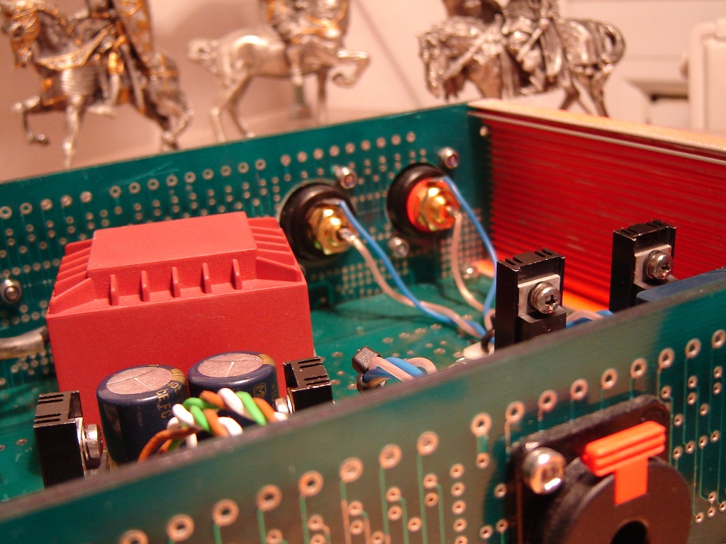

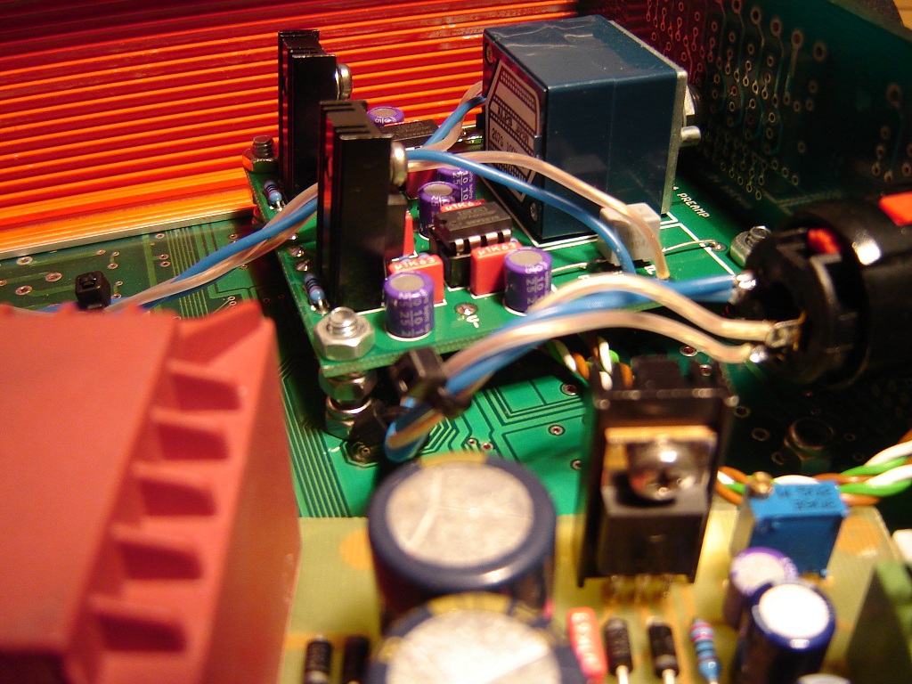

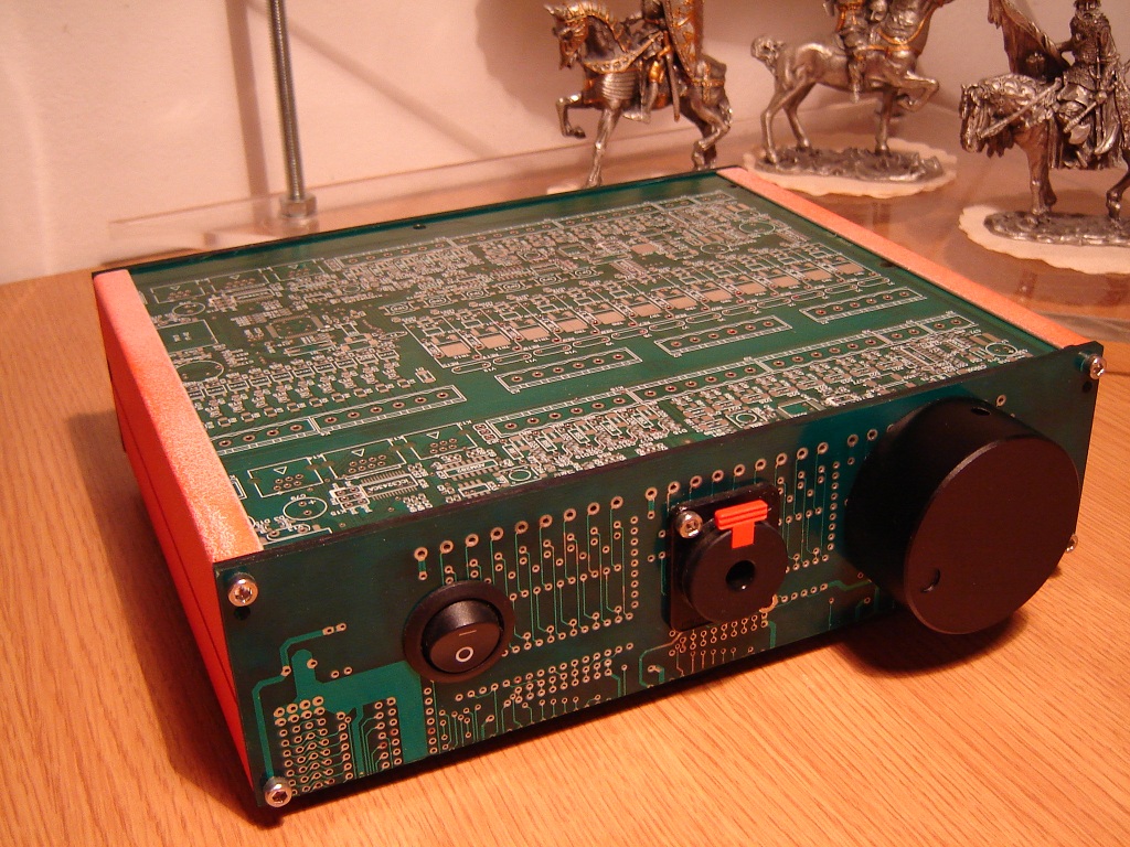

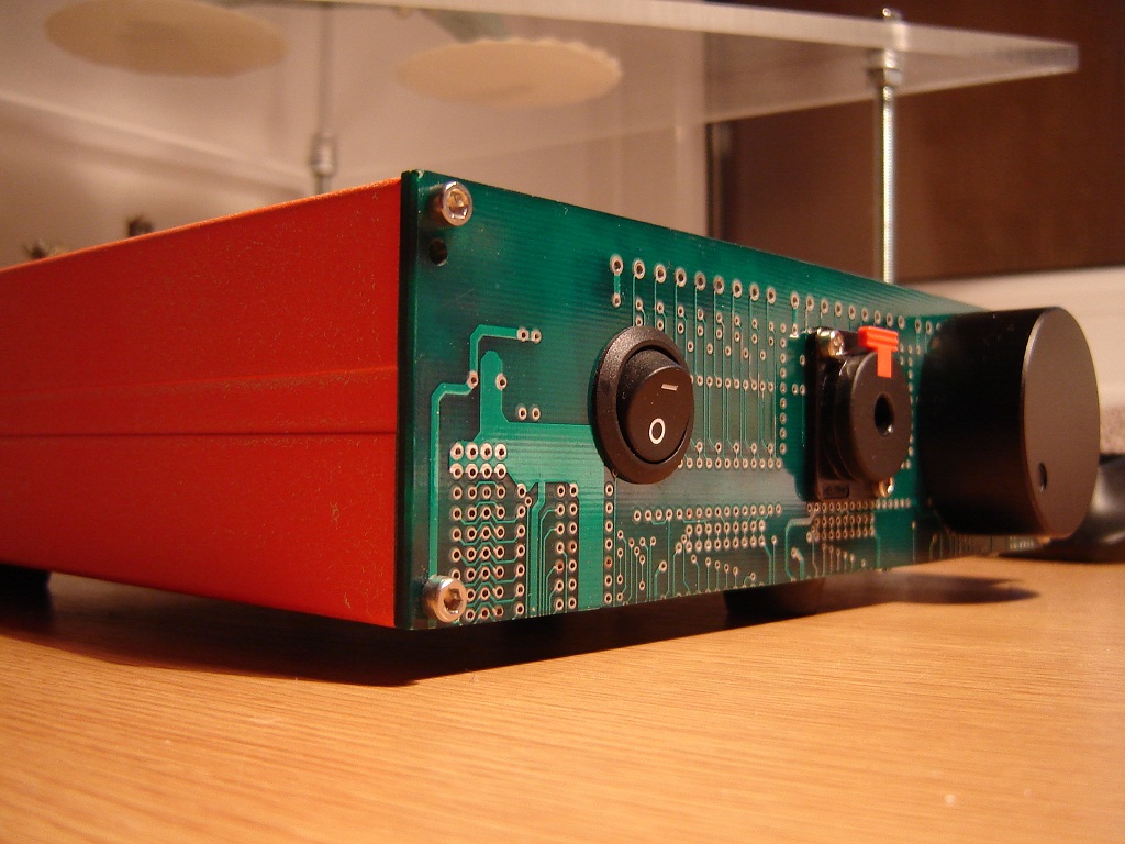

BUF634 headphone amplifier
My headphone amplifier based on BUF634T, the PCB is designed as dual mono but I am using it as stereo. I the near future I will replace this LM317/337 regulator with tracking preregulator based on Linear technology LT's, that is why the wiring isn't done so well.
For the casing I have used old PCBs and two aluminum profiles from other casing. RCAs and headphone jack are from Neutrik, volume button and rhodium IEC are from ebay. I really like it visualy and sonicaly, sound is very neutral with lots of dynamics and really goes well with mine HD598.
