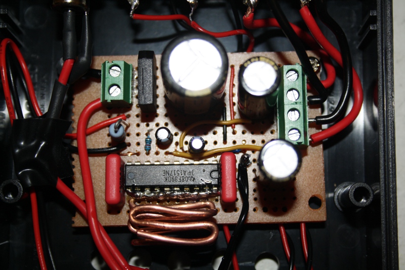

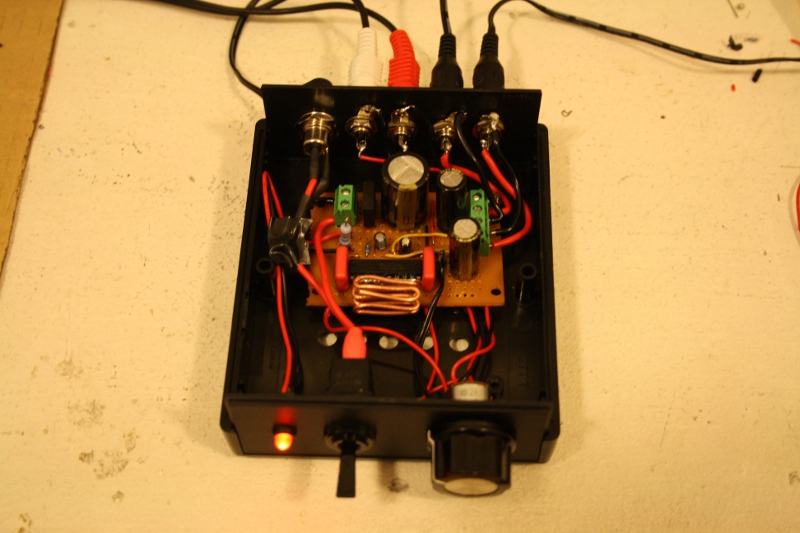

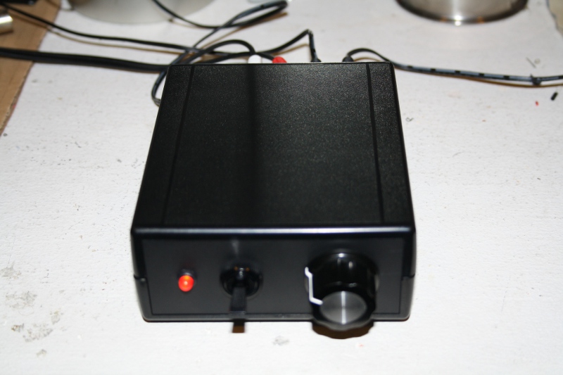

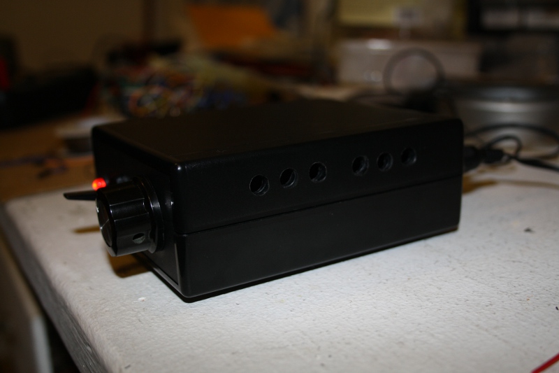

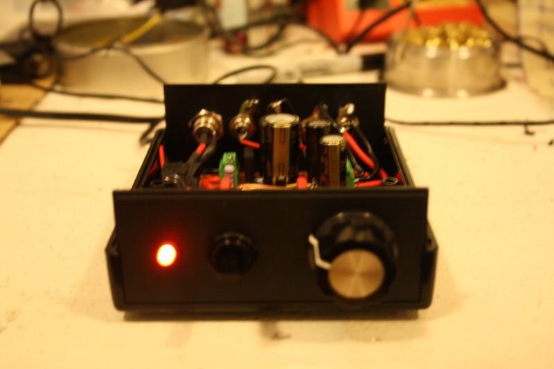

Here are some photos of my first chip amp, which I completed yesterday. It's a cheap and cheerful TPA1517 amp, powered from a 12VAC wall wart. I am using it with some cheap bookshelf speakers I picked up from a thrift store for $7.50. Obviously neither the amp nor speakers are hi fi, but they actually sound quite good to my ears, especially when you consider the overall price of the system. Certainly a huge step up from laptop speakers!

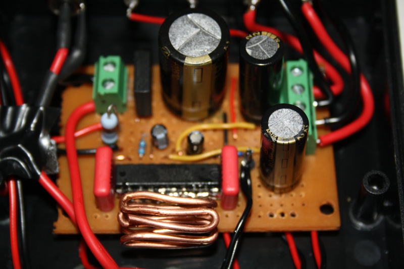

Nothing too pretty or interesting to look at, except perhaps for my improvised heatsink. Pins 10-20 of the TPA1517 (i.e. one whole row of the chip) are heatsink pins. The idea is that if you are etching a PCB for this chip you connect these pins to a big copper plane to act as a heatsink. Since I was using protoboard and not my own PCB, this wasn't an option for me. So I took some heavy guage copper wire, like what they use for house wiring, and bent it into an elaborate little miniature radiator shape, and soldered part of it all along the relevant side of the chip, as you can see in the photos. There's also some more of that wire on the underside of the board. This system seems to be working well enough. The chip doesn't get that hot in the first place.
I highly recommend the TPA1517 as a very simple project for beginners. It runs from a single-sided supply, requires the bare minimum of external components, has the gain internally set to a sensible level (20db) and puts out more than enough power for sensitive speakers (6W per channel into 4 ohm), and sounds pretty good. Should be far more rewarding than two LM386 chips for about the same complexity.

AudioSan, yes, the 6W is peak, obviously continuous power is much lower. But with sensitive speakers 1.5W is more than loud enough for domestic listening. I don't think I'd ever turn the volume on this past the half way point, since I live in an apartment building and have neighbours to be considerate of.
ofcource. with 98db sensitivity it will be loud🙂 no dobdt. but it will have a hugh lack of headroom. you will loose control(power) allready at about 90db.
That is true. It will not fare well trying to play very dynamic music at loud volume. But it's not without its uses. I might build something a little more powerful for a future project, but I found this a great introduction to chip amping.
