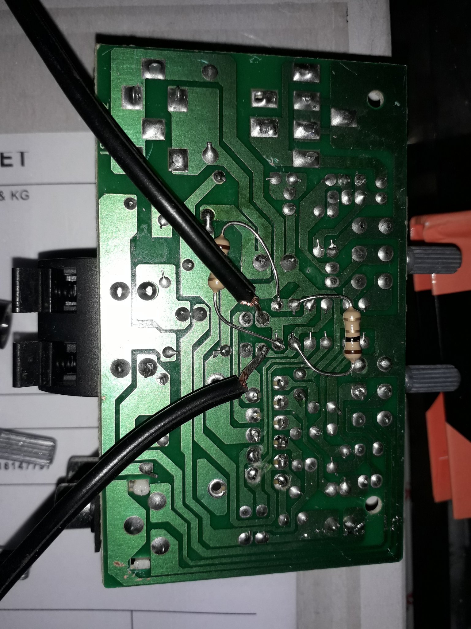

Tested now chip amp with TDA2004. From post 199 in this thread.

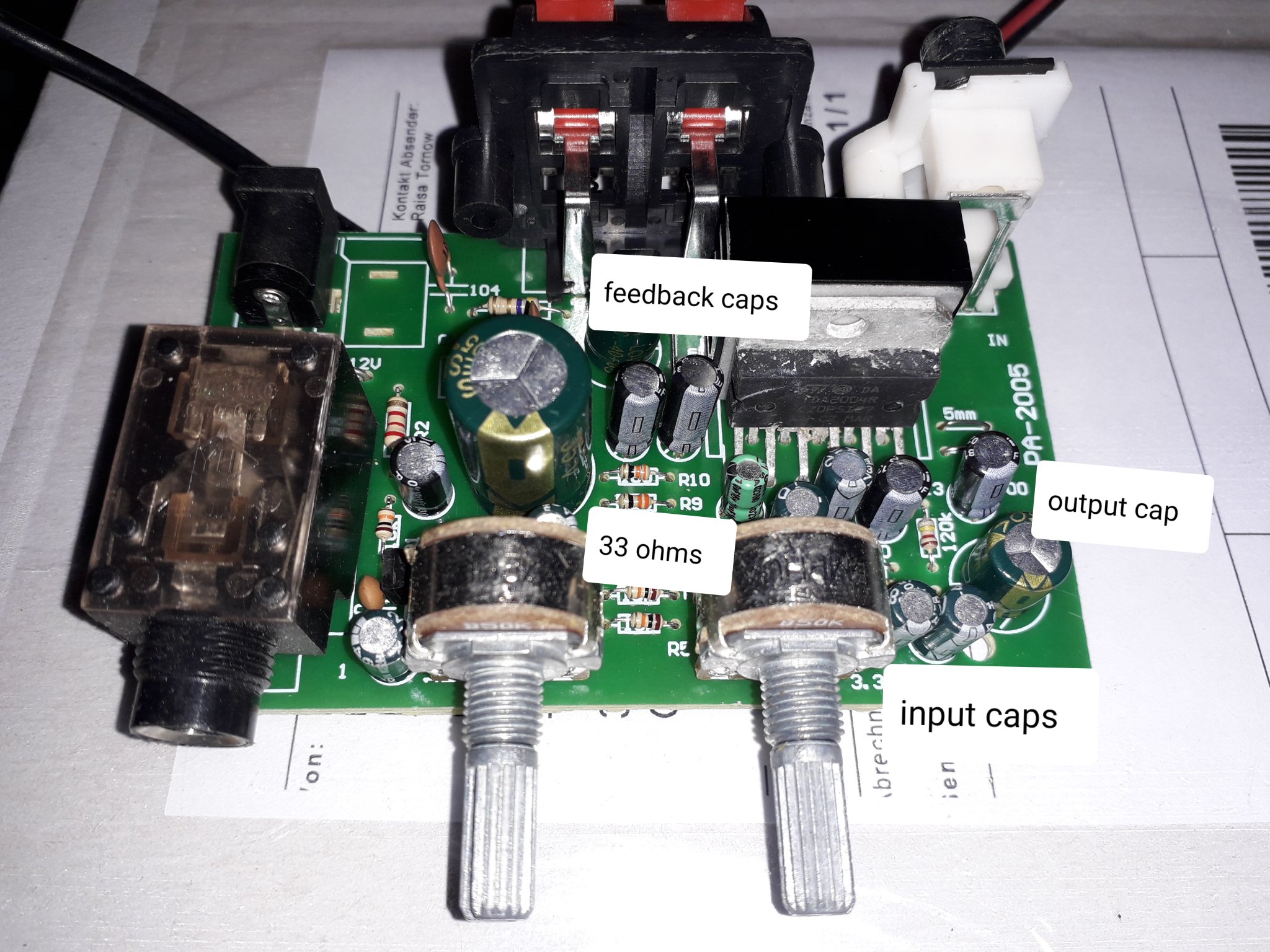

The current sensing resistor must be one ohm. I tested 0.5 and 0.15 ohms, too.
One ohm is just right.

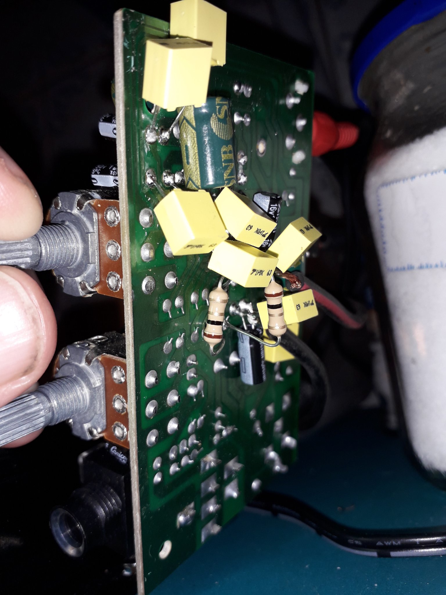

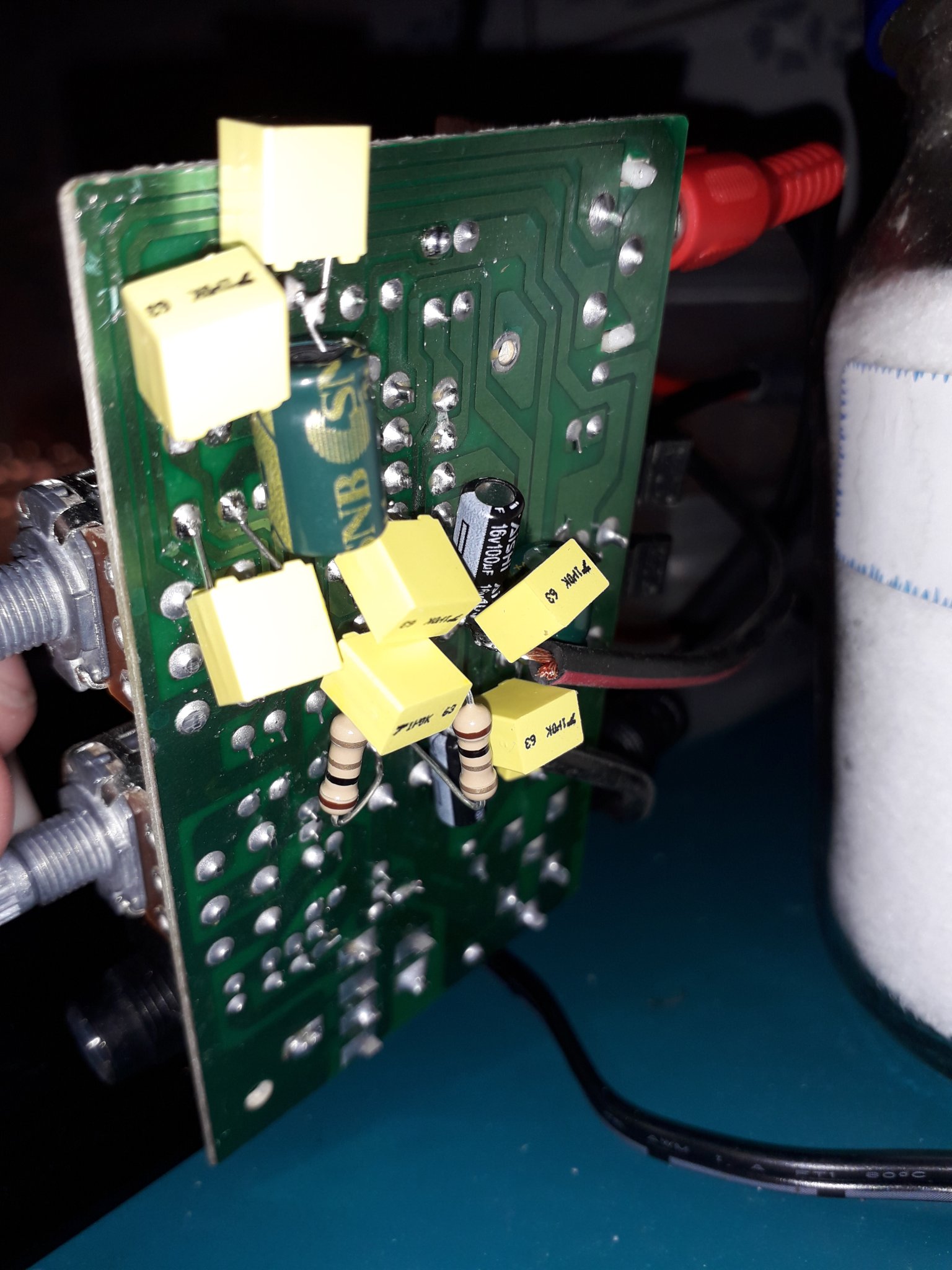

I added 1mfd MKT to all relevant electrolytics. It helps the sound.
Minimal configuration works fine with the current sensing resistor to 1 ohm (original on the pcb is 33 ohms - far too much).

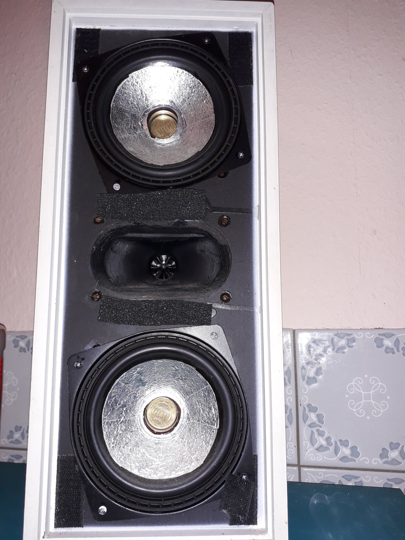

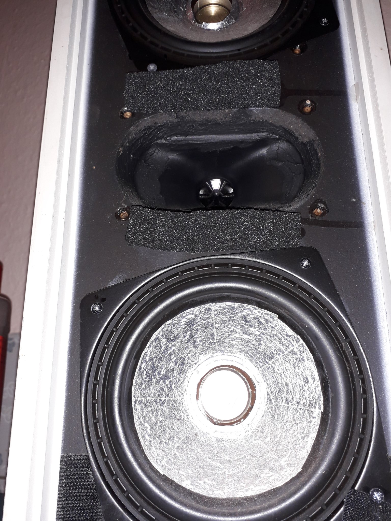

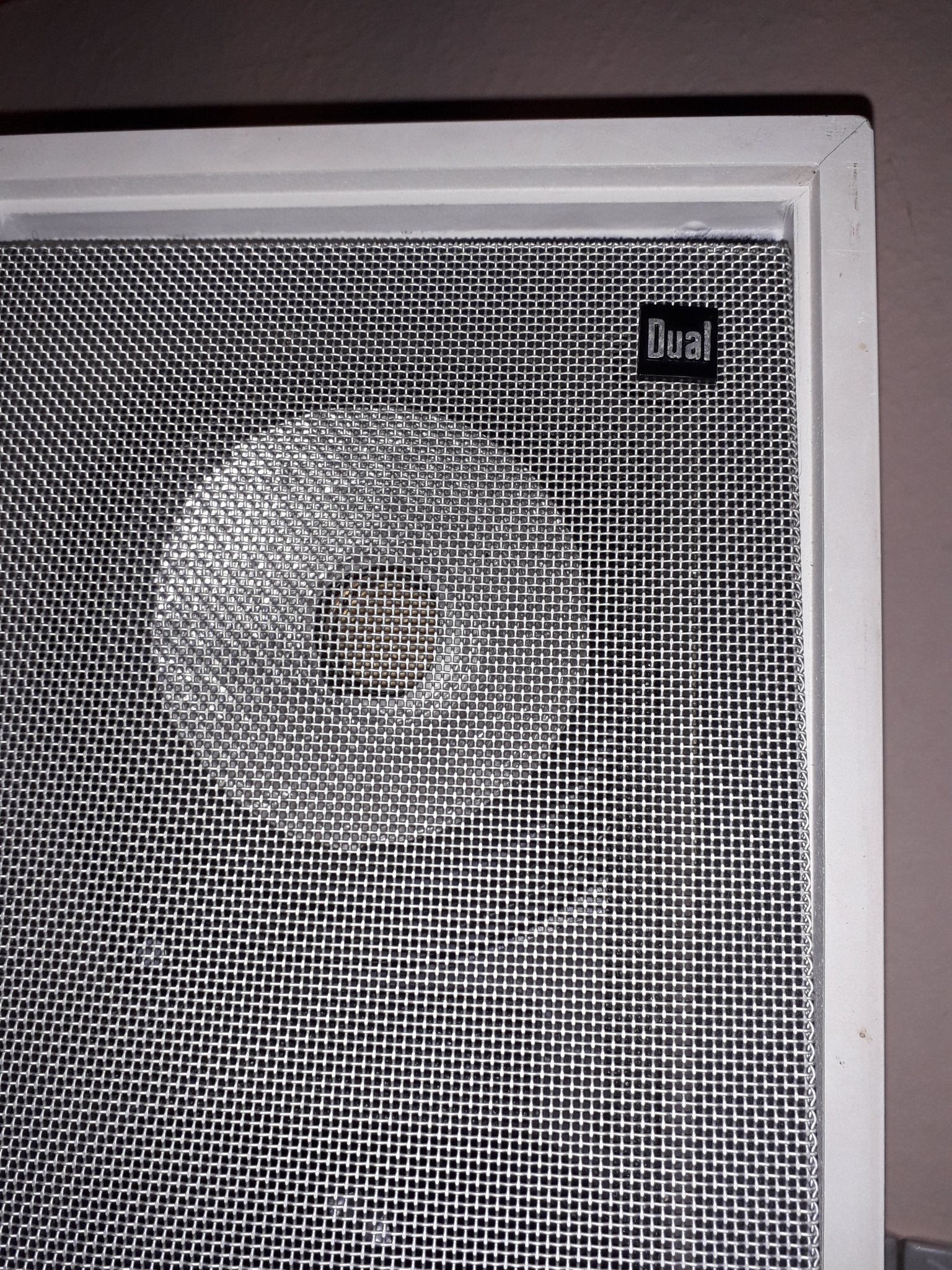

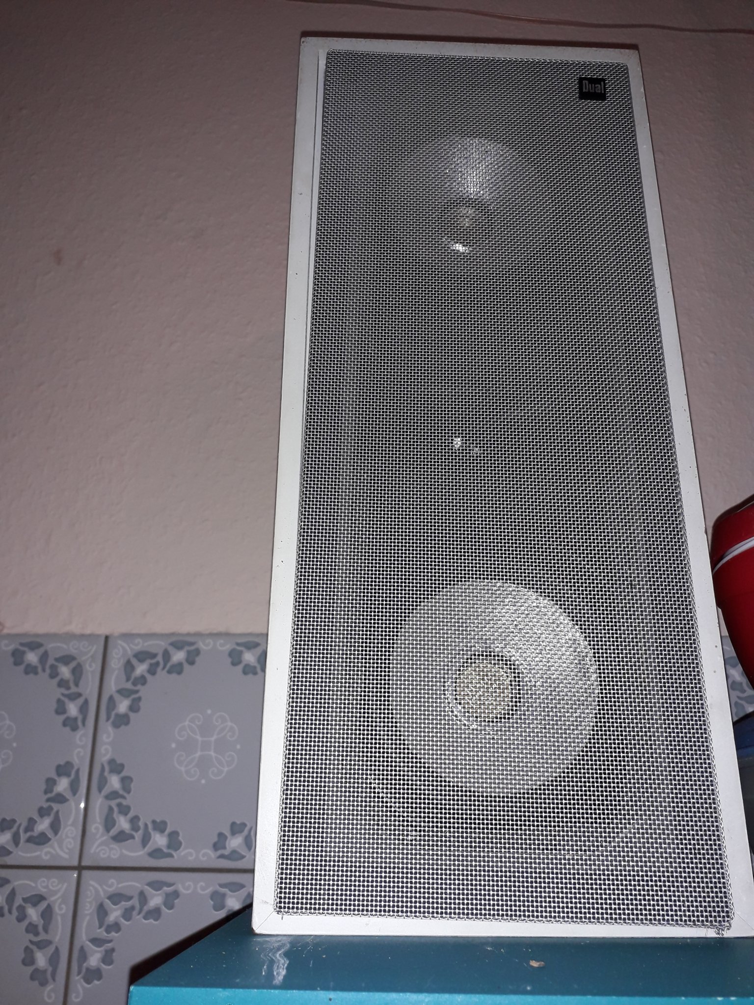

With the bass light loudspeakers I have (two 12cm fullranges with piezo tweeter in old DUAL enclosures and low tuned reflex ports close to back wall) this amplifier sings, sings, sings.
I am impressed again what current feedback does sonically to fullrange drivers.
It corrects the highs and bass "automatically" and the depth in sound gets soooo good.

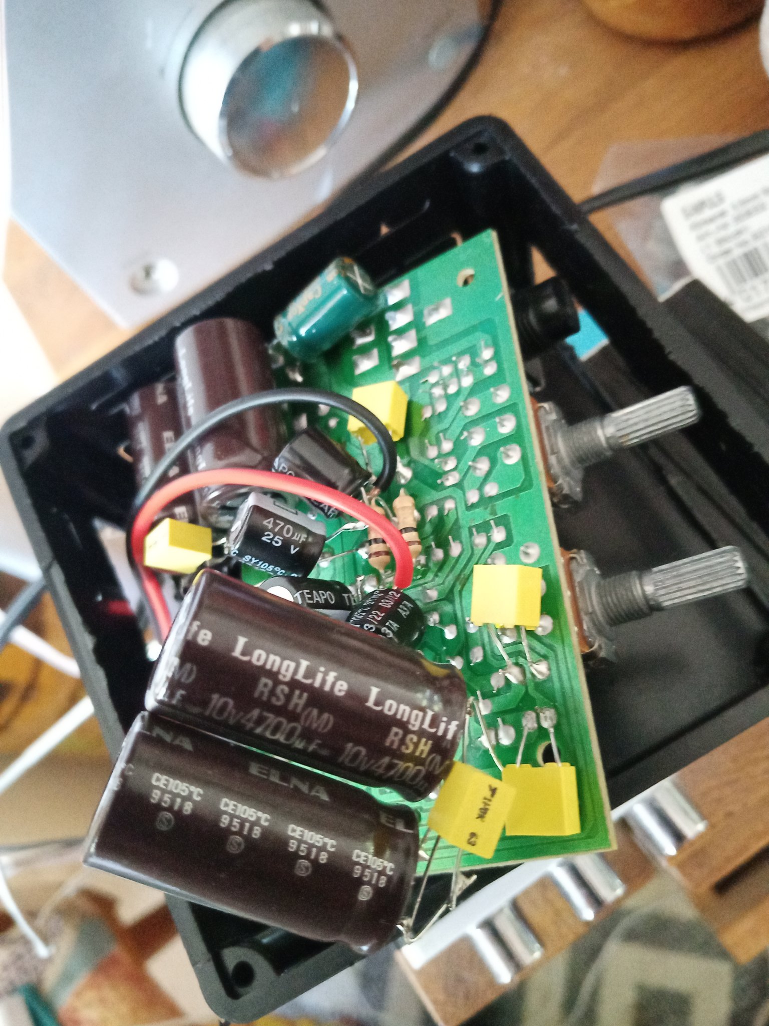

Output cap is original 10volt 820mfd. I doubled that. Not tested if its necessary.
Added to the 100mfd 16volts (feedback cap) a second one. Not tested if necessary. But the foils help the sound, they are on:
Coupling capacitors input+output. Feedback caps and for the power lines on the chip.

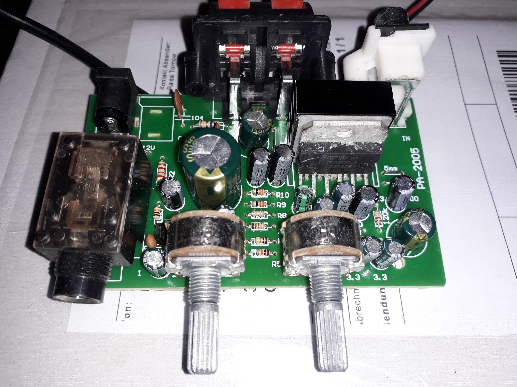

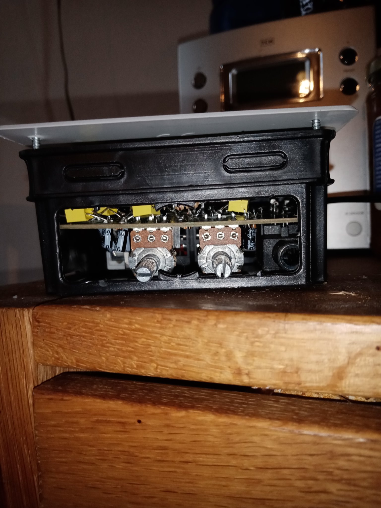

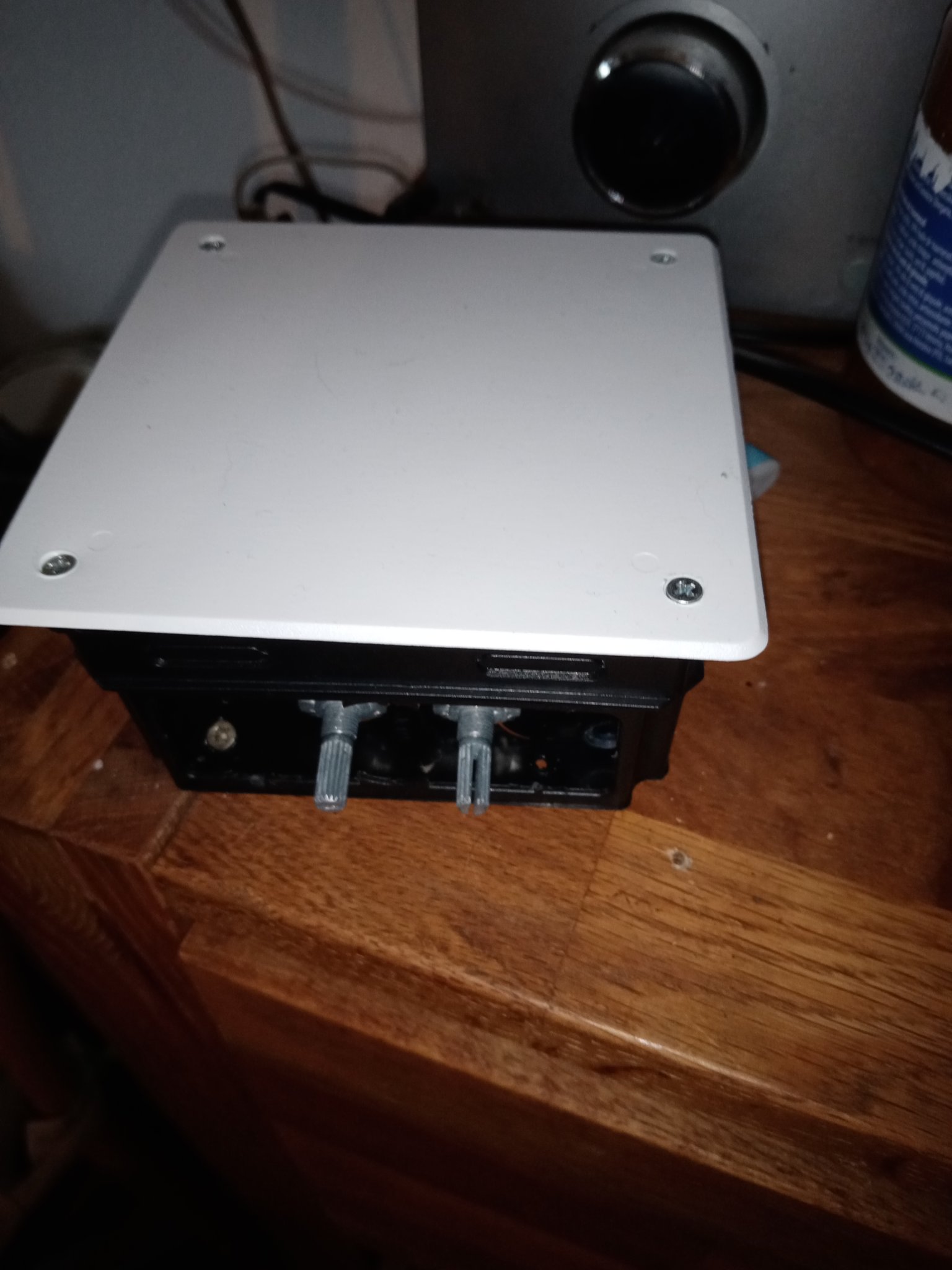

The right trim (50k) is for loudness.
The left one I guess for the microfone input. Turning it exerts some irrelevant change to the sound. Its no bass or treble knob

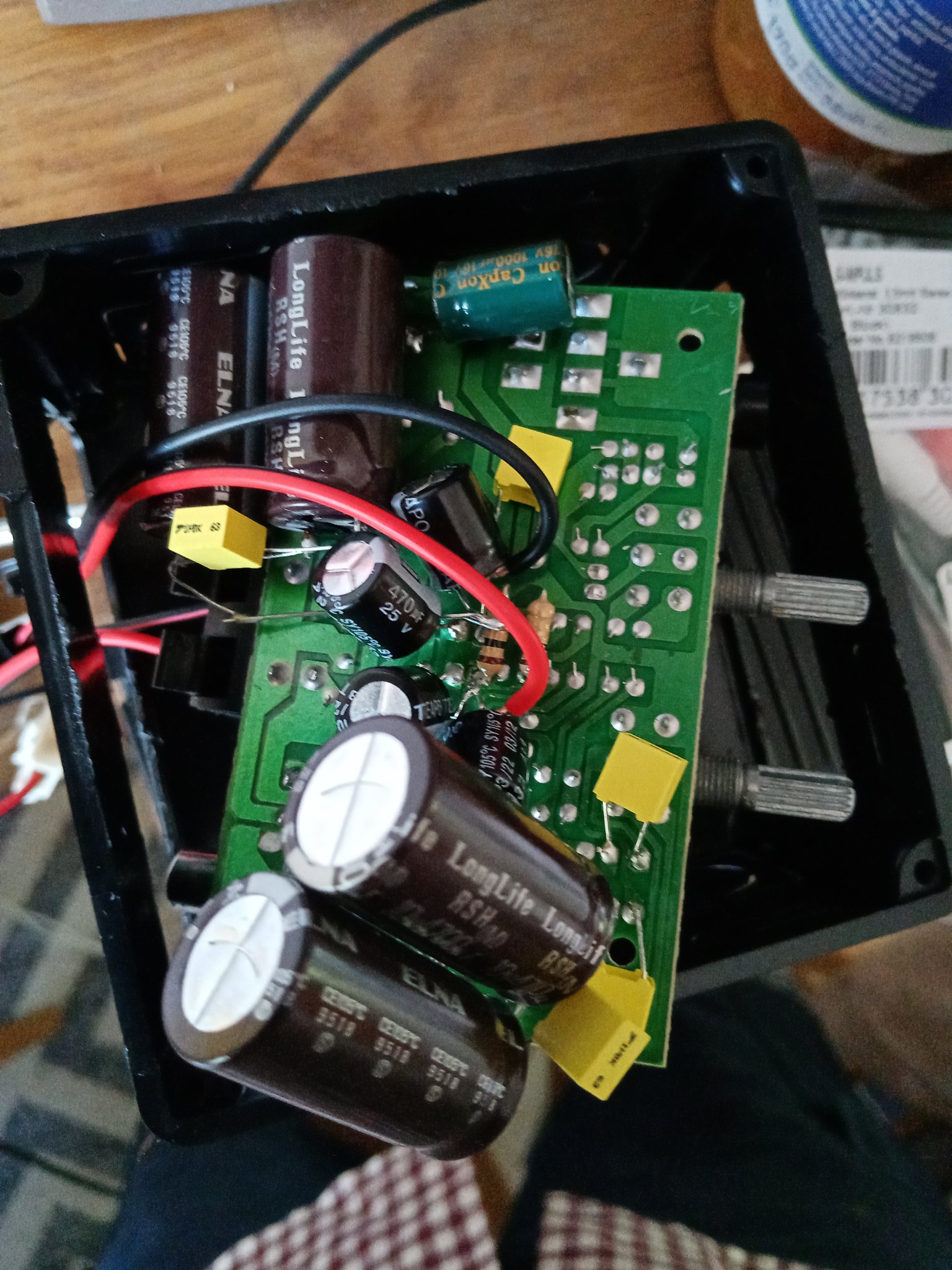

I tested now some tweaks.
Original output cap is 10v 820mfd. Here I add at least 1000mfd or change for one with 2200mfd.
Feedback cap is 100mfd. It's too small cutting the bass. With 200mfd it sounds good. 470mfd did not do well. Here an extra 1mfd MKT foil was not of sonical profit. I just use electrolytic here. The highs sound more realistic.
The power cap is 35v 1000mfd original and it sounds nice with bass shy boxes. If you have enough bass capacitance can be popped up and it sounds then more dry and controlled. You can adjust to your taste.

TDA2004 amp:
I tried out now bipolar electrolytic 2x2200mfd 16v - combining polar Cs - for the output and bipolar for the feedback capacitor (2x 470mfd, 16v).
Reduction in distortion is clearly audible. Maybe you can get the same result by using electrolytics with higher voltage like 25/35/50v.
So for a sound design you can choose between less distortion and more distortion - just to match your taste.

Putting 1mfd foil directly on + and - on the chip and putting 1mfd foil cap on the bootstrap electrolytic (100mfd) made the highs sound better.

Amplifier has least distortion with 1000mfd orginal capacitor in place. Depending on your wall wart smps you use more capacitance (2000 or 3000 mfd) sounds worse. Easily identifiable by distortion: more distortion means psychoacoustically less bass and highs.
Now this capacitance can be used to attenuate your loudspeaker although it should not be used for this. A speaker dominated by bass and highs will sound nicer with 2000 or 3000mfd with the wall wart smps mentioned (2A 15Volts). The difference in sound is prominent and therefore easy to detect.
If you really want to optimize your amplifier by ear you end up always to change only one single part and listen to it. Or you use measurements to check.
So this small TDA2004 amp sounds best:
bipolar electrolytic for feedback capacitor (+100mfd for the original 100mfd installed)
bipolar electrolytic for output capacitance
some foil capacitors on all electrolytics and directly on the plus and minus power supply pins of the chip
All in all a nice experience to make a ready made amplifier work well.

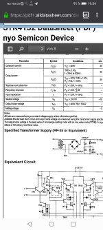

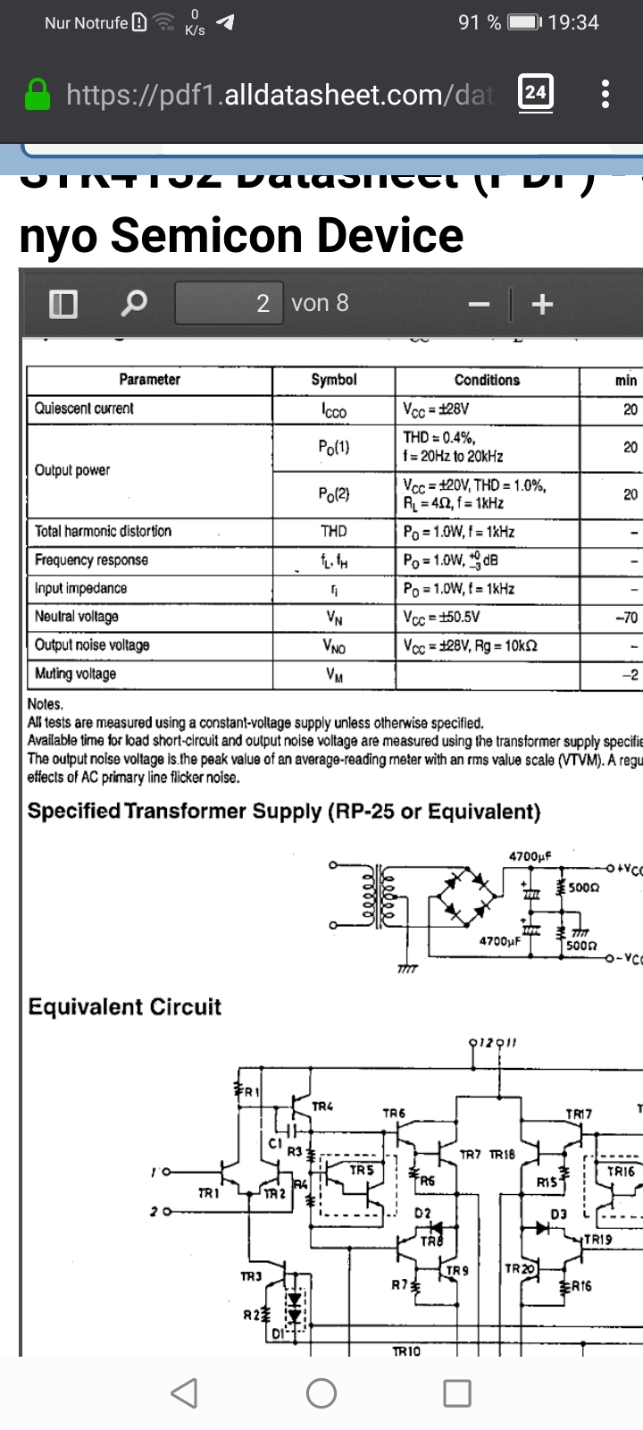

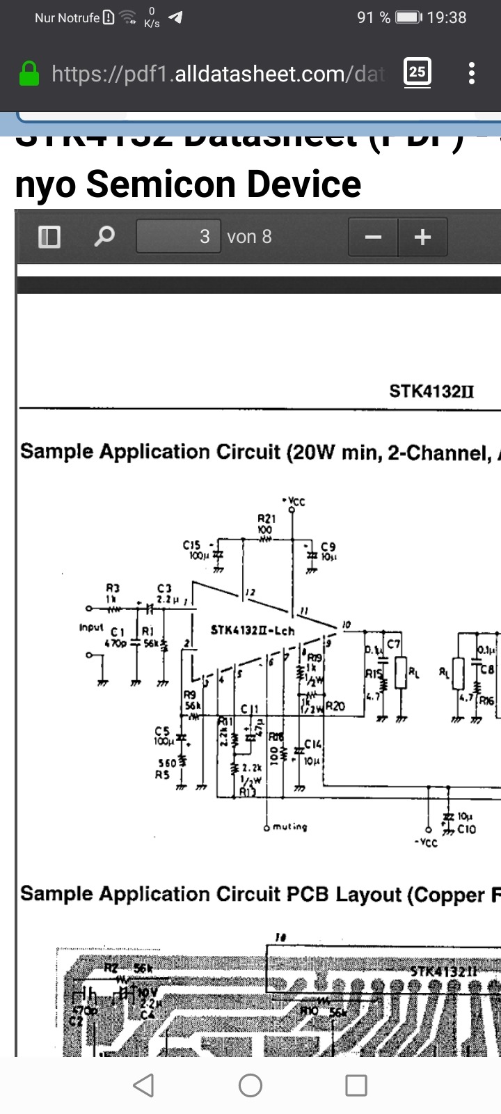

I want to order a transfomer for the stk 4132 amplifier. In the data sheet they mention a RP25 trafo - what does it mean?
Is a 15-0-15 transformer appropriate or can I take a one with more volts?
C5 is on my amp rated at 25 volts.
It's the amp from post 174
https://www.diyaudio.com/community/...fication-to-current-drive.389985/post-7274732
STK4132 can have max +/-34.5 VDC.
In datasheet they use +/-28 VDC for 8 Ohm load.
They use +/-20 VDC for 4 Ohm load.
I think you should use the 15-0-15 transformer. Will give like +/-21 VDC.
There is no good idea to hunt for much power. 20 Watt is more than you can use.
You can not turn up your potentiometer that high ...
25V for C5 is not critical, especially if you use +/-21 VDC
