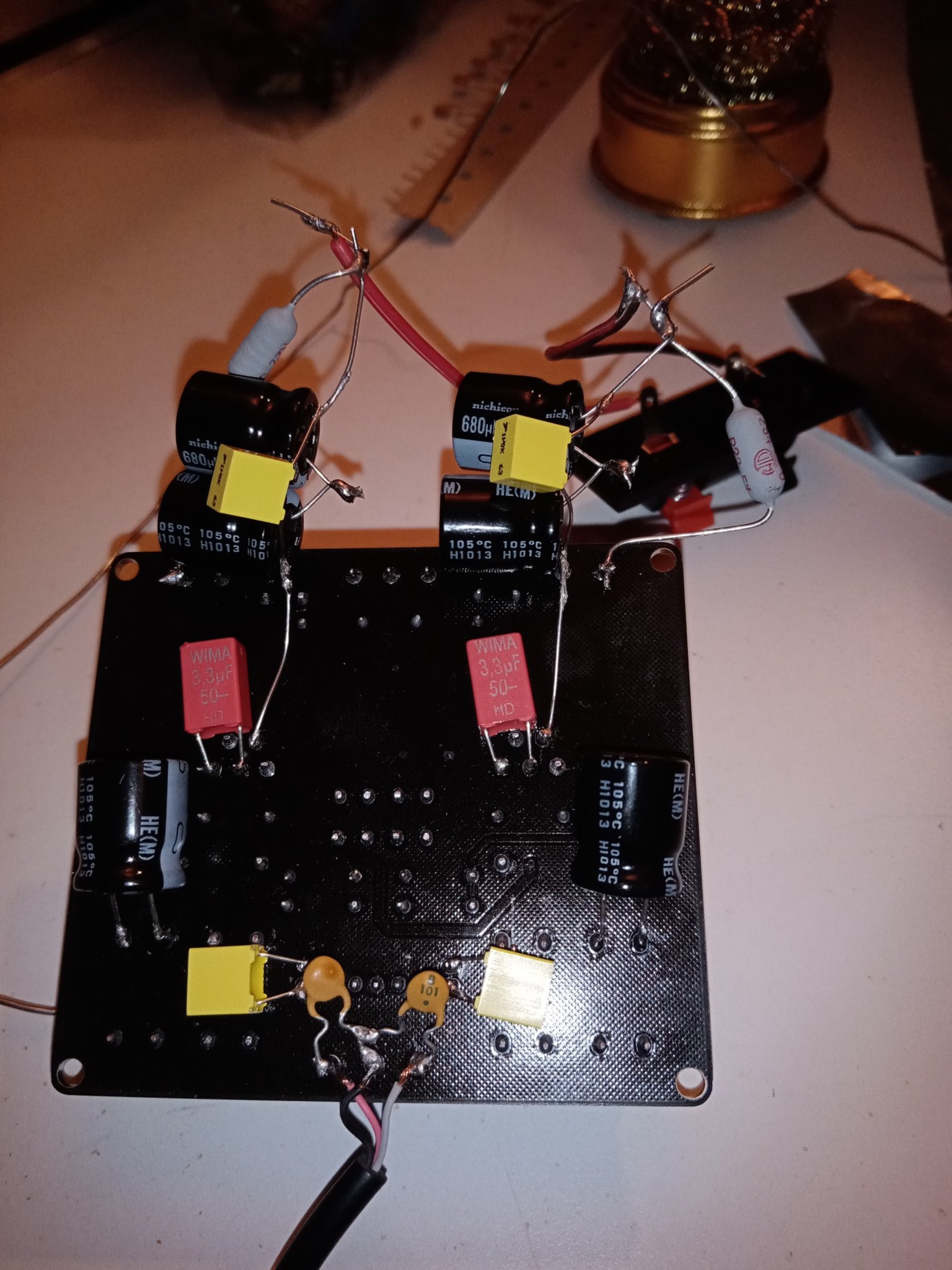

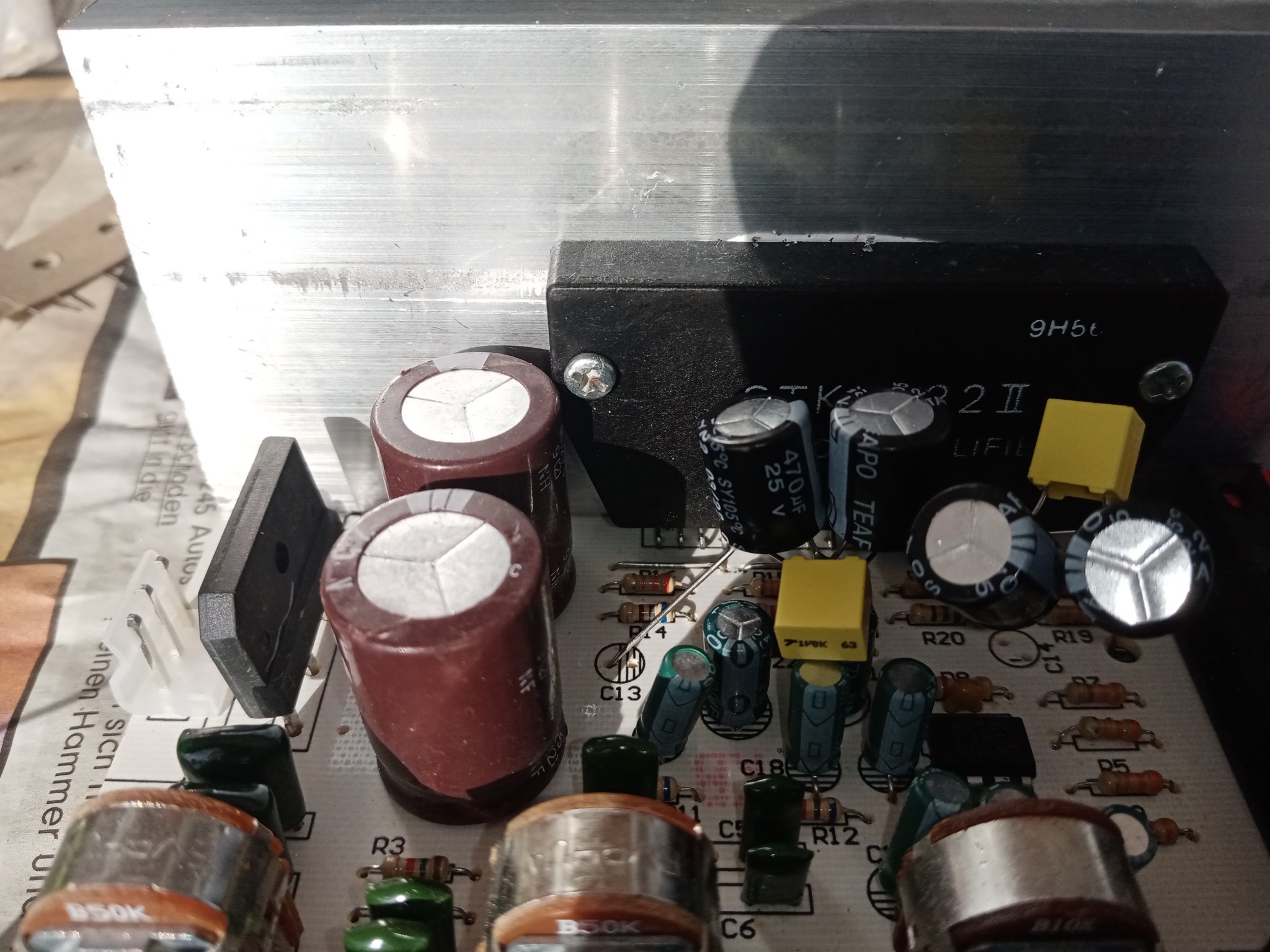

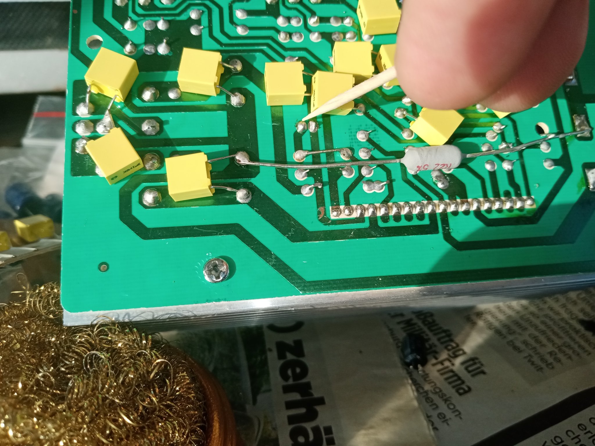

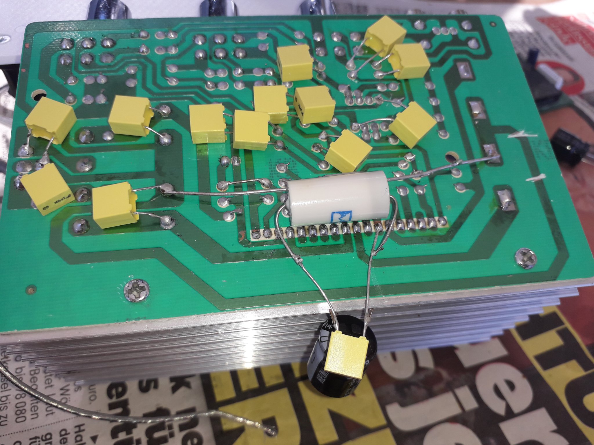

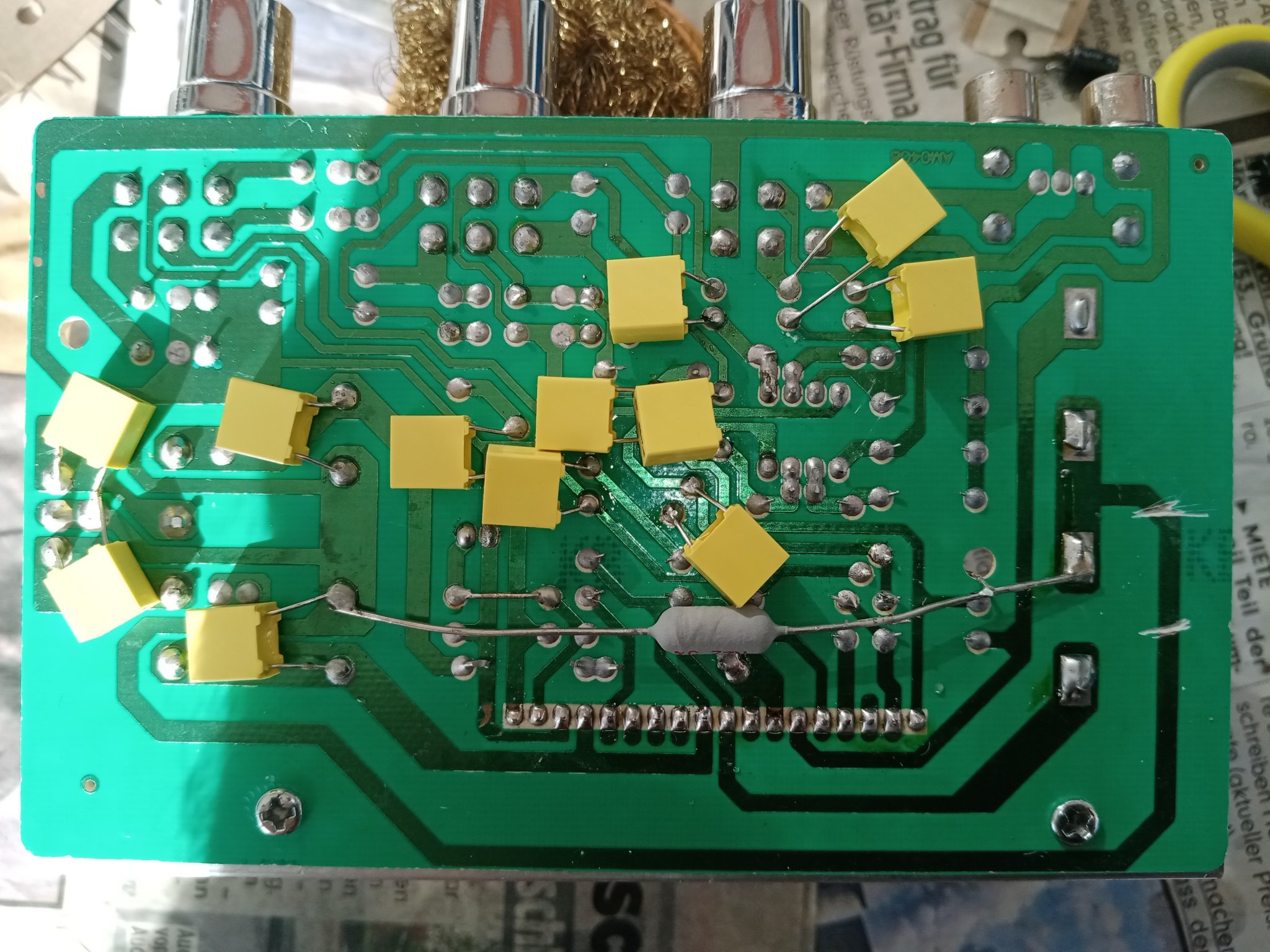

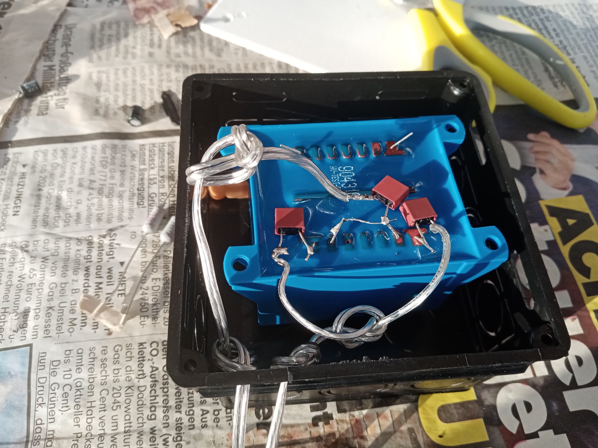

Now I found some time to modify STK4132 amplifier.

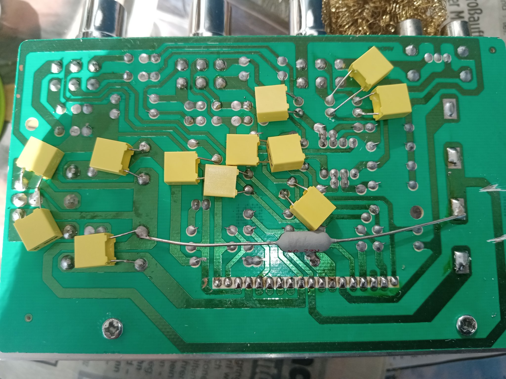

I did put 1mfd foils on every electrolytic. Cut the trace from ground to the - of the speaker binding posts.
The 100mfd 16v feedback cap changed to 220mfd bipolar, 25v and wired them to the speaker output minus.
Wired current sensing resistance 0.22 ohms, 3 watts to the combined ground of the speaker out.
I left the 4558 op amp in place as I have no desoldering copper at hand.
Think about putting a holder so I can try some other op amp. Got NE5532 and LM4562 for experiments.

Prepared 15 0 15 transformer, 25VA.
I bought a 15 0 15 transformer with 120va as well. Want to try out if it makes a difference.
Images of schematic in post #169

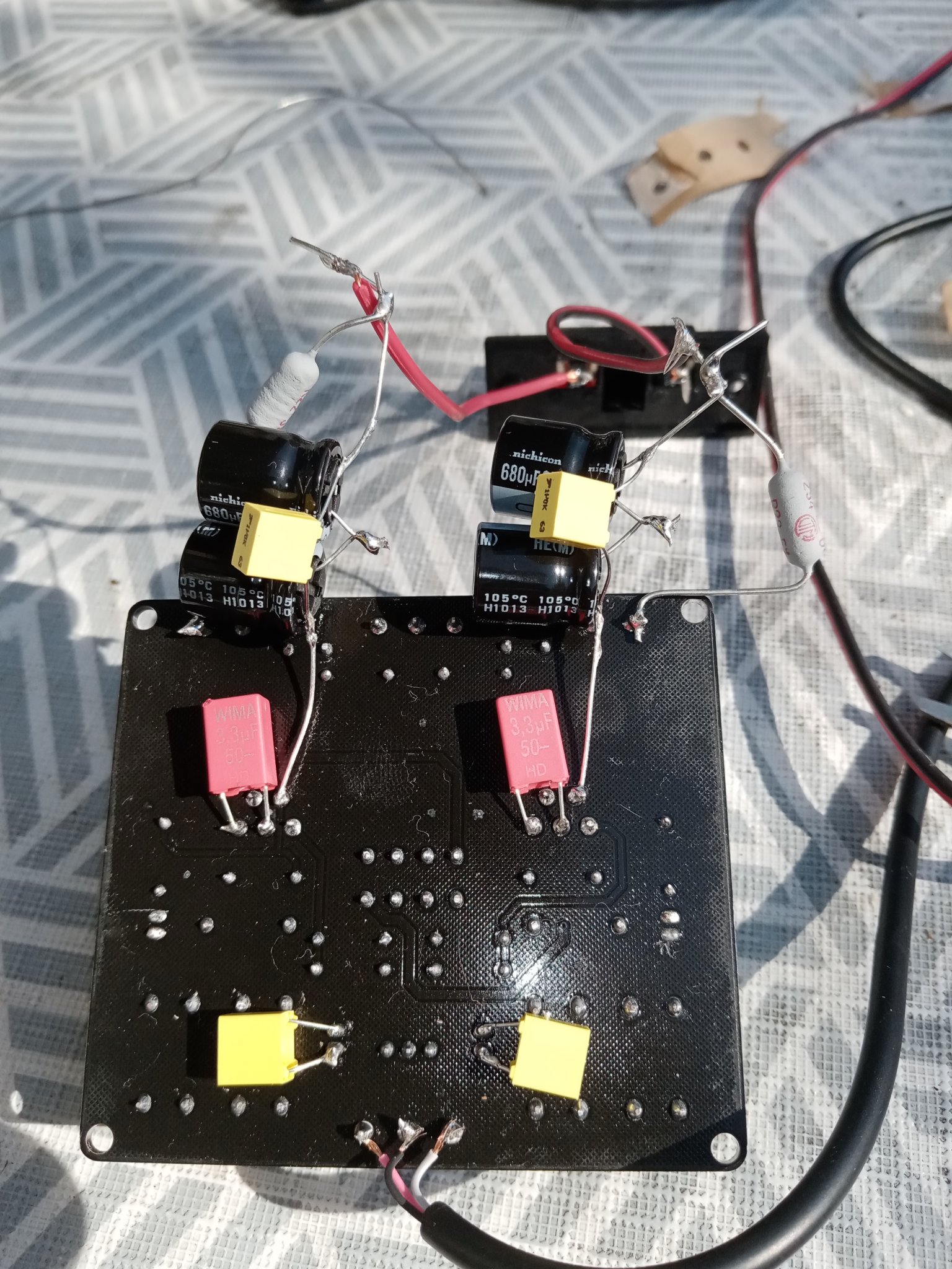

Correction for the points where to solder the feedback cap after removing old 100mfd 16v.
560 ohms is on this pre-assembled Chinese board before the feedback cap.
The 560 ohms to ground are R14 and R20 you can put the cap directly to one of their legs or you must bridge these R's.

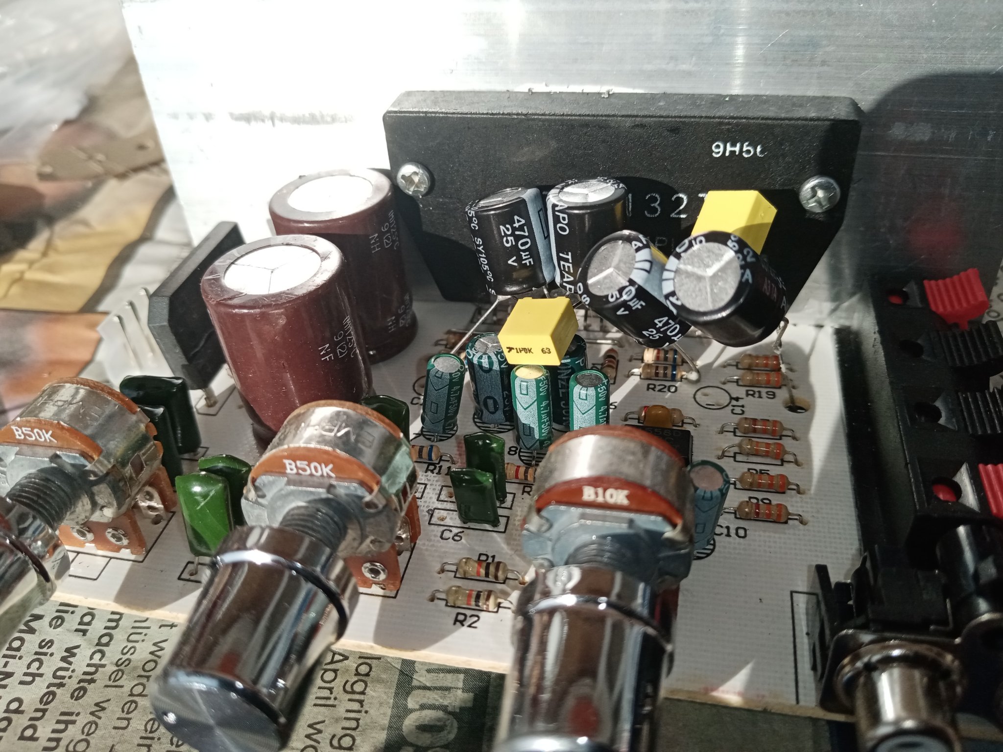

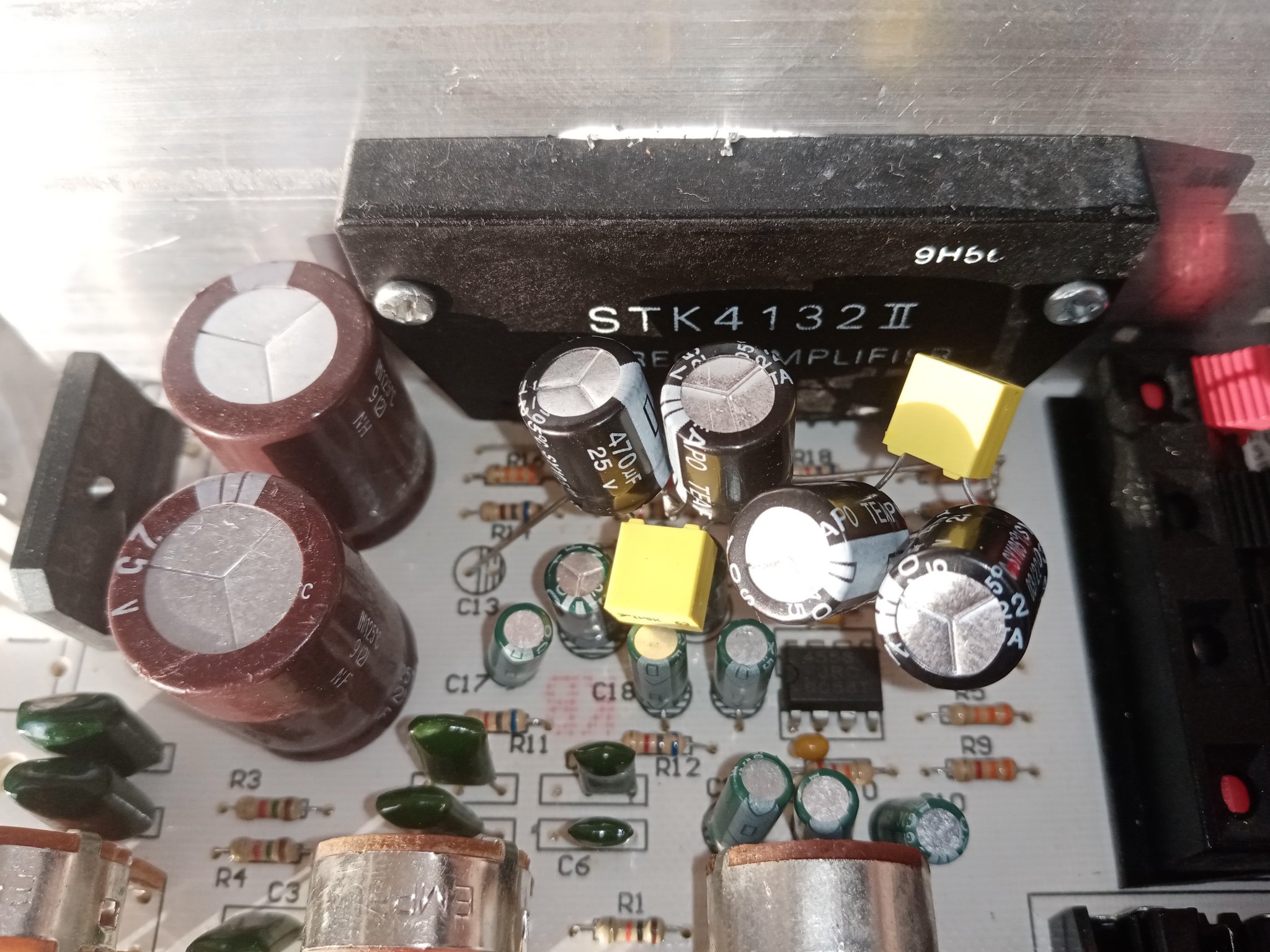

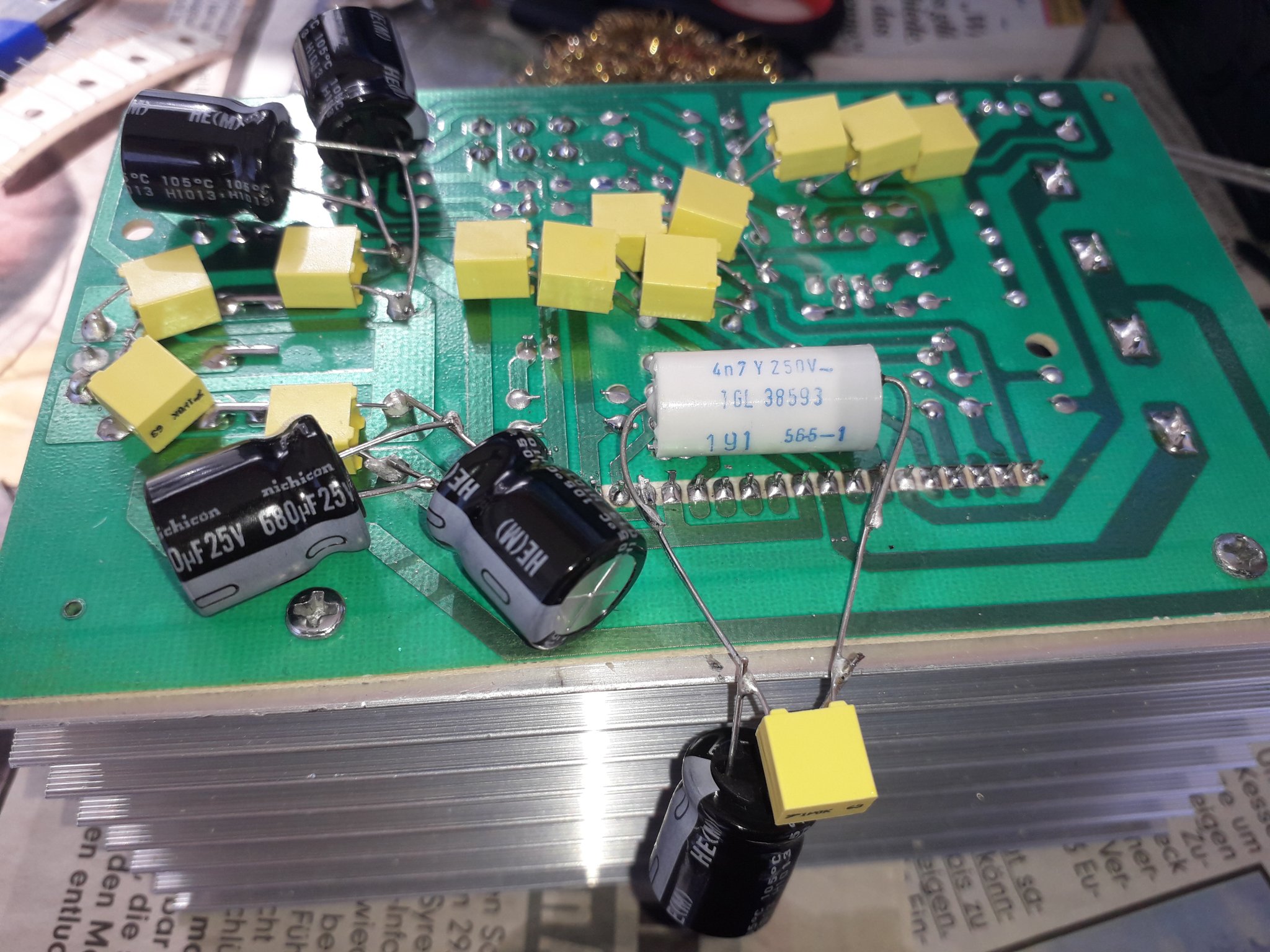

Looked at the schematic and the PCB.
Do not see local decoupling for the chip.
So added 4.7nanofarad foil. 1mfd MKT foil and 680mfd electrolytic directly to the pins 3 and 12 of the STK4132 chip.
I prepared a second amp left original but tweaked with foils in order to compare the sound of both amps. The current driven with a voltage driven amp.

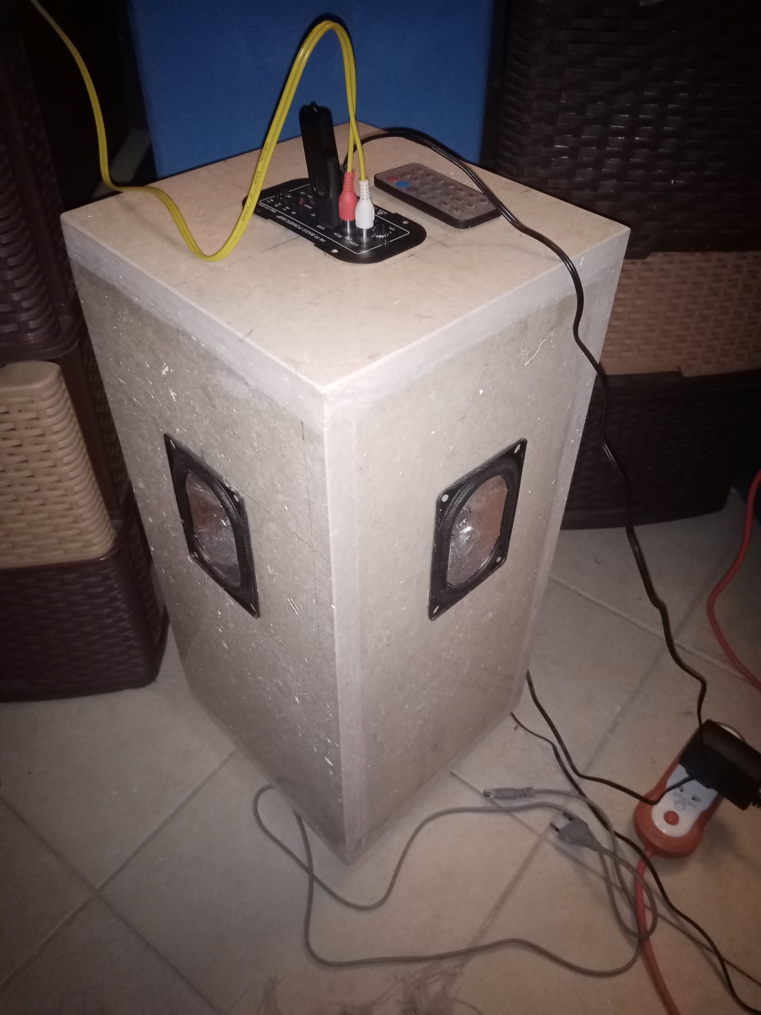

I expect the STK will sound better than the TDA2004 boards (Better specs and no output capacitor). However the main sonical progress lies in the modification of the amps to current drive and the dominant drop in distortion.
The STK4132 is rated at 0,3% THD. Loudspeakers have much more distortion and a drop of 10-20db in distortion on the loudspeakers changes the sound dramatically. The amplifier is not the limiting factor here.

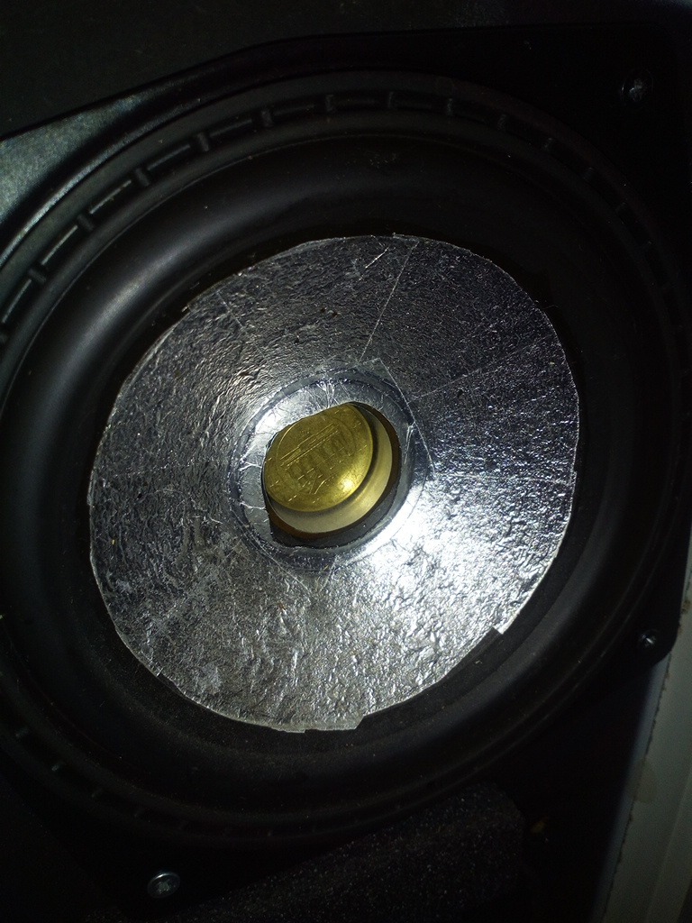

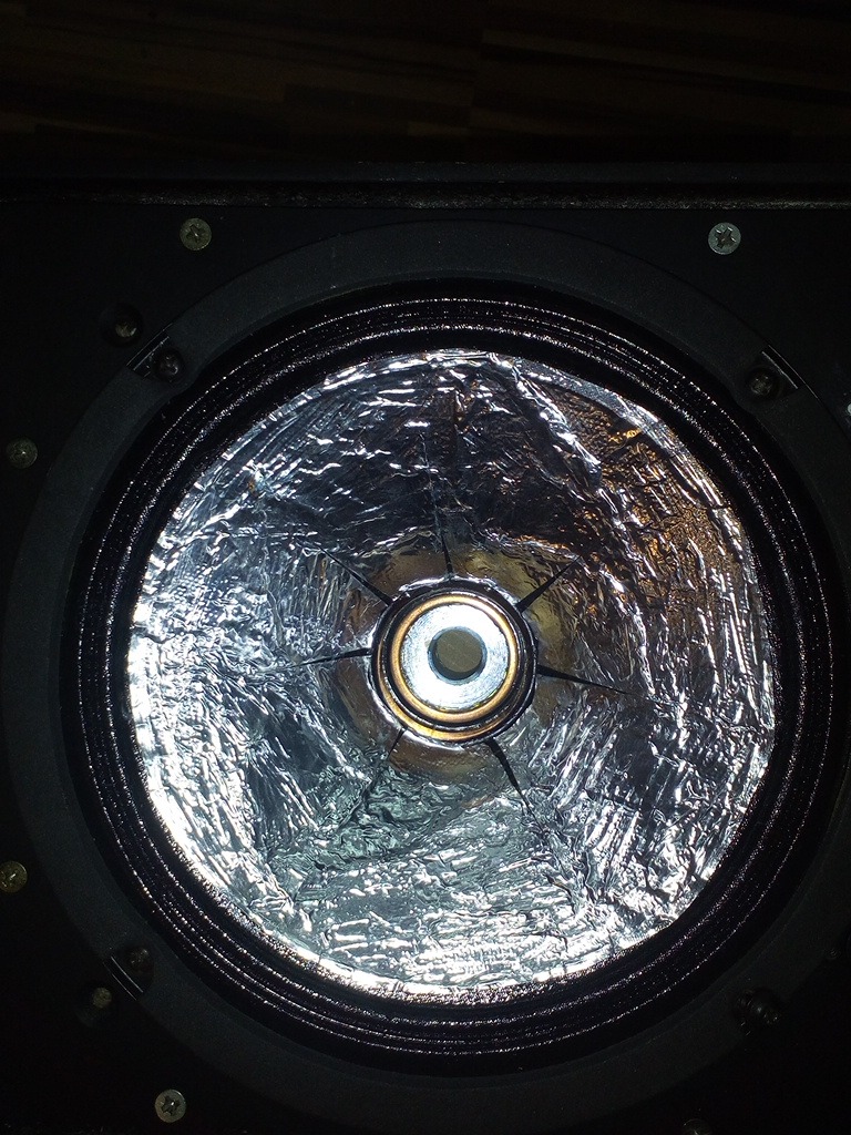

It seems that current drive changes not only the distortion, the frequency response in the bass and the highs but also impulse response because fullrange drivers with faraday /copper ring on the pole piece had a profit in the bass region which sounds more right and convincing than with voltage drive.
The mids profit, too:
As distortion is mostly perceptible in the mid frequencies by the ear they sound much better under current drive. Psychoacoustically the distortion in the mid frequencies add a monotony to the sound. Without this distortion highs and bass are better perceptible.
Interesting is that the frequency linearization due to current drive works so well that I do not feel the necessity any more for correcting the response of my fullrange drivers without crossover network with digital signal processing (dsp).
Here copper rings DIY added to existing driver. This helps already bringing distortion down. These drivers still profit from current drive.

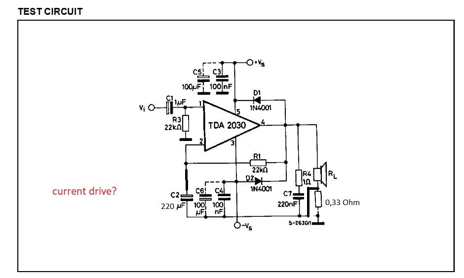

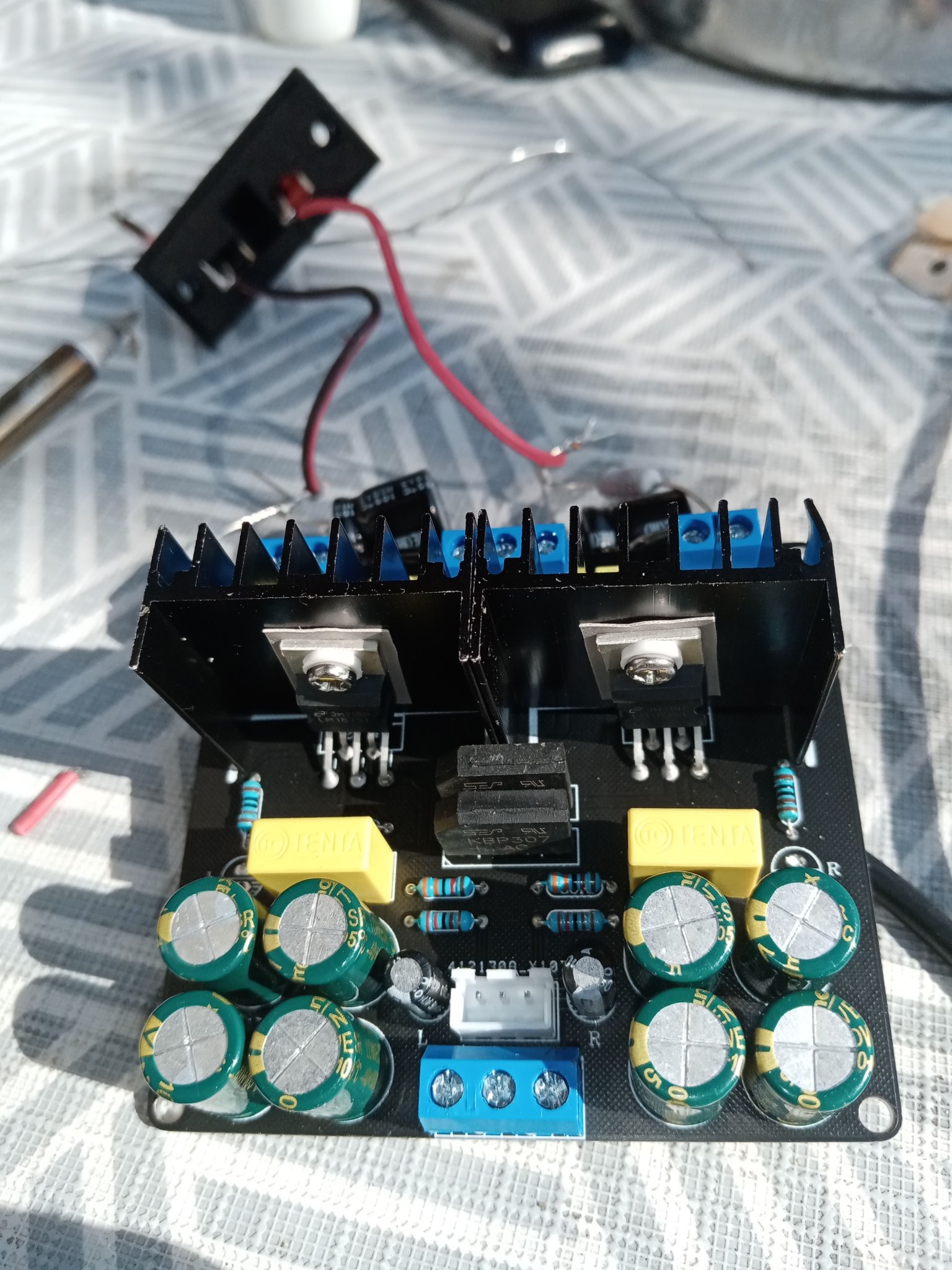

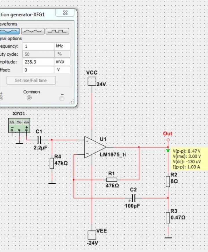

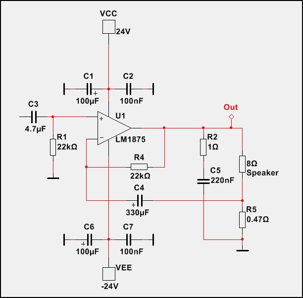

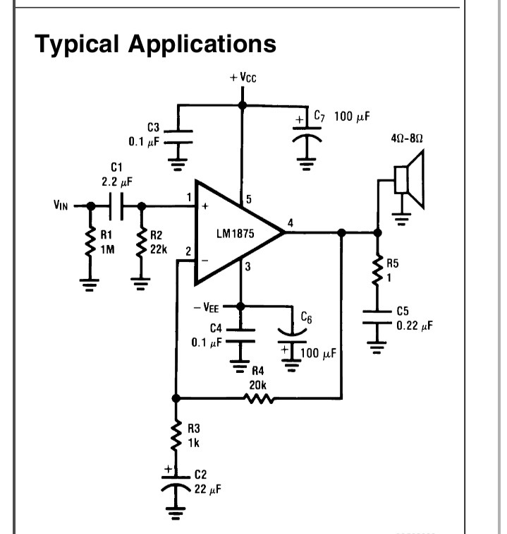

Now soldered one LM1875 board to basic current feedback.
From pin two 340 mikrofarad to minus of the speaker. 0,22 ohm, 3 watts to ground.
Foils for the input and 3.3 mikrofarad MKP directly on the chip on legs 3 and 5 for decoupling the power.
One capacitor of 47 mikrofarad removed to cut the trace from pin 2 to ground.
Connection R2, C5 to ground I will check this.
It seems very simple work I do transforming these amps to current feedback. Maybe annoying to professionals.
But you have to study the board in order to find out the right wiring. In order to make no faults.
