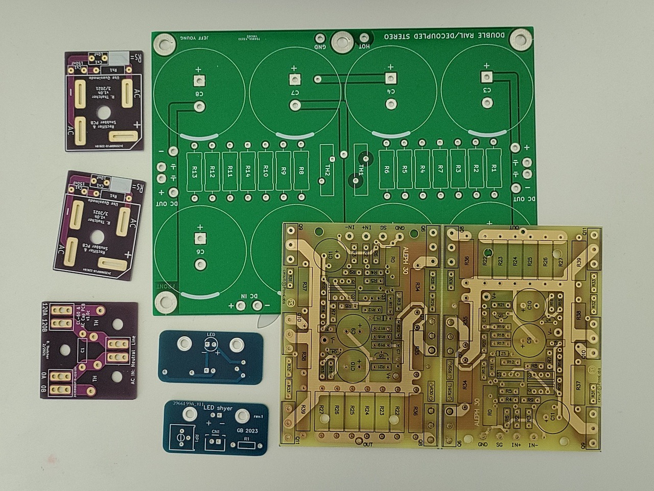

Thanks @rhthatcher. I have already packed Jeff Young PCB you gifted me during latest @codyt SJEP giveaway with snubbers and CL-60 + main cap PCBs. I have more PCB of your design for myself.
@TheSoundMann, in the pictures below is what you will receive at the address you gave me (small blue PCBs are for front panel LEDs if you wish). FETs seems will land on your laps thanks to Randy. Find heatsinks and toroid and you have hit the point of no return.
Keep in mind that if you do not build it you will end up in the audiophile hell, where all amplification is class B!

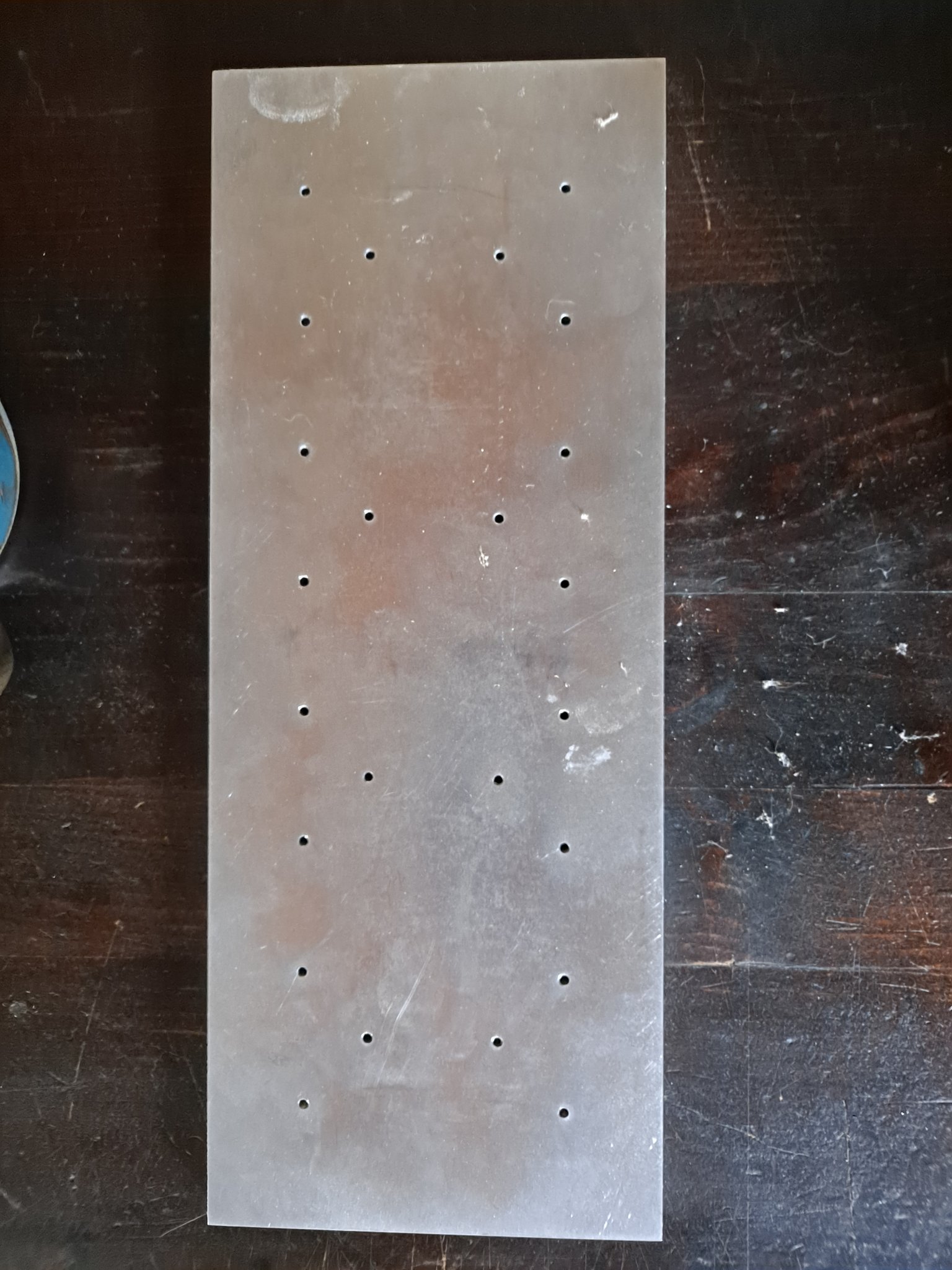

It is hard to drill heatsinks. bottom tapping etc If you are going to do your own, a good way to go about it is drill and tap a piece of 3/8" aluminum stock with through holes, tap them and then attach the aluminum piece to your heatsink. M3 holes or 6-32 holes will work for the IRFP240 mosfets. You can drill through holes for the heat spreader to heatsink bolts between the heatsink fins that way.. The aluminum also acts as a heatspreader which is a big plus. Also you can remove it and drill a new pattern etc.
With the PCBs that you have coming to you, if you drill holes for the mosfets being soldered directly to the PCB, the mosfet leads will be more than strong enough to hold the PCB boards. There is no need to drill holes for the PCB mounting holes. Just use a spacer or something to hold the PCB up while you solder the leads to the board.

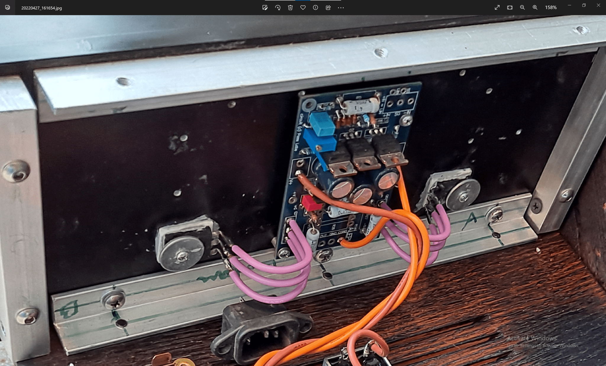

Another way to go is to purchase a DIY audio store 4U chassis and attach your mosfets to your heatsinks with short wires. One thing that I have learned is that the 4U chassis is an economical solution being that heatsinks by themselves (of a large enough size) are pretty darned expensive. Also, the 4U chassis is predrilled to accept other designs available from the DIYaudio store. Same with the power supply that you are going to build.

First picture is a heatspreader with holes drilled and tapped. 2nd picture is wire leads being used to make existing holes work.

Are the boards that you are sending me all I need to build a clone of the Aleph 30?
This version will work best for me.
