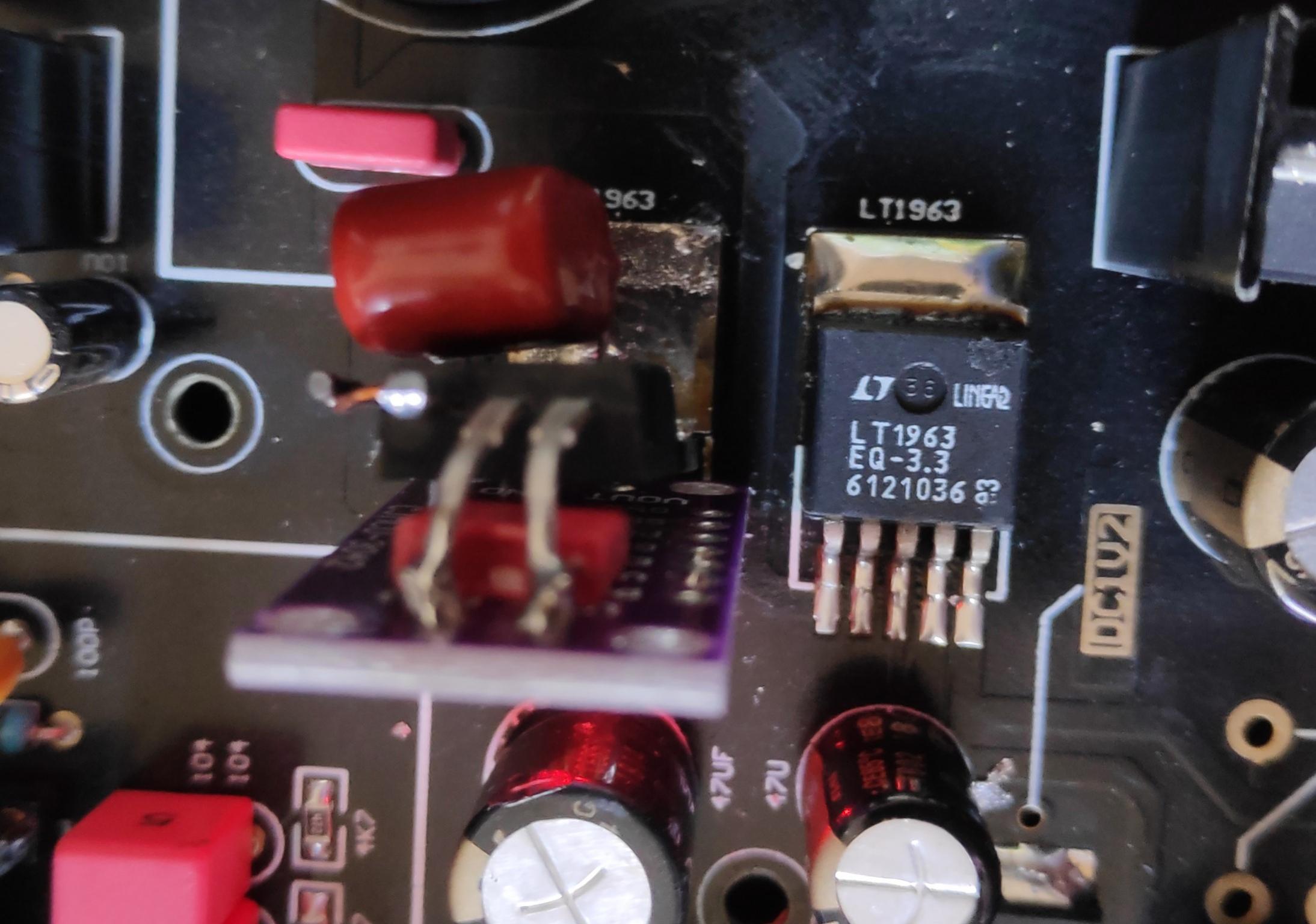

Here is my first PSU mod
I have ordered the reg board here:
LT3042 PSRR RF Linear Regulator Power Board Module Ultra low High Noise Board Reverse Battery Current Protection 20V 200mA-in Integrated Circuits from Electronic Components & Supplies on Aliexpress.com | Alibaba Group
As a pre-reg, i have used a 7808 attached on flying leads to the back of the reg board
once I receive this it will look much leaner.
5PCS LM78XX LM7805 LM7812 L78XX PCB Fixed Voltage Regulator Prototype PCB Board FAST DISPATCH-in Instrument Parts & Accessories from Tools on Aliexpress.com | Alibaba Group
I was able to get a signal lock, I take my coffee now and put some music on, to see if there will be any improvement 🙂

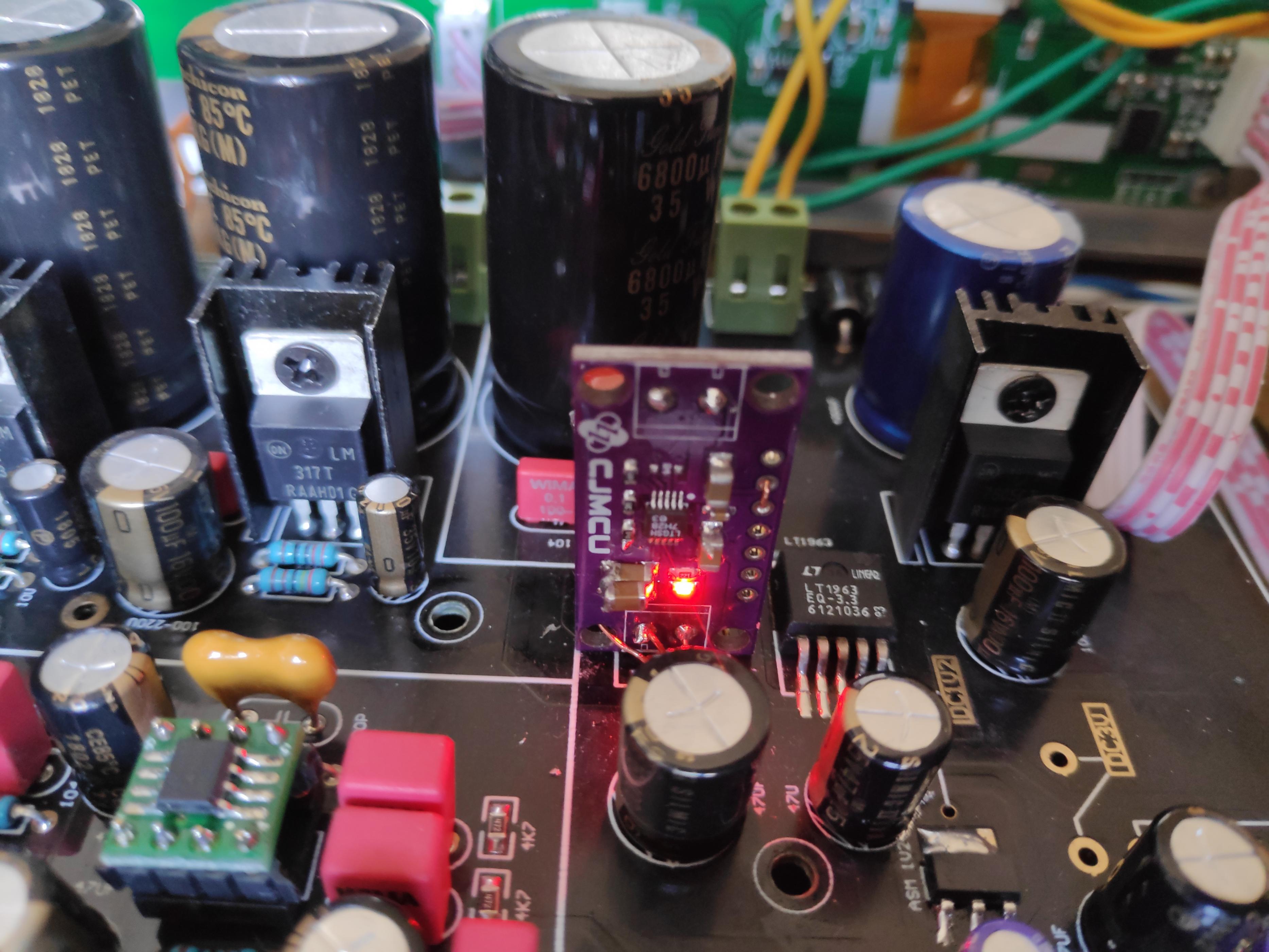

Today I tried to listen to some hi res audio, and was not able to. the DAC would play nicely up to 48 kHz 96 kHz pauses the payback here and there and DSD does not play.
I realized that the LT3042 provides a max current of 200 mA. And the ES9038PRO AVCC can Draw a maximum of 120 mA per channel, therefore 1 regulator per channel is OK but 1 for 2 joint AVCC is not a good idea.
At the other side, AVCC is the analogue part of the chip and so sampling rate should not affect current draw here...
anyone any hints?
anyone any hints?
I will use this little board it has the same reg, but can provide 1A current.
Low Noise LT3042 Linear Regulator Power Supply Board DC Converter Overvoltage-in Integrated Circuits from Electronic Components & Supplies on Aliexpress.com | Alibaba Group

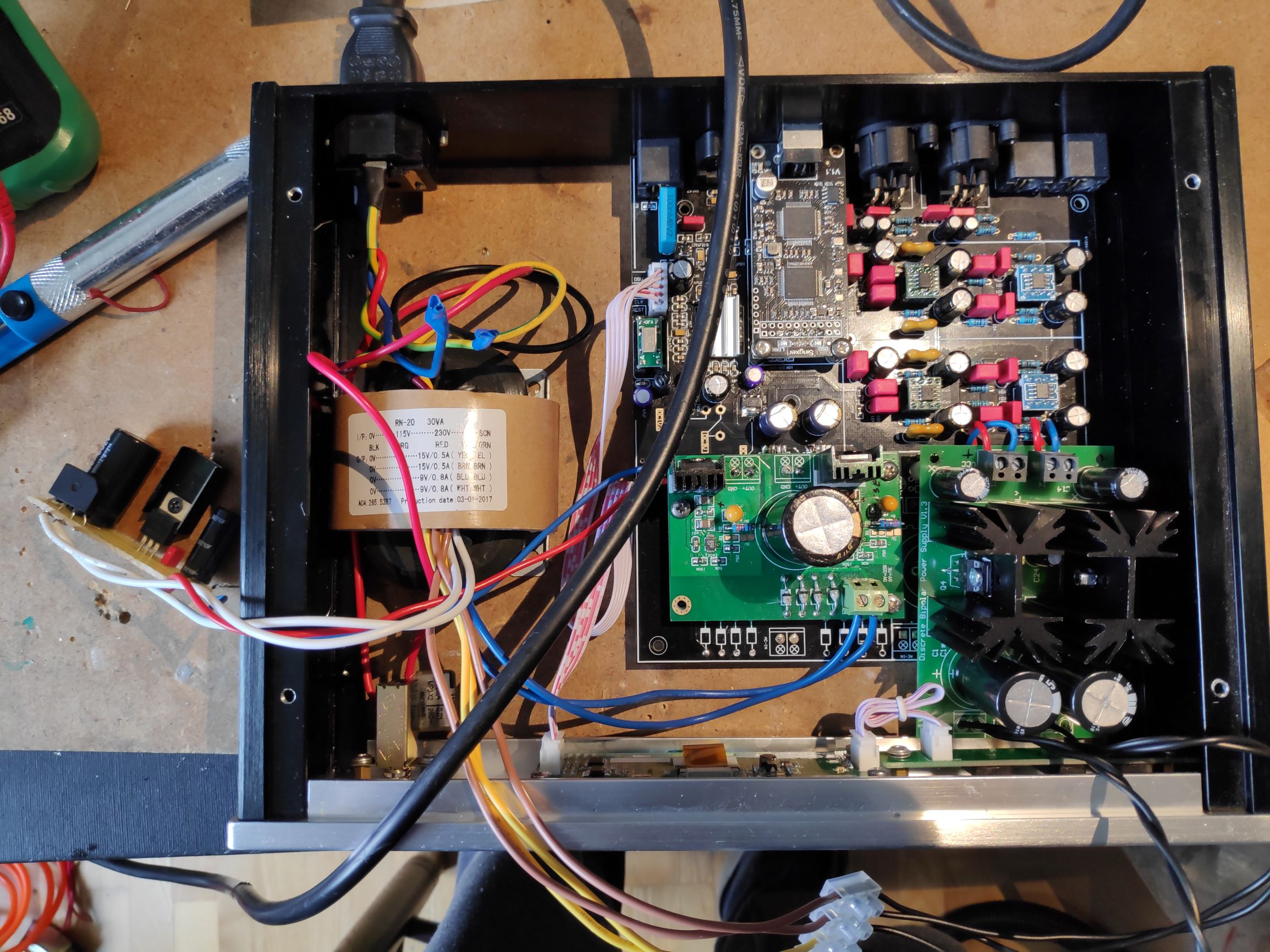

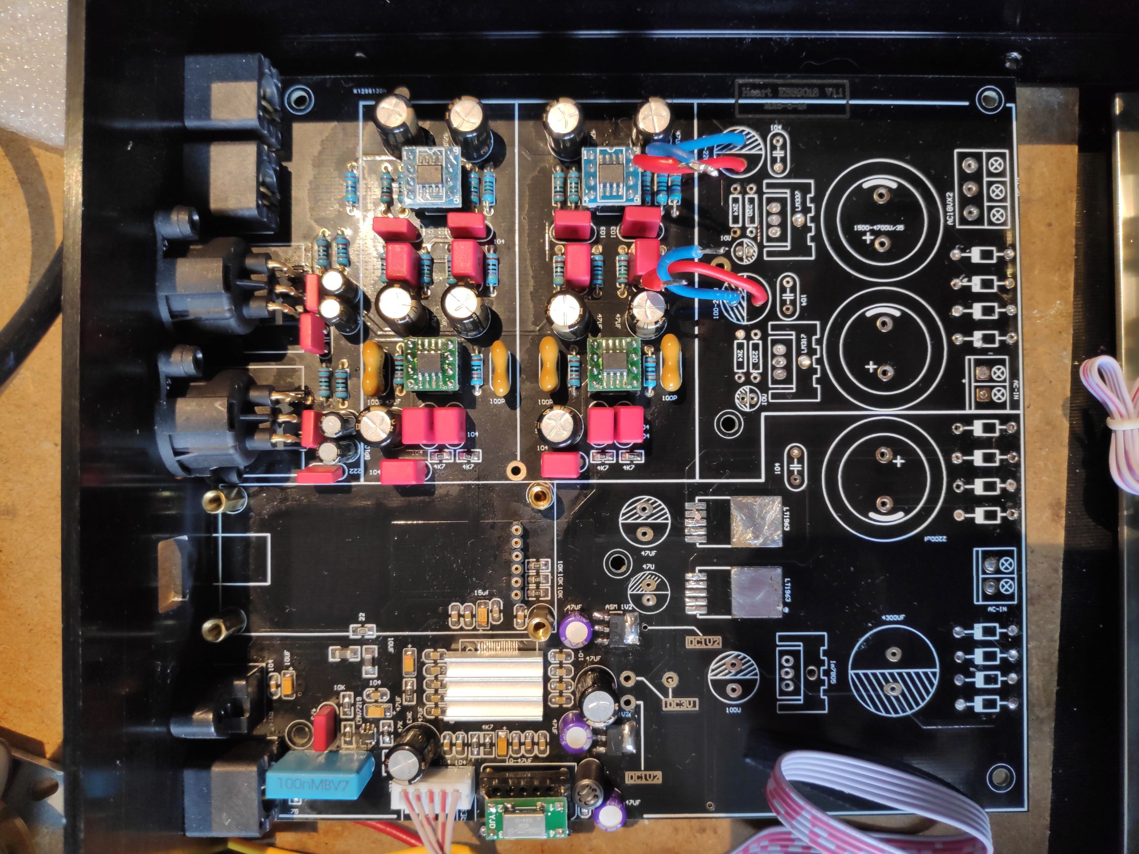

I removed completely the PSU from the board
The rectifier and reg on the left side in only to power the MCU, therefore I plan to remove it completely from the board and place a small one near the display. For now, I made a quick temporary PSU that is near the transformer (outside the case in the pic below). So the board will have left only what will replace the 2 x 1963 regs. and the I\V stage PSU
On the right, there is a bipolar PSU dual 15 V for the I\V stage.
In the left 1A LT3042 PSU
The problem I had with DAC stability is solved by providing more power than the small 200mA LT3042 was able to produce.

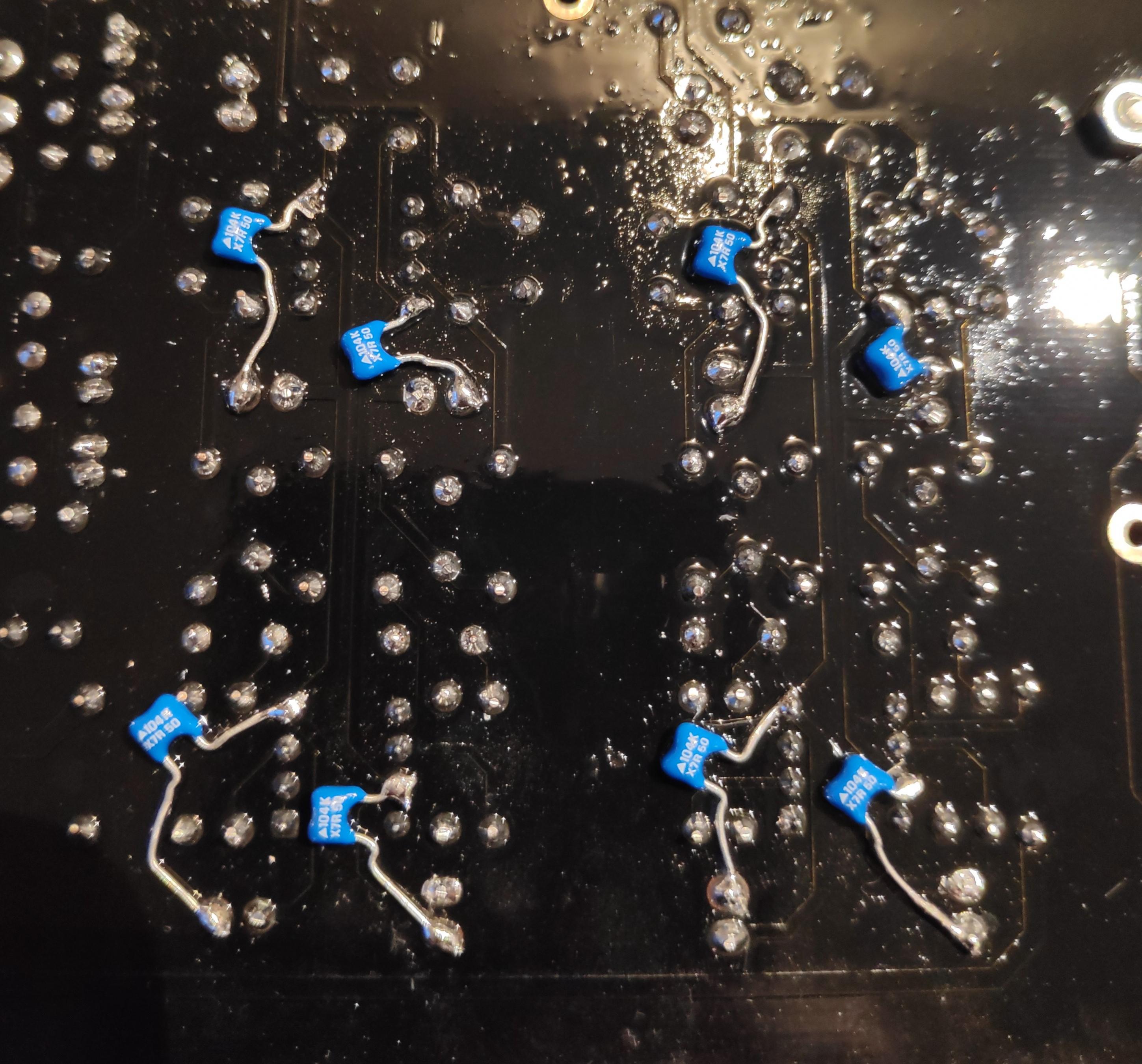

Also, from my own experience (mainly the "Band-Aid" approach of changing one cap here and adding another cap there), soldering bypass caps (small film caps or X7R ceramic caps) directly to the power pins of the opamps makes noticeable differences in the sound. Are you going to try that too?
Great to see that you are completely redoing the power supplies for this board. I'm anxious to know what kind of improvements in the sound you get from the power supply modifications.
Are you going to try to add big fat PP film capacitors as recommended by Markw4? 🙂
when it comes to 100 uF film cap per rail, will give it a try, not sure they will fit into the case though ;-)
My experience too - though I use low ESR electrolytics mostly (Nichicon HZ). Opamps turn out to be surprisingly sensitive to small power supply perturbations.
