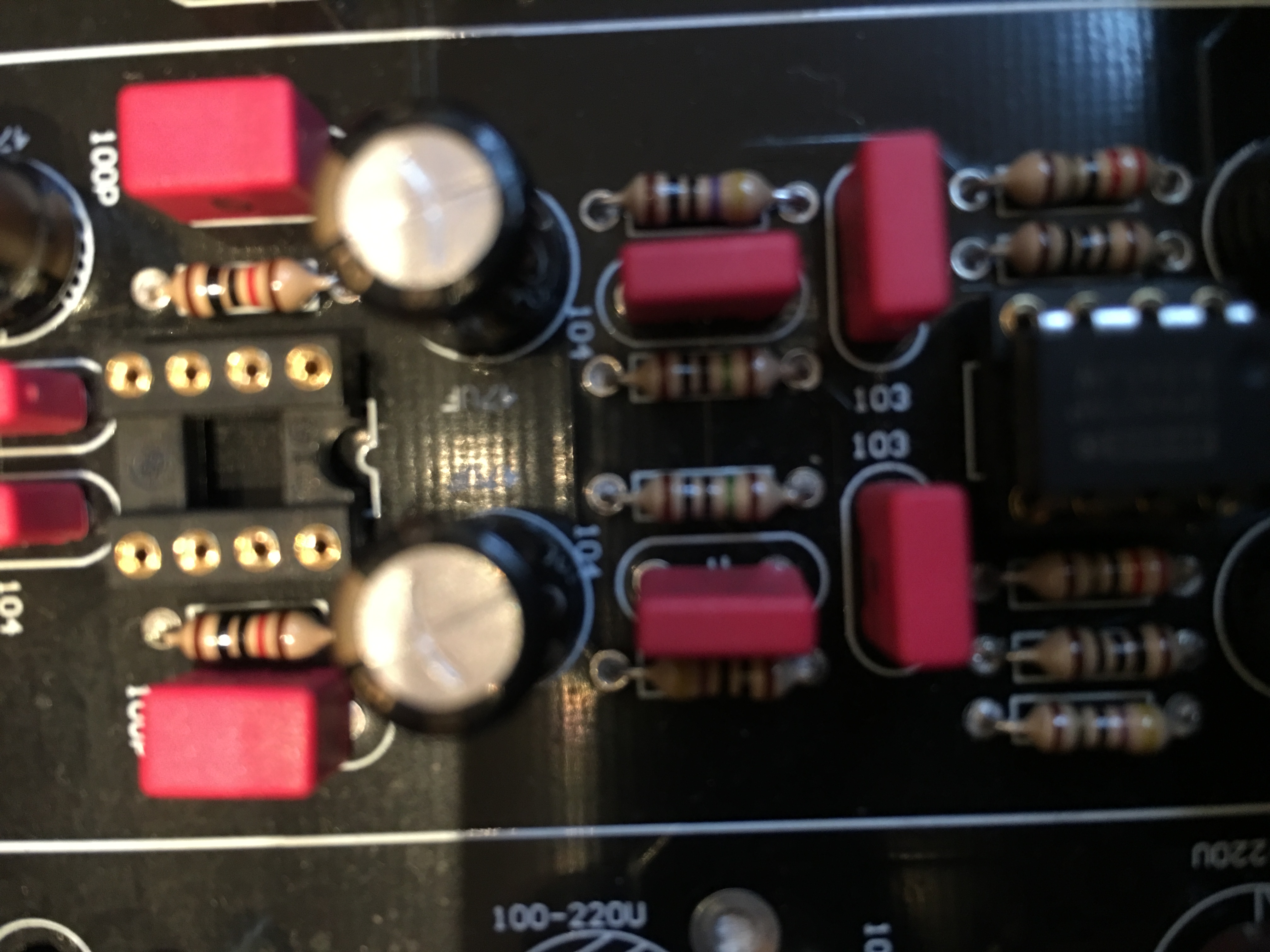

Hmmm the I/V discussion got me very very curious. I am wondering where might the 680R resistor be? I looked around the OpAmp on my Chinese board that looks identical to the OPs but couldnt find a 680 anywhere.
470 perhaps?
470 perhaps?

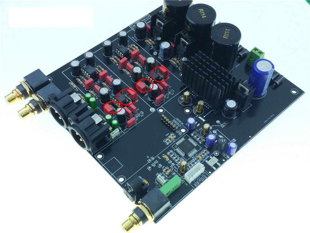

NEW ES9038 ES9038PRO DAC decoder assembled board upgrade to Crystek CCHD-575 | eBay
Same board as the photos the OP posted but
Not the schematics that the OP posted (which seems to be a 9018 board schematic not a 9038)

Easy enough to check. Looks like a socket for a dual opamp, right? The I/V resistors would be connected from the outputs back to the inverting inputs. Output pins on dual opamps are 1 and 7, and the inverting inputs are the pins adjacent to the outputs at 2 and 6. What does an ohm meter show between those sets of pins? (with the power turned off, of course 🙂 )
The schematics i have are the one the seller provided, as i remember he said the board is the same for 18, 28 and 38 there is a diffent MCU for 18.
Could you please post the schematic you have, just to compare?
@Markw4 Pins 1-2 and 6-7 measure 120 ohms.

@idir I dont have the schematics. I am just trying to trace this board myself (of particular interest is the SE output side of things) I will get a better trace once I flip it next time after the caps arrive and I can trace and change at the same time. This board is nothing like the schematic you posted. And I am pretty sure your board and mine are the same. Wait...... it does look like your board has 680 ohm resistors as per your schematics! Blue-Gray-Black-Black-Brown?
@jlw I think we do have the same boards. I believe they use exactly the same boards sice the ES9018PRO through ES9028PRO and ES9038 PRO

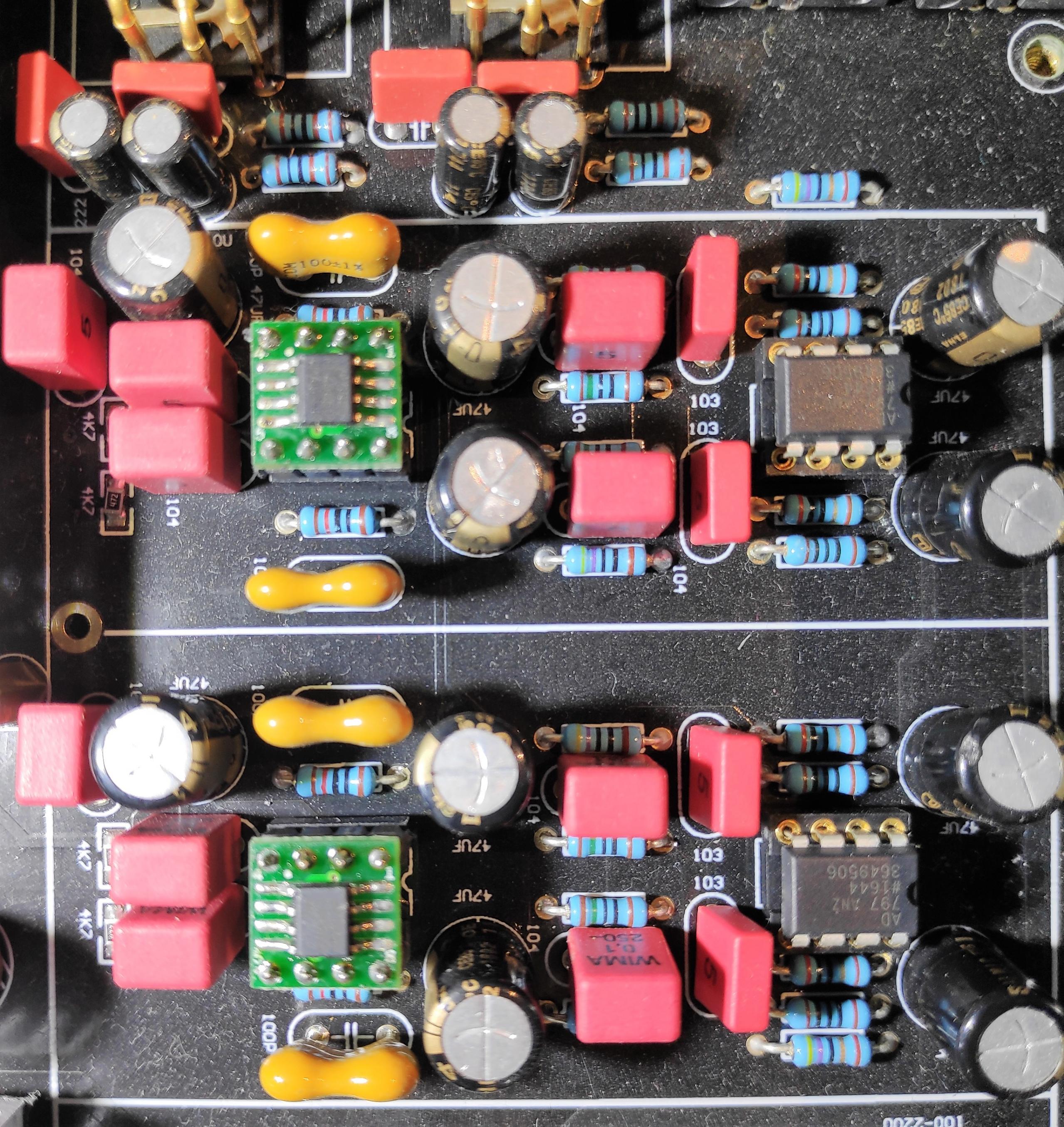

Pins 1-2 and 6-7 measure 118 ohms. (- 3 Ohm of my multimeter wires thatwould give 115 Ohm). In my board
Here is the picture of genuine vs whatever is there Elna Silmic II. I did not have 25V so the size is not the same but the colors seem weird. I have check Elna specs and did't find that color pattern therefore assumed they are fake.
When it comes to 680 Ohm Resistor i do not see it here

So I made some basic mistakes in calculation. The ESS9008/9018 put out 10.5 mArms when 4 are paralleled, a 187 ohm I/V resistor will see about 2Vrms and a 22R + 10nF cap is required at the first filter position. 680R was the value per channel for ~2Vrms out, when 4 are paralleled you need 1/4th the value.
With 120R (which is used as IV resistor here) you will see 1.2Vrms at output (only of first stage, I am unsure if gain has been applied to second stage and am not interested in finding out). You can see PCB track layout on pg 1 of this thread that shows 120R being used in IV position and the first stage LPF is a simple cap across the resistor.
Which means the seller provided schematic is useless because it does not reflect what is actually being used. However given the PCB traces and top view with components, you can clearly work out what is being used.

@idir I see you are using an AD797 in the SE output OpAmp position.
You may consider the 1611 due to current requirements. Cheap enough to try and you wont risk burning the $$$ Bursons.

@idir do you have 2 different boards? The photo of the board you posted at the start of the the thread looks like a 680R equipped board. This one with the yellow 100pfs look a bit different. (or is it lighting?)

The first board on the first post has the ES9028 chip so is the one with uncovered top copper layer. while the one I am playing with now is the ES9038. Sorry should have mentioned that before.
