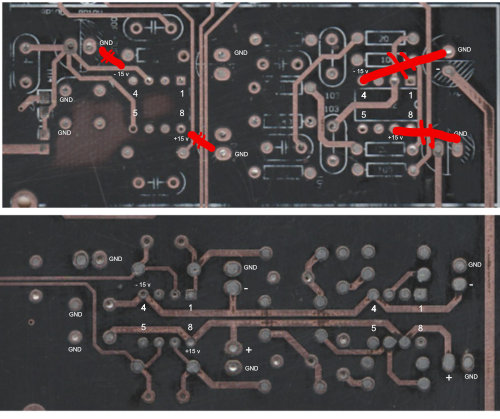

Two comments:
1. The solder points on the topside (the upper half in your picture) of the PCB will be covered by existing components, such as the e-caps and opamps (or their sockets). You will not have access to them so cannot use them for bypassing. It would be much easier to solder small caps for bypassing on the underside of the PCB. For big fat film capacitors that cannot fit in the space underneath the board, you have to find creative solutions to form electric contacts from the top.
2. The upper-left bypass connection in your picture is incorrect. The red line in your picture should end on pin 4 of the opamp, but now it ends on a signal path. The lower-left connection end points are also ambiguous.
Two comments:

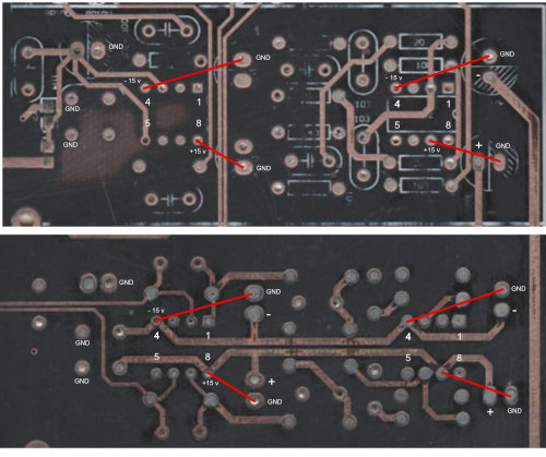

@kchang
1. I will most probably use soic to dip so will for sure be able to solder SMD caps inder the opamps
2. Sorry for my drwaing skills ;-) all the lines are supposed to be between +-15v and GND.

I was looking and your design of the output stage. If I apply the same power filtering here for ops. I should replace the all the 47 uF with tantalum 10 uF and add a ceramic or film 0.1 uF directly to the pins.
@idir
The 47uf electrolytics are usually for lower frequency reserve power, whereas immediate bypassing or decoupling from supply pins to ground for opamps is mostly for high frequency stability to avoid oscillation or ringing of the opamp. For digital circuits and maybe for faster opamps the decoupling caps would provide reserve current for fast pulses and fast edges of transitions, which in digital circuits can help reduce chances of logic errors.
The idea of bypassing at device power pins is based on using a tantalum and ceramic in parallel with closer to the pin than the tantalum if they have to be at different distances. The expectation is that the tantalum can provide lower impedance at lower frequencies than the ceramic can, and at higher frequencies the tantalum will become lossy and the ceramic will have low impedance. In that scenario one would not expect to have resonance problems at the power pins due to too many capacitors of different sizes and with different parasitic inductance forming multiple high-Q tuned circuits, which is why this method is recommended. Therefore the tantalum should be one that is not good at very high frequencies, and the ceramic should be X7R (not C0G or NPO which are too high-Q).
On the other hand, film caps aren't very good for bypassing since they are not as low impedance as ceramic at higher frequencies and they have much more parasitic inductance. My recommendations for using film caps to best effect has been written up in other threads.
One other thing, I think when Mikett went through making some power supply changes to the board he has that looks a lot like this one, IIRC, he said that adding local bypassing helped the sound. You might check his thread on the subject to see what he reported.
