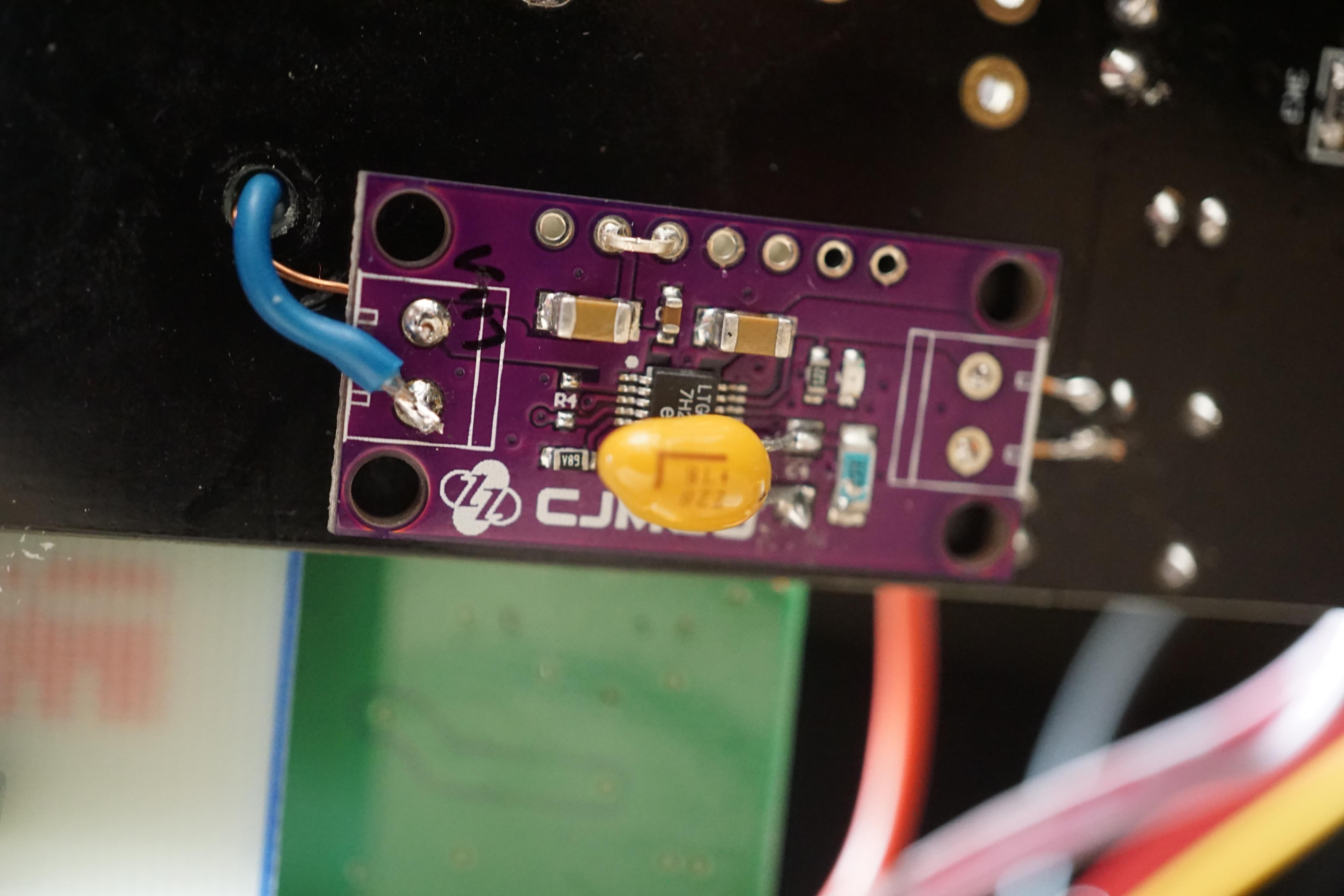

Mark, do you mean placing regulators close to RF device during board design?
Honestly I do not know how to place regulators other than the ones on an additional pcb.
I totally agree with you that long flying wires act like antennas collecting all RF and EMI garbage, in my board this is just an interim solution. The reg boards will be soldered to the pads where the AMS1117 was. I would need another reg than LT3042 as the current draw is too high there. I will use the LT3042 board I have to power the oscilator, and probably place it under the clock on the other side of the board.
exactly, it fits there nice. actually, I placed quite a few TH parts I changed at the opposite side, just because it was more convenient.... I will use the LT3042 board I have to power the oscilator, and probably place it under the clock on the other side of the board.

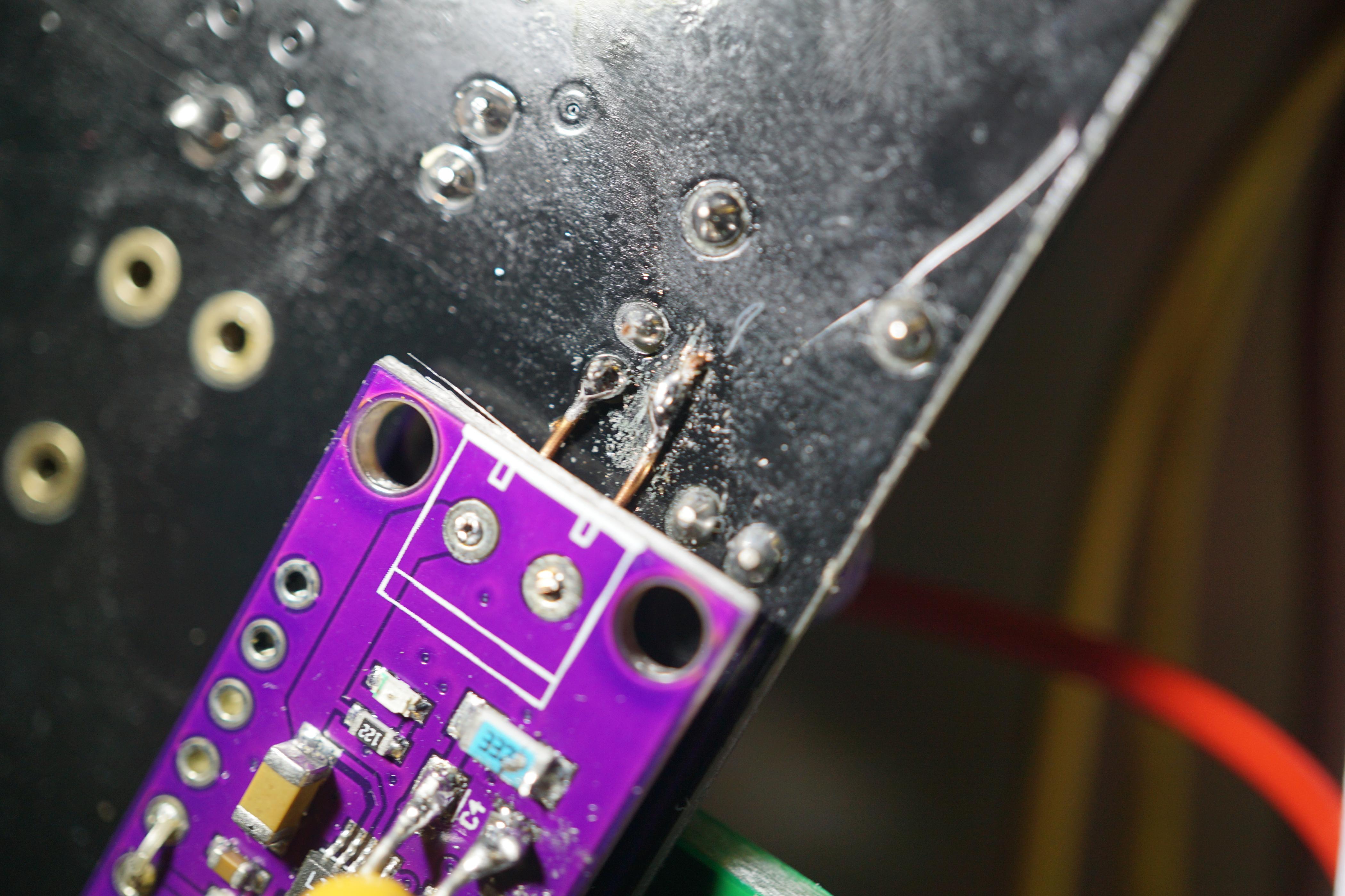

I mounted the local dedicated regulators on the bottom side of the ground plane, dead-bug style. Since the board I am using is only two layer, it was possible to safely drill some small holes for the regulator outputs to be routed directly up right near the power filter caps for each RF device.
and the leg connected is isolated from the original power trace? btw gnd could be soldered to the capacitors gnd pin just next.
That is correct, the trace is cut.and the leg connected is isolated from the original power trace?
It could but, in this way it will be easier to replace the capacitor.btw gnd could be soldered to the capacitors gnd pin just next.
Since we are talking about cap. I have hard that 3042 reg. does not perform well with the low esr oscon, that is there.
Does anyone has any experience in that matter? Should i replace it?
in case of stability problems I would rather put a 0.2-1ohm resistance in between. but better first take a look with a scope what is going on.

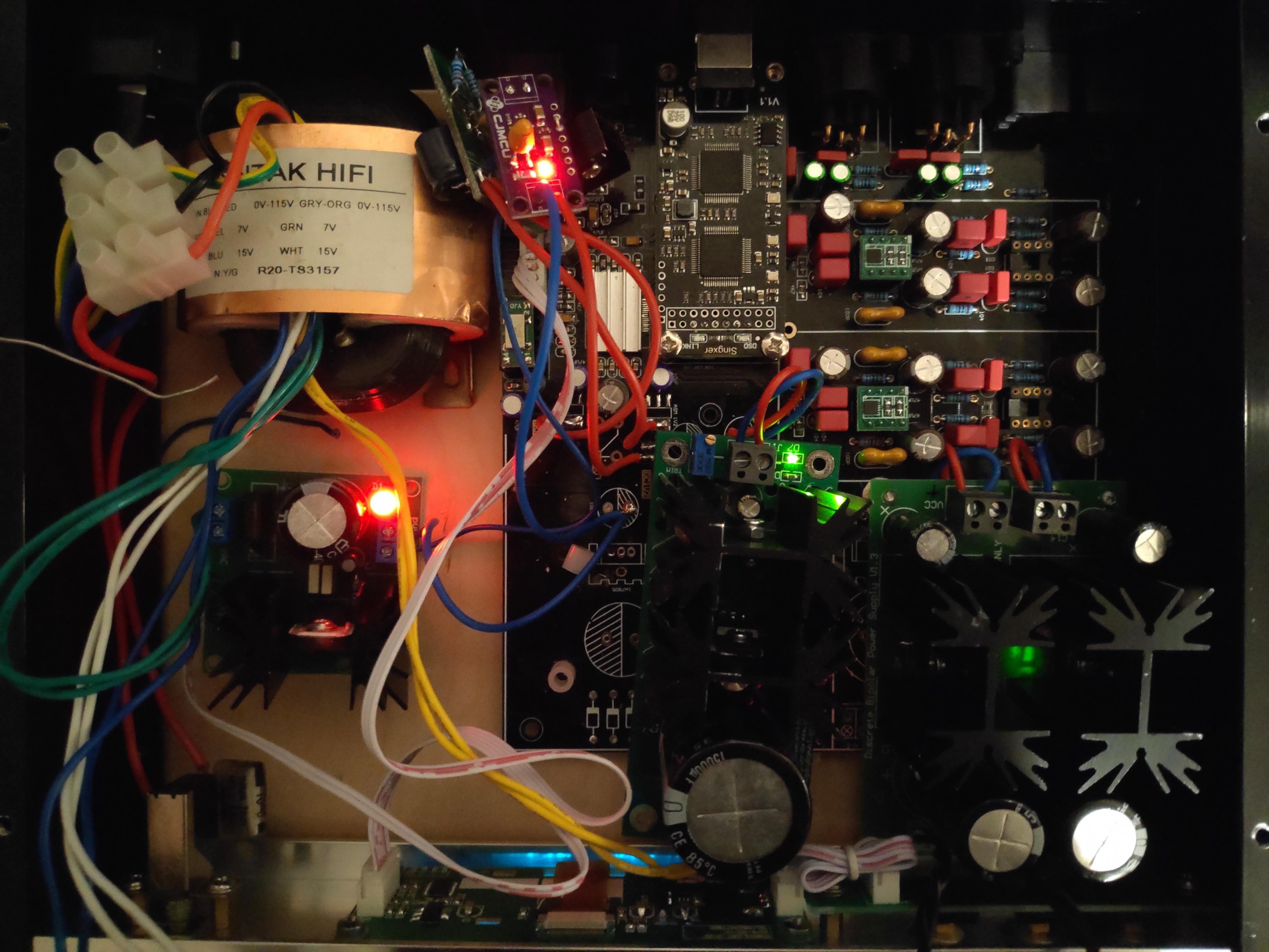

I stopped short of ripping / adding regulators and cutting traces to partition the channels since I want everything to still fit in the Breeze Audio Minishow0328 chassis.
Did a few things such as caps and 0.1uF MLCC bypasses around the OpAmps but so far my biggest bang for the buck has been to eliminate the 47uF round the OpAmps in favor of just 10uF 50V WIMAs.
