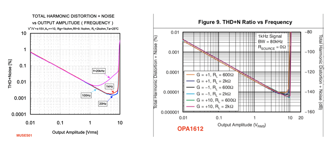

What opamps are suitable and recomendable as upgrade to ES9028PRO board?
from the modern ones, which can handle the output current (stay linear, not just max value) OPA1612/OPA1611 perhaps..

imho, all this is rubbish and a waste of money. if you fancy discrete, then better look for sparkos. but, unless you redesign whole output stage, there is no need for anything more "audiophilic" than TI OPA161X opamps

Moreover, trying to buy Muse opamps on ebay at low cost may be a good way to become owner of some relabeled counterfeits.

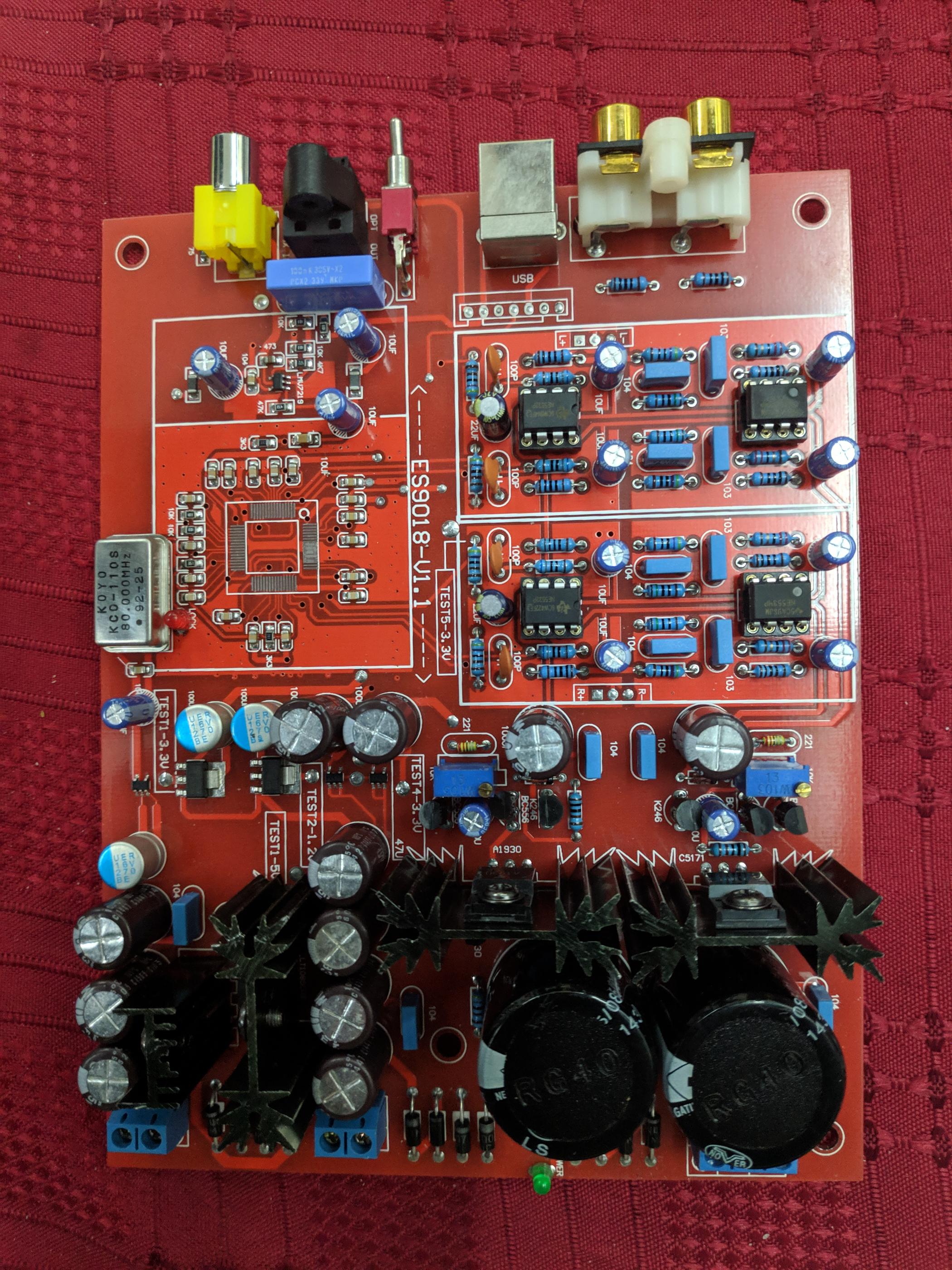

I bought the same board version as ldir have and on that board was chip 9018s. Could i unsolder 9018s and replace it with 9038pro?
technically pins are identical yes. the I/V on the board is not up to the task to handle 9038pro output current. so either stay with 18s, upgrade to 28pro, or buy TP Mercury output stage if you go with 38pro.

ok, so you already replaced 18s with 38pro and board is dead? as I said, all ES90X8 are pin compatible, even though the DAC chips have different electrical characteristics. the board discussed was designed for 18S. however it is sold also with 28/38pro chips. the latest clearly is not appropriate for the board, even though it should be functional.
anyway, another thing is you need a proper MCU (that chip behind the display) code, which supports 38pro. the code flashed for 18s will not work. so, what message is displayed when you switch the board on?

My not-too-adulterated board as it stands.
The biggest improvement was junking all the 47uF lytics around the OpAmps replacing them with 10uF film and upping the 220uF at the output of the regulator for +/- rail with 330uF Nichicon KZ.
The tonal balance of the unit completely changed from lean to lush. Smooth with a lot more microdynamics.
