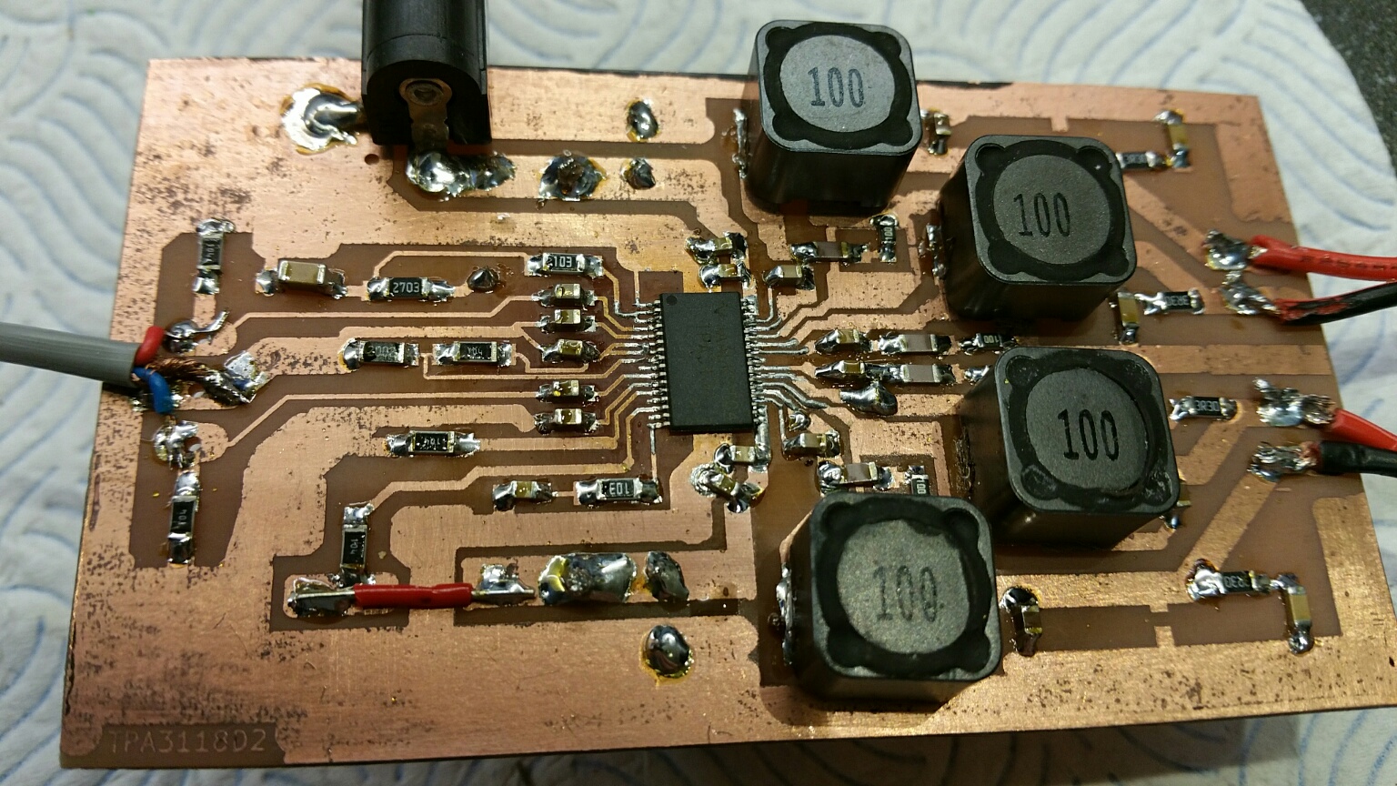

So i,ve been putting a circuit board together but having problems with interference to my DAB radio in same box, here is a pic off pcb if u can see a problem please comment
The circuit is to IT spec sheet
Thanks !
There is a lot of radio noise emission from class D. I you problem radio inference? Depending on your frequency of interest the TPA311x has resistor jumpers to select the carrier or modulation frequency between 400kHz and 1.2MHz. Probably best not to put them in same enclosure.
Nice SMT board.

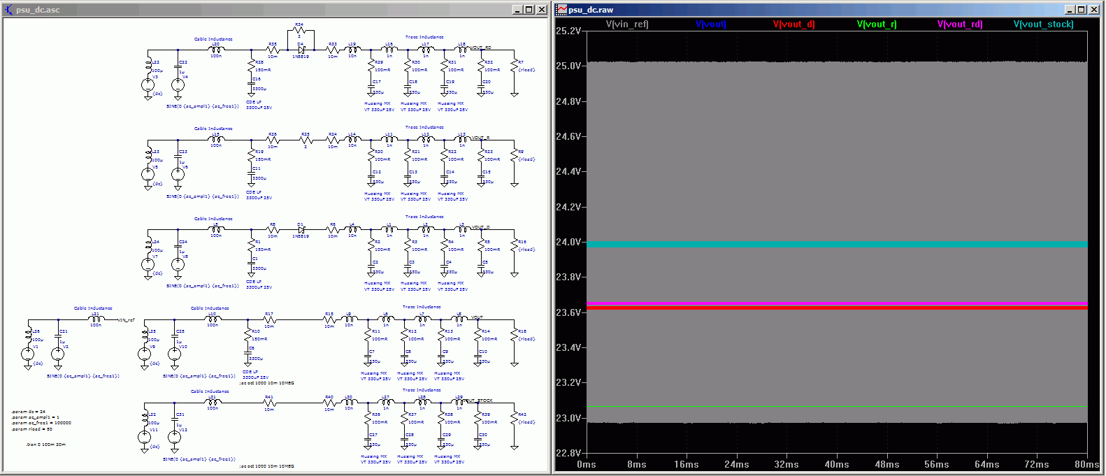

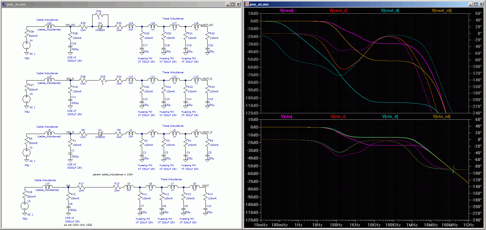

I'm still confused by how Daniel's C+Diode (which is what it looks like in the pic he posted) implementation on the power input is a CRC implementation as he claims.
To make the short answer long:
Lets compare:
- Resistor + Diode + big bulk cap
- Resistor only + big bulk cap
- Diode only + big bulk cap
- direct connection + big bulk cap
- stock (no R, no D, no bulk)

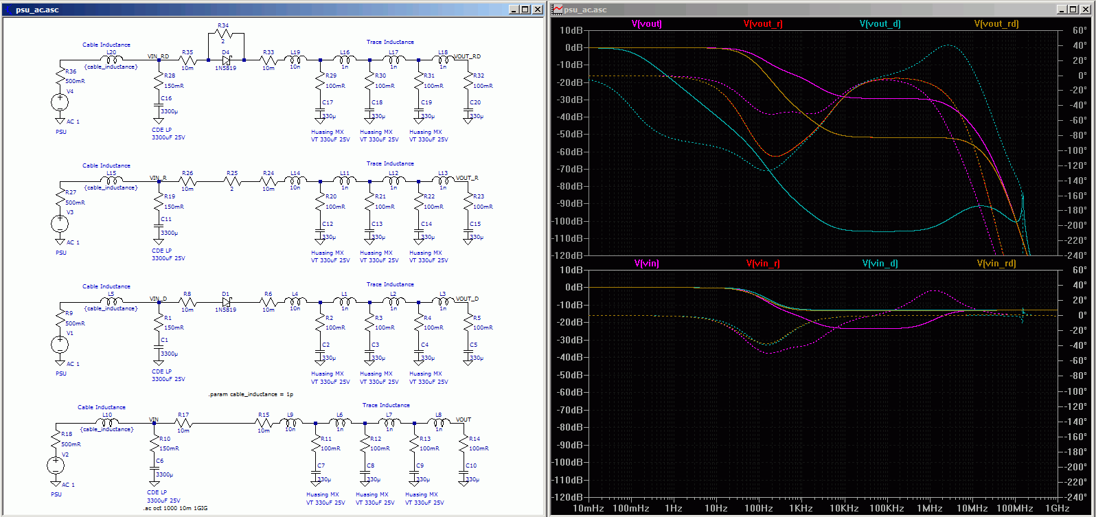

An AC-analyse provides:
Without cable inductance from power supply:
With cable inductance from power supply:
What can be seen? R and R+D is similar/same at AC - we will see, that this isnt at DC. The diode only plot lacks from the simulation modell i guess.
The cables inductance takes place at frequencies from 1MHz and up.

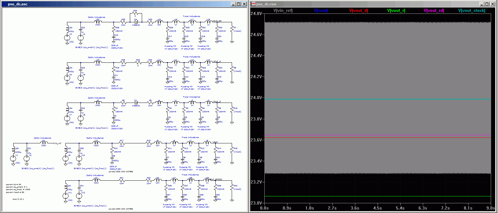

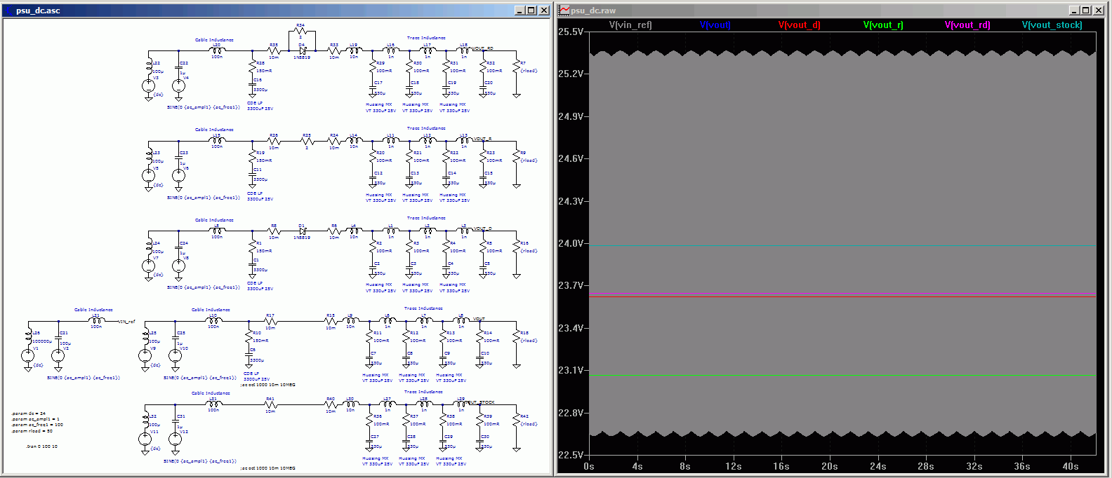

So whats happening on DC. Lets assume PVCC=24V, PVCCripple=1Vp, constant load of 11.5W (Rload = 50R)
at 100Hz:
at 1kHz:
at 10kHz:
at 100kHz:
Vinref is the voltage (with ripple) feed in into the power path. It can be seen that the "resistor only" variant has the least ripple but bigged voltage-drop. "Diode only" and "Diode + Resistor" are pretty much the same for frequencies <10kHz, things getting worse for frequencies of 100kHz and up (for the "diode only"). Having just the bulk cap, voltage levels stay ~the same as stock with bit better ripple reduction.
Compared "just bulk cap" with "bulk cap + R + D", "bulk cap + R + D" is better at the cost of 0.4V drop.
Better means 10mVripple vs. 20mVripple.
Lets see this in percent from 24V supply voltage:
"just bulk cap": Vripple=0.083%; Vdrop=0.08%
"bulk cap + R + D": 0.042%; Vdrop=1.6%

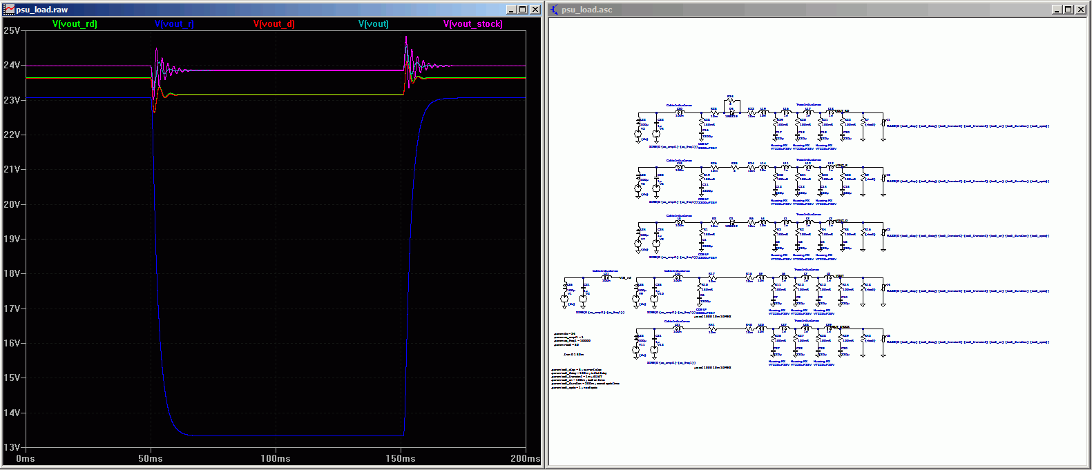

Having a load step of 120W (5A) at the rail:
It can clearly be seen, that having an just an R of 2Ohm between the caps is a real deal breaker. Diode and Diode+Resistor are performing nearly the same with some voltage drop (of course).
Having the big bulk cap in the system dampens out the peaking of the connection wire but wont help on a load step, as the voltage drop is dominated the power supplies impedance.
My own conclusion from the simulation:
The advance of using an R+D + bulk cap is negligible. If doing so, the inflluence of R (at 2R) compared to the diode only is also negligible.
The bulk cap is helping to bring down the systems impedance when having long wires/connections to the PSU (This is a commonly fact) and helps to reduce "ringing" from the connections inductance. If you have short low impedant connections, the bulk caps influence is also negligible.
While the diode or resistor+diode decreases the ripple by about 50%, we are talking about ripple levels of 40mV (with a stimulus-ripple of 1Vp) and down which are below 1% of the supply voltage. Would you use a supply with 1Vp ripple on the output?
So if there is an audible effect, this either is biased or the supply from "non-optimal" quality/performance.
At bass levels the bulk capacitance is way to low.
For thos who like, the simulation files are attached.
YMMV.
Regards.

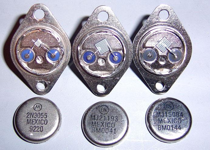

I don't think amount of plastic or metal surrounding tiny dies matters much
But the thickness of the pins leading from the die can carry more current, no? Plus no output inductor to squeeze all that current through. I bet the physical transistor size (active element) of a Toshiba 2SC5200/2SCA1943 is bigger than what is used in a TPA31xx.
